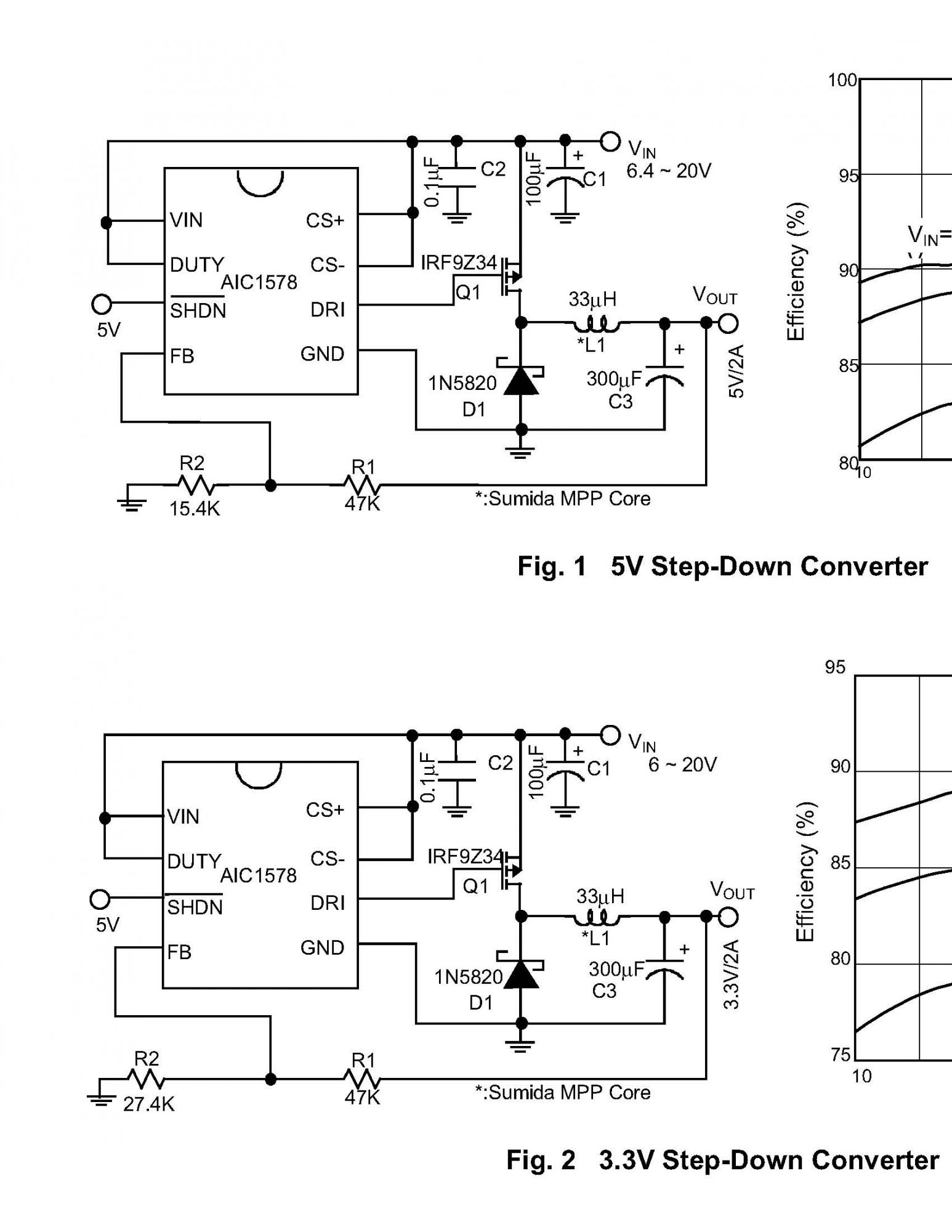

        It looks like the TPC8104 is a good match for the RSS050. I do agree with budm that several of the voltages on Q801 don't make sense:
        1) have you verified there are no shorts on Q801?
        2) from the diagram in post #21, please verify the R1 and R2 equivalents on your board are within specs?
        If 1) and 2) are both good, then it might very be that U801 needs replacing.

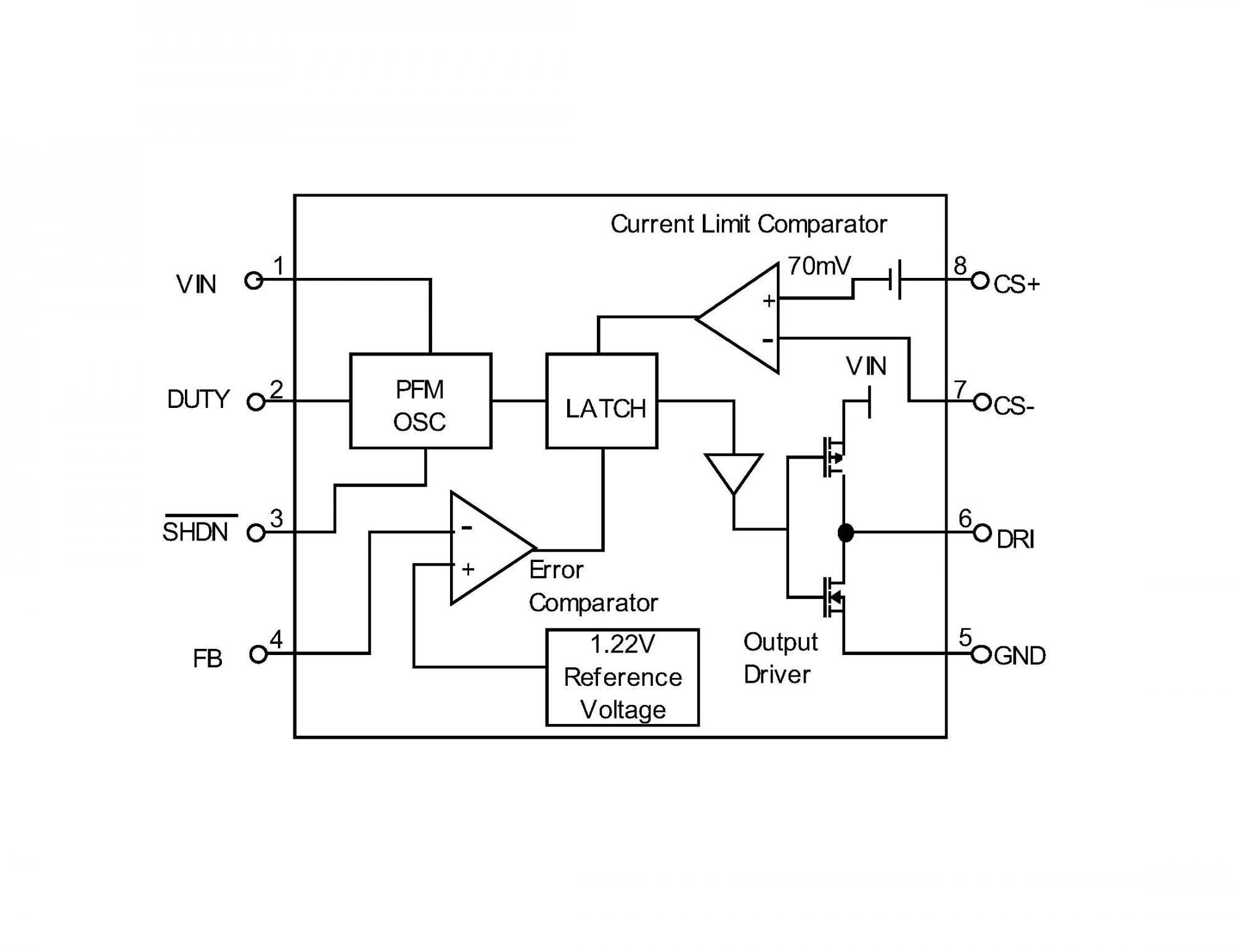

          I looked at the block diagram of U801, please take the resistance reading between pin6 (Drive pin) and the Vin pin 1 to see if the internal MOSFET is damaged and caused the output drive pin6 to be stuck high.

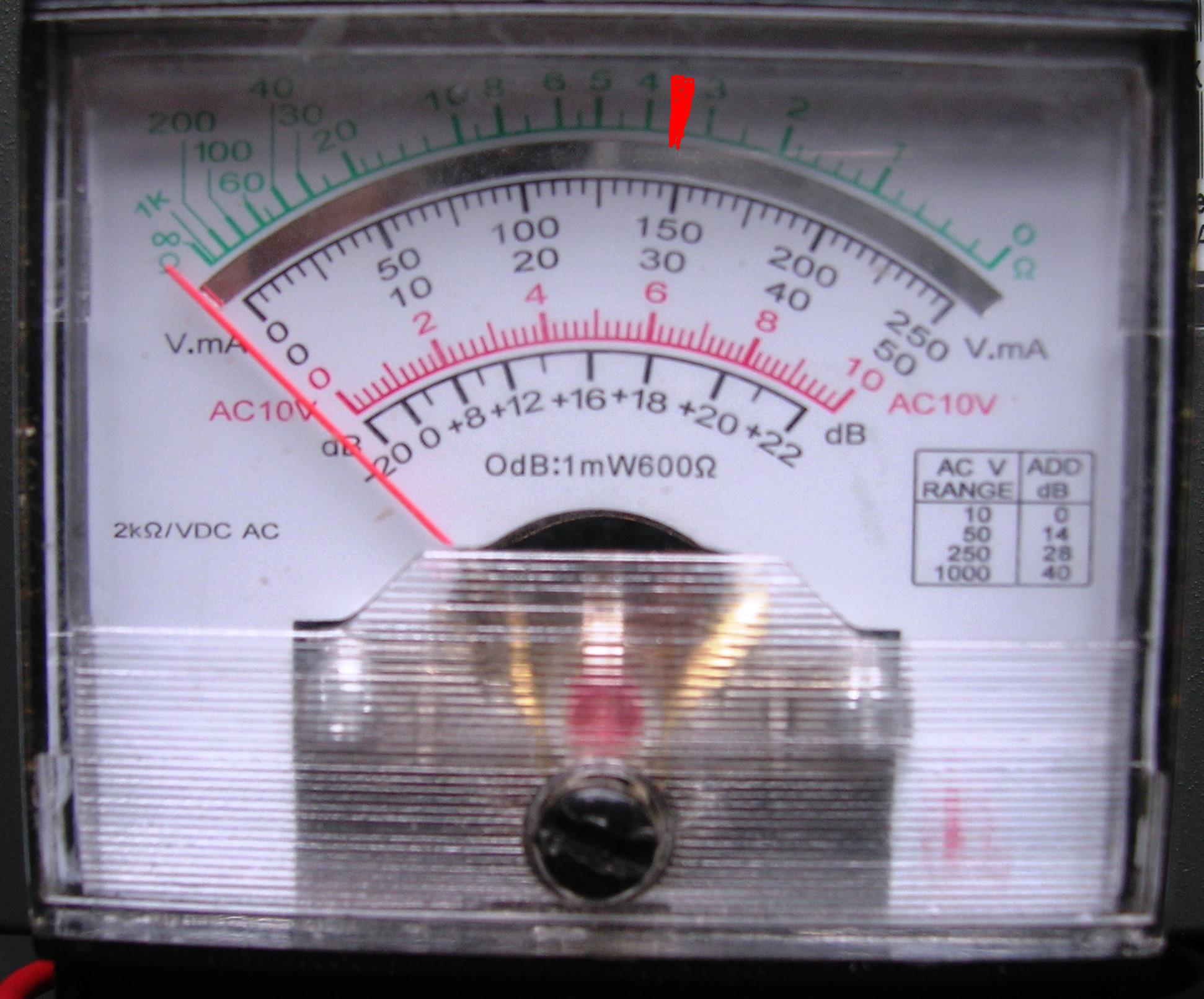

              Re: AG Neovo X-17A
              Hi
              reading from pin 1 to 6
              X1 ,X10 or X100 all read the same (see pic)
              But cant find any shorts on mosfet
                Re: AG Neovo X-17A
                It goes up to the red marker on the meter? or the needle just stays down on the left side?
                I still think there is problem with the IC due to some of the voltage readings you had indicated earlier.

                  Re: AG Neovo X-17A
                  Meter only goes to the red mark i put on there save writing out 3 readings (lazy i know).
                  I also think that U801 is probably defective but looking at the damage that was done its possible there may be other components failing .

                    The meter should not move at all since the MOSFET should read open circuit between Source and Drain.
                    That will explain why you are getting about 11V at the drive pin all the time.

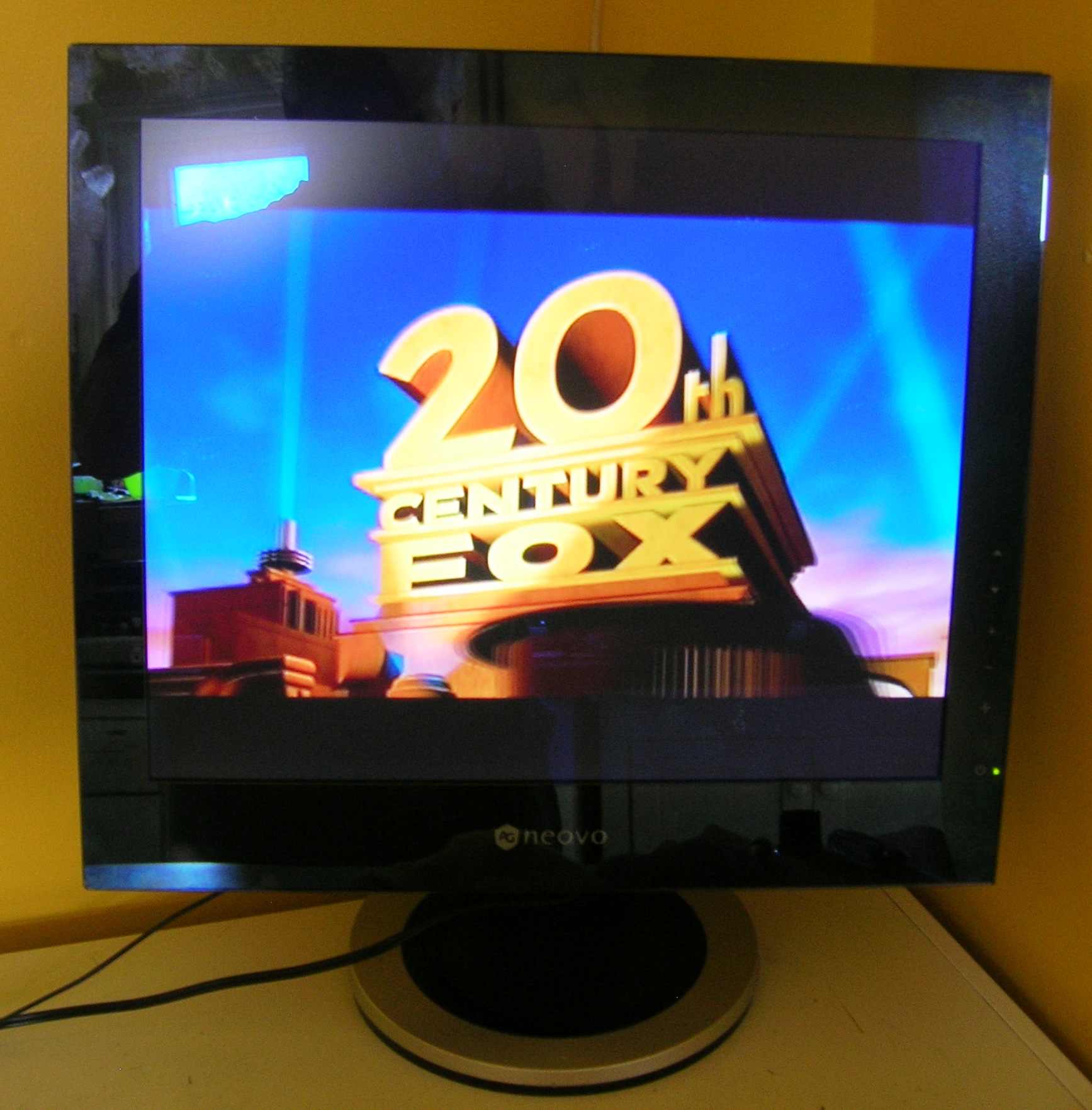

                          Re: AG Neovo X-17A
                          HI all update on this iit is now working
                          Replaced U801 and was rewarded with power light and no signal reading on the screen .
                          This unit has s-video and composite as well which are both working and vga and dvi inputs working .
                          Also had to replace a fuse and cap on the inverter .
                          Parts replaced
                          Q801 used a TPC8104
                          U801 used a AIC 1578
                          2 x SS14 Diodes
                          ZD801 used a 6.3v zener diode
                          And while opened up i changed 1 16v 470uf and 3 x 1000uf 10v on the power input side.
                          I have had it running now for about 12 hours using a dvd player via the s-vid connection with no problems .
                          Thanks to all for the inputs and advice have attached a pic of it working
