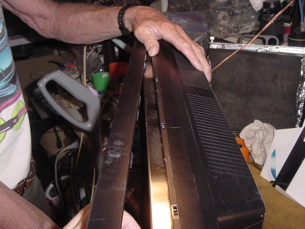

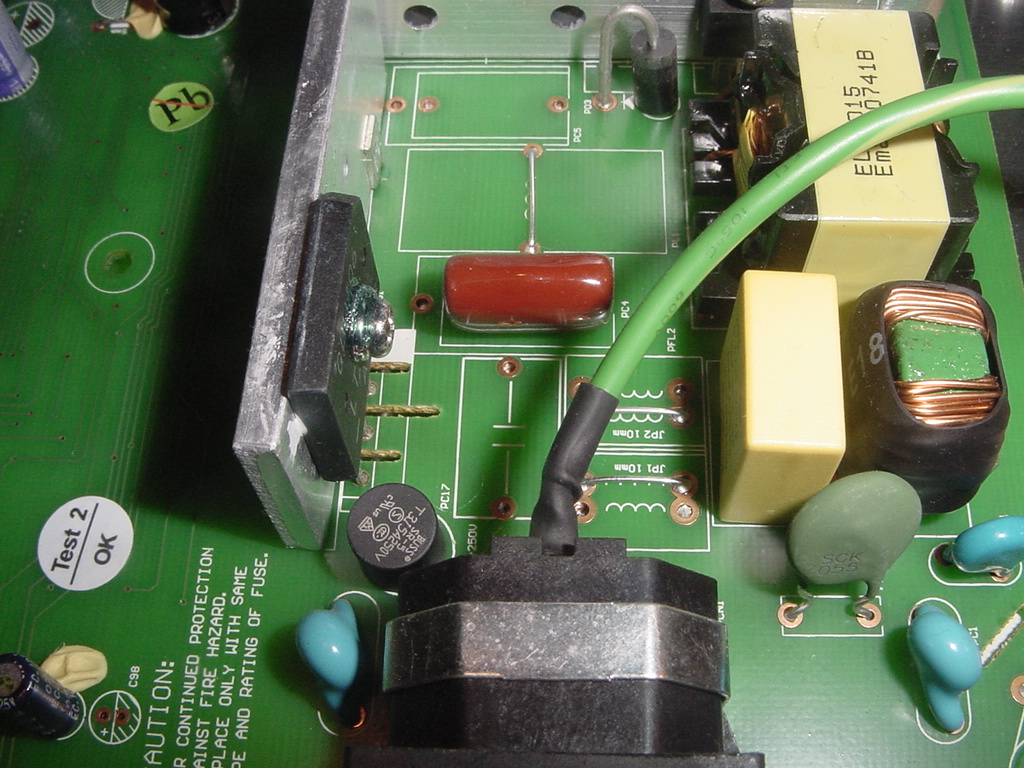

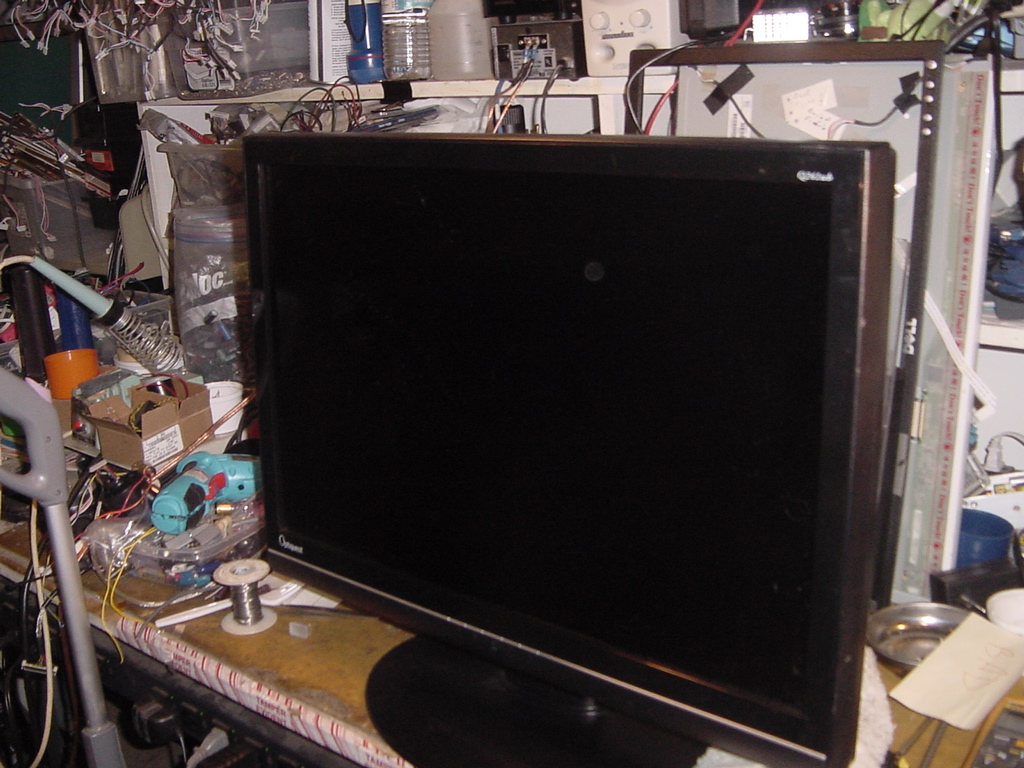

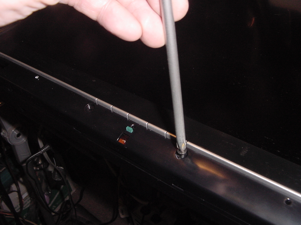

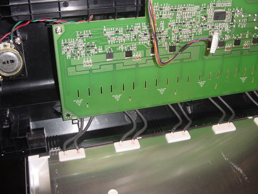

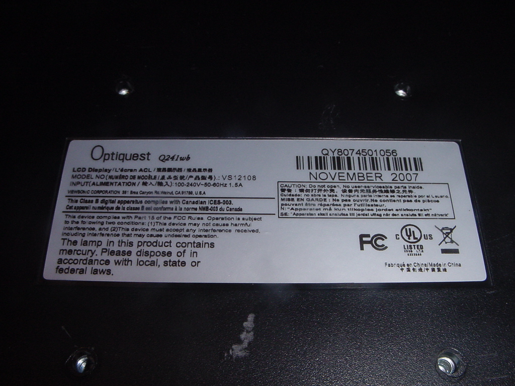

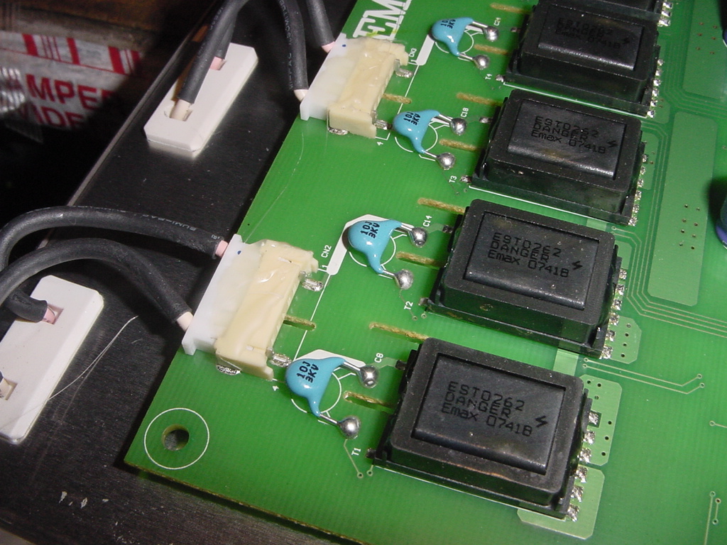

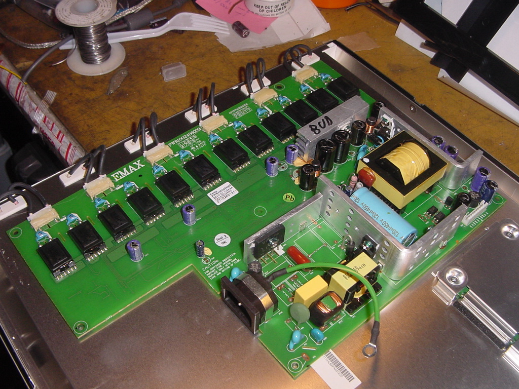

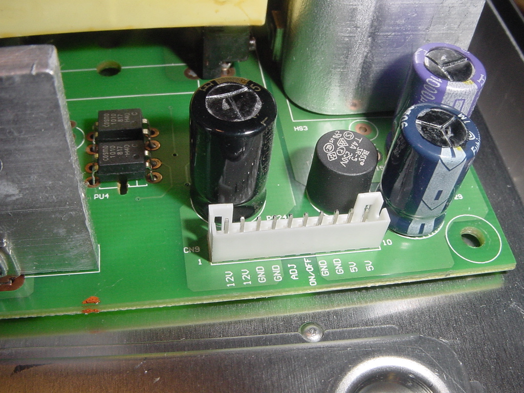

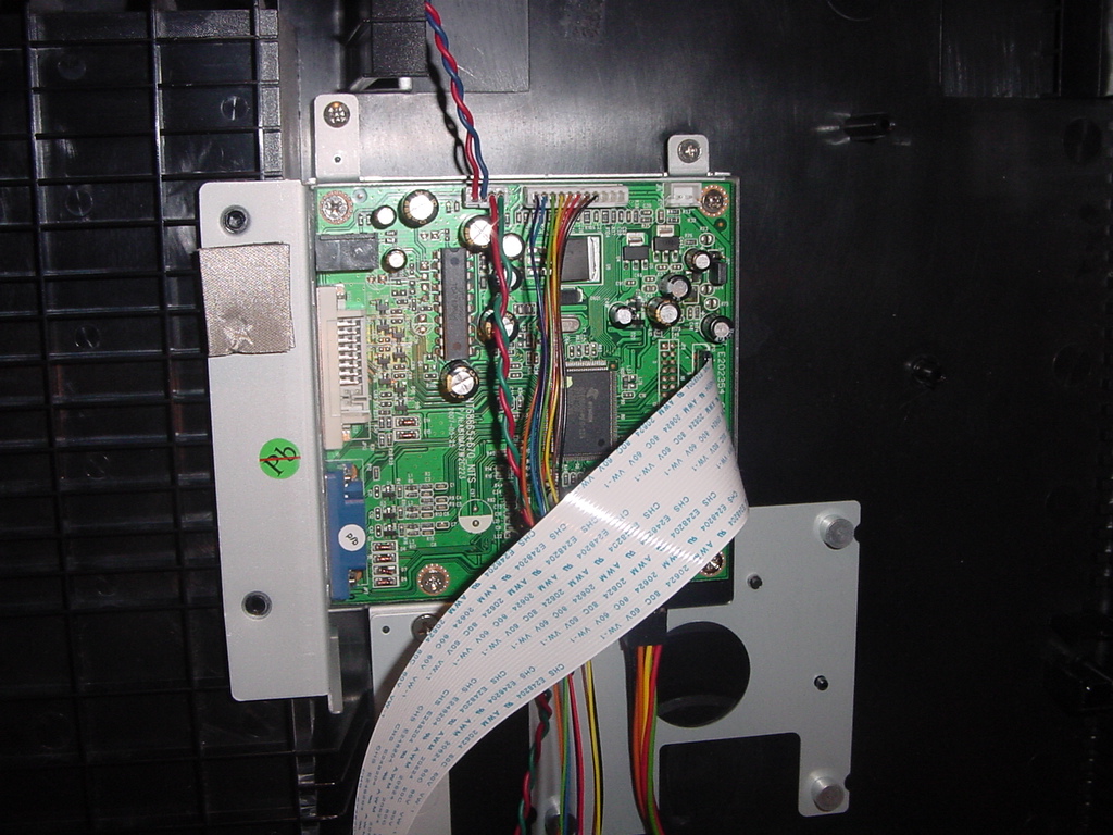

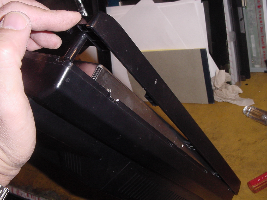

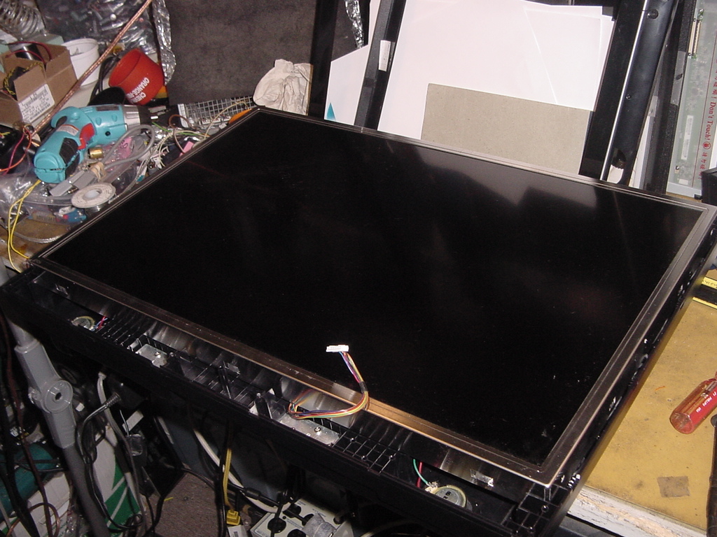

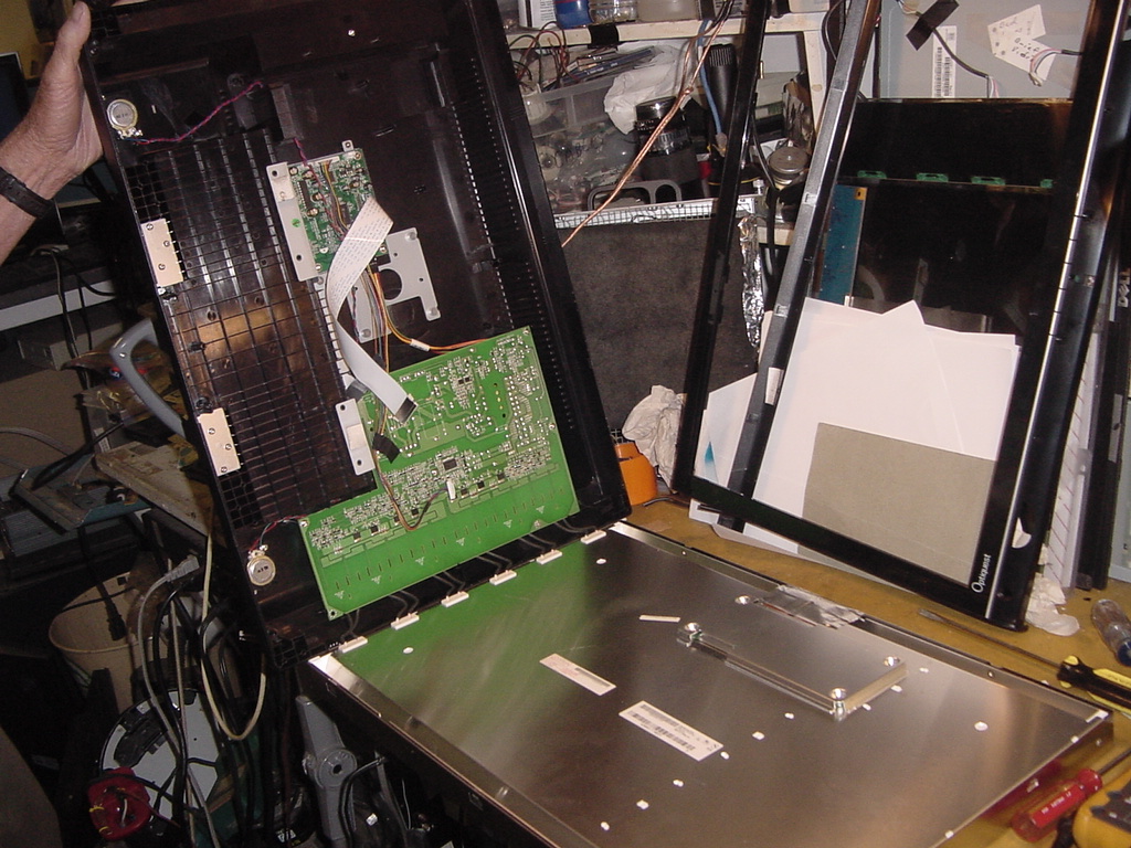

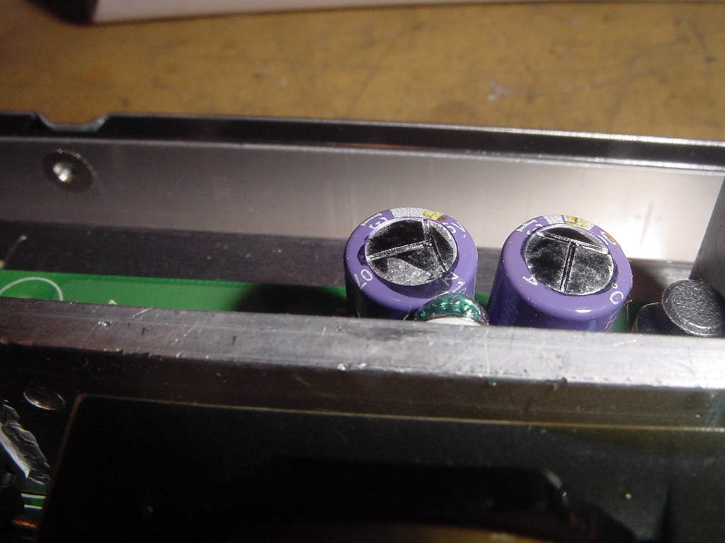

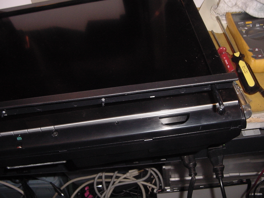

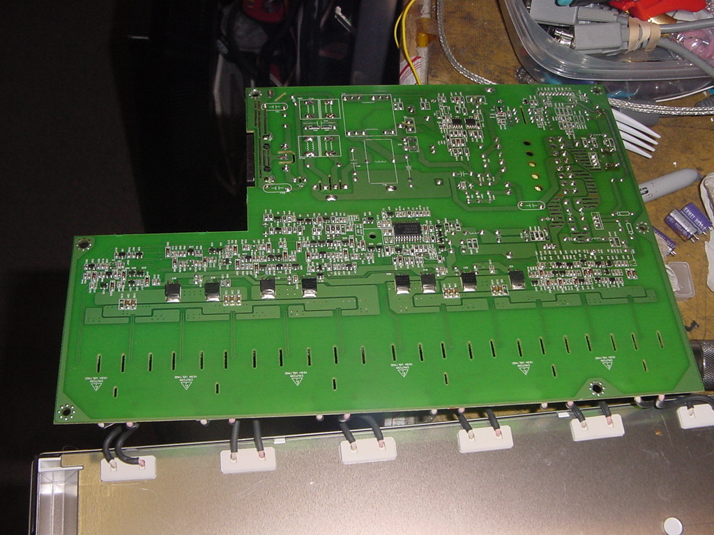

    This is must be one of the worst design as far as for putting it together or taking apart. Wires are so short, it takes two people to get this thing apart without breaking the lamps wire, the plugs for the lamps are glued down. I worked on many monitors, this is one of the worst. It is 24" screen so I had to be real careful not to damage it. It has bad caps.

    Viewsonic must take all their rejected designs and give them to Optiquest.
