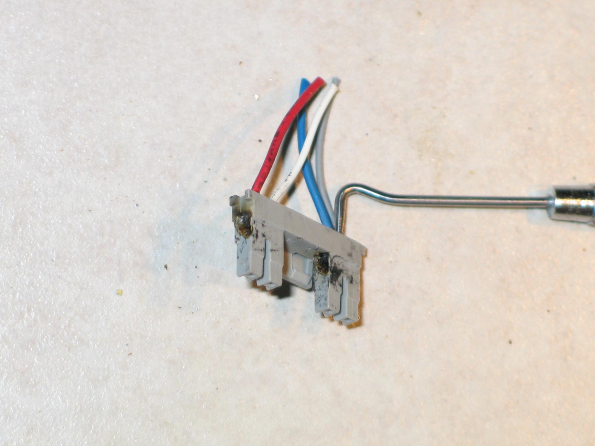

                    Good Morning,
                    I just went through the same issue with the same monitor. The unit would shut down after a second or two. It produced a easily audible buzzing, and a very noticeable stench. Upon opening the monitor, I found that there was arcing from the CCFL inverter connector (attached to the CCFL). The current was so high that it melted a hole in the connector, followed a path back out of the receiving connector (female, mounted to the power board) and was shorting to one of the grounding pins.
                    I disassembled the LCD panel so I could view the lamps and retested. I noticed one of the CCFL's was dark, the second in the pair (this panel has 4 lamps, 2 top and 2 bottom) just flickered. I temporarily replaced the faulty CCFLs with a couple I had lying around from an LCD TV. When I applied power again, the lamps lit up, but went out after a couple of seconds. The arcing was still an issue. I verified that the board mounted receiving connector wasn't damaged, but the male wire-end connector was scorched and had a hole melted through the side of it. I couldn't find replacements for the 4-pin connector, but realized that it was just to of the standard 2-pin connectors bridged together to form a single connector. I took a known bad panel (cracked screen) and cut off the connectors. I soldered the two of them in place of the single connector. Hooked everything up and applied power again. This time the lamps lit and stayed lit.
                    I measured the CCFLs that I had removed and they measured 520mm from end of glass to end of glass, not end of connector to end of connector. That may be where the extra 15mm is coming from to get the 535mm. I'll double check tonight before I place an order. I have found 520mm lamps on Ebay. They are the 2.6mm versions. I have emailed the seller for more information as well (he's asking $10ea. + 4.99 shipping).
                    I also found that ccfldirect has a kit to replace all four lamps for $24.99 + $3.99 shipping. I think it makes sense to spend the extra $10. This seems to be a fairly common problem, and to have to do this fix again would cost more than the kit.
                    Good luck with your repair! I'll try to post a couple of photos of that connector later tonight.
                    P.S. I have to say this just to make me feel better. I picked this monitor up at a yard sale along with an HP wireless all-in-one for $5. Cha-ching!
                    -Grant

                      Re: hp w2338h issue
                      Here's a closeup of the connector

                            OK, I got the 520mm lamps in yesterday, and they are very close, maybe a millimeter or two long. But now, when I have all four lamps wired in, I get two that light brightly, and two that are a bit dimmer. they appear to attempt to come up to full brightness, then they all go out. I need to do some swapping around to see if I can pinpoint the issue.

                                  Re: hp w2338h issue
                                  Are the connectors in good condition (the one you have shown in the picture)? The ballast caps are OK?

                                      I replaced both of the double connectors with four single (standard) connectors. I have the lamps wired up with jumpers right now, not soldered, to allow me to easily switch the lamps around. Could that be causing a problem? I didn't get a chance to work on them last night, but I plan to do some testing tonight. However, I don't think it's the lamps as I can swap them around and the result is the same. Is it possible that the new lamps have a different rating than the originals, therefore the inverters are sensing something out-of-range?
