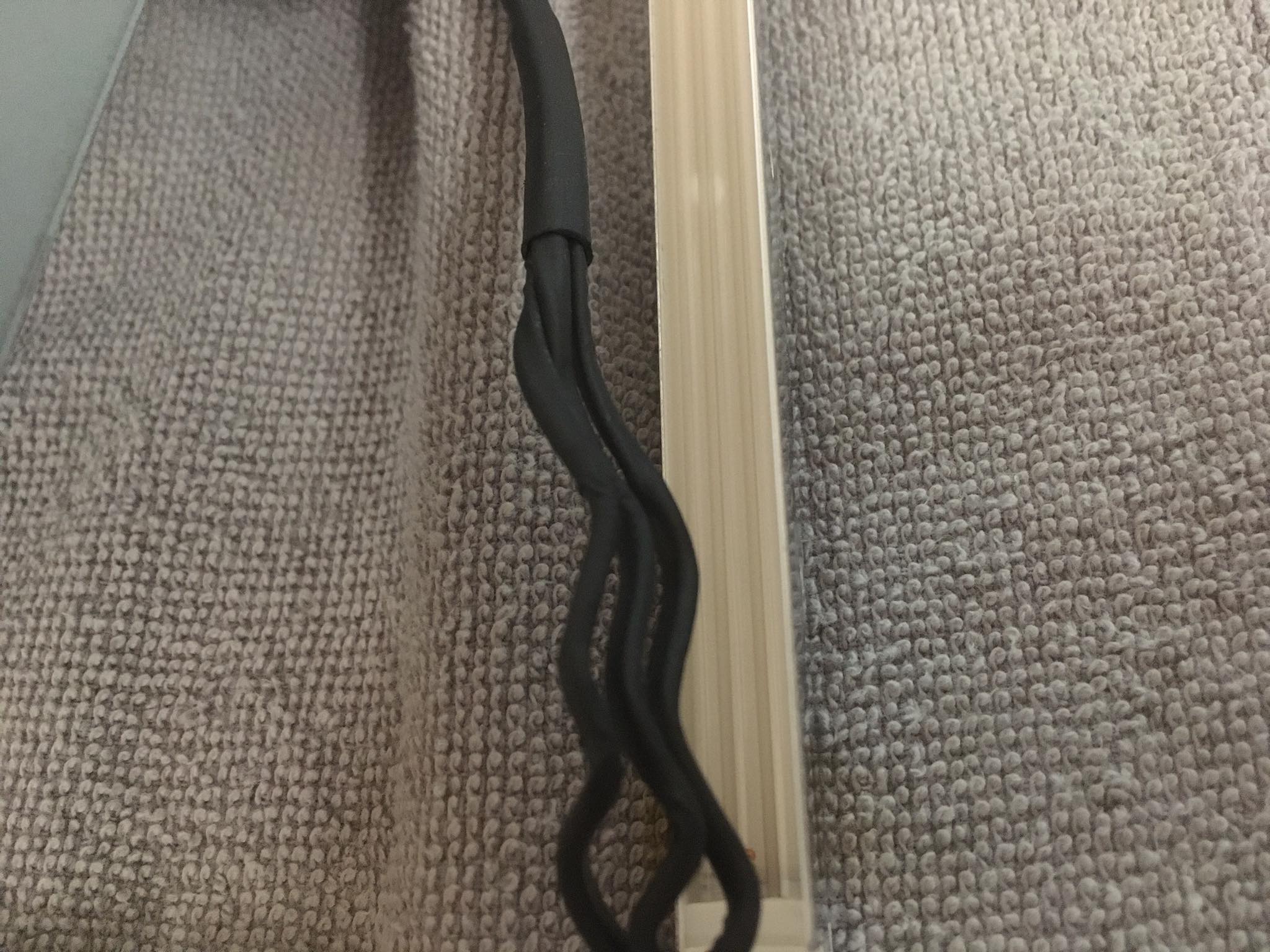

                                  i think this is an appropriate thread for this because i teared down this monitor even more. i bought it used and after over 50k hours it got rather dark. it doesn't look that bad compared to my 2009 lg tv with less hours but using it during the day can get irritating and it's way darker than my new cheapo 250cd/m2 monitor.
                                  i've seen people replacing the ccfl lamps with leds but connecting that to the board can get complicated and the colors looked off in the video so i would rather not do that.
                                  i found a website selling those lamps but i'm not sure if they aren't scamming people.
                                  https://lcdpartsdirect.com/product/4...creen-monitor/
                                  are 4 lights instead of original 6 enough ?
                                  are they really going to ship them to europe for 4 dollars ?
                                  also, i have another question. should i be able to see this display without backlight while lighting it from the top ? i took both modules off and i can't see anything but everything else works as normal.
                                  edit
                                  After further testing the display is still working, i had to lit it from the back which required talking off the rim again. Now that i know i didn't break it i can buy the backlight. I'm still not sure about that store, i would be grateful for any help with that.
                                  btw. i've never seen diffusion layer(?) that thick. i can take more photos when i put it back together
                                  • Behemot
                                    • 4845
                                    • CZ
                                    #117
                                    Re: Dell 2007FPB teardown
                                    Many 20" displays do have such thick diff plastic and 6 tubes.

                                        • migra100
                                          • May 2021
                                          • 2
                                          • poland
                                          #120
                                          my lights from lcdpartsdirect arrived. i had some trouble soldering them so i only did one part before testing. it's hard to tell but the old ones and the new ones look about as bright. i really hope that isn't the case because the dell before taking it apart looked like the 92cd/m2 crt i've bought recently and that's not a good score for bulbs that claim to be brighter than original in an 300cd/m2 display
