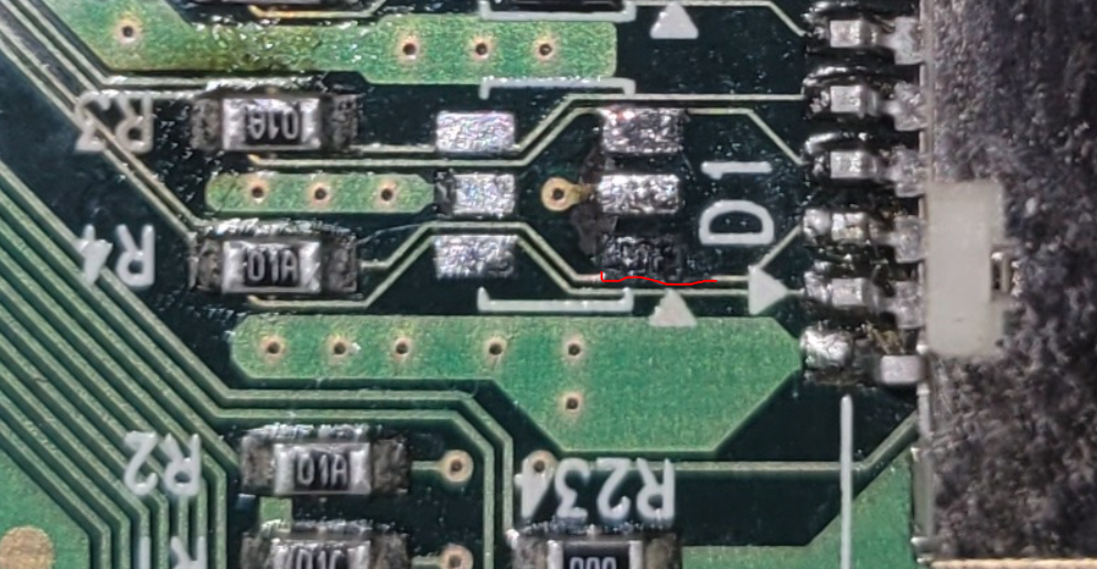

    Hi All, I need help identifying a replacement for D1 (same as D2 through D5) on the Dell 2007FPB board please? The board ID is an LG Philips LM201W01-SLC1-F11. Thank you for any help! It popped under power while troubleshooting, oops!

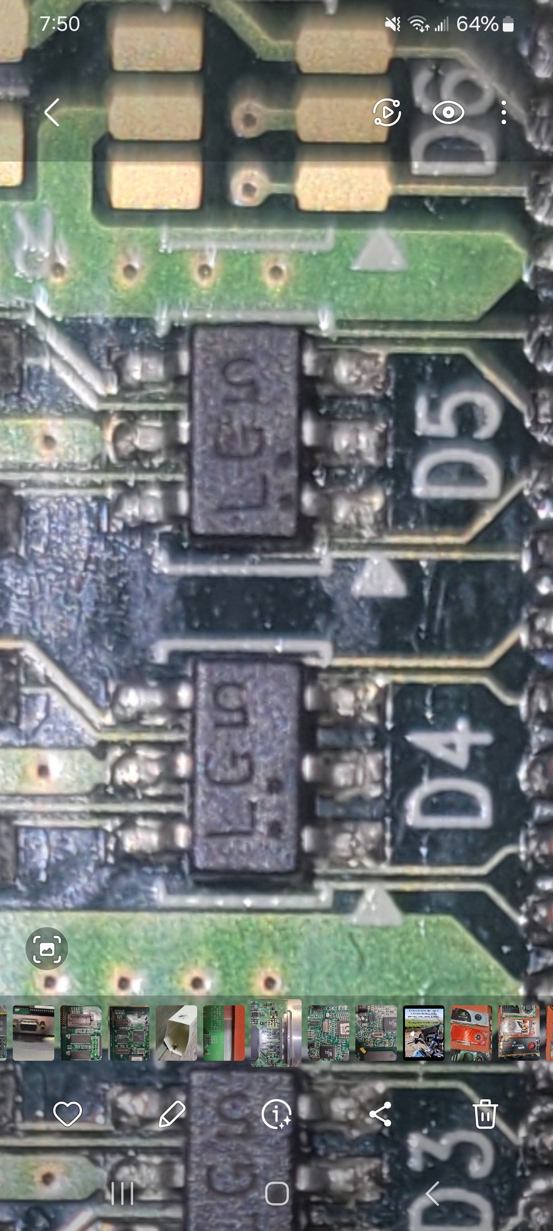

    I forgot the most important photo.

      DALC208SC6
      This is a protective diode assembly, try without it, the main thing is to check if the track is damaged.

        Thank you lotas! I have fixed the trace to continue the troubleshooting. I have flashing power LED, 1 and 4 on the bezel with no output. Appreciate your help on finding that component. How did you identify from the markings what it was? Or is that just experience? thanks again!

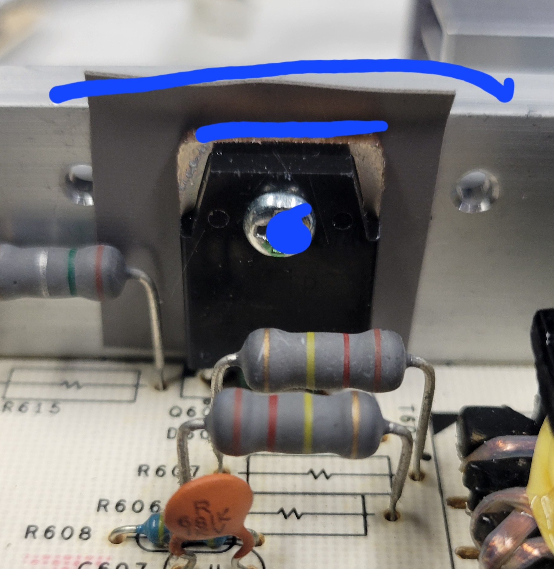

          following this thread and testing components, I have 45-56 volts AC where i should have DC volts? Not sure what happened? I removed to test this component and I'm not sure if it's supposed to ground to the heatsink? https://www.badcaps.net/forum/troubl...blinking/page2
