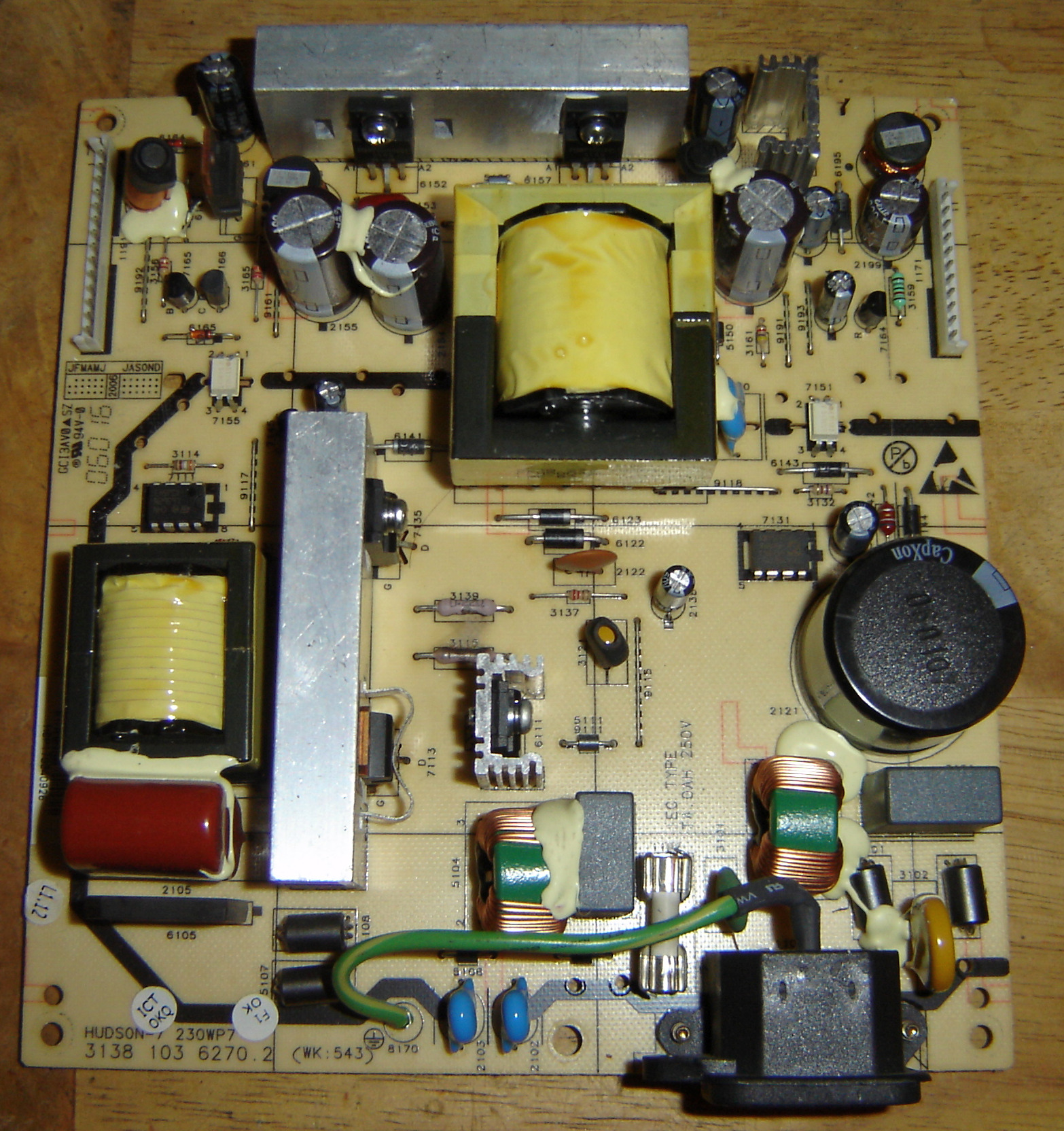

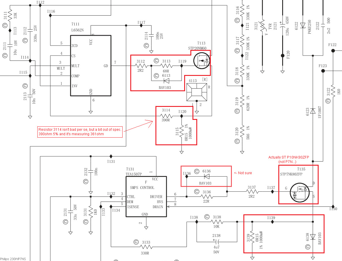

    Got one of these for next to nothing. Previous owner said he got it from a friend and after a couple months it just didn't turn on anymore (completely dead).
    PSU board is shot. What I've been able to diagnose so far:
    - one primary side MOSFET is completely shorted (0 ohms on all pins)
    - the other primary side MOSFET is completely open
    - 1 resistor close to them "exploded" (lost part of the outer casing)
    - another resistor below the above one is shorted (and was covered in soot)
    - 4 amp mains fuse is open
    Apart from one tiny Capxon (what else), none of the caps are bulging, even though they're all junk brands (Capxon KF/KM and Elite EB/PF). I expected much better from a monitor that retailed for 900 USD or more when it was new..
    I'm not very experienced when it comes to fixing up the primary side of power supplies, so I kinda need help here. In a scenario like this, are there other components that are likely to be bad? If so, which parts would that be?
    I'm suspecting the SMPS controller IC (Philips/NXP TEA1507P) could be damaged as well, but I don't know for sure (and much less how to test it in this situation).
    As this is a 23" 1920x1200 LCD monitor with a S-IPS panel, I wouldn't mind spending a couple more bucks on fixing it than usual.
    One thing that annoys me a bit is that the pin headers (to the inverter and the mainboard) aren't labeled at all apart from the pin count, so I'll have to look at the SM all the time..
    Talking about service manuals.. I managed to find a sort of incomplete one. The PSU diagram is there but the PCB shot is useless as it's a regular image (think JPG), not a vector graphic. When will people learn to create proper PDFs!?
    "Servicemanual" (almost 13MB)
    https://cdn.badcaps-static.com/pdfs/...0af21ab69b.pdf
    PSU board diagram is on page 10, the almost useless PCB shot on page 11 (blurry mess)
    There are a few inconsistencies between the PDF and what's on my PSU board though, which doesn't make this any easier I think.

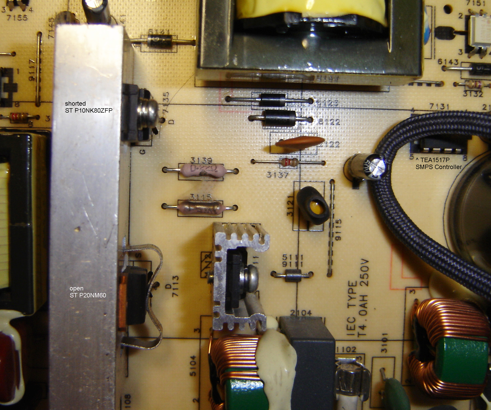

    The completely shorted MOSFET is marked 7135 on the PCB (and in the manual), and is a ST P10NK80ZFP (800V, 0.78ohm, 9A), whereas in the manual it's a P7NK80ZFP (800V, 1.5ohm, 5.2A)
    The open one is marked 7113 on the PCB and is a ST P20NM60 (matches the manual).
    More inconsistencies with the resistors next to them. The one that "blew up" was still readable, and said 0.22 ohm. It's marked 3139 on the PCB. The manual however says that's supposed to be a 0.15 ohm (1W 1%) resistor.
    The other resistor below that one (marked 3115 on the PCB) was covered in soot from it's blown up brother, and my attempt at cleaning proved to be a little bit too effective, as I wiped the markings off as well
    According to the manual that's also supposed to be 0.15 ohm (1W 1%)
    The SMPS controller IC, which might or might not be damaged due to the blown-up parts is a Philips/NXP TEA1517P.

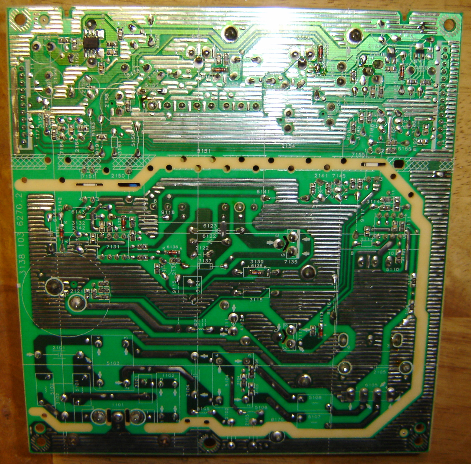

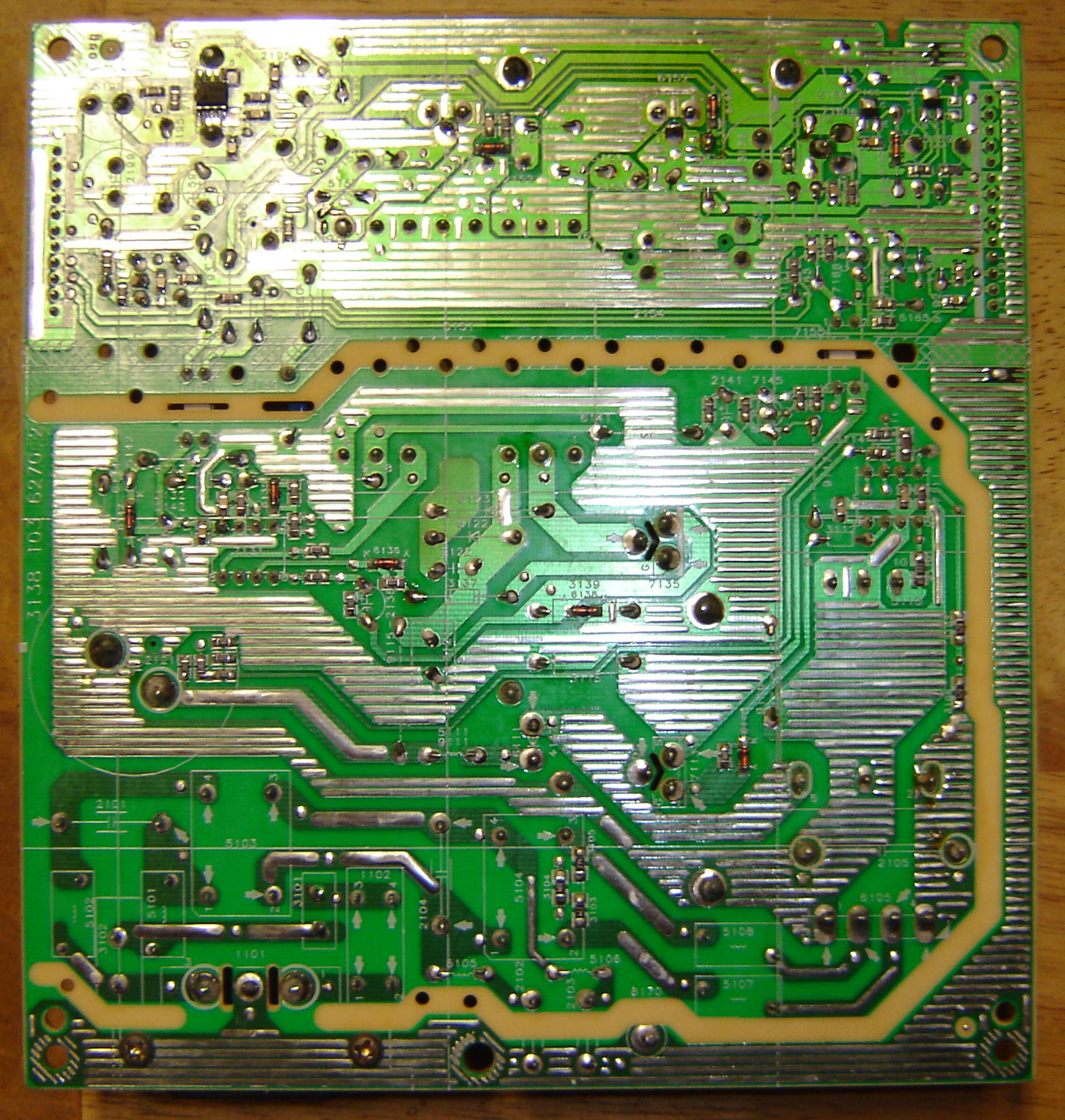

    I've attached all the datasheets to this post, as well as a bunch of photos from before desoldering parts to check them out of circuit.
    Sorry for the bad solder-side photos.. the huge ground traces with solder on them didn't really help with their reflections. I'll try to take some better ones later
    So.. what do you suggest checking apart from the bad parts I already found? Should I just go ahead and order the parts as per the manual and hope it doesn't end in fireworks..?
    I would check the bridge rectifier for shorts even though it might be okay.
    Try a resistance test between GND (pin 2) and every other pin. That is, 1-2, 3-2, 4-2, 5-2, 6-2, 7-2, and 8-2.
    I would test all the diodes to see if any are shorted.

      The bridge rectifier (GBU6J ; 6A) tested OK. I'll check the TEA1517P and the diodes near the MOSFET graveyard tomorr..err.. today, as it's 12:30 AM here right now. I already found a little general purpose SMD diode (PCB marking 6138 ; a "BAV103") on the solder side of the PCB across the blown up resistor to be open when testing around earlier.
      RS-Components seems to have both MOSFETs and the SMPS controller in stock, so I guess I'll buy from there (free shipping and no need to worry about china fakes )
      The only thing that still puzzles me are the two resistors (0.15ohm in the manual vs. 0.22ohm on the actual board..)

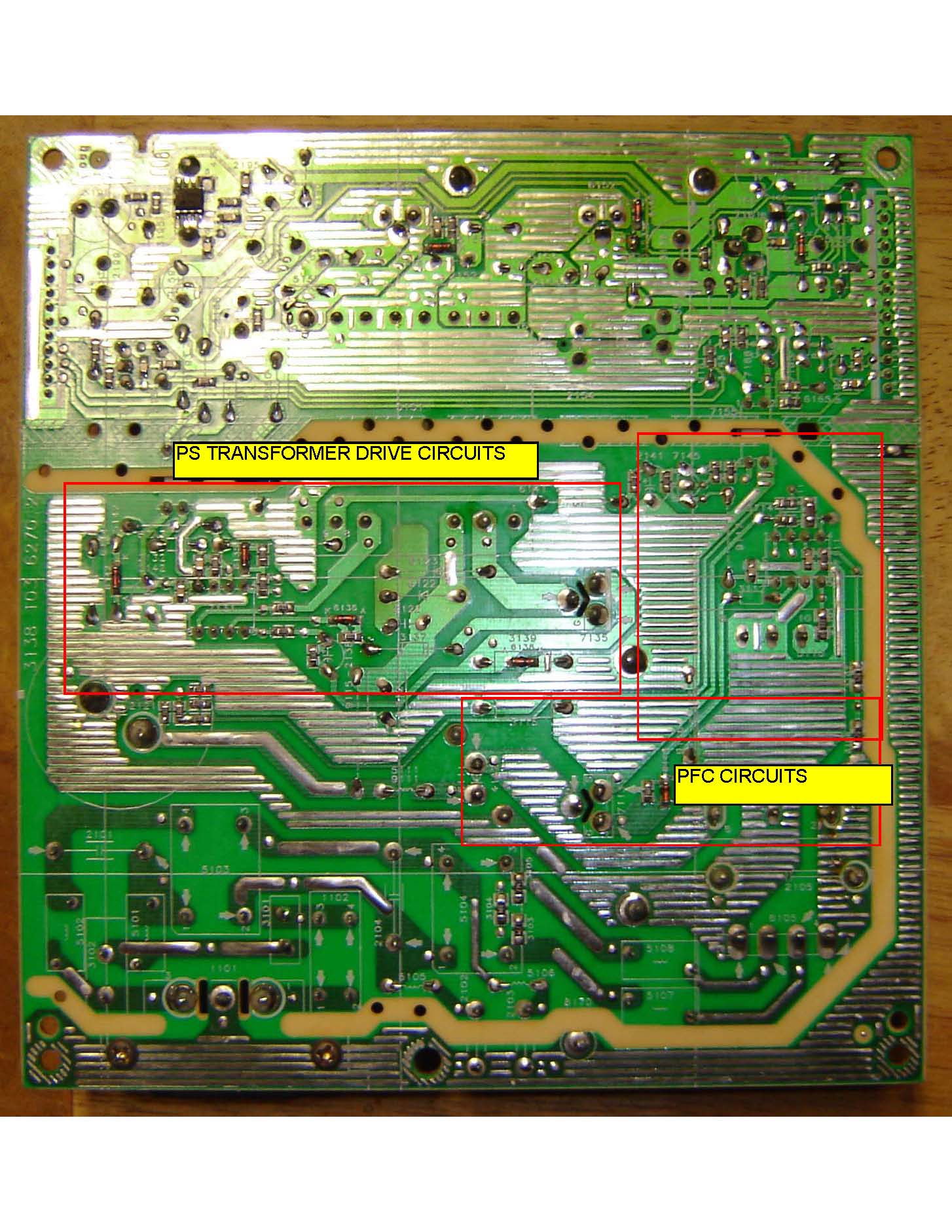

        Re: Philips 230WP7NS Professional Series LCD
        If they use 0.22 Ohms instead of 0.15 Ohms for the MOSFETs Source resistor, it means that the over current trip point is lower when use higher resistance since it will take less current to develop voltage on the higher Ohm resistor for the Over current feedback to the SMPS IC PIN, thus it will shutdown at lower over current trip point than the one that use the 0.15 Ohm resistor.
        And one thing when MOSFET shorted out, it may have taken out the output drive circuits of the SMPS IC, the Diode and resistors that are connected to the Gtae of the MOSFET'S with it also.
        From the look of the board, it does not have standby power supply that I can see, it does have PFC circuits. And yes, those resistors are for the Source resistors, one (3115) for the PFC MOSFET, one (3139) for the main power supply MOSFET.

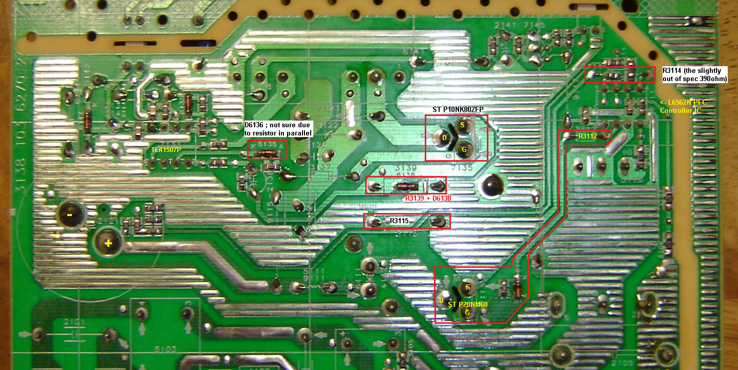

            Allrighty.. Checked all the diodes I could find on the primary side. Found a few bad ones along with a few resistors (see attached pic.. stuff in the red boxes is bad)
            I also tried to mark the same parts on the actual photo of the backside of the PCB. Hopefully not too much of a mess to follow..
            I'm getting some readings on the SMPS controller IC and no pin appears to be shorted to ground. Good sign I guess. Same goes for the PFC controller IC (ST L6562N).
            I also noticed that I used the wrong model number for the SMPS controller IC throughout all my previous posts. It's a TEA1507P, not TEA1517P as I wrote before for whatever reason
            I'll go ahead and order the parts from RS, including the SMPS and PFC controller ICs (just in case.. both ICs combined cost less than each of the MOSFETs..)

                                      If that Capxon that bulged was for the Vcc for the controller IC, it could have caused the controller to go a little crazy (for example, keeping the gate high due to latch up) and damage the MOSFETs.
