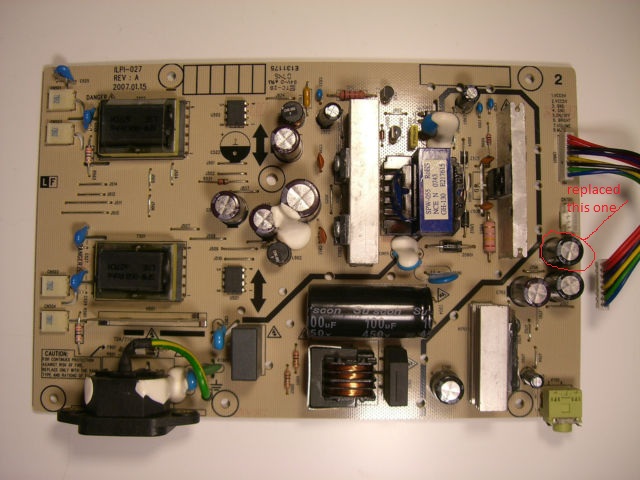

    hp w1907 would not power on,replaced the 16v 470uf cap because it was leaking,but the one i ordered was smaller in size.Will the smaller one work for me?

    Sometimes other brands might be thinner but taller. As long as you have the correct capacitance and voltage then you should be ok.
    What make did you order?

      rubycon the one that was pulled out was a su'scon

        What series of Rubycon?
        As with any manufacturer, they produce various series, some more general purpose and not really recommended for power supplies...

          ok i installed the rubycon and it powered up but picture is destorted with no black

            You might have other capacitors going bad but not yet swollen or visibly bad. Also, the cable that connects the video board to the LCD might be improperly attached.
            Check it, and post pictures with the boards as clear as possible if you can.

                What series of Rubycon capacitor did you use? For example, you get Rubycon ZL(H/G/J) and YXF/G which are good for an LCD monitor. But you also get Rubycon YK, for example, which is -not- suitable.

                  my bad the new one was a Nichicon HN 16v 470uF and just replaced the one beside the first one and the picture is getting better, now to replace the third one as shown in the picture

                    powers good, works great, one issue,when a black screen is shown,it more red than black.any clues anyone

                      Check again the cable from video board to panel and also whatever cable to connect to the pc - check for bent broken pins - try a different cable
