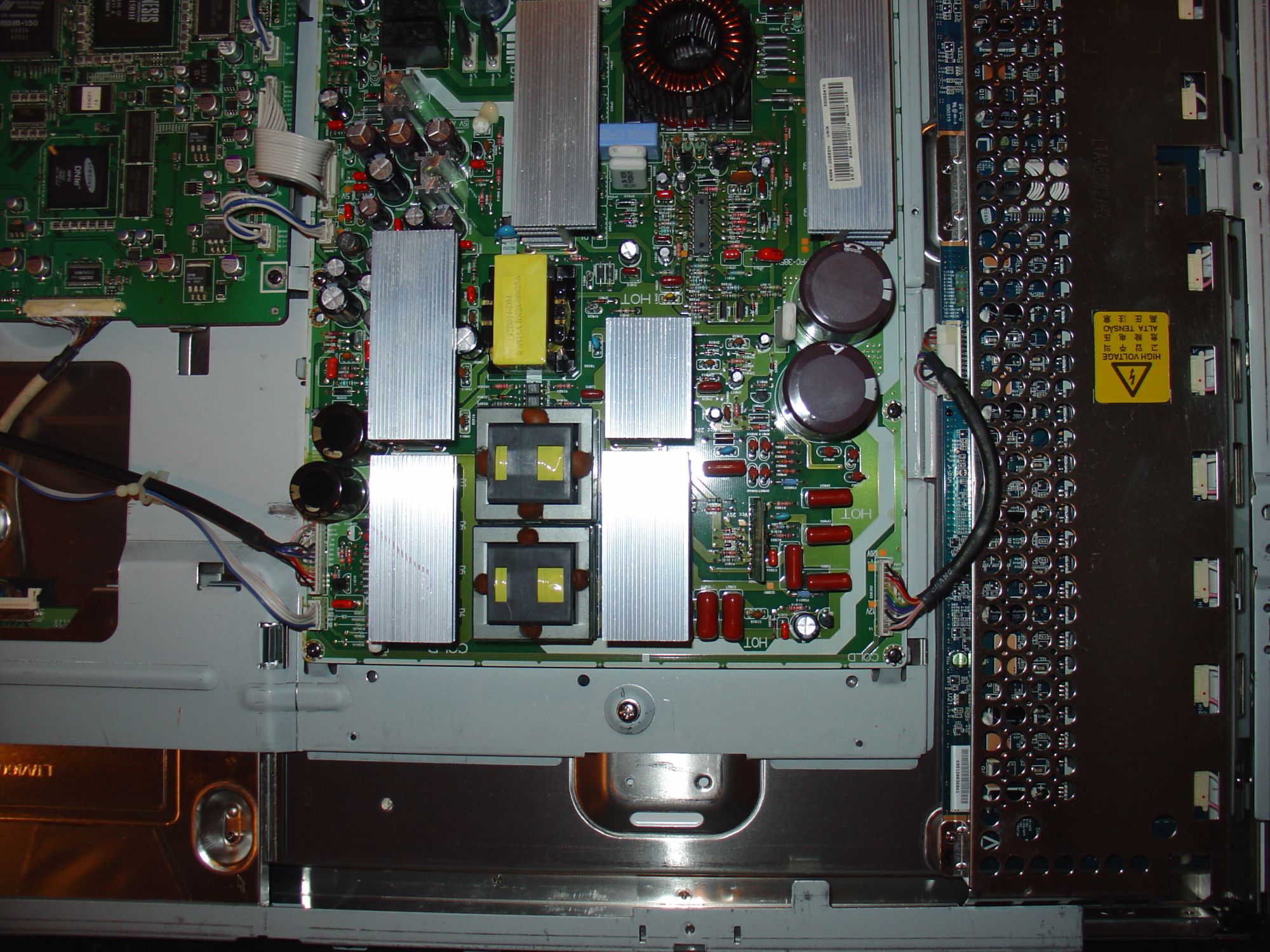

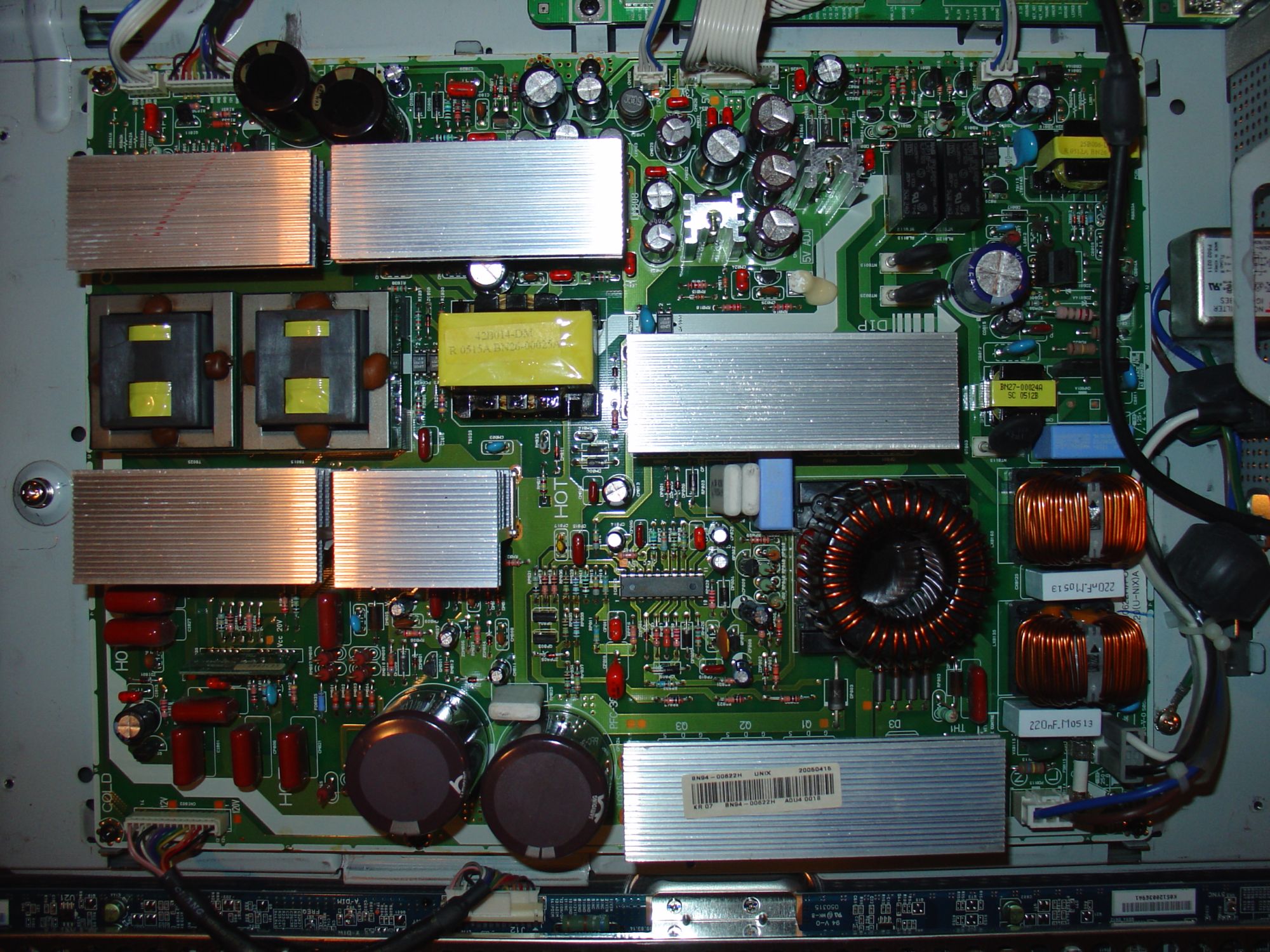

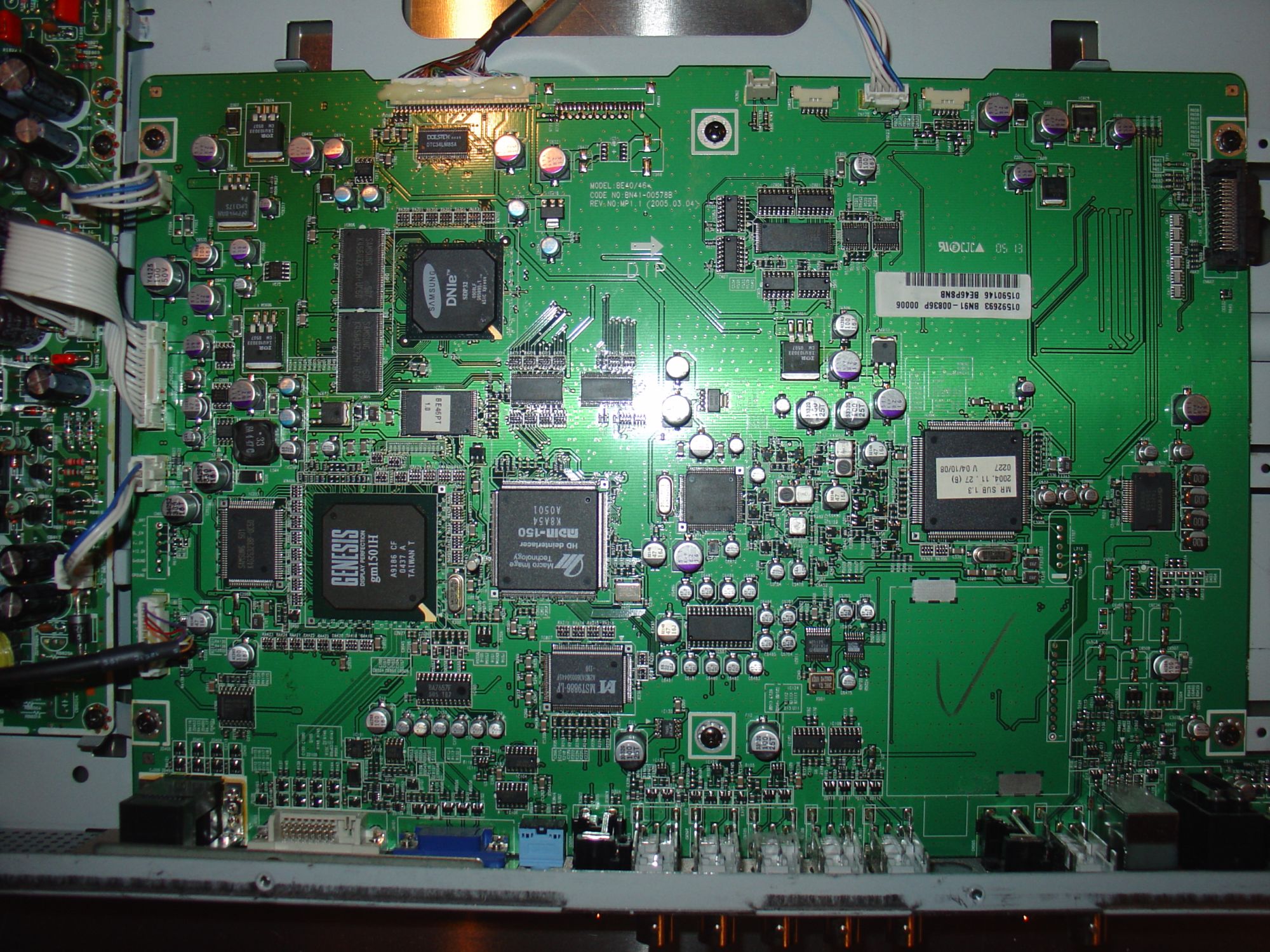

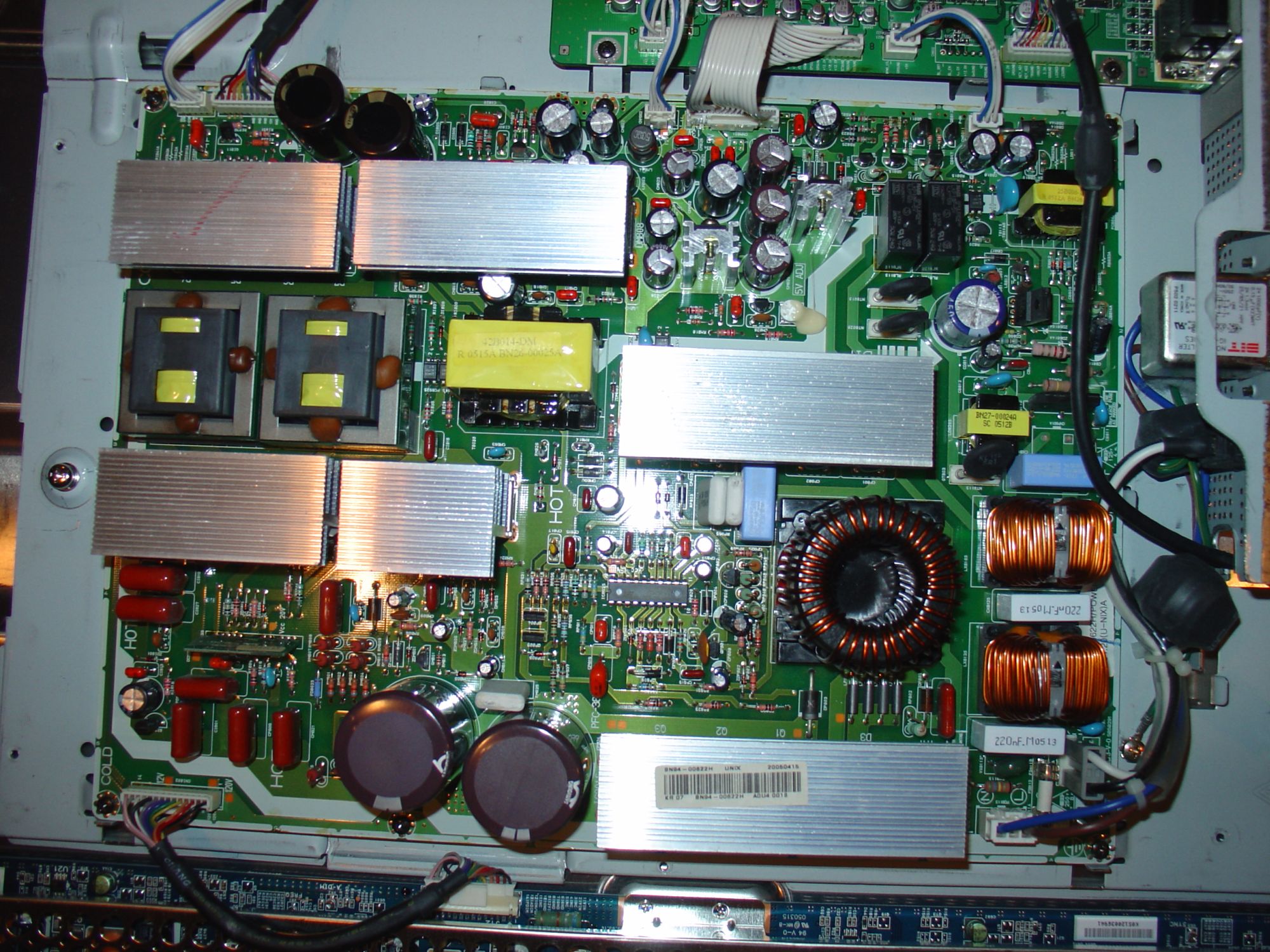

    Can we have some decent pics of the tops and bottoms of both boards added through the manage attachments option please.

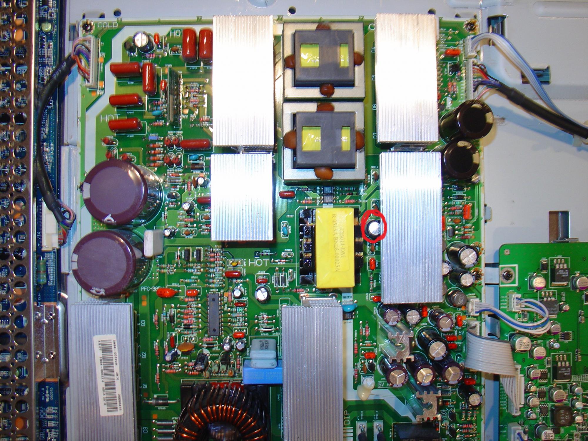

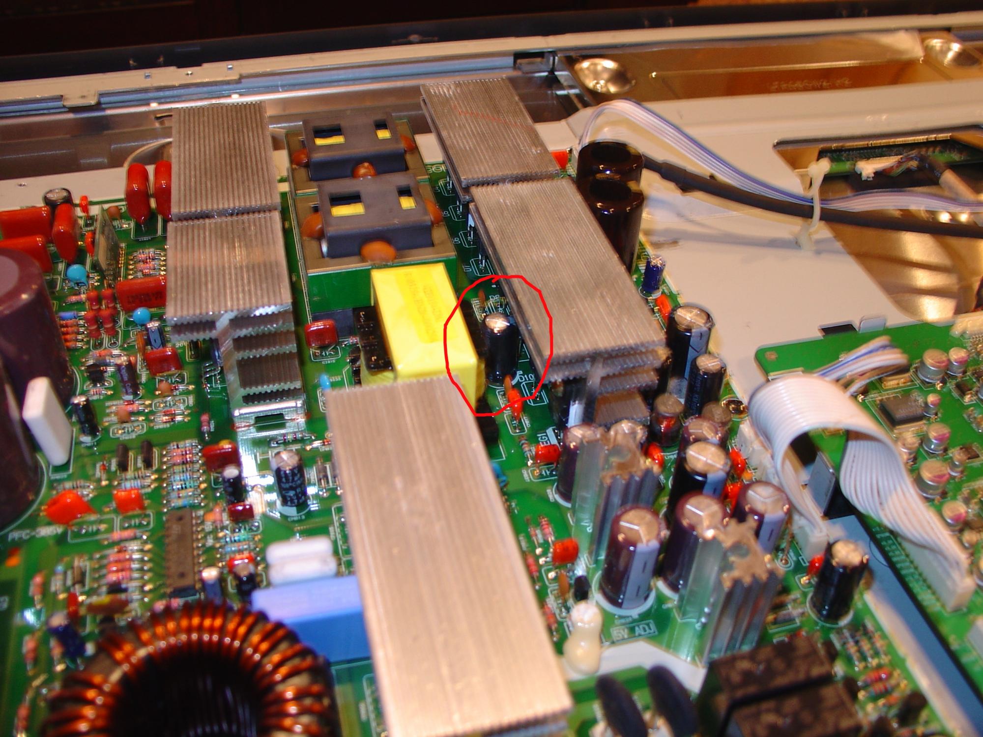

            I am having some issues uploading my photos but I managed to get two uploaded where I have circled a bulging cap. I am going to retake some my photos tonight as some were a littly blurry. All of the boards look fine with no signs of arcing/shorts.
            The caps on the power and driver board seem to be made up of capxon and rubycons.
            I will update once I get better photos.

              As you say the pictures are poor and too small They need to be as near to 2mb as you can get as per retiredcaps post above. The Big Caps seem to be Samyoung which is not brilliant but they are probably ok Capxon tend to fall into the replace on sight category.
              The rubycons are usually ok but if they are old and have been subjected to a lot of heat
              (near/under heatsinks) they will dry out.
                Replace just that cap first and retest. One bad cap will be enough to stop the entire TV from working properly.
                  My pics didnt do that bulging cap justice, it is really domed at the top so I will work on getting ahold of the replacement part. Do you have any recommendations on brand?

                      I replaced the cap that was bulging and no-joy same as before.

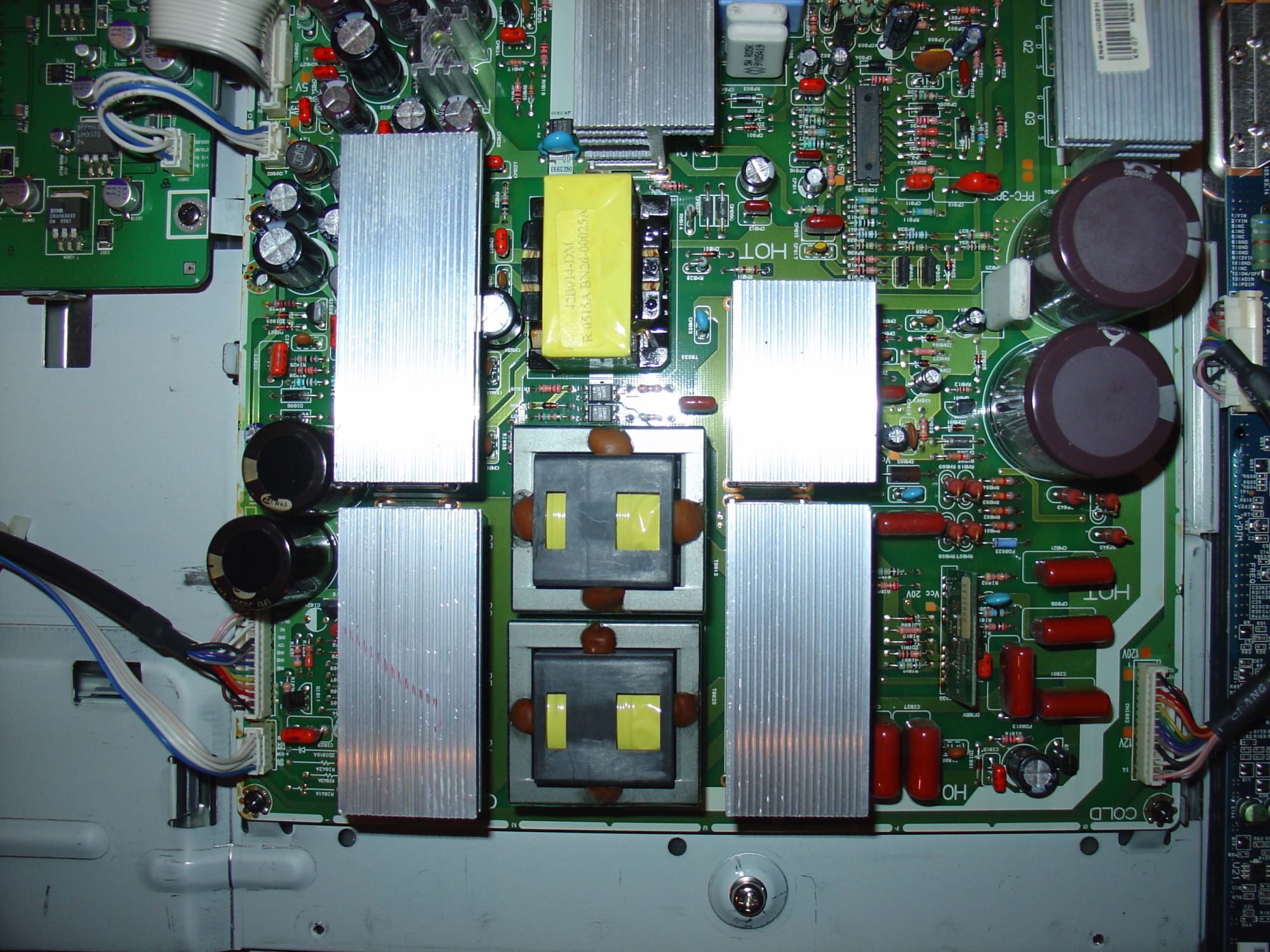

                        Post a clear focused picture of your inverter board.

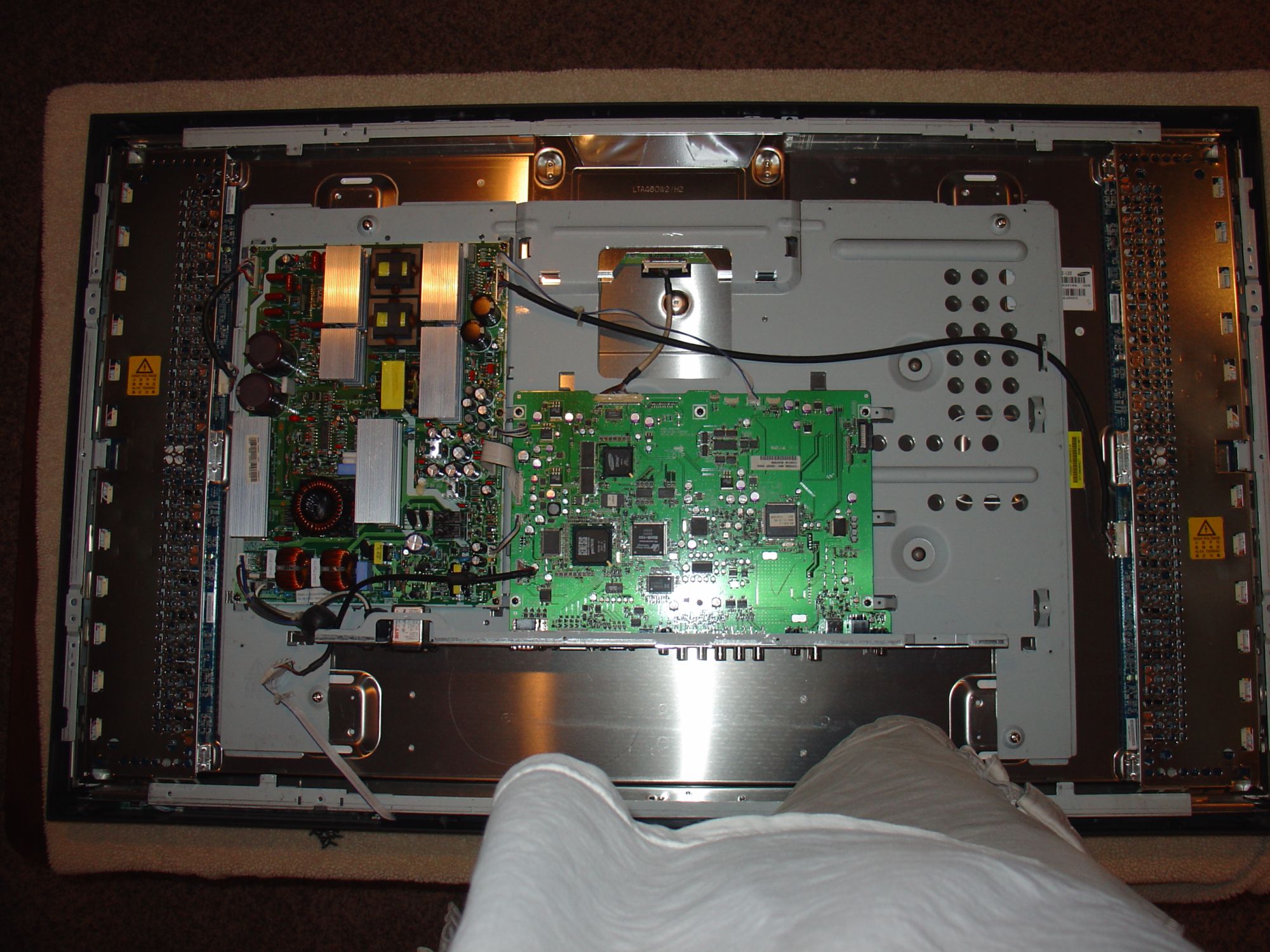

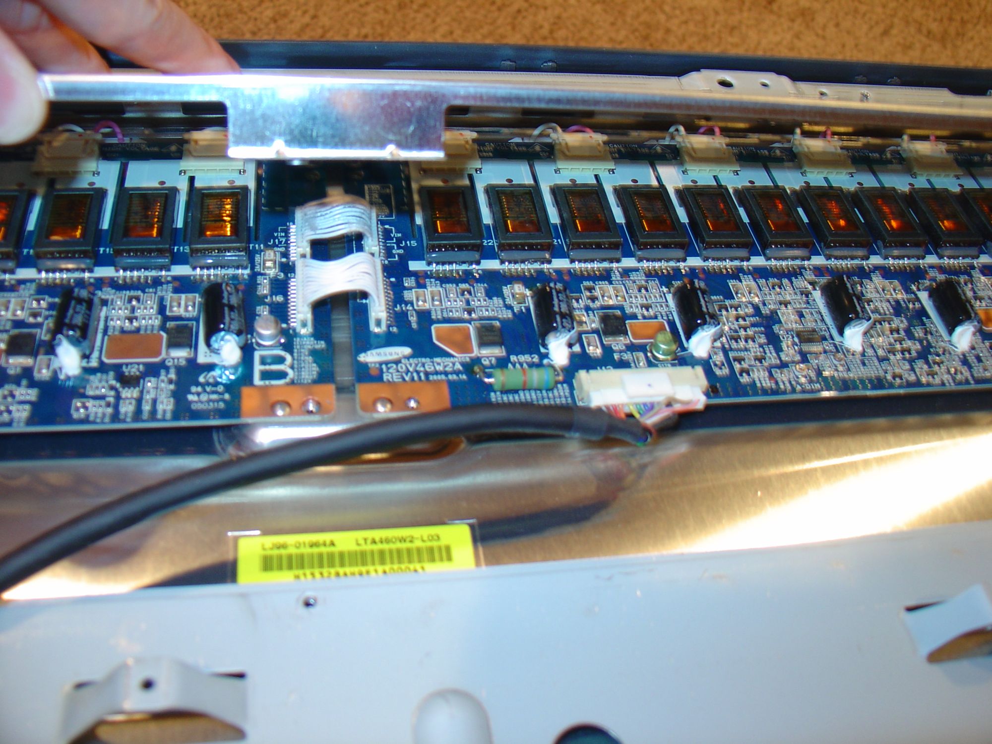

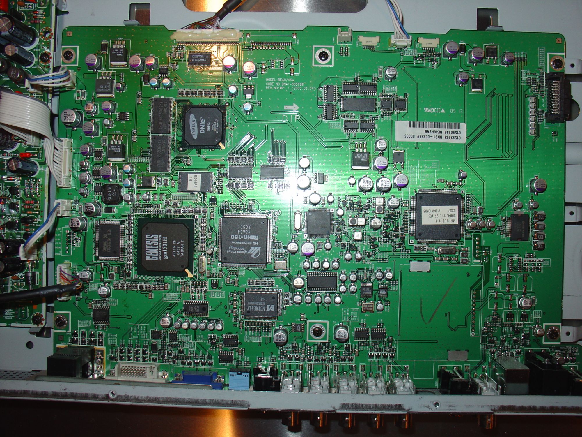

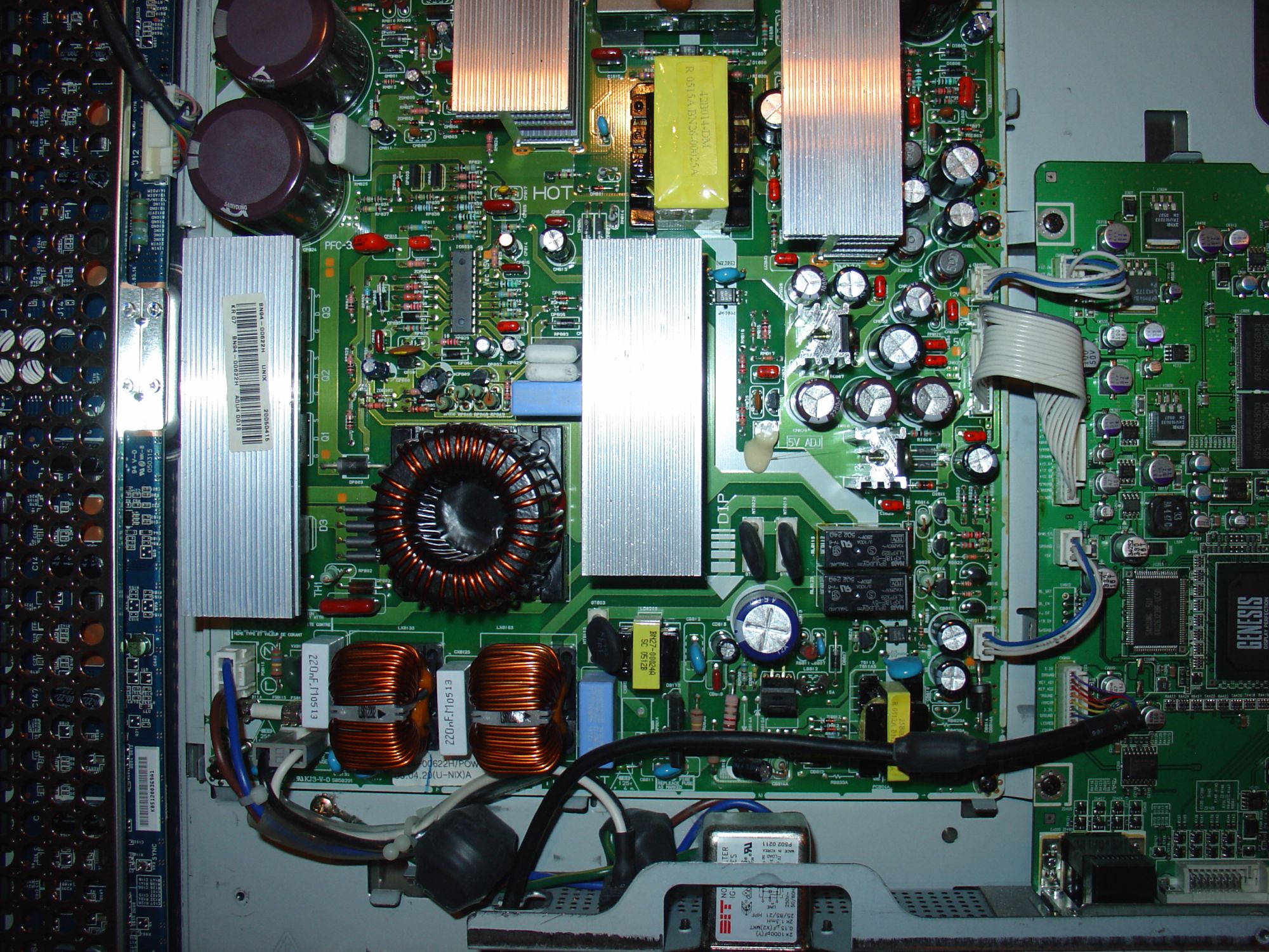

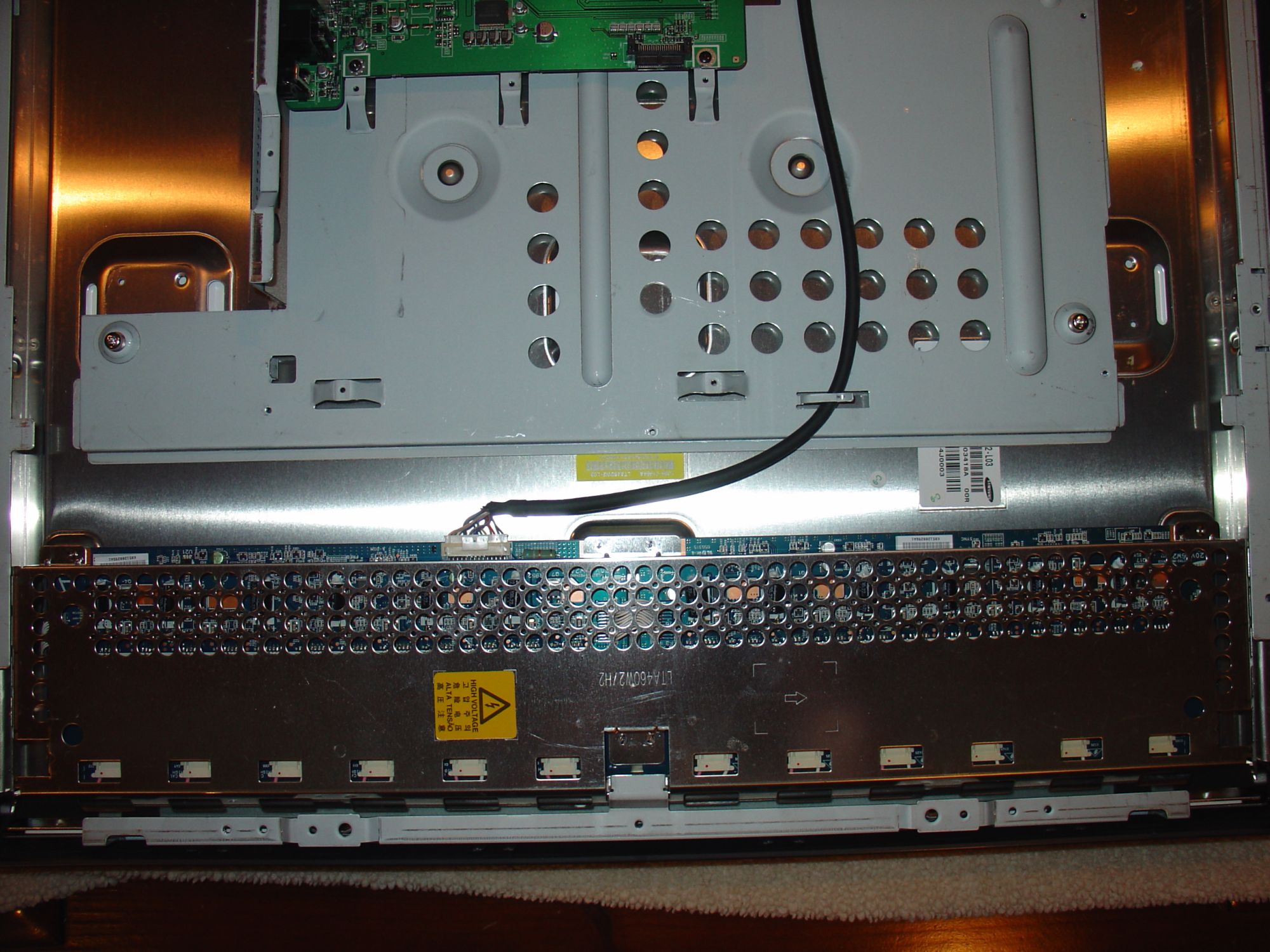

                          I have attached some photos of the boards, I wanted to clarify that it looks like this monitor has left and right inverter boards and there is an A and B board on each side (dsc02913).
                          They are a PITA to remove so if we could trouble shoot the power supply first before removing the inverters, that would be great.
                          Just let me know if I need to post any close ups / certain parts of the boards as I figured out my issue in uploading photos, Thanks to all!!
                            Re: samsung syncmaster 460p black screen
                            I can tell that there are at least 3 fuses on the the inverter board since I can see F3 in one of your Inverter picture, so there may be more. Look for Fxx and check the resistance of the fuses.

                              the photo is of the left side inverter boards if you are facing the screen
                              If those fuses or even a fuse on that side were bad, would that cause both sides to not power on?
