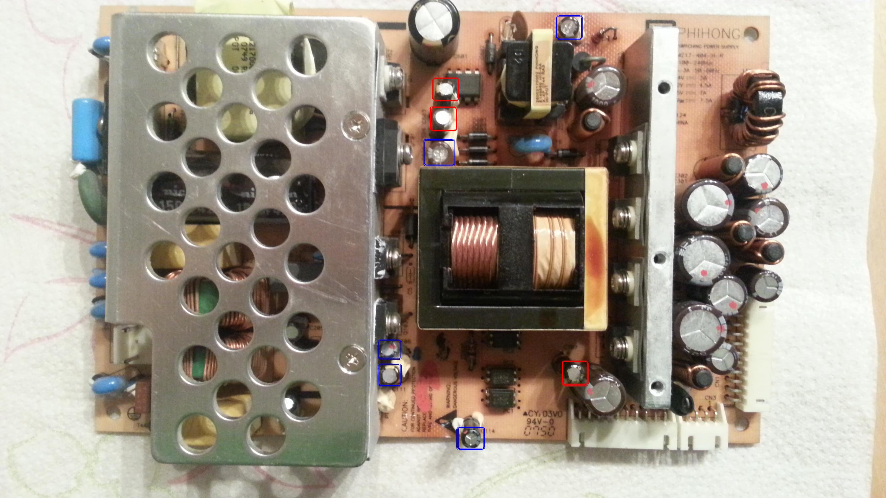

                          my monitor went out for good a couple days ago. i need to order caps for the power supply, they have spots on the tops of them. I found a repair kit for $13 on ebay to recap the exact power board model #. I would rather order from digikey but there are so many options for cap sizes with the same uF and voltage.The board is PSM217-404-H-R
                          http://www.ebay.com/itm/VIEWSONIC-VX...6109%26ps%3D54
                          could someone that has done this same board give me a detailed cap list?
                          • Qbass70
                            • Aug 2012
                            • 9
                            #53
                            Re: HANNSPREE HF289H Black Screen No Power
                            i replaced the caps with the kit i ordered and no luck... can someone help me out troubleshooting?

                                I think I know what happened. That kit you ordered from eBay didn't replace all of the caps. Just 12 of them. And it missed 2 of the 3 that are commonly bad on this board. I'll post a pic I have that shows the 3 that need to be replaced (circled in red) and the others circled in blue are optional. ~L-J-7~

                                  I have soldering experience, and the proper tools to replace caps.. I don't have a lot of experience with an ohm meter except for musical equipment... the kit i got had some of the smaller caps outlined in red but they were 22uf and 35v, the ones on my board are 50v. I didn't replace all of those yet. what I really need is I guess is a detailed list of what all the caps are, a scematic... some are to hard to read without removing them from the board. Im going to tear it apart and look again.

                                    I got it working! I replaced the 22uf 35v caps in blue and red. I did not replace the 100v 1uf cap that is in red (because i didn't get one in the kit or know what it was until i took the one out next to it) I did not replace the 50v 22uf caps because i didnt have those either,, but it works fine now. Thanks for the help! Does anyone have a schematic or list of all the caps for this board?? how do you guys know what to replace unless you strip the board and read all the caps??

                                      Well done! - bottom line is we usually dont. The usual answer to a request for a list of caps for a board is you need to make a list from your board.
                                      The reason is that boards evolve over time and boards even with the same
                                      part number have different caps - that is also one reason we do not recommend cap kits unless there is no alternative.
                                      If a cap is completely missing it is sometimes possible to find a schematic or parts list or spot it on a picture or have had practical experience of that particular board/cap- one good reason for us asking for good clear pictures - it can help others in the future. It is sometimes possible to find lists in the forum but I would still get people to check it against their own board.
