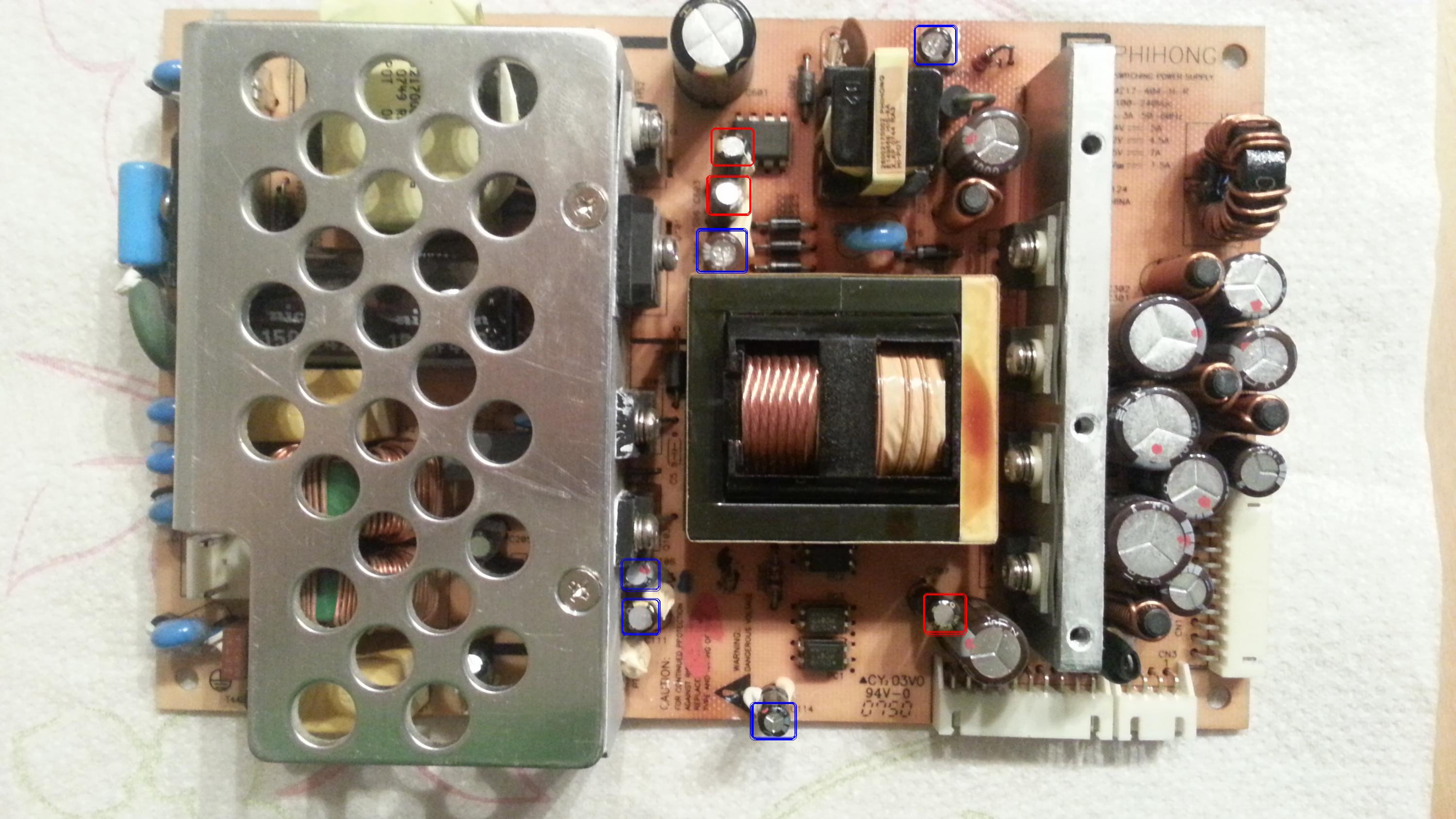

    Hello all, I have the same model and went yellow light. When i plug the monitor to pc yellow light goes off , if i unplug it from pc yellow light goes back on.
    Can you guys look at the picture and tell me how many and which caps i need to replace and/or what kind of caps i need to go get?
    Thank you very much.

      Re: HANNSPREE HF289H Black Screen No Power
      I would replace all of them. You are going to have to look at all of them as you remove them, no one has a list that i got anyway... what I should have done is took a picture of the whole board ( yours isn't showing the top part), took the caps off one by one and wrote down what they were with a map.
      Mine worked after I replaced the 22uf 35v and other small ones. the only ones I didnt replace were a 1uf 100v, and 2 22uf 50v on the outer edges. there are several 1000uf 25v & 35v, 470uf 35v, 25v, 10v...etc..there is 1 22uf 400v cap on there too. Order them from digikey, they will be the best quality. good luck, i'm a beginner at fixing monitors and im using mine right now after fixing
        Thanks for your reply
        I took this board to local repair shop and guy said caps look good, He wants me to bring the whole monitor. I did change some caps on my old Samsung and caps did look bad ( tops were blown) But on this monitor all caps look ok like repair guy said. I don't know if i should just change them or bring the monitor to him to look at the whole thing.
        What would you say?
          If you want to try to fix it yourself you will need a multimeter and soldering equipment.
          If you cant fix it you can still take it to the repair shop.
          We will need better pictures posted using manage attachments.
          Welcome to the forum-
          We can help a lot more if you please post good clear pictures of the whole chassis, and then pictures of each board, front and back (in the same orientation) and close up of connectors, (max resolution 2000x2000 and 2MB) using the manage attachments button, which is found by clicking "go advanced" under quick reply.
              It may turn out they are good, but anyone who declares that capacitors are good by simple visual inspection doesn't know what they are talking about.
              A capacitor can appear fine, just like an AA battery looks good, but have incorrect ESR or capacitance. The two parameters requires specialized test equipment to measure them.
                That's exactly right RC. This board is a perfect example of that. This is one of the "HANNS" boards where the small capacitors in the middle dry up due to extreme heat and poor quality. You cannot tell just by looking at them. But need an ESR tester.
                Ismolika; Does this look like your board? I'm attaching a picture of the 3 caps that need to be replaced. (circled in red). The ones circled in blue are optional. You'll need to use high quality, low ESR - 105c rated capacitors because they take a lot of heat.
                You could replace all of the caps: but when I tested the others on my boards the ESR was still very low and good. I have fixed a couple of these monitors and it was always those 3 little caps. Good luck! ~L-J-7~
                Last edited by Lumberjack777; 12-02-2012, 02:52 AM. Reason: Additional information

                  That is the same board i have. I will have to buy the equipment to test the caps. Thank you for your help
                    Repair guy couldn't find whats wrong with it, lol
                    So, now i have to go get some tools and try to fix it myself. Ill post some more pictures, maybe you guys can tell me more about it.
                    Before i go on and get my hands dirty can you guys answer a few questions please
                    1- Is there a way to test the caps without taking them out?
                    2- What voltage numbers iam looking for? Good cap , bad cap?
                    Thank you.

                      1 No - without an esr meter you cant even test them when out.
                      2 Bad caps can reflect in odd voltages on the board you cant just say
                      voltage x = bad cap
                      post the pictures to see if we can spot anything and source the 3 caps
                      L777 mentioned.

                        ok SUCCESS Repair guy said he cant fix it. So i took it back and,
                        I did change all the caps with red circle and whatever i could with blue. I had very little exp. with soldering but i did it. woooottt. I am using my monitor right now.
                        Thank you very very much to all people who helped out.
                          Refer back to post #66. If the repair guy is serious about his business, he should consider investing in an ESR meter.
                          While I'm glad you got it fixed, unless you have an ESR meter to check every capacitor out of circuit, there could be more caps that are bad than the 3 you changed. As I have mentioned several times, this particular monitor in its various incarnations seems to run very temperature hot drying out caps on both the power and main board.
                            You are right , Monitor was hot before, you could feel the heat from screen, Its not like that anymore now.
                            I was low on cash so i did buy analog meter but its very difficult to understand it. I will buy digital int he future. Its kinda hard to check the caps without taking them out. Plus i need some soldering classes. I did a messy job but hey it worked

                                      Hello, looking for fixes to my hanspree monitor brought me here. I have similar problems to what people are describing in this thread. It started with My Led Power button having issues when waking from sleep mode, its performance diminished over time, to where the monitor would only turn on when cold.
                                      I have removed the 8 caps that are circled in the image posted earlier in this thread and ordered replacements on digikey. I wanted to make sure I ordered the right caps as I wasn't sure about several factors like ripple current, impedence and size. If anyone can tell me if these capacitors i ordered listed below will work, it would be much appreciated. I have also attached a board map of the capacitors I removed.
                                      1x P13462-ND EEU-EB1H2R2S CAP ALUM 2.2UF 50V 20% RADIAL
                                      1x P13478-ND EEU-EB1H100S CAP ALUM 10UF 50V 20% RADIAL
                                      1x 493-10411-1-ND UTT1V100MDD1TP CAP ALUM 10UF 35V 20% RADIAL
                                      3x 493-11889-1-ND UPX1V220MPD1TD CAP ALUM 22UF 35V 20% RADIAL
                                      1x 493-1962-ND UPW2A010MDD CAP ALUM 1.0UF 100V 20% RADIAL
                                      1x 493-3288-ND UTS1H470MPD CAP ALUM 47UF 50V 20% RADIAL
                                      Any help is much appreciated, and thank you in advance!

                                          Well I replaced the 8 caps and the monitor has started up perfectly. I also removed 5 vertical lines on the screen by pressing near the edges to fix the loose connections. Now in testing phase of using the monitor, the fact that it started up at all is a good sign, will repost if the problem persists. But so far so good, this thread has helped out a lot!
