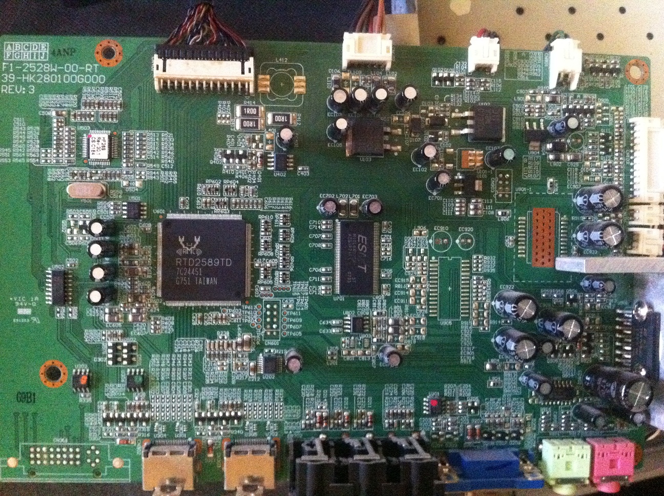

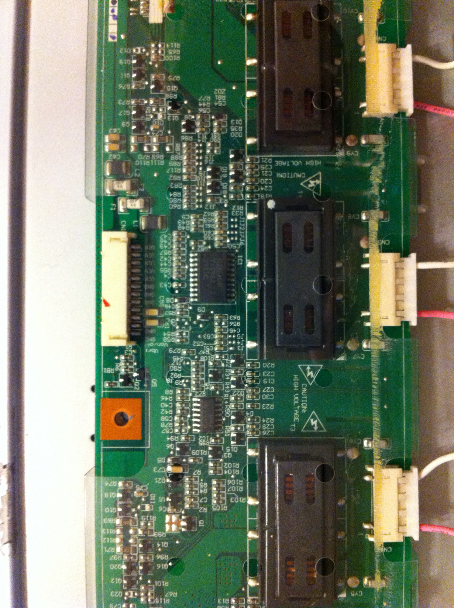

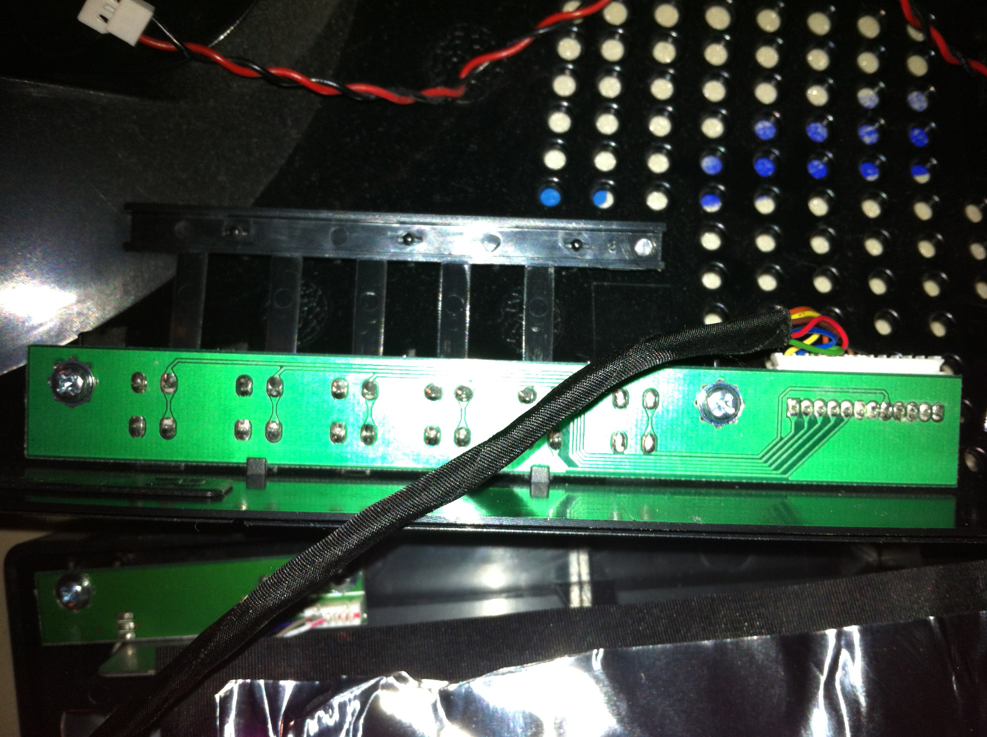

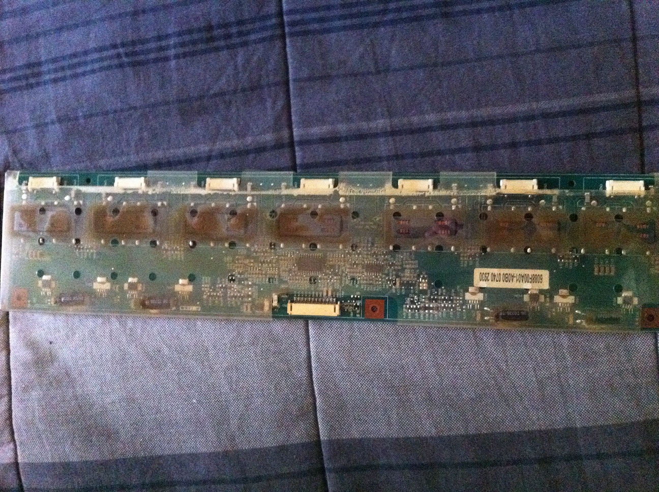

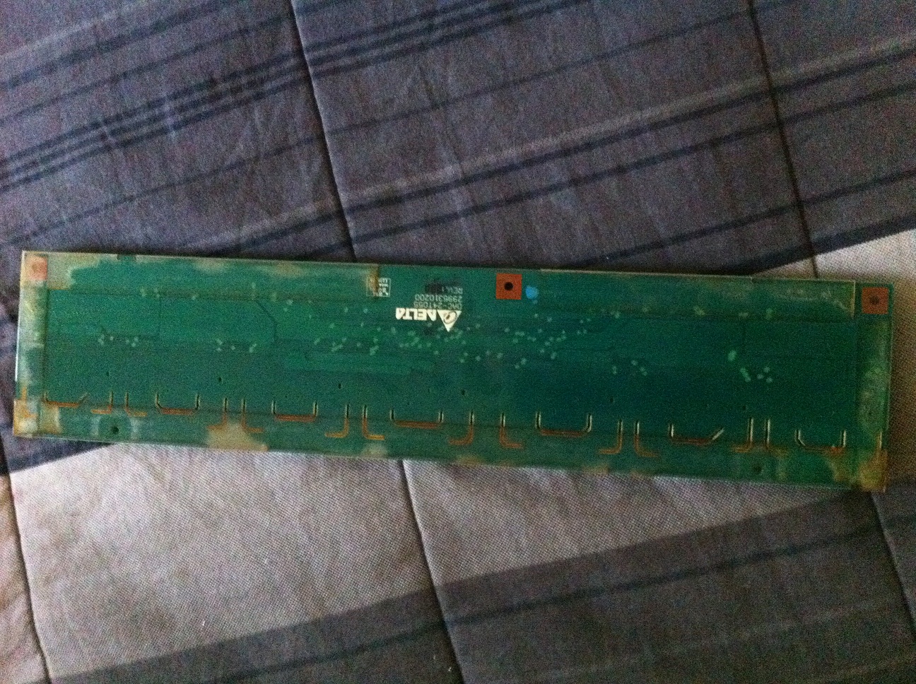

    Hello everyone, I am having problems with my monitor and I'd like to see what you guys think the problem might be. As the title says I have a Hannspree 28" HF289H monitor that stopped working. My computer went into power saving mode the other day along with the monitor. When I moved the mouse the PC turned on but the monitor did not. No LED light anywhere. As a matter of fact I get absolutely no response from the monitor at all except when i plug in a video source I get an orange light that blinks once whether there is power or not. When I plug in the power source nothing at all happens. Every time I plug in a video source though whether its HDMI, or VGA I get that one orange blink before the light turns off. Now there is no picture on the monitor at all, no faded image nothing at all. It feels like the thing is not getting any power. I opened it up and looked around a bit and noticed that the inverter board, and power supply have significant discoloration. The video card I would assume is fine since I get a response from it when I plug a video source in. My question is, which part of the board do you guys think would cause this? Is it the inverter board, the power board, the video board, the backlight? Any help would be greatly appreciated, Thanks!
    Attached are some pictures that I took

    Start with this megathread. There are enough ideas, suggestions, and test points to get you started.

      Pics are not well focused. Please, upload new pictures if you can.
      Since I'm not a technician, this is what I'd do:

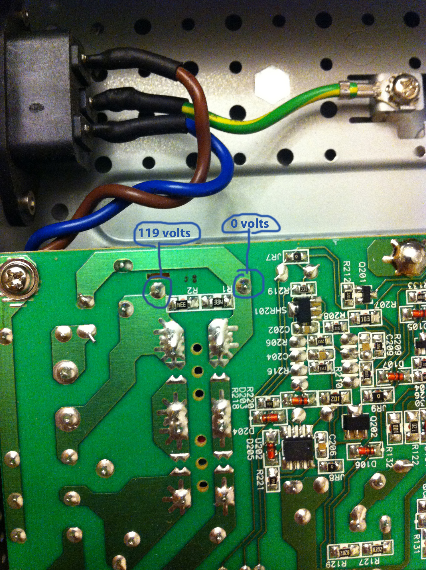

      - Check the power cord (if you get 110v at the end of it).
      - Look for not working caps (apparently none) and blown fuse(s).
      - If you get 110v on the board. If you do, then the voltage in the main cap filter and the bridge rectifier.
      I'm trying to find the service manual of the monitor but I can't find it.

        Yeah sorry about the bad quality my phone camera is all I have available at the moment, and I did see that thread and some others before I posted, I posted on one of them a few days ago but didn't get a response so I decided to start my own thread. The thing with those is that I never really got a conclusive answer as to what part of the monitor caused the problem, or did I miss something?

          It's actually a fairly complicated power supply and not easy to troubleshoot. Sounds like you're getting some power as evidenced by the orange led coming on for a second. On the lower left of your third picture there is a row of pins for each of the wiring harnesses. There should be markings on the board to indicate the 5V, 5VSB, 12V and 24V outputs. Once you record this info on paper, connect everything back together except for the inverter and with your meter set to DC volts, try measuring for the above voltages at each connector. Especially interested in the 5VSB as this should be on at all times.

            The orange light flashes on even when the monitor is not connected to the power at all. It comes from the video source

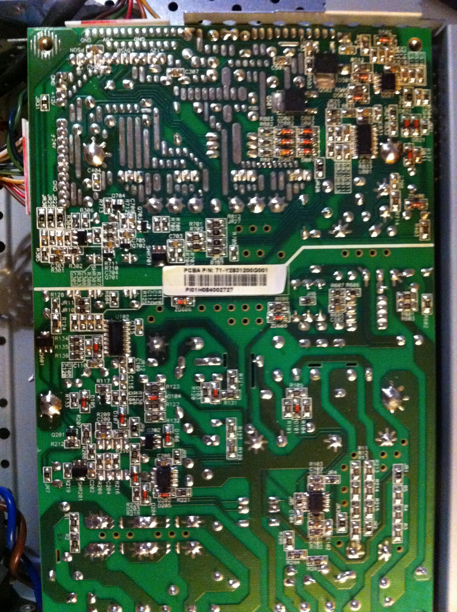

                  We can help a lot more if you please post good clear pictures of the whole chassis, and then pictures of each board, front and back and close up of connectors, (max resolution 2000x2000 and 2MB) using the manage attachments button, which is found by clicking "go advanced" under quick reply.

                    Thank you for the quick and thorough response. As soon as I get back into town, I will take pictures of everything. I won't be able to answer anything about when the monitor died because I picked it up from someone that was tossing it out.

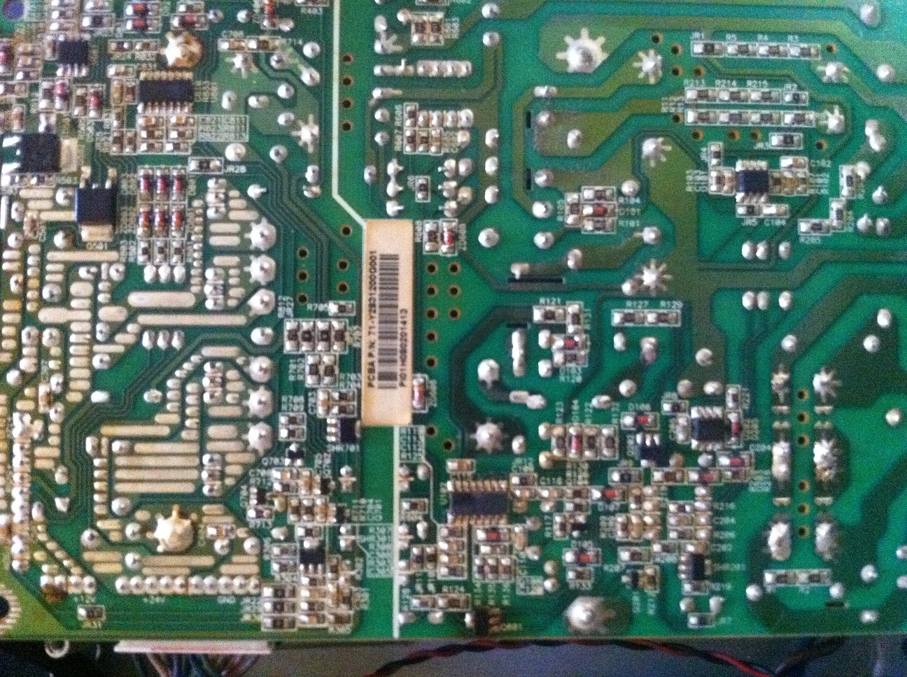

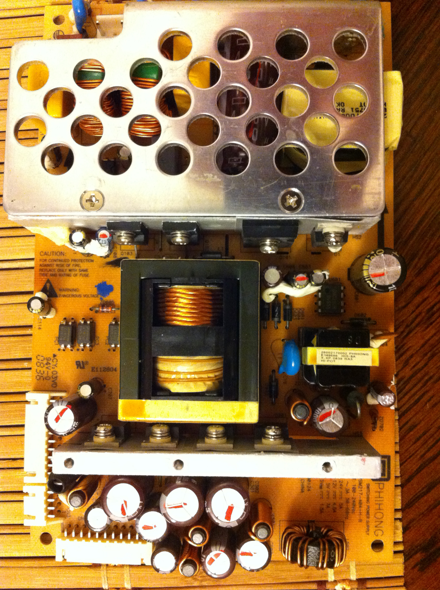

                      Too hard to tell from your photos, but this monitor may have the same power board as the infamous Hanns G 28 inch megathread. If yes, there are hundreds of posts in that one thread and several forked off threads for you to do some homework.
                      https://www.badcaps.net/forum/showthread.php?t=11329

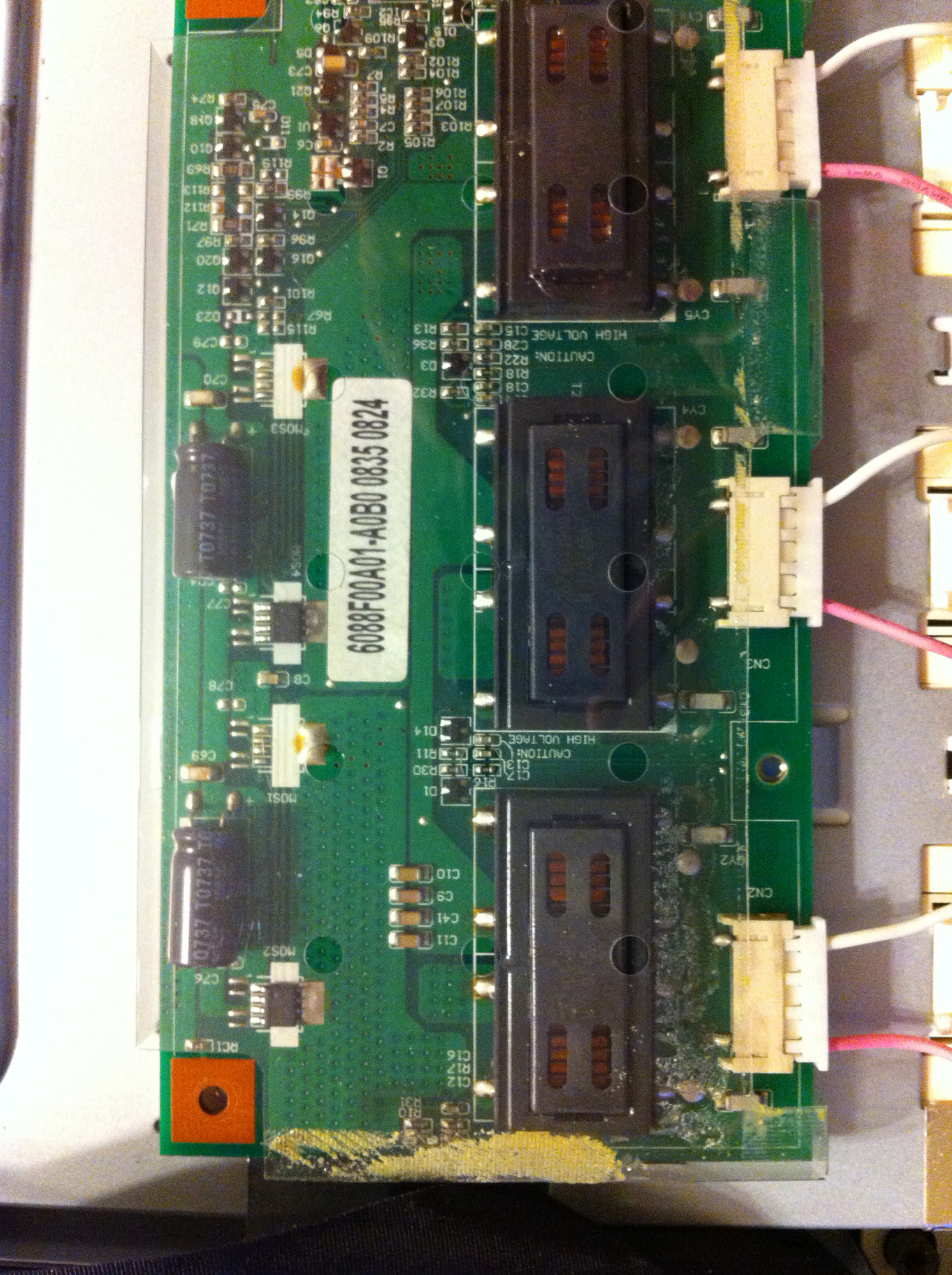

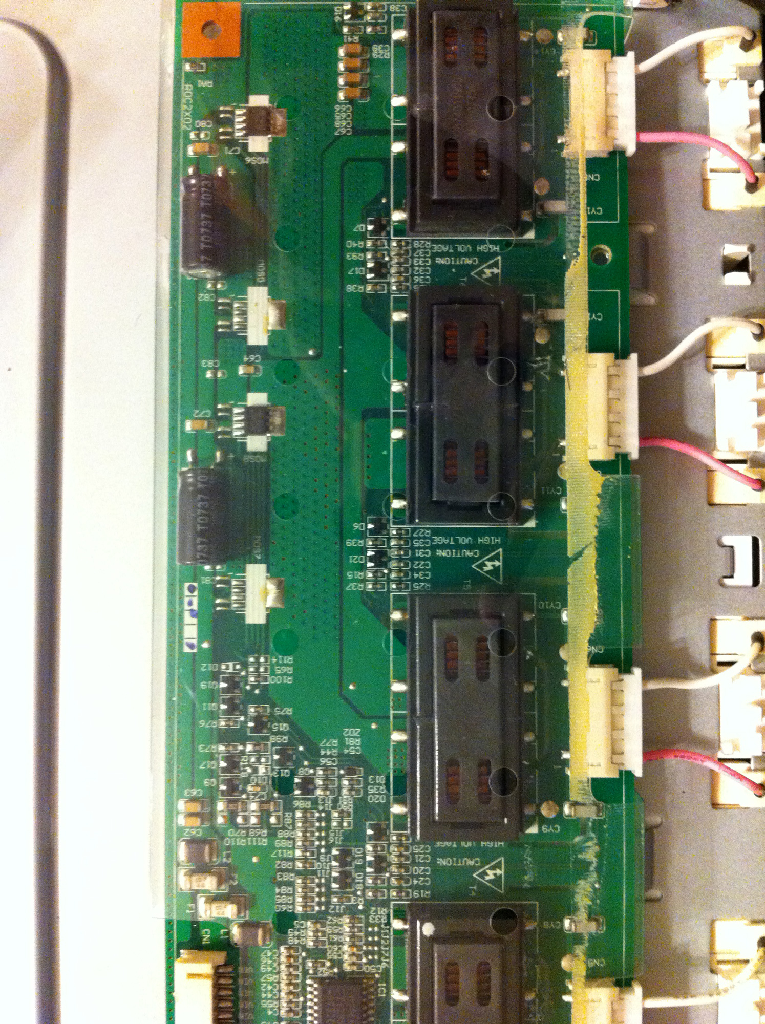

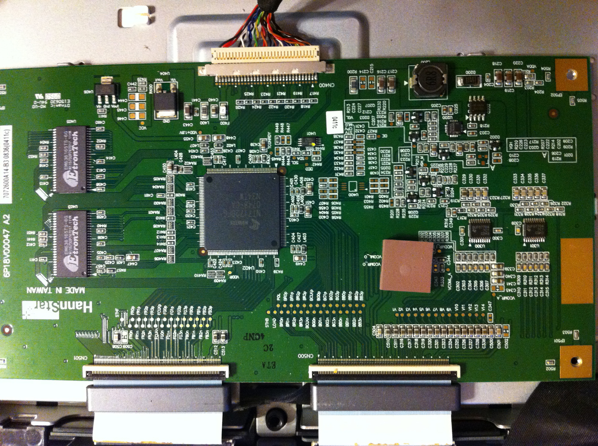

                                  No, you are doing alright here- pictures are good and clear, thanks. Can you do the bottom of the power boards and the top and bottom of the main board
                                  And the inverter board - ie same set as the original poster. To get it clear you may have to do the inverter board in 2 parts.
                                  We can then locate where you need to do testing. Is the rest of the heat shield
                                  soldered on?. Can you locate where the BIG Cap is on the back of the board and which is the positive and negative leg. First test is with it all connected up and plugged in -CARE as HIGH Voltages- set meter on 600vDC and put the red probe on the positve leg and the black probe on the negative leg and report the voltage should be around 170vdc. Then press the
                                  power button and quickly but carefully do the same test - may be up to 400vdc.

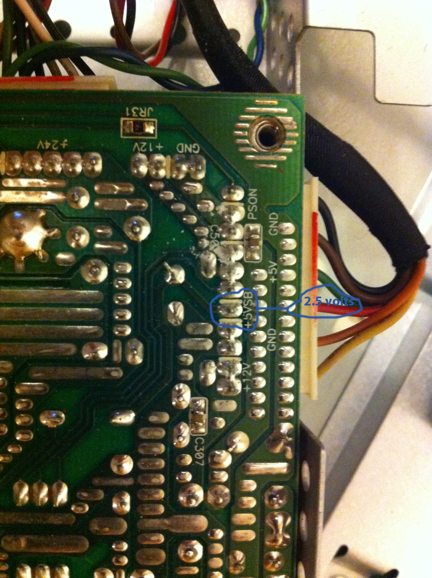

                                    I'm working on the photos for the rest of the boards. Before I started to strip it apart, I checked the big capacitor underneath the metal plate and it was reading 280vDC. Unfortunately, I can't get too close to it without desoldering the metal plate. I did try the power button but nothing happened. No blue light, no increase in voltage on the big cap, no picture...
                                    • welch_41
                                      • Jun 2012
                                      • 21
                                      Re: HANNSPREE HF289H Black Screen No Power
                                      I hope that this gets me a little closer to a solution.
