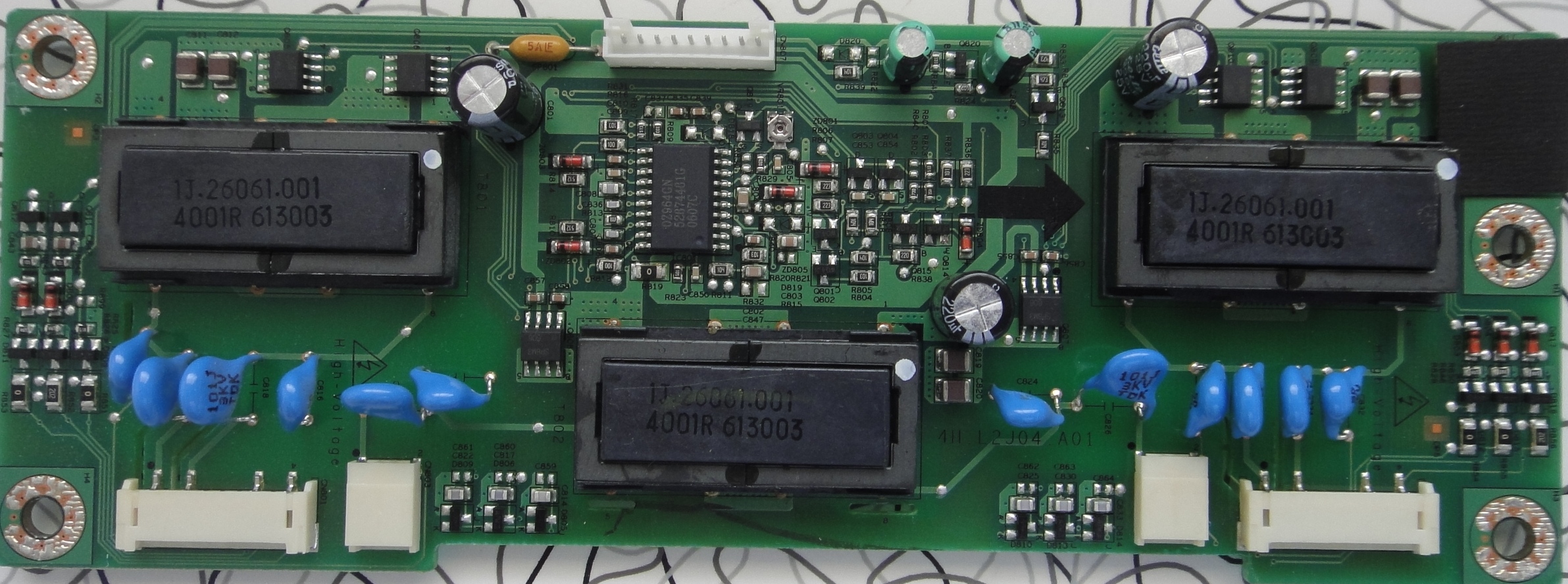

    4001Rxxxxxxxx is the type i need? i have wasted so many time, at least i ve learned

      Are you sure it measures as OPEN and not as 0.00. we are only expecting it to be less than 1 ohm so meter should be on ohms20 or less.
      What do the primaries on the old one measure
      Can you unsolder it again and post pics of the bottom of both the old and new.
      align them with the positioning pin at the same end.
      I also notice there is some damage to the cap - does it just extend to the outer plastic?

        yes the damage is only in the cover, i did it when i removed the old transformer that had an open winding, i dont have a good transformer out of the board, but i can desolder one of the other two original transformers.
        comparing readings in the board without desoldering:
        1st original 0.03ohm
        2nd original(middle)0.04ohm
        3st new open, infinite resistance
        i believe the originals have 0.8ohm in each winding becuase:
        middle pins are joined in the board. i suppose that the board is putting the 2 resistances(p1 to p3 and p2 to p4)in paralel, giving half the original resistance value for each winding)
        anyway i think i will be desoldering it to check for sure

          Originally posted by Armandorf
          3rd transf
          1-8 resistance: 1.040 K
          4-5 resistance: 52.3 K(200K scale)
          Interesting... I have a 2007wfpb that's doing the same thing. ...and the same transformer is bad. I wonder if there was some sort of error in the design or if this is purely a chance happening?
          T801:
          1-8:1076Ω
          4-5:1089Ω
          T802:
          1-8:1089Ω
          4-5:1095Ω
          T803:
          1-8:No reading
          4-5:1078Ω

            I have been doing some searching using google and I'm not finding any transformers that mach the 4001r714050 exactly, should this 4001K do the trick? Or is the 15K resistance enough different that it would cause problems?

              Unless your meter is broken there is no such thing as "No Reading".
              I think that the 1500 resistance would trigger a shutdown but it may depend on the circuitry - the primary also seems different.

                at first I thought that a faulty ccfll overcharged the transformer with that ccfl. but they glow. probably is the inverter only.
                finding an inverter board complete can be the solution.

                                Re 4001R
                                https://www.badcaps.net/forum/showpo...59&postcount=9

                                      Mac Nut - is this the one?

                                        That is the same as Armandorf's board 20$US at shopjimmy.

                                          This is the board that came out of my 2007wfp that had a terminal problem with the video board.
