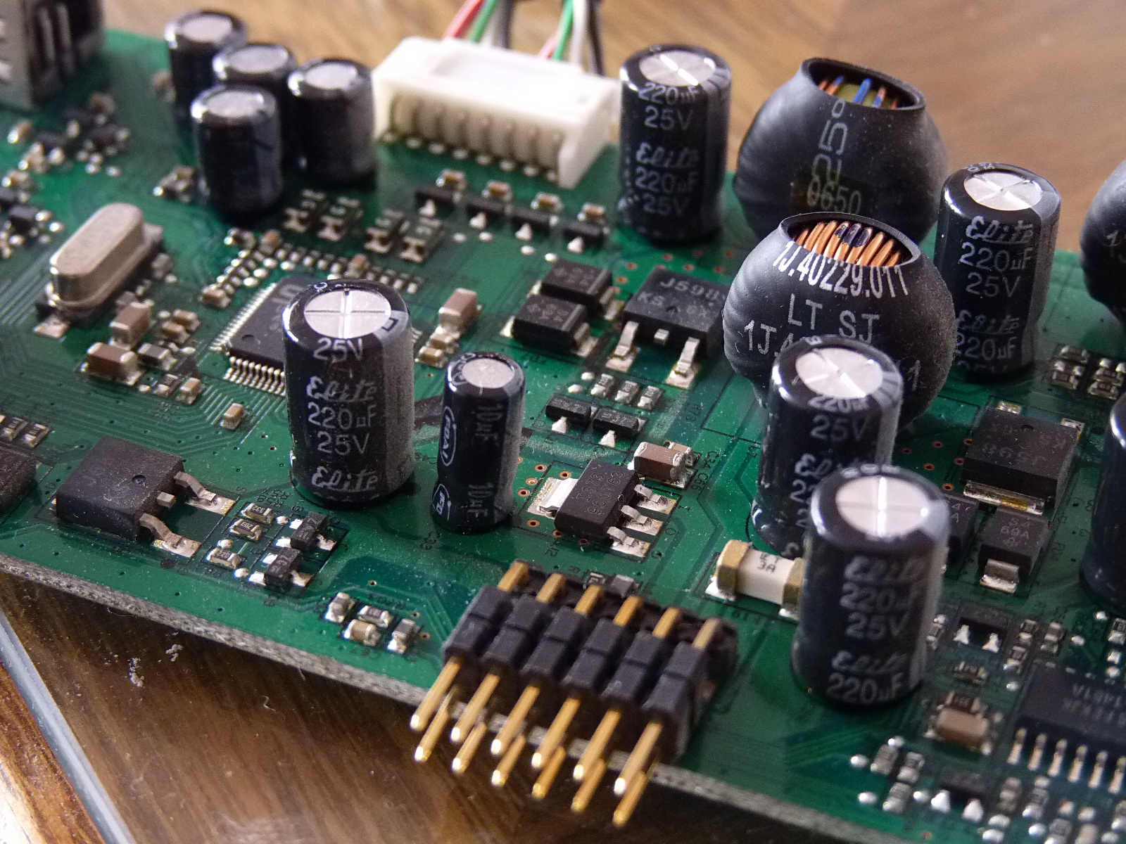

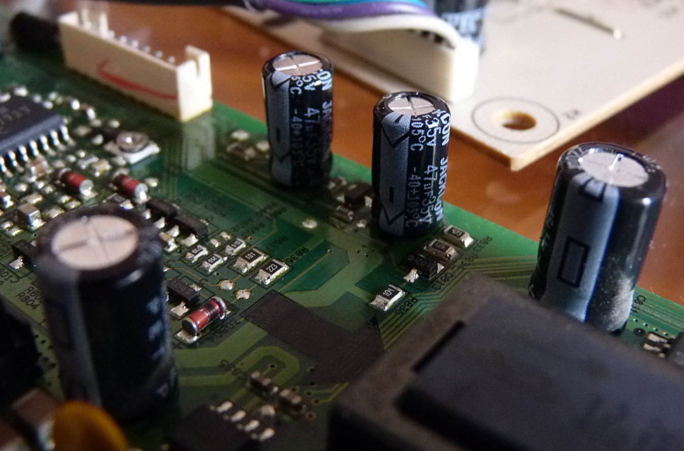

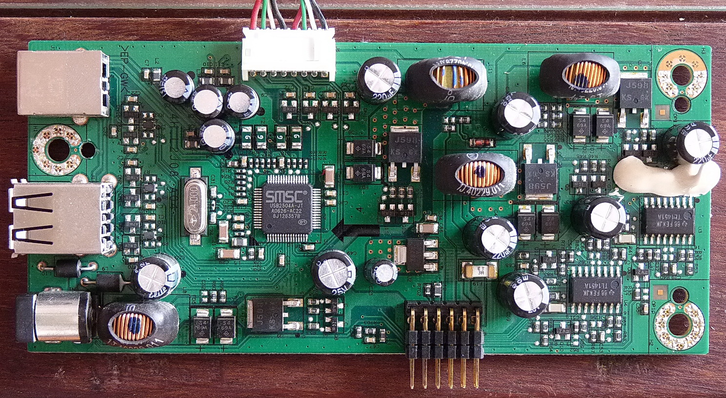

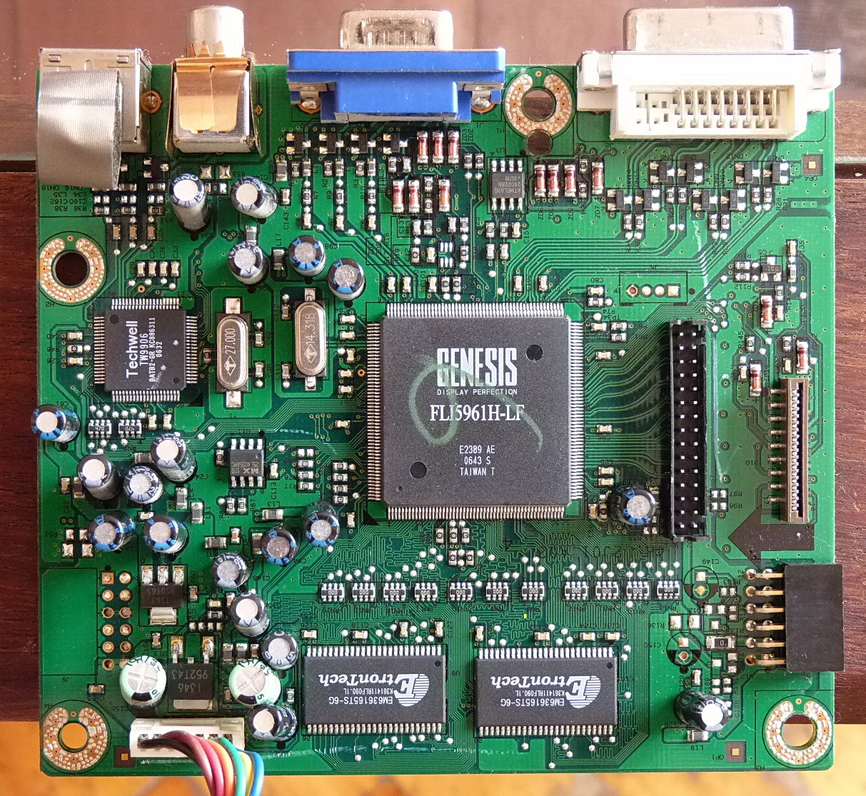

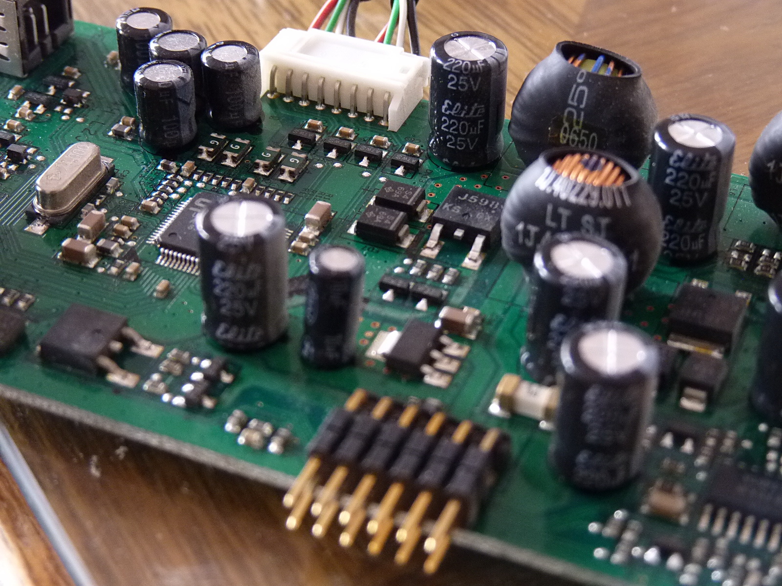

    Hi,i bought this monitor in late 2009, used,its from 2007.
    im a happy owner since then.
    lt has never been too bright, so i used the brightness at 66-100
    doing that result in a whine(high frecuency sound). so i tried to use it at 50, just for precaution.
    for 2 years no problems
    A week ago, after using mi monitor for a couple of hours,i moved it to my desk(it was in a chair) and get out.
    several hours later i power on and the image lasted 1 minute. then no backlight(but stayed gren light on)
    if i unplugged it and waited a bit, it lasts 30-40 secs
    if i try to re power on its 2 secs to black.

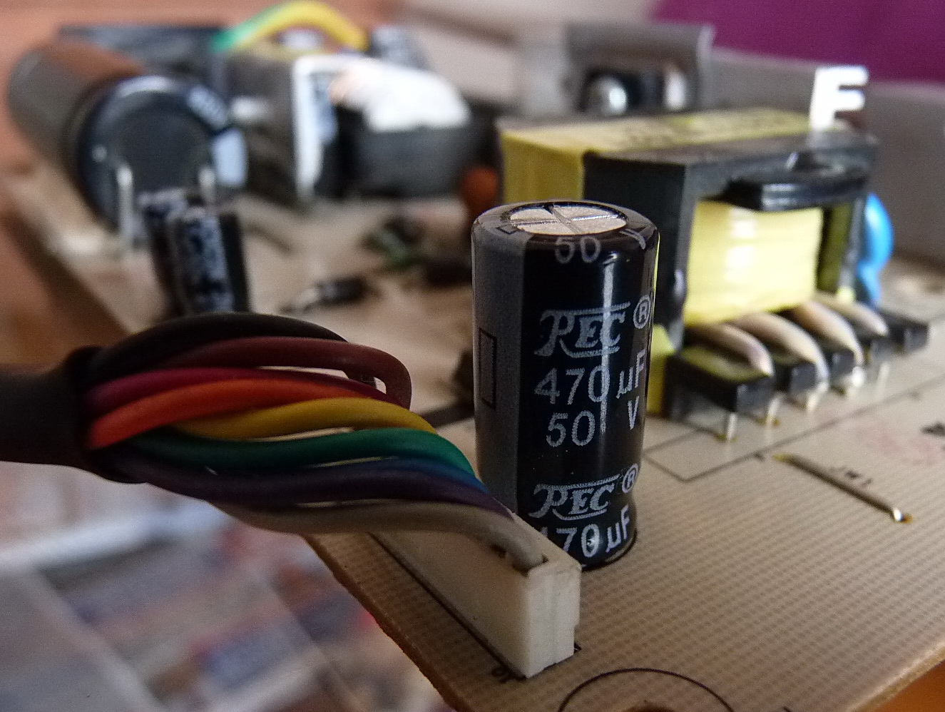

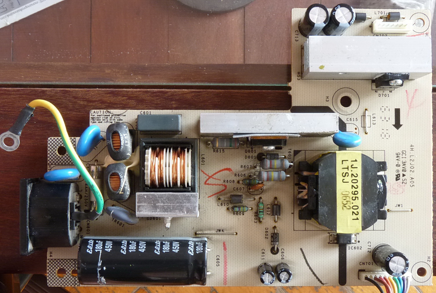

    so i decided to take a look,and see if i could do something.
    my first thought: PSU related problem
    so i changed al the electrolytics. except the huge one
    tested diodes, the mosfet(sk3548), resolded critical sectors.
    all seemed okay, no bulging capacitor or cold joints of solder.
    tested and it was the same.. first time lasted 30 secs then it was 2 secs to black.
    when it lasted 30 secs, i saw a flickering every 3 or 4 seconds.

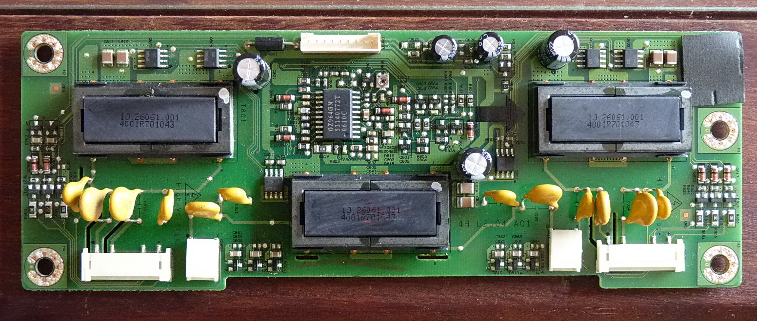

    so i looked further into the inverter, changed all the electrolytics an resoldered transformers.
    no changes.
    i also tried to power on the monitor with 1 or two of the 4 ccfl conectors, nothing

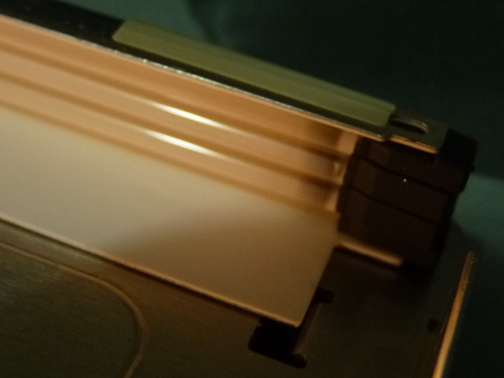

    i have dissasembled the LCD panel now and have access to the tubes.(photos)
    should i recap all the boards?? i have crappy Trec `s capacitors, but they are new
    what should i do?
    Many thanks in advance, sorry for grammar errors(tell me so i can correct them)
    cheers from argentina
    PD,
    1 i have done most of the 2 sects to black excellent tutorial, except th tranformer part.
    2 im sorry if its to large i can resume it and put spoilers.

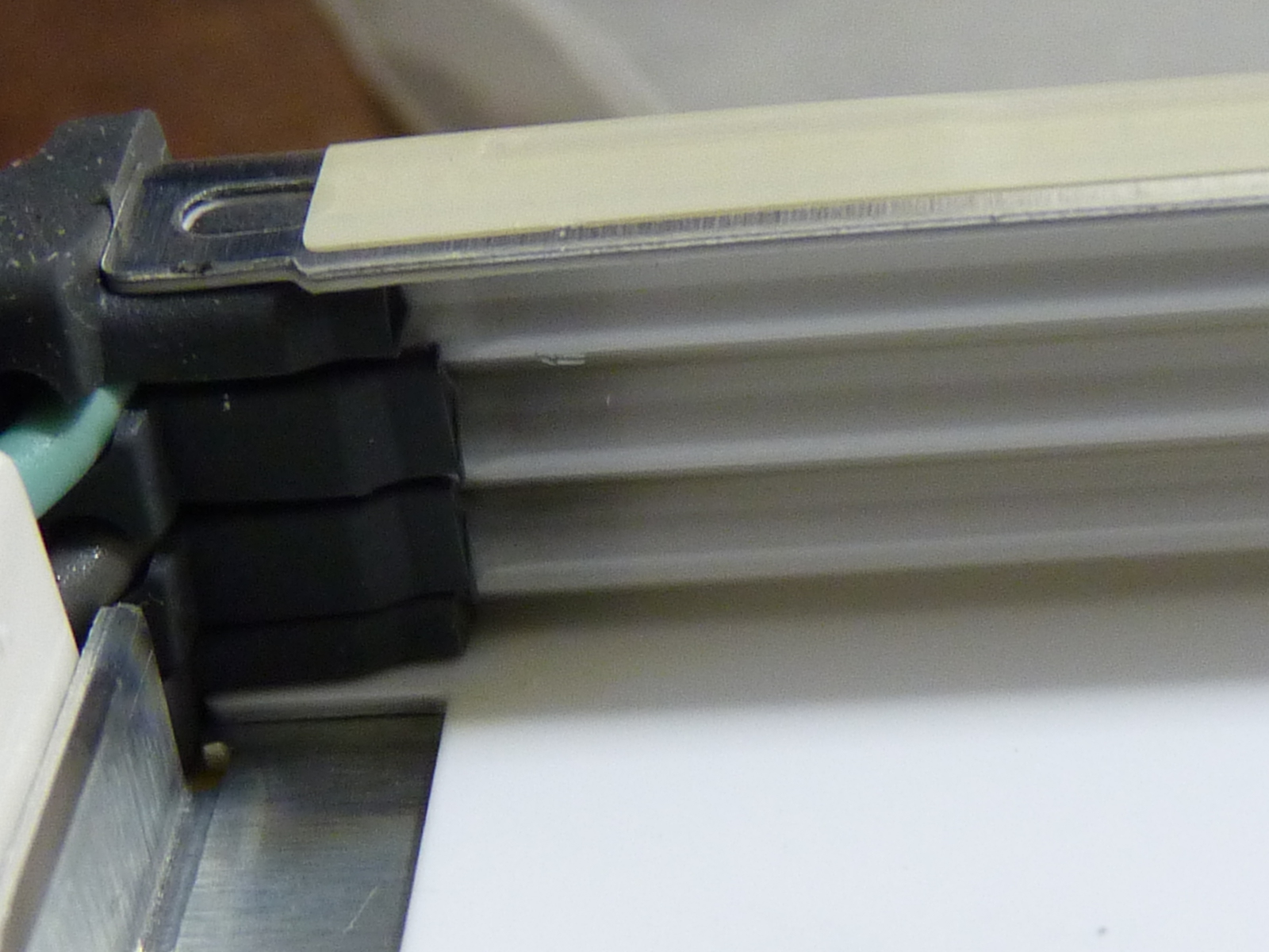

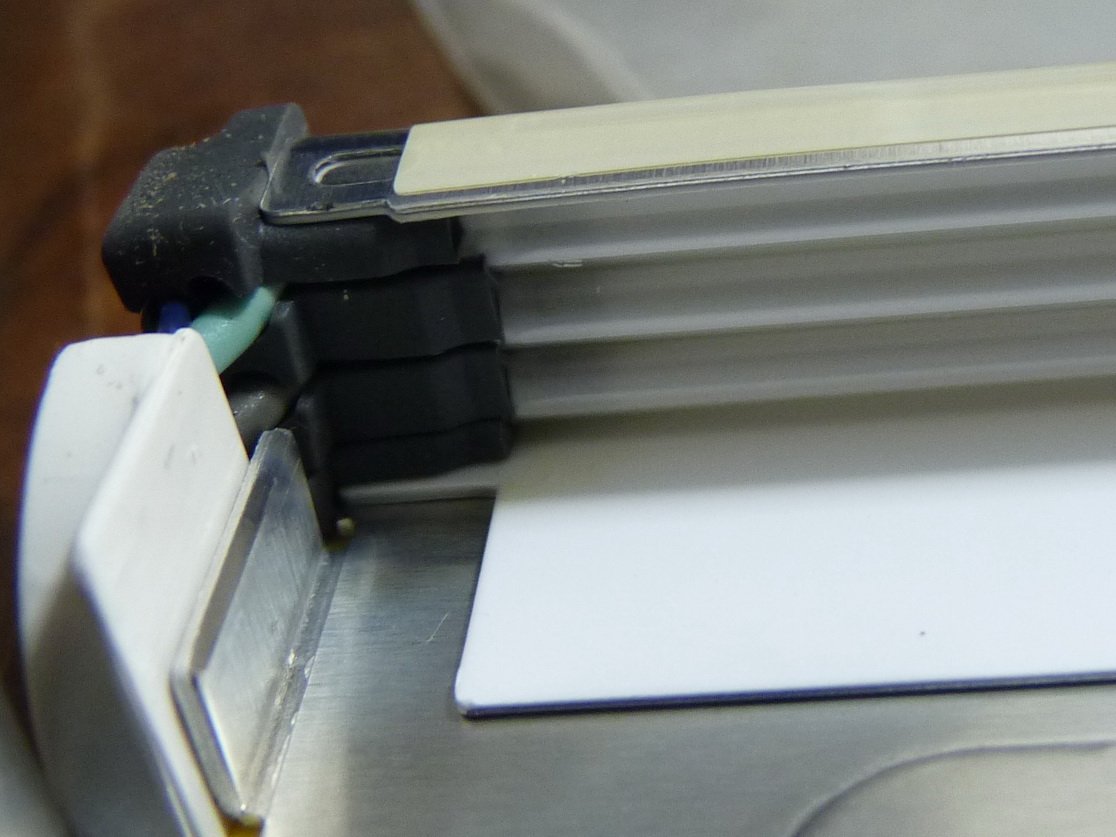

    Re: DELL 2007wfp - 2 Secs to black w/flickering

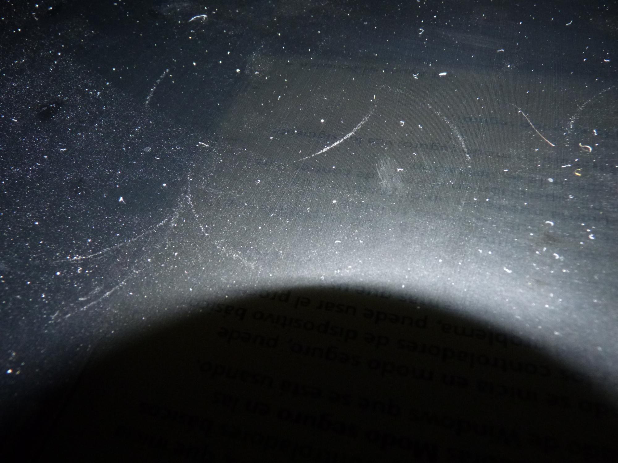

    tubes photos,
    i have another monitor, LG with a broken panel, so i have a test inveersor and tubes,no?
    its a 19 screen, its compatible to test dell tubes with the LG?.
    here i found a lot of infomation, great forum, keep it up
      The inverter PWM will shutdown all the ccfls if one or more of them are not connected. Either all the ccfls work or none at all.
      Your written English is better than most who are native speakers.
      Measure the resistance between pins 1-8 and 4-5 for all 3 transformers. You should have 6 readings. Post your results. They should be within 3% of each other. I expect readings in the 1023 ohm range.
      PS. Those are excellent photos.
        Yes, you can use these ccfls as "known good" to test with your Dell despite the size difference.

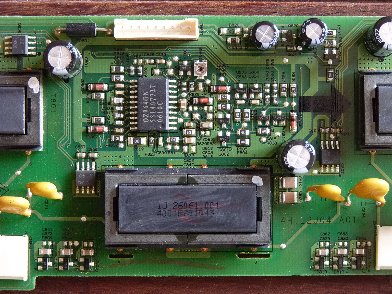

          transformers readings, pins numbered as described in attachment.
          with the tranformers mounted in the board.( no need for desoldering?)
          DMM set in the closest scale, in this case 2K ohm
          1rst transf.-
          average resistance 1.062K-
          1%= 10.62 ohms
          1-8 resistance: 1.061 K (deviation -0.16%)
          4-5 resistance: 1.063 K (deviation +0.16%)
          2nd transf
          average 1.0665K
          1%=10.66 ohms
          1-8 resistance: 1.064 K( - 0.21%)
          4-5 resistance: 1.069 K(+ 0.25%)
          3rd transf
          1-8 resistance: 1.040 K
          4-5 resistance: 52.3 K(200K scale)
          with a transformer replacement should work? can i emulate this tranformer to see if i have another problem?
          i will read the components relationed with these pins
          thanks

            Transformer #3 is bad. It has an open winding.
            See the following for a replacement. They are available on ebay.
            https://www.badcaps.net/forum/showthread.php?t=17945
            http://www.ebay.com/sch/i.html?_from...All-Categories
            It is highly unlikely that another replacement transformer will work. The number of turns is very specific to each board.

              what about the tubes, theres a slight blackness in the ends, should they work a couple of years more?

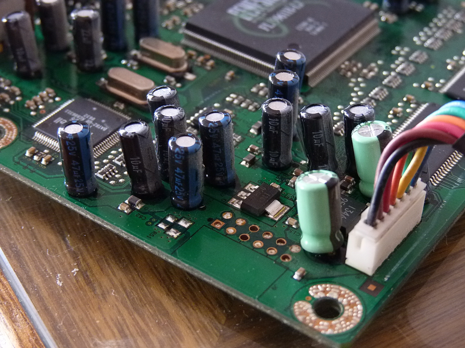

              in the logic board, i find the caps slightly bulged, its better leave them as it is, or replace all of them?
              i want to make a whole service to the monitor, i love this monitor,thats why i want to leave it as new as possible. here is difficult to find non TN panels monitors
                They look okay, but sometimes the return wire (the thinner guage) can become disconnected/charred/frayed. You can't see it because it is inside of the silicon cap end. Replace the transformer first and retest. I expect it will work fine and the caps and the transformers were the only bad things.

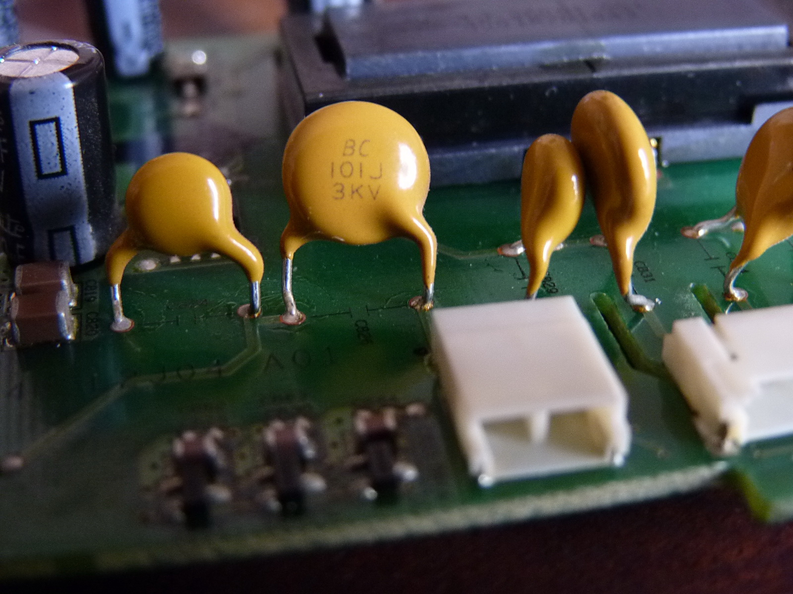

                Any cap that is slightly bulged is automatically bad. We recommend the standard advice (regulars may skip)
                https://www.badcaps.net/forum/showpo...84&postcount=3
                edit: If you are talking about the green Lelon caps by the connector on the logic board they look completely flat to me in one angled picture. The caps on the logic board don't undergo the same stress as those on the power board.

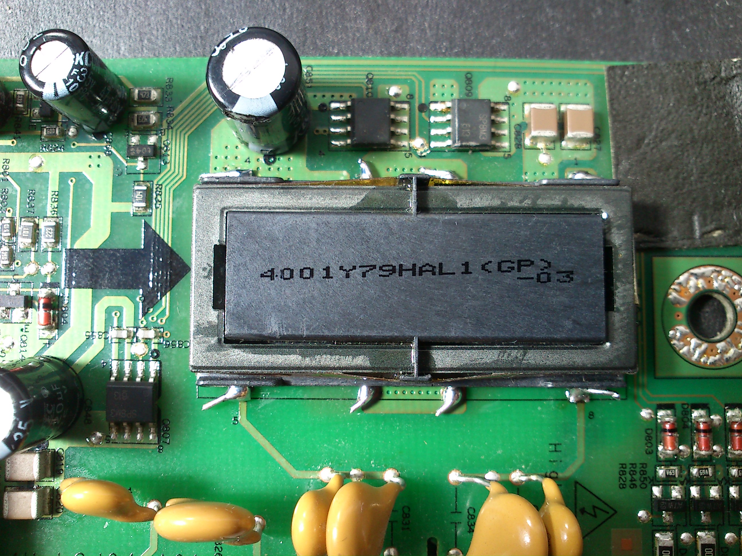

                    yesterday arrived the transformer. it had SMD pins, so i put short wires(ends of used caps or resistences), soldered and mounted the transformer on the inverter.
                    i tested
                    but i still have the same problem; it flashes very quickly and i can see the [ No signal OSD] for a fraction of a second
                    i re checked the 6 ccfl´s with an inverter from a Lg 19'' and they flash once,1 second off, and lit on again, this time with an increasing brightness during the first 3 seconds .finally they still hang on with no noticeable problems.
                      You are saying that this replacement transformer has surface mounted pins instead of the through hole pins. Does it have the same part number as the original and did you take any resistance reading to see if it is the same as the original good transformer?
                        Did you measure the resistance of the new transformer before installing it? If no, what is the measurement?
                          yes, the readings were 1.054K and 1.055K, and the readings in this transformer are equal to the other two.

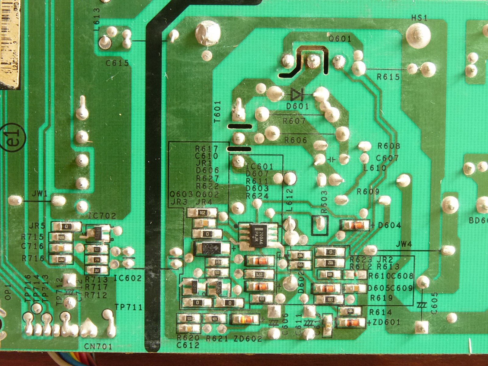

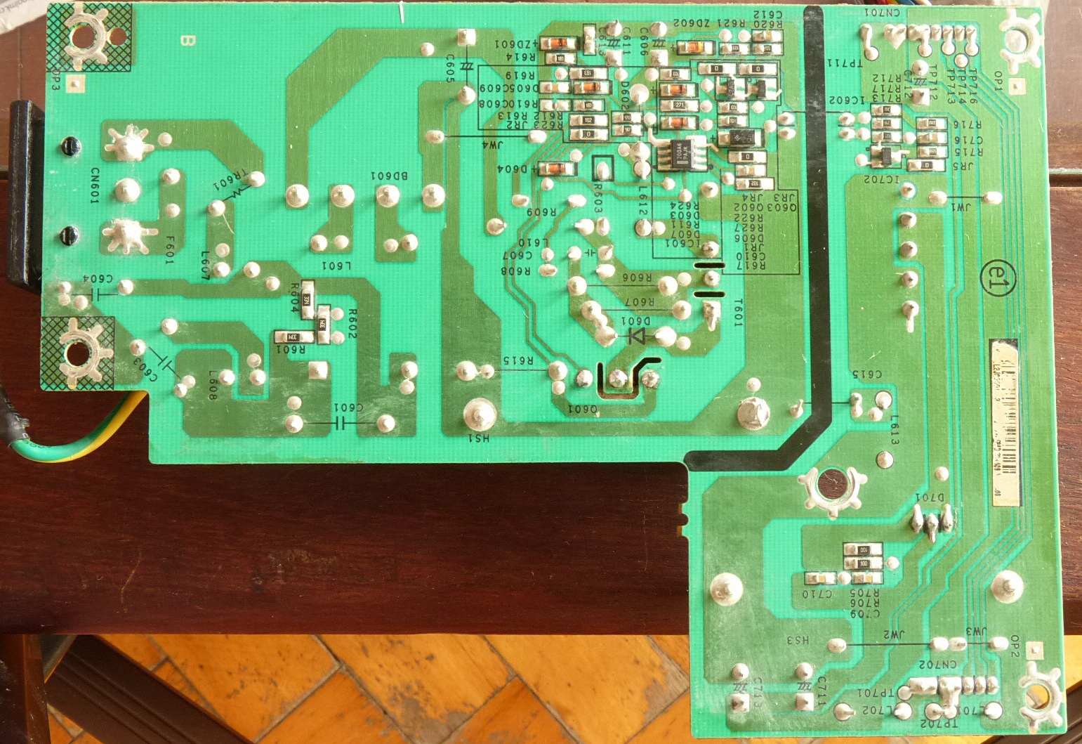

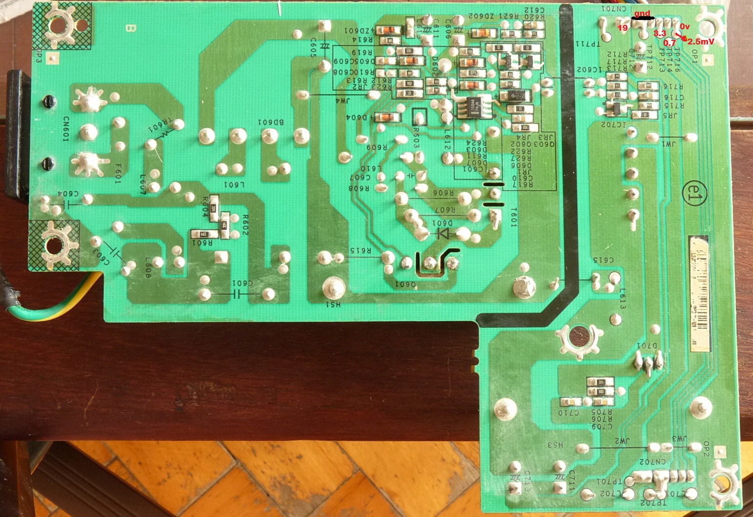

                          looking the power supply, i searched for bad diodes or smd transistor shorted(continuity test)
                          and found something
                          i have 19.2v dc
                          an other 3 pins with 3.3v, 0,8v , 0v(it seems 2,5 mV with the tester in 200mV scale)
                          the last pin has no voltage but it doesnt seem grounded(continuity test with chassis marks open)
                          posted an edited pic of the solder layer for the voltages in the power supply
                          where i cand find a diagram for this power supply?
                          i will be looking for dead voltage regulators in the other boards, i read thats quite common.
                            Your power supply is OK, it is only a single output supply, 19VDC, this 19V is coverted down to lower volltage to run the logic board, the inverter runs off the 19V directly. Your problem is more likely to be in the Inverter board. Does the new transformer 4 middle pins of the transformer all have low Ohm reading?
                                what do you mean with low ohm readings? in which pins I should measure?
                                in the pcb the 2 central pins of each side are joined
                                Budm is asking you to measure P1 to P2 and P3 to P4. See diagram below. It is not a 4001R, but the 4001K is "close enough".
                                      i measured p1to p2 and p3 to p4. both readings marks open
                                      i read that the 4001 was the important part of the transformer, i have a wrong transformer? i cant find the exact model en ebay
                                        The board that I have here in front of me has two transformers with P/N 4001R702048, the middle transformer has P/N 4001R703038. When you told us the replacement was the surface mounted type, then I kind of suspect that it is not the same transformer as original.
