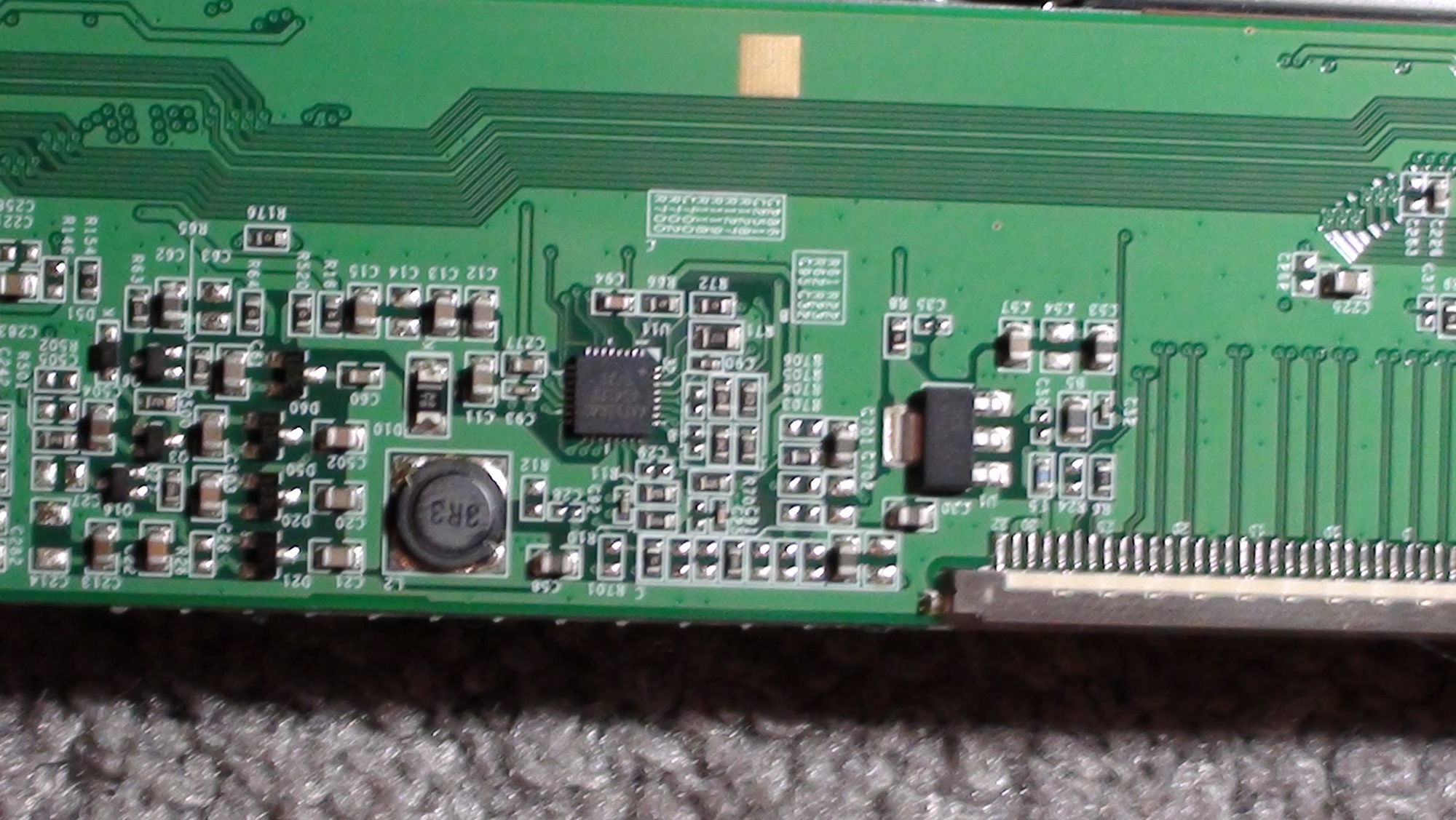

      retiredcap is correct about possibility that the surface mounted fuse on the T-CON board may have blown, or it is not getting the 5Vdc feeding it from the logic board through the switched transistor.
      Please see the PDF and pictures and also read my guides.

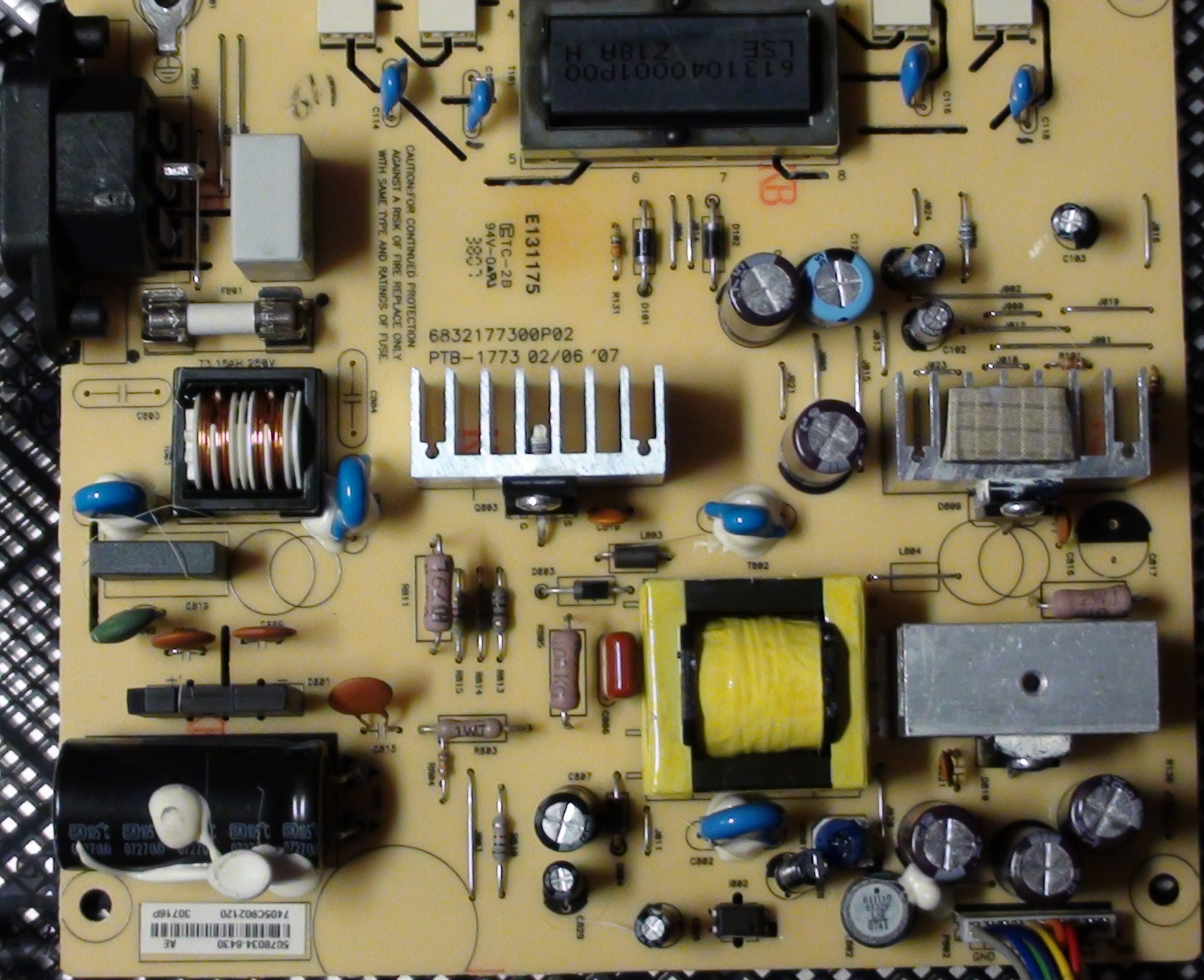

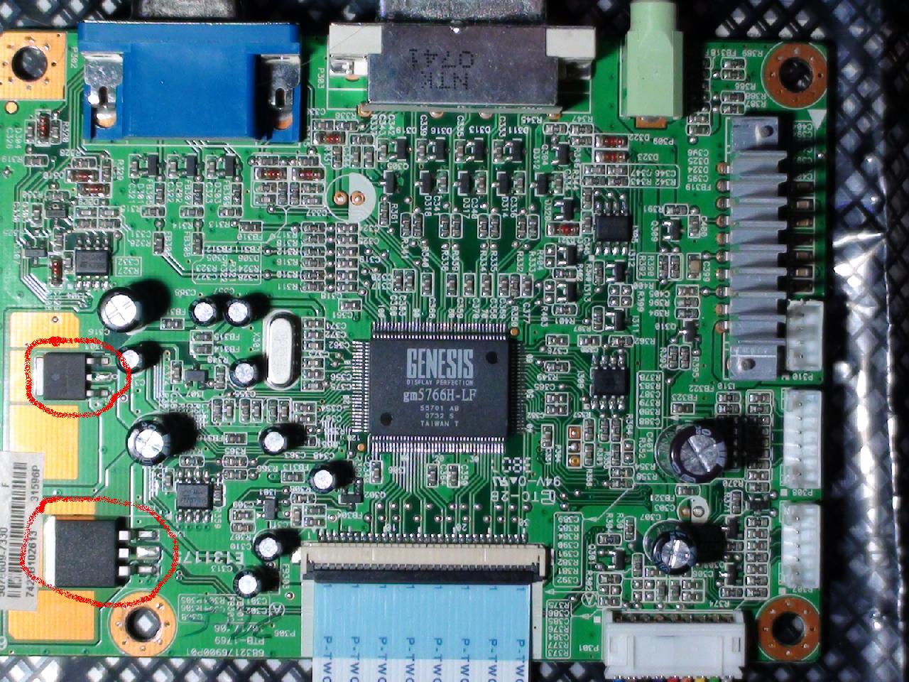

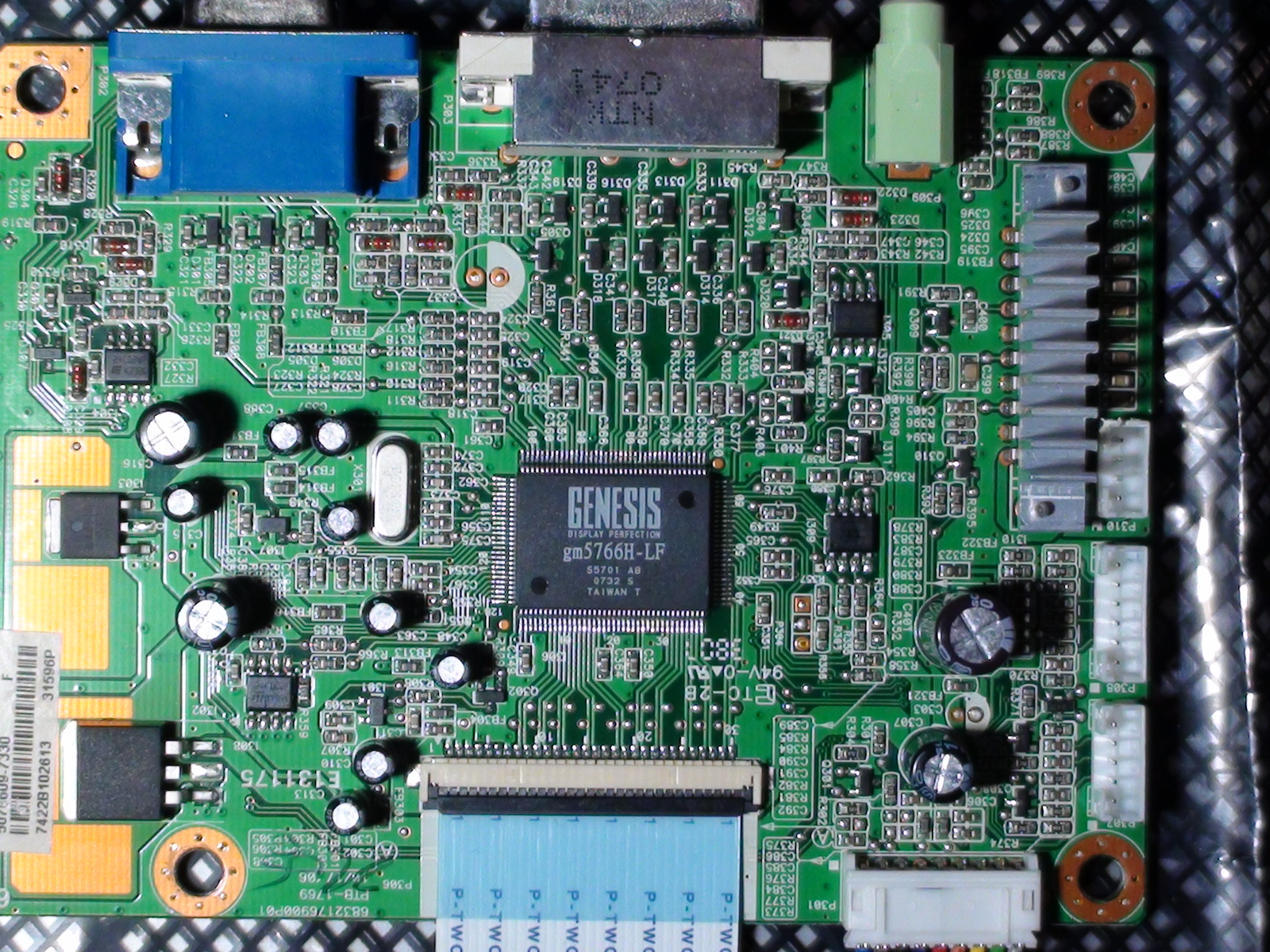

        Here are the pictures of the two boards. I'm not sure of the official name for the board that provides the power so I named it "Power Supply Board". Also, I did not take any pictures of the T-CON board. If it is needed, I will take one though.

              You have 2 voltage regulators on the logic board (circled in red).
              1) What is the part number of each?
              2) What is the DC voltage of each pin with respect to ground?
              3) Post a picture of the panel board as well so we can suggest test points.

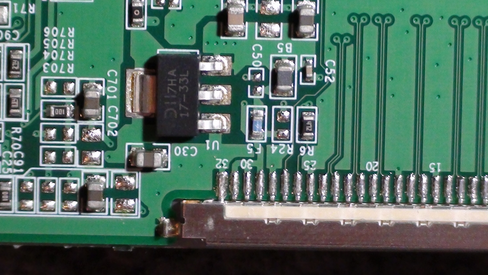

                  Okay, so on the T-CON board, I was looking next to the ribbon cable connector and noticed an SMD that is labeled F5. I tested the resistance and it measured open. I believe this is the fuse. It is above pin 29 and 30 of the ribbon cable connector.
                  I am attaching a picture of that section of the board. I can also send a picture of the whole board but I doubt anyone will be able to see anything in detail because of the limitations for the file uploads.
                  If this is the fuse? If so, any suggestions on a replacement?
                  -- Law of Expanding Memory: Applications Will Also Expand Until RAM Is Full
                    Re: HP 2007W LCD Monitor
                    That is it! the main VCC fuse feeding the T-CON board. You should Ohm out the top end of the fuse and Pin 32 which is Ground to see if it shows shorted circuits, the shorts can also be after the active switches that may not show up with the Ohm meter connected to the fuse.
                      You can set your DMM in DC amp (10A range) mode and connect the probes across the fuse then you can see how much current it draws. I usually use 1 Ohm Metal Oxide resistor in place of the fuse to try it out, then measure the voltage drop across the resistor then I can calculate the current draw and just double up the value of the current reading for the fuse rating.

                        I was getting ready to measure the voltage on the regulators. The part number for the smaller one is az1117d-1.8e1. I believe for the larger one it is 1084-33. 0736AL is below 1084-33.
                        I plugged in the power cord and turned it on. There was a noise like someone touched two hot wires together. There was a smell of smoke and I'm almost certain I damaged the power supply board of my system.
                        I believe the four plugs that plug into the side of the power supply board were plugged in to the wrong holes. I think these plugs are for the CCFL lamps. There's two groups, with two plugs in each group. I believe in both groups, I switched the plugs on accident. I plugged plug 2 into the plug 1 hole and vice-versa. Same with the second group.
                        I have no idea what I'm going to do now. I physically can't see anything wrong with the board. It was the board that was sparking. I don't know if I fried the lamps or what. I don't even know if this is what caused it. Just one of those days I guess.
                          Oooh, you are not suppose to run the inverter without the load, since those connector will have about 1500~2000Vac on them, probably arc over the terminals. Look and see if you can see any carbon traces, scrape them off real well. The Inverter may have gone into shutdown fast enough to protect itself, the inverter has detection circuits that detect no load or overload.
                          Plug the lamp connectors back in securely and try powering them up again.
