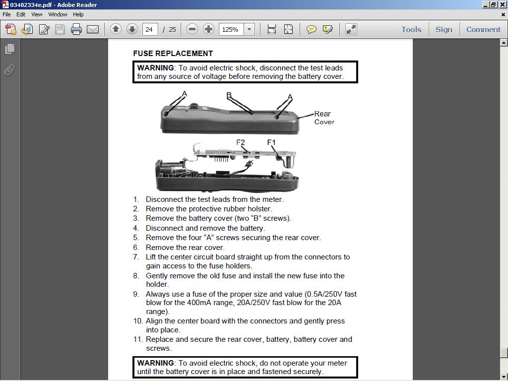

            Okay. I think there's something wrong with the multimeter and that is why I did not get any reading while we by-passed the fuse. The screen is old but if we tap the side, there's a picture of a blown fuse on the screen. I've ripped it apart and all I can find is the fuse for the 400mA port. Despite the picture on the back of the DMM, there appears to be no 20A / 250V fuse. There's a spare fuse in there but it's just that, a spare.
            -- Law of Expanding Memory: Applications Will Also Expand Until RAM Is Full

              • retiredcaps
                • Apr 2010
                • 9271
                #47
                Re: HP 2007W LCD Monitor
                One or more of your fuses in the multimeter could be blown through accidental use?
                I know on my Fluke 75, I can do the following to test the internal fuses. It may or may not work for you.
                1) Put your black probe into the COM jack.
                2) Red into the V jack.
                3) Put your dial onto Ohms.
                4) Take your red probe and put it into the mu/ua jack. It should read less than 2 ohms.
                5) Take your red probe and put it into the 20A jack. It should read less than 2 ohms.
                Report your findings for 4 and 5. If you get 0L for 4 and 5, it could mean your fuse is blown.
                Again, this may not work for you.
                        I get almost 1K for the uA - mA port and 0L for the 20A. I ripped the whole meter apart earlier looking for the 20A fuse and I cannot find anything. Only a fuse for the 400mA port which reads 500mA for the fuse. Maybe it was an efuse or whatever those are called?
                            1K for the uA/mA sounds correct which means your 500ma fuse is okay. Sometimes, there is a 1K resistor in the jack for protection.
                            On the front of your multimeter, it clearly shows that the 20A is fused. The fuse could be on the other side of the multimeter pcb. However, I don't want you possibly wrecking your multimeter looking for it.
                            I'll see if I can find your multimeter manual online.
                                I cant find it but did find this for their current model - fuses might be in the same place? Id have thought they should be reasonably accessible.
                                  I couldn't find the manual either and generally I have been able to find other Craftsman models.
                                  Yes, the fuses could be on the "underside".

                                    Hey guys! Sorry I haven't gotten back to you guys until now. I was in the ER. I was replacing the valve cover gasket on my Jeep. I borrowed some tools from my father, after using them, my hands and part of my arm turned all red and felt like some one poured gas all over it and set it on fire. The docs said it was a chemical burn. It sucks and my hands are all wrapped up now.
                                    Anyway, I ripped apart my multimeter and took out the PCB. You guys were right, there was a fuse in there and it's blown! It looks like a ceramic fuse but instead of being white, it's a darkish gray. I have a white ceramic 250v 10A fuse that I was thinking of using until I can get a 20A one. Worst case is it'll blow if I go over that limit, right?
                                    And even better news! For the longest time, my multimeter screen would go out. Like I could read all the numbers some of the time but other times it was cutting out. I ripped apart the screen part and cleaned everything. There were glass connectors. It was cool. Works like a charm now!
                                      Jeez, that is scary. Hopefully they will heal soon.
                                      It was probably white until it blew.
                                      Yes a 10A will blow faster than a 20A fuse if you measure more than 10A.
