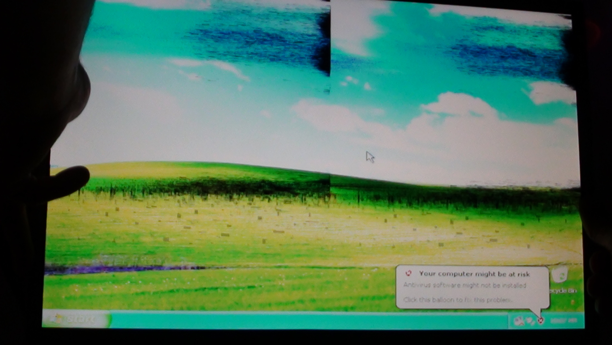

        K, so I did the 1/4w 1ohm resistor and now we're getting something on the screen. It's a jacked up picture of the background on the PC we have it connected too. Is this because the TCON board is shot like we thought or is there any chance of salvaging it at this point in time? I never thought we'd get this far, honestly....
        here's a photo of the display

          That is strange looking screen, do you get 3.3vdc from that IC. I still do not understand why you did not see anything on the screen when you bypass the blown fuse with the meter. The T-CON is shot. We need to find out which component shorted out, but we can only do so far.

            Okay. I think there's something wrong with the multimeter and that is why I did not get any reading while we by-passed the fuse. The screen is old but if we tap the side, there's a picture of a blown fuse on the screen. I've ripped it apart and all I can find is the fuse for the 400mA port. Despite the picture on the back of the DMM, there appears to be no 20A / 250V fuse. There's a spare fuse in there but it's just that, a spare.

              I did get a 3.3vdc from that regulator on the TCON board. I also checked what I thought was a little regulator on the logic board. Is this broken or is it something else? The other little ones on the logic board seem to measure higher voltages. I'm attaching a picture. Sorry for the crappy job on it, I'm not too skilled at making nice pictures. There's also another regulator on the TCON board opposite side. It's the only other regulator on that board. It seems fine. Reading around 3VDC for the input, 1.7VDC for the middle pin and the output.
              Also, on the back of that TCON board, there's a ton of test points with labels on them. Stuff like VCOMX78, YVGG1, BR2P1...You think those could help me in testing this board? Maybe there's some definitions on what they all mean. Got any links?

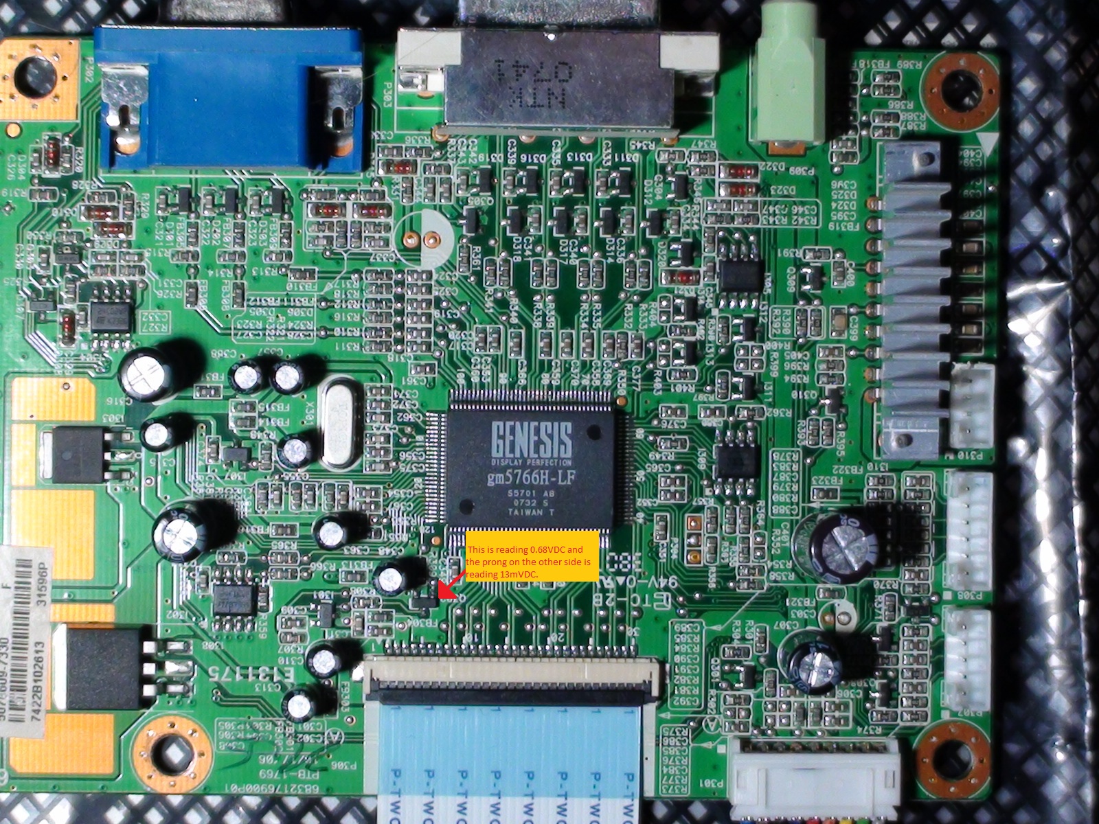

                  That 3-pin device on the logic board is a transistor, you are reading the Base-Emitter junction voltage which is about 0.6~0.7vdc when it is bias on, so that is normal.
                  The logic board provide 5VDC for the T-CON by that switched transistor as I indicate earlier, that 5Vdc is generated in the main power supply board and is fed to that transistor, the Controller IC sends the signal to turn on the transistor when the monitor detects the video signal from the PC, or it will go to sleep when the video signal is no longer present, same thing for the backlights this is done to save power.
                  The 1.7~1.8V you get from another regulator on the T-CON board is probably for the big IC for timing/signal processor of the T-CON board, same as the 3.3v regulator.
                    The part number on the regulator tells you the correct output voltage. For example, on an AL1117-18, the suffix indicates that 1.8V is the correct voltage.
                    1.7V is not an usual voltage. It is normally 1.8V. Most voltage regulators have a 1% tolerance.
                    So
                    1.8 x 0.99 = 1.782V
                    1.8 x 1.01 = 1.818V
                    So anything in between is fine.
                    (1.8 - 1.7)/1.8 = is 5.5% difference which suggests the voltage regulator is failing "low". You may want to remeasure and confirm.

                      Make sure to put meter in a finer scale so you can read at least 2 decimal point, I have a feeling he has it set to high range.

                        She reads 1.81VDC on the middle pin.
                        That 3-pin device on the logic board is a transistor, you are reading the Base-Emitter junction voltage which is about 0.6~0.7vdc when it is bias on, so that is normal...
                        I'm starting to understand I believe. I know this has taken up a lot of your guyses time. I've learned so much though since I first started. I've never really understood how the digital electronics stuff worked. I can solder the stuff on and off, but understanding it, that's a whole nother story!
                        Okay, I've had it on auto-ranging. The finer scale definitely gives me more accurate readings. Thanks
