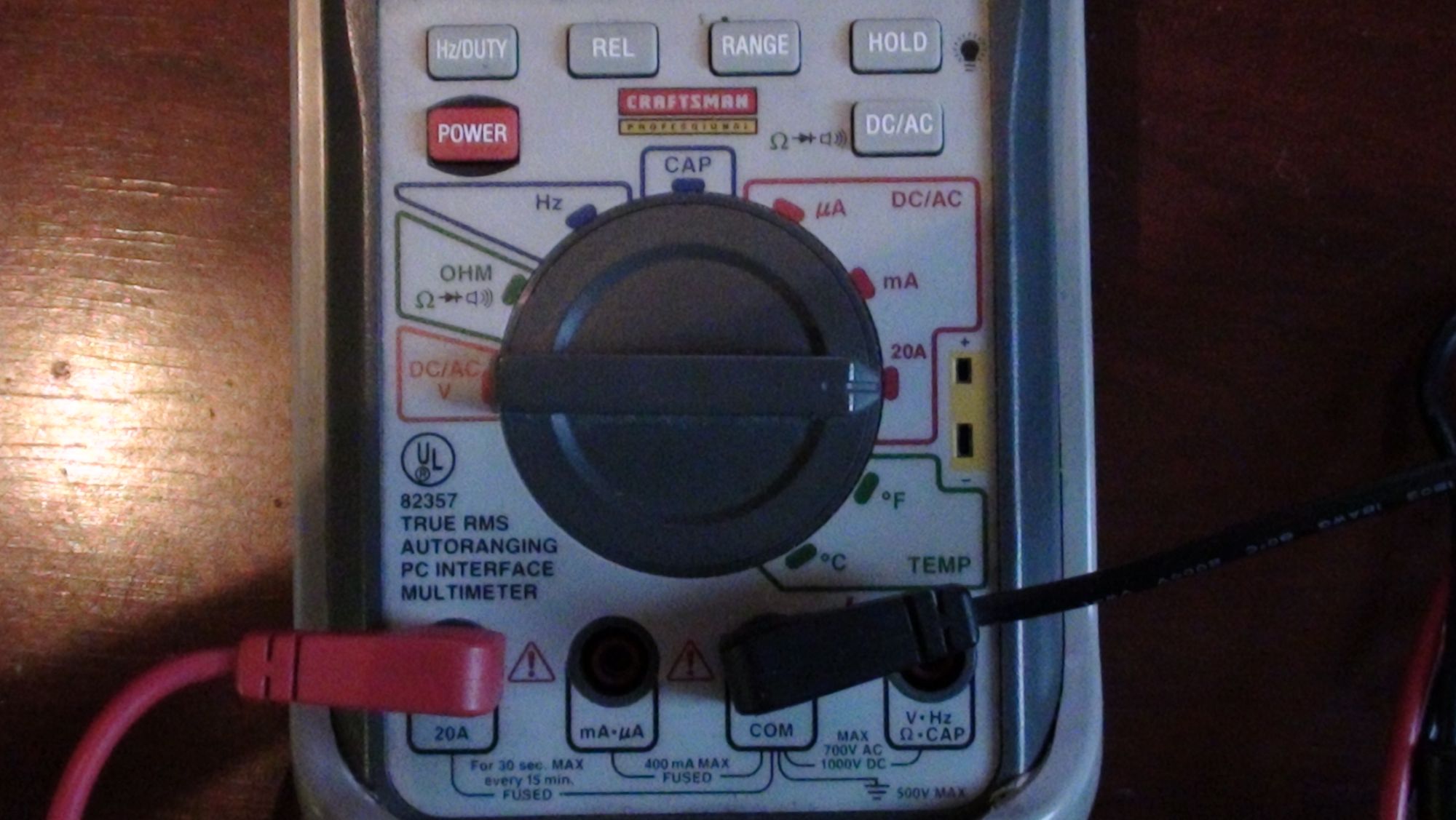

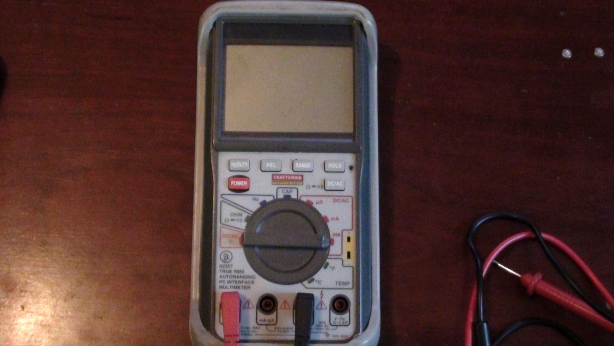

        Originally posted by budm
        You are basically jumping the open fuse with the Meter (set to DC AMP mode, the Red probe on the meter will also have to plugged inot the AMP probe inlet if the meter has separate V/Ohm and AMP input, the meter will show how much current the T-CON board is flowing, or you can use 1 Ohm instead of using the AMp meter.
        Multimeter tutorial (less than 5 minutes). It covers how to measure amps.
        http://www.youtube.com/watch?v=bF3OyQ3HwfU
        --- begin sig file ---
        --- end sig file ---
        • Spork Schivago
          • Mar 2012
          • 4734
          • United States of America
          Re: HP 2007W LCD Monitor
          Okay. That makes sense. I did have the probe plugged into the 20A input. I know where to put the red probe, right after the fuse, right? Where should I put the black (common) probe? On a ground some where or close to where the red probe goes? Here's two pictures of my multimeter. It's an old Craftsman 82357 but it still works fine.
          Last edited by Spork Schivago; 03-05-2012, 04:27 PM. Reason: typo graphical error correction
          -- Law of Expanding Memory: Applications Will Also Expand Until RAM Is Full
            Red probe on one end of the fuse, black probe on another end of the fuse, DO NOT LET THE PROBE TOUCH THE CHASSIS, or you will blow the fuse for current measurement section of the meter. You will have to at the screen while doing this to see if you will get the image on the screen. See what the current reading is also on the meter, make sure to put it into DC AMP mode.
            • Spork Schivago
              • Mar 2012
              • 4734
              Wow, that was cool. I knew about all the other functions, however, the AMP stuff I didn't know about. I have been using it to test batteries but nothing else. I tried unsuccessfully to measure it. I set it to 20A, put the common before the fuse and the red probe after the fuse. Turned on the monitor while it was hooked to a PC and couldn't get a measurement at all.
              Is it possible that I damaged something from shorting it out last night to the point where the T-CON board isn't getting what it needs? I measure the voltage coming into the logic board and it all seems to check out. 5V is 5V, VCC is 5V, etc.
              Sorry for posting questions about how to do this after you write a message like the one with the link. I start writing my question before you write the message and by the time I ask it, it seems you have sent me something that answers my question.
