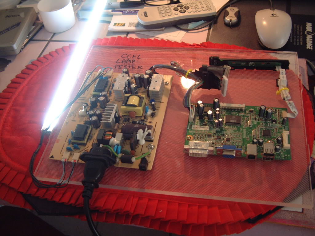

                                  Re: What to do w/ 'Bad' LCD Monitors?
                                  This is what I do with the them.
                                  • DMCrimson
                                    • Feb 2012
                                    • 58
                                    • Finland
                                    Heh, I see you used a lot of an old monitor there Not a bad idea at all...
                                      The mounting plate came from inside the LCD panel asembly, they are great for a lot of projects.
