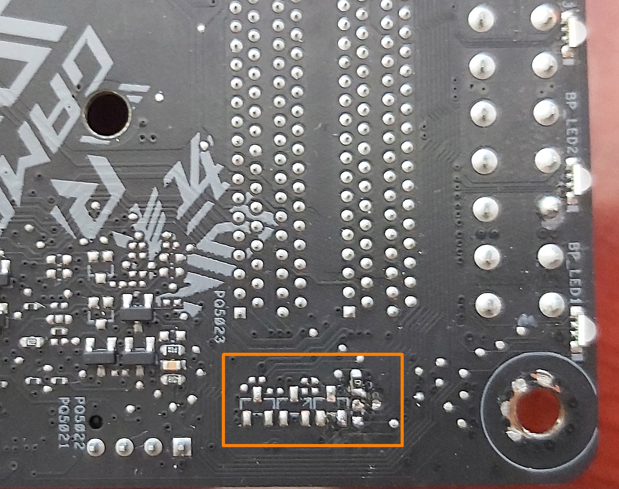

    I have an Asus Rog Strix B360-I Gaming with missing parts. I know there is a resistor missing for sure, but nearby it seems there might have been also a transistor or mosfet. Below the picture of the area on the board with the missing parts. The interesting area is inside the rectangle.

    I'd appeciate if somebody could make a detailled picture of this area from a working board and post it here. Getting the parts values would also be helpful. The revision of the board is 1.02 .

    It seems to me that you're only missing another resistor. See this pic (source). The resolution of the picture only hints that the missing resistor has 2 digits written on top, so it might not have the same value as the one you still have on that area.

      Hi Cloppy007, thank you very much for this link. It really confirms that only a resistor is missing. I just mounted on hit or miss a 0 ohms resistor in the missing place, and the board started to work. I do not have a confirmation the value is correct, but the board is working w/o issues since several hours, so the target is achieved.
