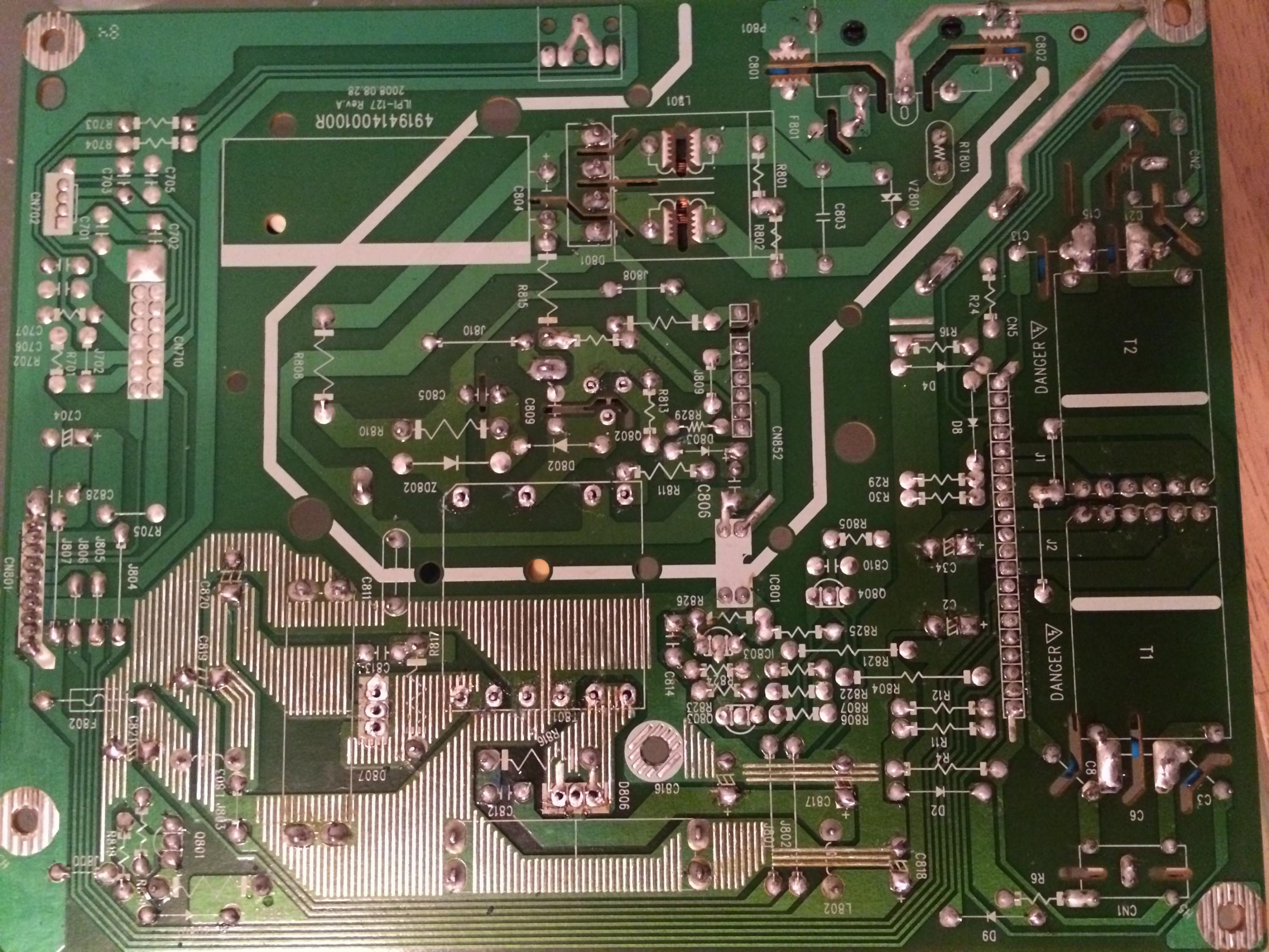

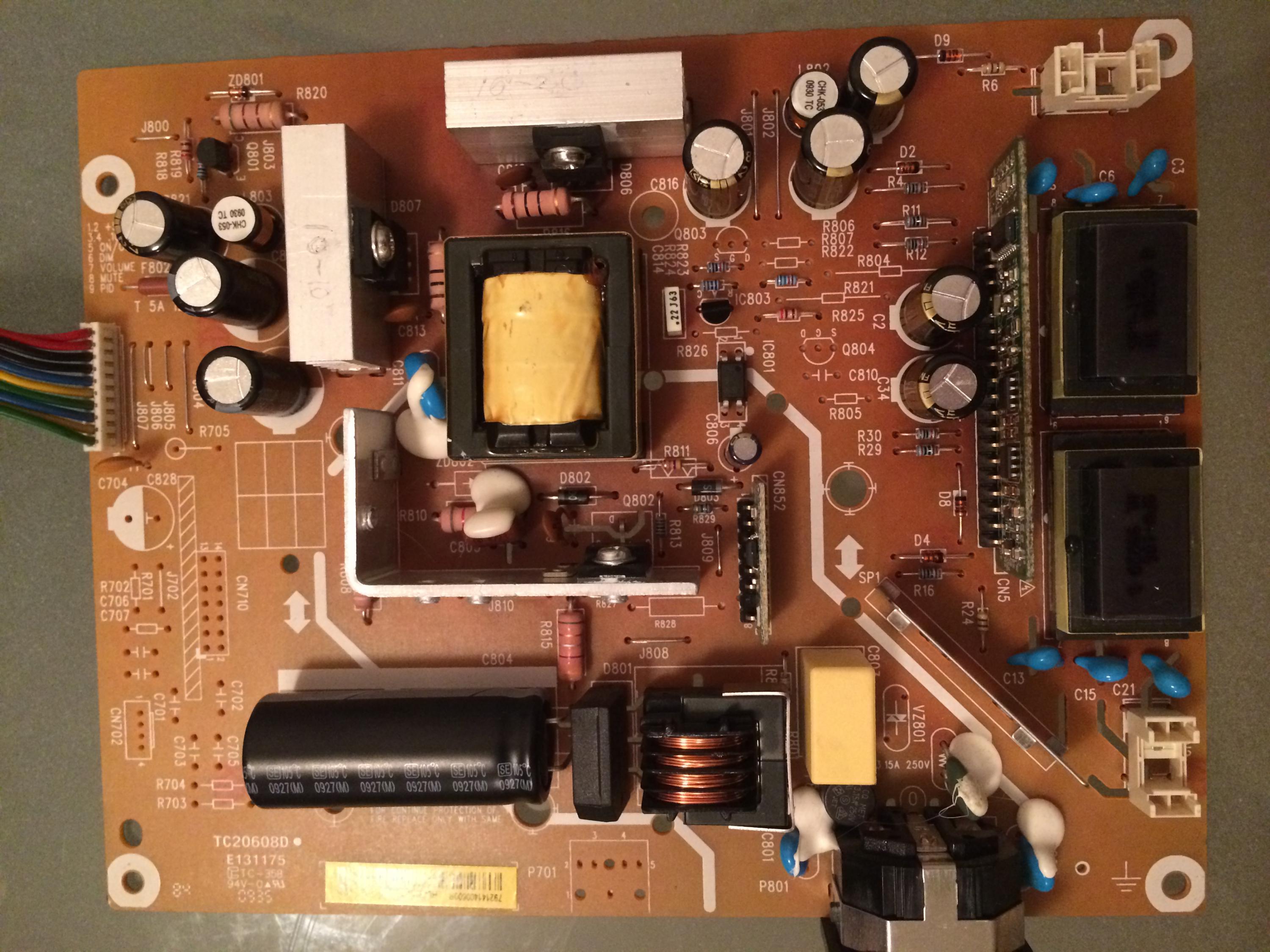

Repairing a FujitsuSiemens LSL3230T
  • axh174
    replied
    Re: Repairing a FujitsuSiemens LSL3230T
    So I've been poking around with this board and I'm pretty sure I've narrowed the problem down to one of the two dual-package 60V MOSFET ICs on the Inverter Board/Riser Card (which can be see as the "wall" on the right half of the power board separating the inverters from the transformer.)
    The story:
    I began a systematic effort to try and test all resistors, diodes, semiconductors, and capacitors on the board. Obviously, testing some components while on the board can be tricky, but many of them can remain on the board and give a reasonable indication of proper function. What I noticed was that on one half of the board I could not use my multimeter's diode tester to induce a charge in the capacitors; I was continually getting shorts across all of them (even the ones I had replaced). Through strategic desoldering of one or two components, I was able to isolate the short and discover it existed on the inverter board/riser card. One of the power pins on this card was shorted to the ground pins. I desoldered the inverter board/card from the power board, and all shorts on the power board disappeared.
    Closer inspection of the inverter card/board revealed that one of the ICs on the board, a 9945N 60V N-Channel MOSFET package, had its source, gate and drains all shorted together. I managed to desolder this IC and probe it off-board to confirm it is indeed the source of the short and not the board.
    During this whole process, I was also able to confirm that the transformer does put out the required 18V to the inverters and the 5V to the logic board, and that as suggested earlier by budm, an over-voltage condition likely existed that prevented the transformer from performing properly.
    So I'm in a position to obtain a new 9945N from Mouser and solder it to the inverter board/card. Though before I do, can anyone offer their insight on how/why one of these ICs would blow? I was told they sometimes just die. But if that's not the case, I'd hate to solder a surface-mount component just to have it die again from whatever killed the original one. Anything I should look for on the inverter board/card or power board to see if something damaged the original IC?
    Thanks for the help!
    Last edited by axh174; 04-30-2014, 07:12 AM.
    Leave a comment:
  • axh174
    replied
    Re: Repairing a FujitsuSiemens LSL3230T
    Resoldered all the components back on and here are the results:
    Voltage across main capacitor: still 166.7VDC
    With logic board attached, I'm measuring 1.67VDC on pins 1 and 2 of the connector.
    With logic board disconnected, I'm measuring 3.0VDC on pins 1 and 2 of the connector.
    Ground was taken to be one of the heat sinks on the secondary side (same potential as pins 3 and 4 of connector).
    Also rechecked the switching MOSTFET. With my meter in diode test mode, applying voltage/charging the gate pin creates a short between source and drain regardless of probe placement on the pins. Discharging the gate pin causes an open between the source and drain IF the positive probe is on the drain and the negative is on the source. If I bias it such that the positive probe is on the source and the negative on the drain, I get a 0.526 voltage drop. Is that normal? Is there a diode of some sort built into this MOSFET? I would have thought you'd not want a path from source to drain with the gate discharged.
    Last edited by axh174; 04-12-2014, 12:06 PM.
    Leave a comment:
    replied
    Re: Repairing a FujitsuSiemens LSL3230T
    OK, the power supply is an always on, meaning that it will run and puts out voltages the minute you apply 120VAC to it without having any other boards connected to it.
    So put all the parts back in place and power up the board by itself and see if you do get the voltages at the connector to goes to the main board.
    Last edited by budm; 04-11-2014, 11:25 AM.
    Leave a comment:
  • axh174
    replied
    Re: Repairing a FujitsuSiemens LSL3230T
    Hi Budm, thanks for your help.
    I've attached images of both the front and back of the power board. The backside of the board is from right after I desoldered the transformer, secondary side rectifying diodes and switching MOSFET for testing (so that's why those solder joints are not present). I also have some images of the transformer by itself that I can upload as well if you'd like to see them.
    Any suggestions on what portion of the board/where in the circuitry would be the protection circuit? I'm taking a look at some other power board schematics to get a general feel for how these things are put together, but I haven't fully digested them yet.
    A little bit of the history of the board:
    The owner of the monitor said that it was working fine, he got up and left the room to bring in some groceries, and when he returned the monitor was dead. The power LED does not light up when the monitor is plugged in, and it is unresponsive to all button presses.
    The first thing I noticed was some of the original capacitors were bulging (but no leaks), so I replaced all of them except for the large "reservoir" (startup?) capacitor that helps smooth out the rectified voltage coming from the wall outlet.
    After replacing the capacitors, I reflowed a lot of the solder to make sure there were no bad connections and then reassembled the monitor, but there was no change. I then started to troubleshoot a few things: I measured 120 VAC into the diode rectifier bridge, and 160 VDC across the main capacitor. I measured 3.0 VDC heading to the logic board (which seems low, I was expecting 5 VDC), and no voltage heading to the backlight inverters. Both the main line fuse and the fuse for power to the logic board are both intact. I then desoldered the transformer, the secondary side rectifying diodes, and the switching MOSFET for testing. Both rectifying diodes seems to test OK and the MOSFET as well (though I'm going to double check that). I measured the resistance of the Transformer primary and secondary sides and noticed a couple of what I feel are odd things, like discontinuities on the secondary side. But I'll describe that in another post since this one is now getting rather long-winded.
    Last edited by axh174; 04-11-2014, 09:55 AM. Reason: Provide additional information.
    Leave a comment:
    replied
    Re: Repairing a FujitsuSiemens LSL3230T
    Clicking and ticking can be the sign of the SMPS going into shutdown-startup cycle due to the protection circuit detect the fault, or the startup cap is not functioning. Of all the repair I have done, I never have to replace the power transformer yet, but not saying that it is possible.
    Can we see the pictures of your board, both sides?
    Last edited by budm; 04-10-2014, 09:03 AM.
    Leave a comment:
  • axh174
    replied
    Re: Repairing a FujitsuSiemens LSL3230T
    Oh, another piece of interesting information:
    I tried finding the HSG1067 service manual figuring that it would include part numbers. I wasn't able to find it, but in the process I stumbled on the LG Flatron W2234S service manual, which includes a schematic for the power supply that seems to match the HSG1067 very closely from the traces that I've followed, although I admit it's not exact.
    In any event, the transformer listed in this service manual is:
    Code:
    XFMR SW DIP ER28 PC40 650uH SPW-100 RoHS
    Part #: 426000091000R
    I haven't been able to find much on this transformer either. But given the similarities between the power supplies, the SPW-134 also appears to be a 4-pin input of 2 separate windings on the primary, and a 6-pin output of 1 winding with 4 center taps on the secondary. 160V DC in, ~16V and ~5V out.
    Leave a comment:
  • axh174
    replied
    Re: Repairing a FujitsuSiemens LSL3230T
    Bump!
    Originally posted by DMCrimson
    I'm beginning to wonder if the transformer itself is faulty - it has markings as follows:
    Code:
    SPW-134 A
    E140167
    LSE-B3 0839F3
    clicking/ticking might be due to failing insulation, so if I was to replace it, what are the specs? Search over the net yielded nada.
    Any luck on being able to identify this part?
    I'm trying to repair a Hannspree HSG1067 LCD Monitor's power supply, which, from some of the surfing I've done, seems to have an identical power supply as the Fujitsu Siemens LSL3230T.
    As DMCrimson indicated, a search for "SPW-134" over the net has yielded zero results, except for the reference made here. The markings on my particular transformer are:
    Code:
    SPW-134
    SBI 4.2 E156193
    FEC 0924 A g
    I'm fairly certain this is the cause of my troubles. It doesn't look all that healthy: it makes a rhythmic fizzle-pop (like a charging and shorting sound), and I've checked the rectifier diodes (10-10 and 10-20) and MOSFET switch which appear to be good.
    I've done quite a bit of digging around to try and understand what exactly this transformer is, but I've run into a decent amount of confusion. As I understand it, this is a High Frequency transformer utilized in a pulse mode, isolated flyback circuit. But whenever I search on Mouser/Digikey/web, I find that separate categories exist for "Pulse Mode", "Switch Mode", "High Frequency", "Power" and "isolated flyback" transformers.
    -Kevin
    Leave a comment:
  • DMCrimson
    replied
    Re: Repairing a FujitsuSiemens LSL3230T
    Hmm... wc_robot has srf10150 where I have srf10-20. That's weird. Also, I remeasured that 10-20 and it seems shot - dmm shows 0,002V for forward voltage.
    Leave a comment:
  • DMCrimson
    replied
    Re: Repairing a FujitsuSiemens LSL3230T
    Now, are there any suitable replacements for those Schottky's mentioned, SRF10-10 and SRF10-20? Also, that MOSFET, AP2761P-A? Just on the safe side for the future...
    Leave a comment:
  • DMCrimson
    replied
    Re: Repairing a FujitsuSiemens LSL3230T
    I've beem unable to do a thing on this. We moved recently and subsequently filed for divorce... Currently I'm trying to study at TUAS, but not on full power as I have both depression and panic attacks. I just hope I get my own apartment, then I think I can focus on these things better.
    Leave a comment:
  • wc_robot
    replied
    Re: Repairing a FujitsuSiemens LSL3230T
    long delay in response, this is kind of a whenever-I-have-10-minutes-to-investigate type of project
    The dell monitor my board is from is a Dell 22" E228WFPF Widescreen Monitor.
    Just for the hell of it, I took the power brick (it outputs a 12VDC supply into a monitor) from my 10+ year old "FujiPlus" 19" 4:3 lcd... aka, no-name brand ancient thing. I was kind of surprised to find almost the exact same circuit in a different layout... same cap, same transformers, same relay, etc. etc. Although, the primary on both transformers is 4 leads, and the secondary on the FujiPlus powerbrick only has 2 of the 6 pins used in the circuit.
    Rtech is correct about the schematic though. There is one FET which has the Drain lead going into one of the two middle pins on the primary. The secondary on the Dell, the 6 pins are soldered in 3 sets of 2: the set in the middle is ground; the set on the left are connected to the two outside pins of one schottkey diode (SRF10-10 - Diode Schottky Diode 100V 10A 3ITO-220AB), which is mounted adjacent to the transformer's secondary on the other side. The set of pins on the right from the transformer's secondary go to the two outside pins of the other schottkey diode (SB10150FCT - 10A HIGH VOLTAGE DUAL SCHOTTKY BARRIER RECTIFIER). It's worth noting that this one (the SB10150FCT) has a bigger heatsink than the FET and the SRF10-10. (On the powerbrick for the fujiplus monitor, they all just use the brick's frame as a heatsink--and I didn't confirm part numbers for that, but likely the same part from a shittier manufacturer).
    For the FujiPlus board, the two outer pins of those schottkey diodes are all soldered together, and the two middle pins are soldered together. The 4 outer pins connect to one of the two secondary pins, and the other pin from the secondary goes to ground.
    I desoldered the FET and checked it -- works fine. I have not yet checked the schottkey diodes, but I will... I suspect it's the SB1015.... (the one with the bigger heatsink). I also confirmed that the ticking is indeed coming from the transformer. I rolled up a piece of paper into a ~2cm diameter tube and placed one end right up to my ear and the other end right on top of different parts of the circuit, moving around from FET to diodes to caps to the yellow transformer. It's very obvious that it's only coming from the transformer -- but I suspect caused by a shot schottkey (SEE WHAT I DID THERE?!)
    I'm too lazy to take a picture right now, but if this doesn't make any sense I will.
    It's nice having another circuit working to compare values to
    Now I want to buy all those broken LCD monitors on craigslist for $10 and replace the 50 cent part then resell!
    Leave a comment:
  • Rtech
    replied
    Re: Repairing a FujitsuSiemens LSL3230T
    Originally posted by DMCrimson
    Rtech: I've measured them earlier onboard, post #17, but will redo.
    If they measured well, then take them out and then power on as suggested earlier and see what you get ref the clicking.
    Leave a comment:
  • DMCrimson
    replied
    Re: Repairing a FujitsuSiemens LSL3230T
    Rtech: I've measured them earlier onboard, post #17, but will redo.
    Leave a comment:
  • Rtech
    replied
    Re: Repairing a FujitsuSiemens LSL3230T
    The Schottky Diode, maybe more than 1, are NOT the 4148s, but will be mounted on a Heatsink, and it is probably the one nearest the Transformer.They are usually 3 leg devices,and the secondary of the Transformer will normally go directly to the outside pins on the device.
    Leave a comment:
  • DMCrimson
    replied
    Re: Repairing a FujitsuSiemens LSL3230T
    Oh: would you tell the model of Dell monitor you have?
    Leave a comment:
  • DMCrimson
    replied
    Re: Repairing a FujitsuSiemens LSL3230T
    Thanks Rtech. I'll need to check the diodes (did you mean those 1N4148's I already changed?) and the mosfet - thanks for pointers
    wc_robot: There's an ongoing auction @ ebay, which has suitable board - I think that might be for you: http://www.ebay.com/itm/Hannspree-HF...8&cmd=ViewItem as the seller will only ship to states.
    Leave a comment:
  • Rtech
    replied
    Re: Repairing a FujitsuSiemens LSL3230T
    The integrity of this transformer,not this Model,but where it is in the circuit, has been questioned a number of times,NOT just for this board,but in many different ones.As far as I know none have been found faulty,and as yet after working on over 400 Monitors,I have yet to see one go faulty !!!.I have no schematic for this,but I suppose it will be pretty standard,and the secondary feeds Schottky diodes ??,and I would certainly take them out of the Board,a) to test them,and b)to power on with them out and see if the symptoms change.
    I also suppose that there is a Mosfet fed by a SMPS chip,and if necessary I would also take that out,and this may help to check it :-
    http://www.4qdtec.com/mostest.html
    Leave a comment:
  • wc_robot
    replied
    Re: Repairing a FujitsuSiemens LSL3230T
    did you ever figure this out? I have the same problem on a Dell 21" LCD monitor, and the power board is almost identical to yours... same board number E131175 on the front, slightly different layout, few minor changes (e.g. 100uF 450V cap instead of 120uf 450V). I also tried replacing some components I suspected failing (the big cap, a few diodes on the AC high voltage side, etc), no luck.
    Most significantly, when powered, mine is also clicking (about 100 times per second). I'm almost certain it's the yellow LSE-B3 transformer. When power is removed, it clicks at a rate directly related to the voltage in the large cap as it drops--slower and slower over about 10s while the big cap goes from fully charged (mine only gets to 164V) to empty. Due to the weird frequency of the clicking, I'm suspecting one of the smaller caps is charging up then the transformer shorts internally, and that cycle repeats.
    My windings on side 2 are the same -- 0 ohms.
    As for the 4 pins on side 1, i also get 0 ohms on 3-4, and 0.2 ohms on 1-2, but for all your ~5 Mohm values I have 148 Kohm
    Let me know if you've solved your problem yet & how. If I can find a suitable replacement for this T, I'll try it out. Thanks!
    Leave a comment:
  • DMCrimson
    replied
    Re: Repairing a FujitsuSiemens LSL3230T
    Could it be the feedback via opto? My neighbour told me the monitor ceased working all of sudden with no warning at all.
    Leave a comment:
  • DMCrimson
    replied
    Re: Repairing a FujitsuSiemens LSL3230T
    Primary side (AC) has 4 pins
    measurements:
    1-2: 0,2 ohm
    1-3: ~5 Mohm
    1-4: ~5 Mohm
    2-3: ~5 Mohm
    2-4: ~5 Mohm
    3-4: 0 ohm
    secondary side has 6 pins, but can be treated as 3 pins as they're soldered in groups of two:
    zero all around.
    Leave a comment:
  • osrex
    LED DRIVER KEEPS DYING
    by osrex
    Hello, this is my first post and im just a beginner, so be easy on me guy. thanks
    i have a LED chandeilier that switches colors from white to cool white to warm when toggling the switch, it has 24 LED arms, each arm is 30 CM length.
    i have no datasheet at all for the LED lights, all i have is its length.
    long story short, testing the chandelier on the ground, and it works fine for 1 - 2 - 6 hours, no problem.
    as soon as i fix the chandelier to the ceiling and bury the driver inside the hub,...
    05-05-2025, 03:36 PM
  • howardc64
    Vizio E55-F1 dark backlight zones. LED failure or Dimming Zone Driver?
    by howardc64
    Problem
    Fixing a dimming zone TV with LEDs not lighting up. Dimming zone circuit introduces added variable to diagnose LED and/or Dimming Zone Driver board? Some 1/2 rows of LEDs appears to be out in active dimming zone off AND some brightness flickering with active dimming zone high while playing changing video
    Model & Board Pics
    Conflicting Spec
    Vizio indicate this TV has 10 dimming zones. However, LED strips and Zoned light driver connector suggest 12
    https://www.shopjimmy.com/vizio-gj-2k1...
    10-10-2024, 01:16 PM
  • charif
    Audio Driver for Thomson P14C4BK128
    by charif
    Need Audio Driver for Thomson P14C4BK128 (Windows 10/11)
    Hi everyone,
    I'm looking for help finding the correct audio driver for my Thomson P14C4BK128 laptop.
    The sound is not working properly, and I believe the audio driver is missing or not installed correctly.
    Here are the details:
    • Model: Thomson P14C4BK128
    • Operating System: Windows 10 64-bit
    If anyone has a working link to the driver or knows where I can download it, I'd really appreciate it.
    Thanks in advance for your help!
    04-30-2025, 05:41 PM
  • bohaboha
    how to install gl usb2.0 uvc camera device driver on windows 10
    by bohaboha
    Hello all am trying to reinstall my AMCAP Microscope on windows 10 but it is not working anymore. But the cam and the drivers are present in the Device Manager but there it saysWindows cannot load the device driver for this hardware. The driver may be corrupted or missing. (Code 39) the drivers is : gl usb2.0 uvc camera device driver and i also get this mesage: Windows found driver software for your device but encou​ntered an error.
    but it is quite strange because it did work on this same OS for one week ago and even for sometimes ago on that same but now nix.
    any help?
    01-26-2025, 08:33 PM
  • Daveleone
    UN55D6900 BN44-00428B partial led driver circuit failure
    by Daveleone
    Hello TV experts! I have a UN55D6900. The successfully TV turns on, and the backlights light up, and I get a picture, but there is a section that is dim. I took it apart and 1 out of 4 segments of backlight LEDs are not lighting on both sides of the TV (in other words, the same segment is out on both LED strips).
    I tested the LED strips with my LED tester and all of the LEDs light properly, so I believe the problem is with the PSU/LED driver board (BN44-00428B). The voltages at CNM810 (between PSU and main board) look ok to me. The voltages at CNL801A and CNL801B look off for one...
    07-23-2021, 06:31 PM
