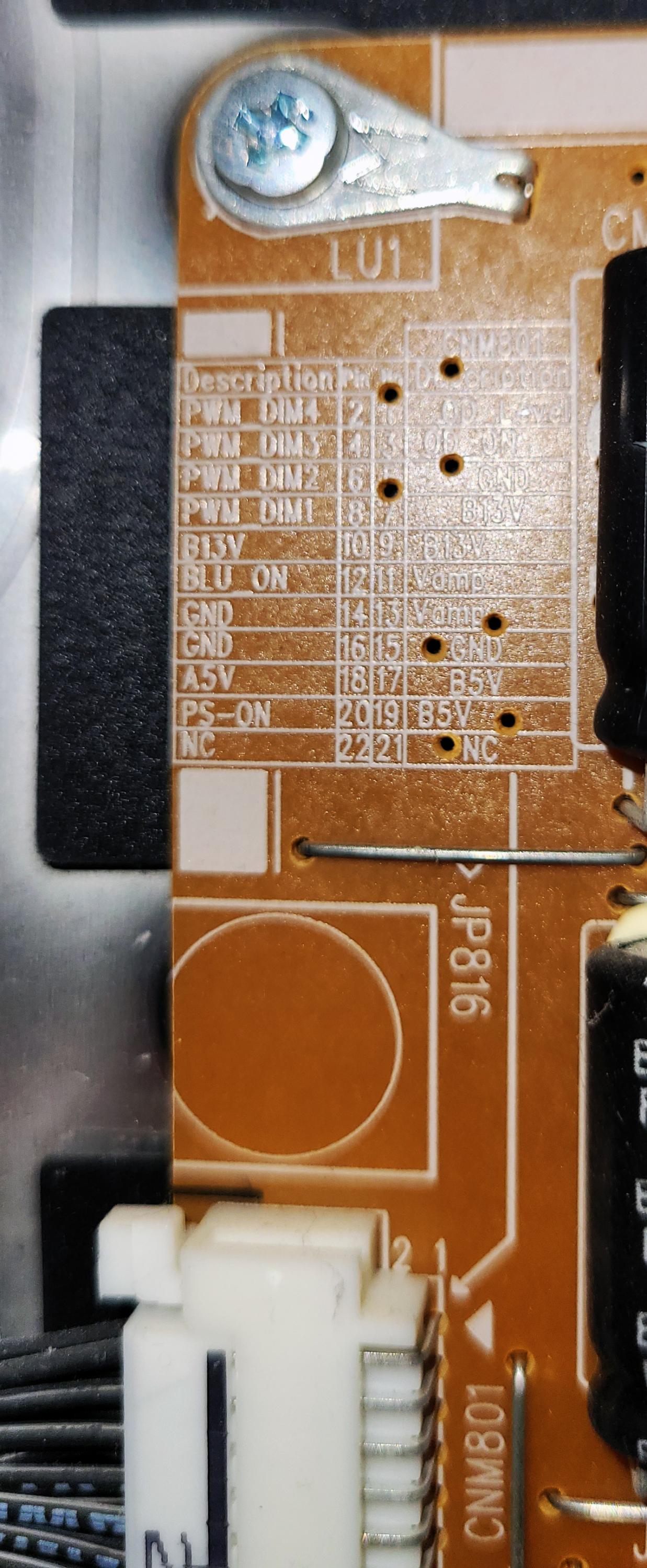

    Hello TV experts! I have a UN55D6900. The successfully TV turns on, and the backlights light up, and I get a picture, but there is a section that is dim. I took it apart and 1 out of 4 segments of backlight LEDs are not lighting on both sides of the TV (in other words, the same segment is out on both LED strips).
    I tested the LED strips with my LED tester and all of the LEDs light properly, so I believe the problem is with the PSU/LED driver board (BN44-00428B). The voltages at CNM810 (between PSU and main board) look ok to me. The voltages at CNL801A and CNL801B look off for one of the 4 LED driver circuits. I've bolded the voltages below that seem wrong to me.
    CNM810
    PWM_DIM4 0.265v
    PWM_DIM3 0.265v
    PWM_DIM2 0.265v
    PWM_DIM1 0.265v
    B13V 12.75v
    BLU-ON 4.71v
    GND 0
    GND 0
    ASV 5.40v
    PS-ON 3.3v
    NC 0
    OD_Level 3.253v
    OD_ON 3.278v
    GND 0
    B13V 12.75v
    B13V 12.75v
    Vamp 1.789v
    Vamp 1.789v
    GND 0
    B5V 5.39v
    B5V 5.39v
    NC 0
    CNL801A
    L2+ 99.7v
    L6+ 101.3v
    L1- 40.8v
    L5- 42.1v
    L8+ 100.8v
    L4+ 68.0v ???
    L7- 41.6v
    L3- 14.69v ???
    IF1 2.97v
    IF2 2.97v
    CNL801B
    R7+ 161.8v
    R3+ 126.8v
    R8- 100.8v
    R4- 68.0v
    R1+ 160.8v
    R5+ 162.3v
    R2- 99.8v
    R6- 101.3v

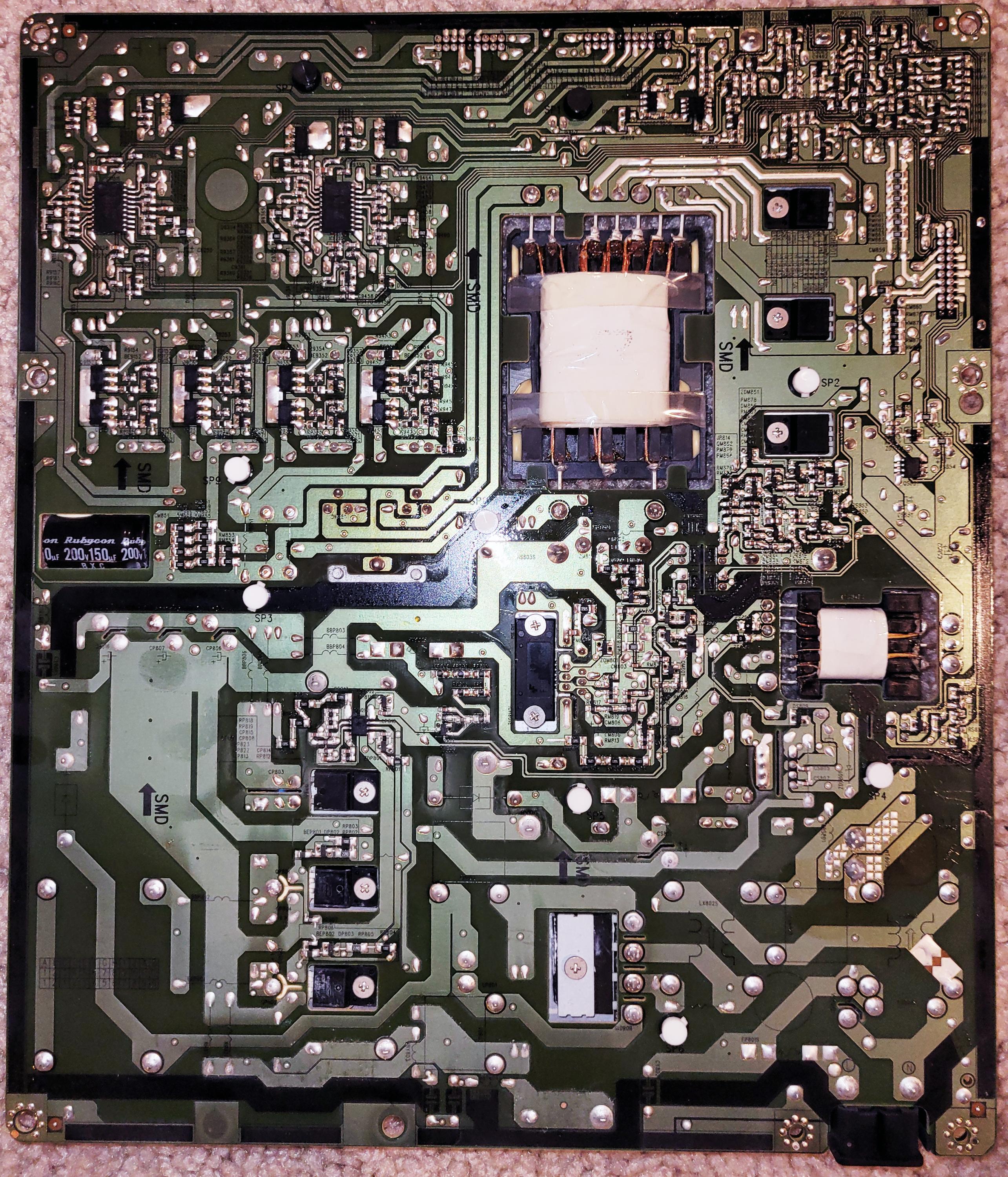

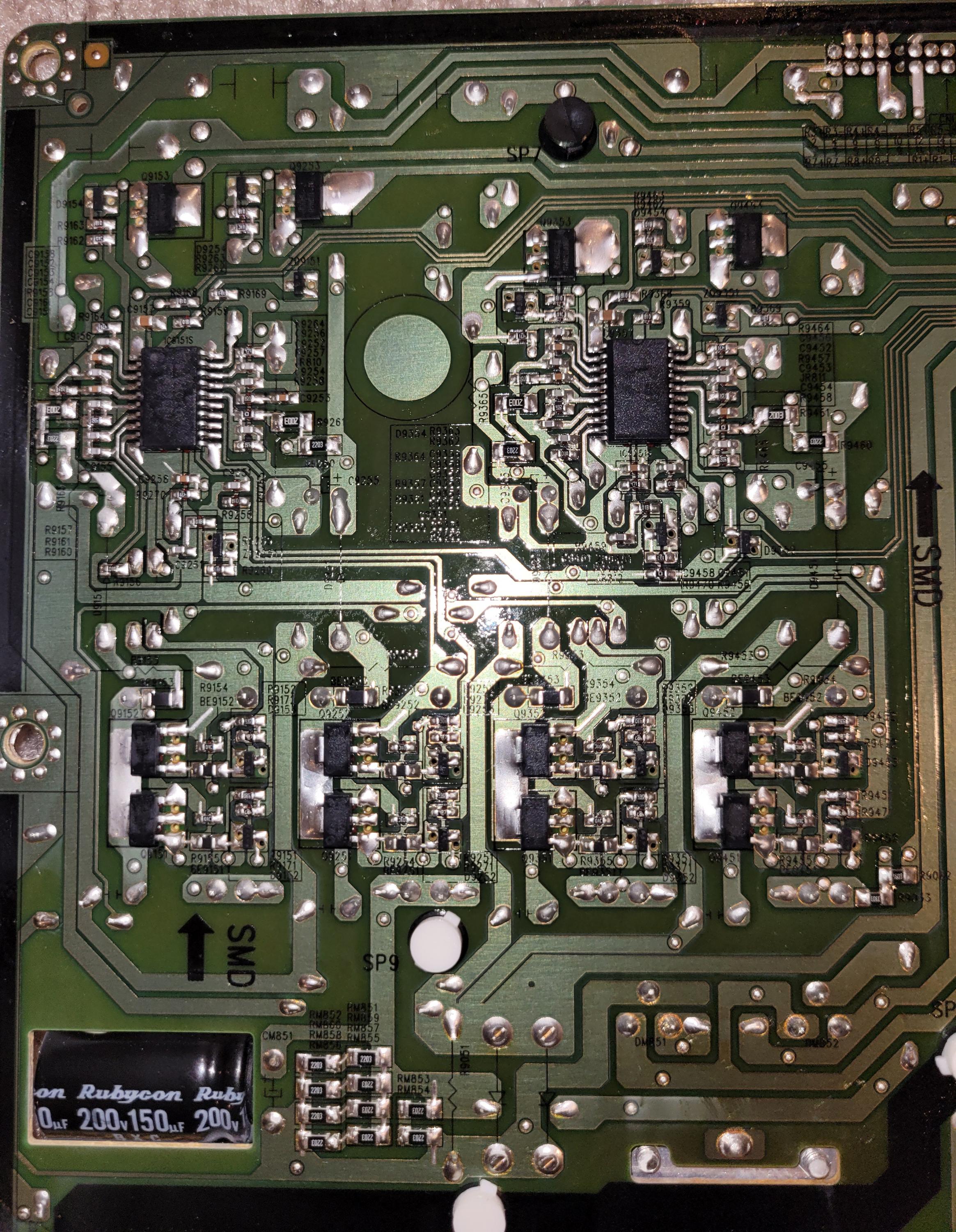

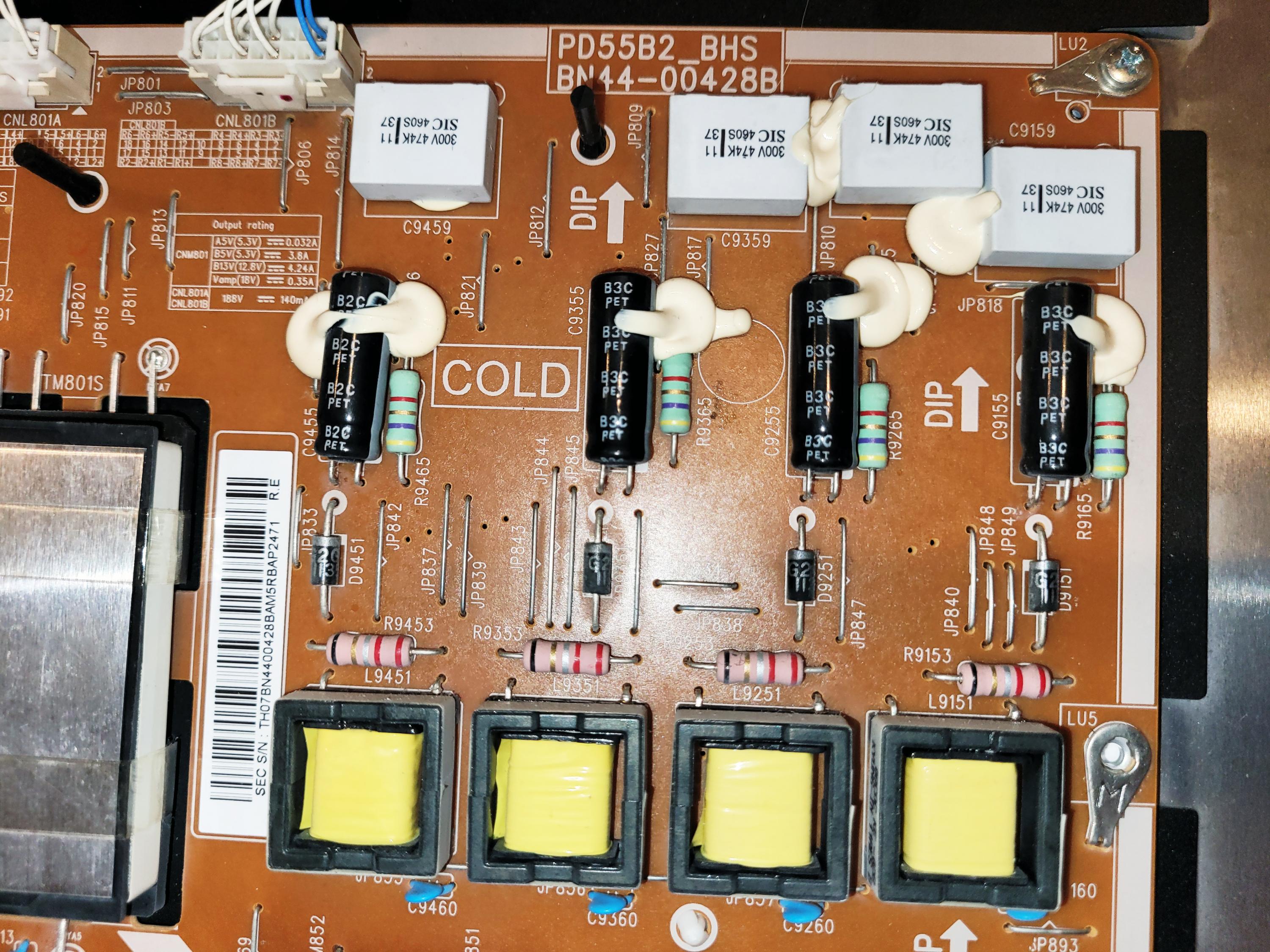

    I also checked the voltages on either side of each diode in the 4 LED driver circuits (top voltage, bottom voltage)
    D9451 161.6v / 126.8v
    D9351 162.0v / 126.8v
    D9251 126.8v / 126.8v (I think this driver circuit is bad)
    D9151 160.5v / 126.8v

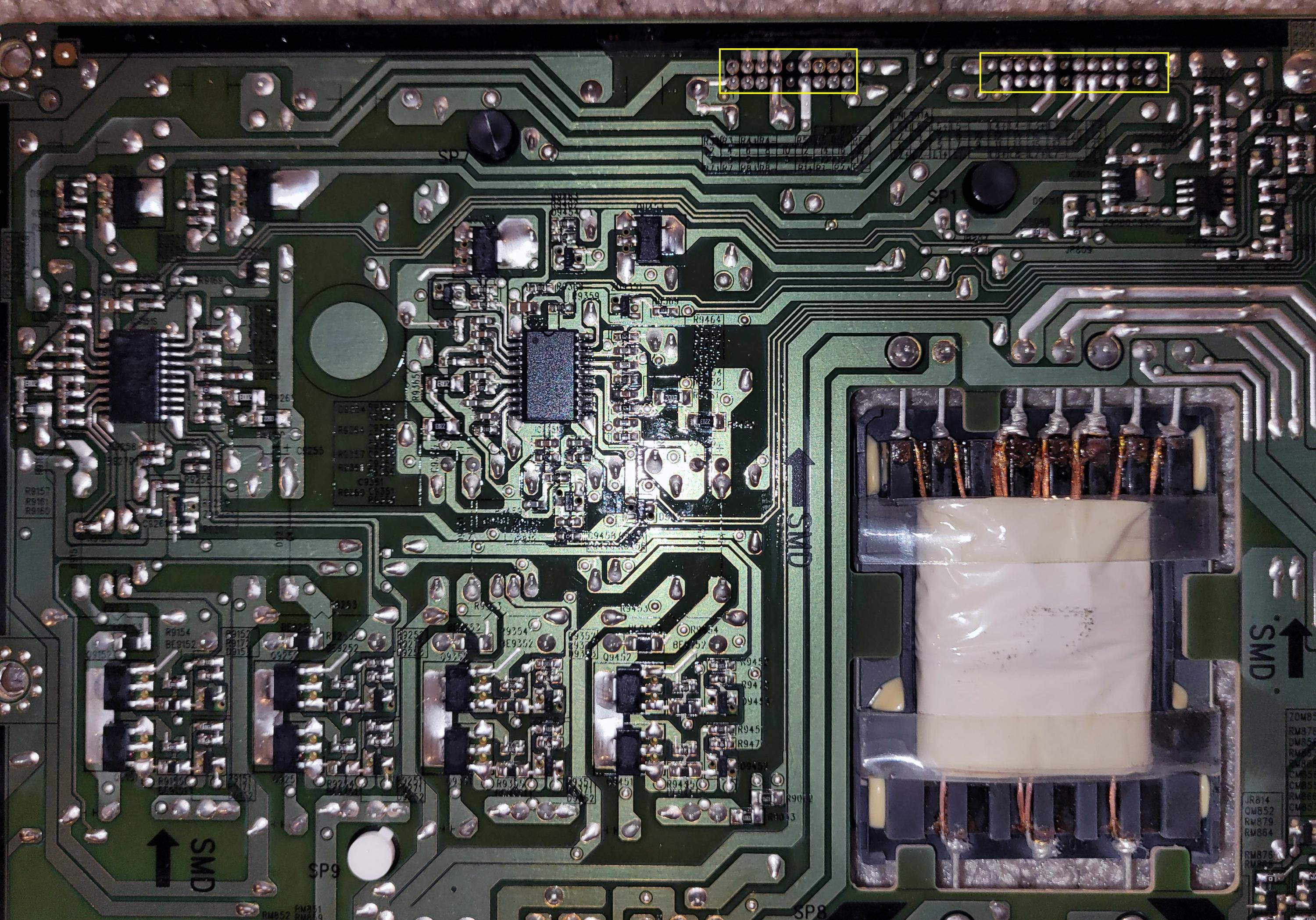

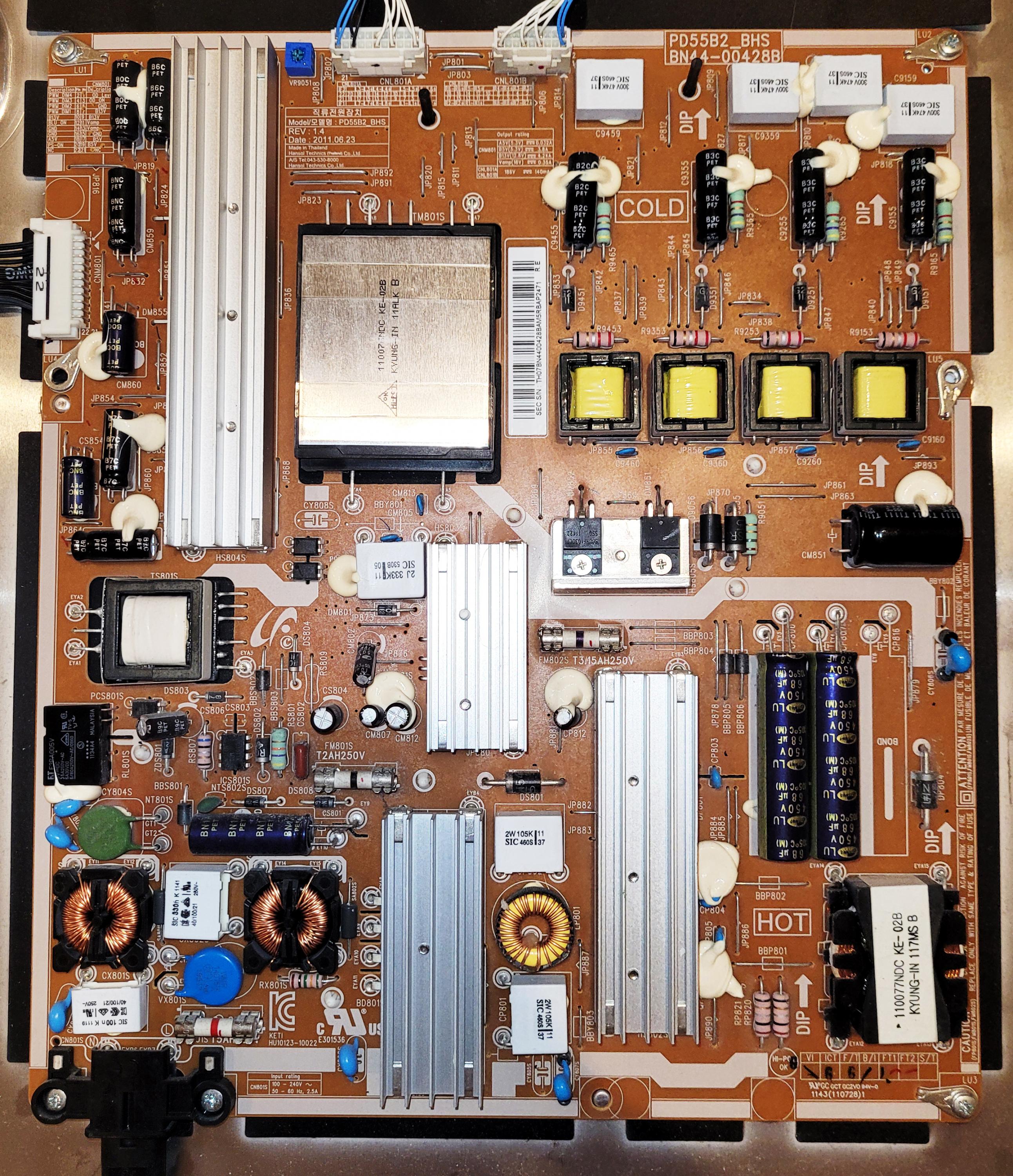

    I've included images of both the front and the back of the LED driver circuits on the board. Looking for help on what I should test next to pinpoint what part of the driver circuit is bad and which component(s) need to be replaced?

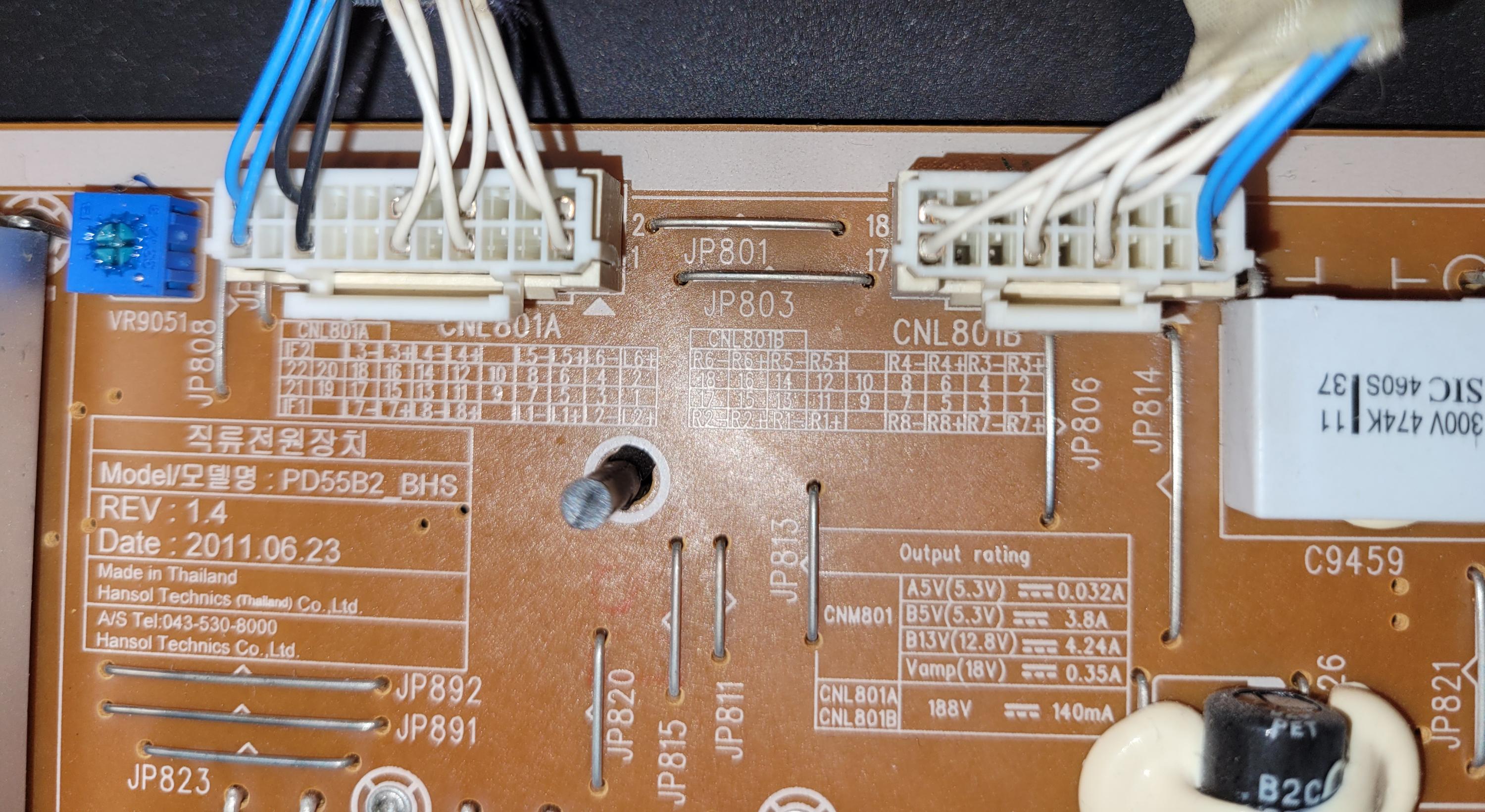

          I was trying to help but those hookups for the LED's just don't make any sense. I have a UN60D6000 (Man Feb 2012) opened and it is crystal clear. There are 8 LED segments, 4 left and 4 right each measuring about 143VDC with LED tester. Each pin has a wire as depicted in the legend on the board - see attached.
          How were you testing with the LED tester - between what pins? How can you test L1, L2 when L1+ (5) has no wire and L2- (3) has no wire?
          And I got nowhere trying to relate all those wires to the schematic that is in the thread you referenced - there just are not enough wires on that drawing for CNL801A & B.
          Maybe I am just confused

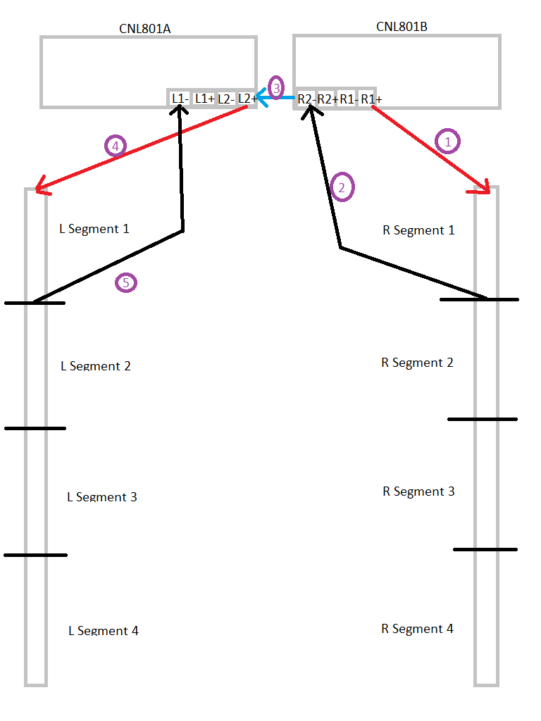

            Ok, I did a bunch of testing with my LED tester and my multimeter to check continuity, and here's what I figured out. All 4 LED driver circuits are the same, and the full circuits look like this:
            1) R1+ to L1-
            2) R3+ to L3-
            3) R5+ to L5-
            4) R7+ to L7-
            Here's how the circuits work...
            - There are 2 LED strips in the TV, a left one and a right one.
            - Each LED strip has 4 segments.
            - The segments on the left strip are: L2+ to L1-, L4+ to L3-, L6+ to L5-, and L8+ to L7-
            - The segments on the right strip are: R1+ to R2-, R3+ to R4-, R5+ to R6-, and R7+ to R8-
            - Testing between any single segment (eg L2+ to L1-, or R1+ to R2-) with the LED tester lights up the corresponding segment of LEDs on that particular strip and drives 69v.
            - Testing for continuity shows that the Left and Right strips are tied together at the following points: R2- and L2+, R4- and L4+, R6- and L6+, and R8- and L8+
            - Therefore, this creates 4 full LED driver circuits. For example, R1+ -> (R2-/L2+) -> L1- (so the full circuit is R1+ to L1-)
            - Connecting the positive lead of my LED tester to R1+ and the negative lead to L1- lights up the corresponding 1st segment of LEDs on both the left and right strips and drives 138v across them.
            Make sense? If it's still confusing let me know and I can draw a picture of it.

                I made a little diagram to show the "R1+ to L1-" circuit, in case the text was still confusing.

                  Re: UN55D6900 BN44-00428B partial led driver circuit failure
                  Have you checked if D9251 is ok and not shorted? Also check R9253 (0.22Ξ©) to see if it is ok and not open.
                  Monitor the voltage on D9251 cathode to see if it ever gets above 126v, If it does spike to 160v and drop, the problem is likely not here but on the return side of the led's
                  • Daveleone
                    • Apr 2016
                    • 267
                    Both D9251 and R9251 check out ok (note: my multimeter only goes down to 0.1Ξ©, and it showed 0.3-0.4Ξ© for R9251, but I checked the other R9x51 resistors and they all read the same).
                    I monitored D9251 voltage when I powered on the TV. My multimeter sampling rate isn't the best, but I tried it a few times and did see it go up to 160-170V momentarily and then drop back to 126.8V and stay there.
                    For reference, the other LED driver circuits would jump up to ~160V, then drop back to 126.8V, then go back up to ~160V and stay there (the normal boot sequence of the TV has the LEDs light up, then go dark, then light up and stay on, so this is normal).
                    Next steps? Thanks for the help!
                    • R_J
                      • Jun 2012
                      • 9535
                      The voltage going high would mean the boost circuit is working, so the fault would seem to be in the led current monitoring.
                      It looks like current is monitored across R9265 (for dimch2) R9264 would supply the feedback voltage for that channel back to IC9151S.
                      Try and check the voltage across R9265, R9165, R9365, R9465. One of these should be different and may be what is shutting down the circuit.
                      IC9151S pin 19 drives (pwm) Q9253 gate, this fet connects the return of the led string to ground through R9265. If this mosfet is shorted or not being tuned on, the current through R9265 will be wrong and trigger a shutdown.
                      • Daveleone
                        • Apr 2016
                        • 267
                        Well, I messed up and accidentally shorted that R9265 resistor and blew it. So, I'm going to give you the post-catastrophe numbers below. I rechecked the resistors and voltages around the diodes and those are still ok, so nothing I posted before has changed...
                        • Voltage drop across R9165=45.4mV, R9265=2.3V, R9635=45.5mV, R9645=45.2mV
                        • If I read the voltages at the bottom and top of each resistor as compared to ground, I see:
                          • R9165 -8.7mV (bottom), 36.7mV (top)
                          • R9265 -8.6mV, 2.27V
                          • R9365 -8.0mV, -37.4mV
                          • R9465 -7.5mV, 37.4mV
                        • I checked R9264 and it reads 0.469kΞ©. I checked R9464 for comparison, and it also reads 0.469kΞ©. So R9264 seems ok.
                        • I checked the resistors around the Q9253 gate. The bottom resistors checked out ok (they were all 10Ξ©), but the upper resistors read as follows: R9163=1kΞ©, R9263=110kΞ©, R9363=1kΞ©, R9464=1kΞ©.
                        • I also checked the Q9253 for shorts and the bottom pin is shorted with the middle pin, so it is blown.
                        So it looks like I need to replace R9265, R9263, and Q9253 at a minimum. Not sure if that will fix the problem or just get me back to where I was before I accidentally shorted the board. *sigh* Anyways, it's going to take a while for me to get parts, but I'll update again once that's done.

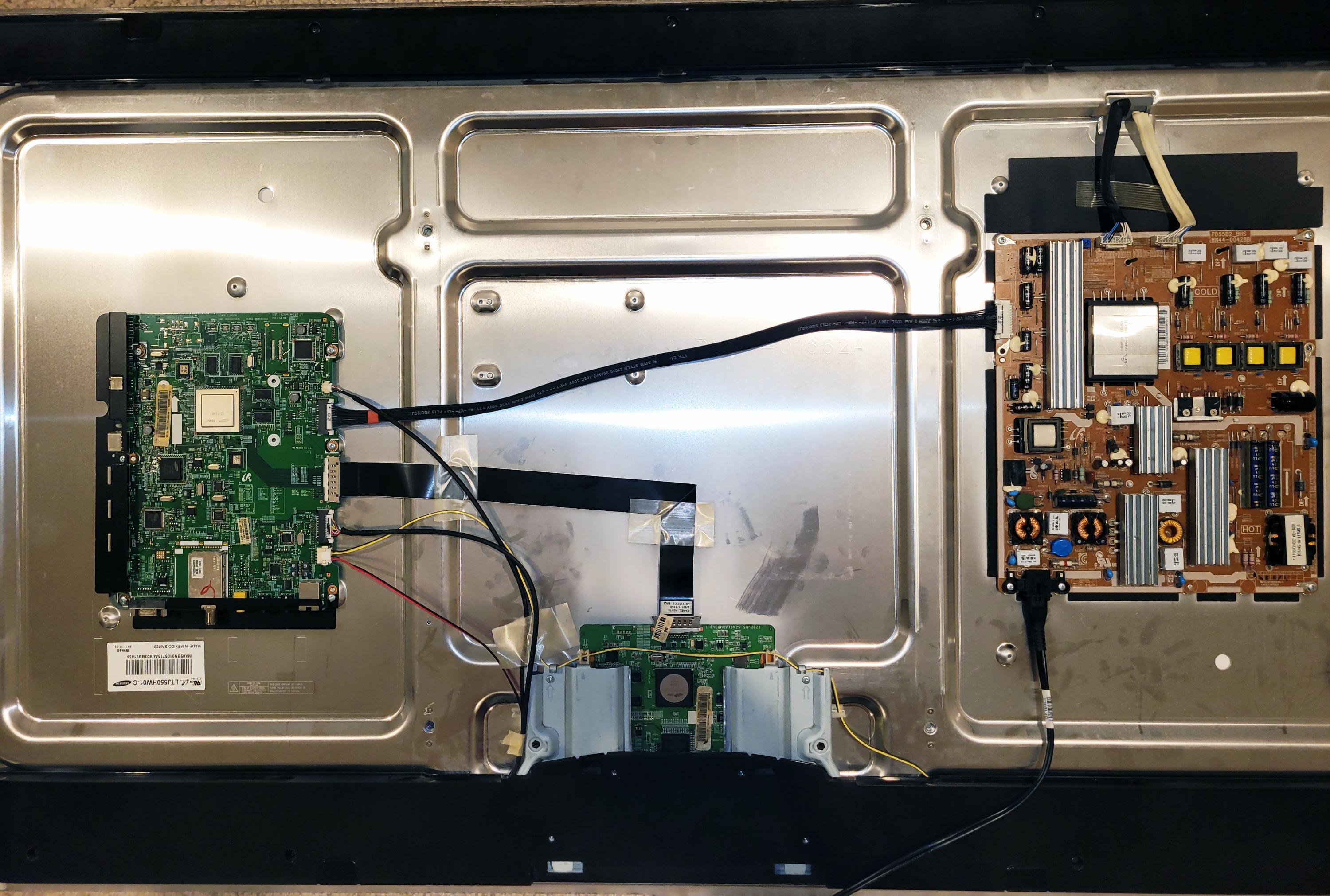

                                        Was testing with PSU & main connected.
                                        Re-checked boost voltage and it still jumps up to 170V right after I apply power. But the LEDs don't come on when it's at that voltage. A moment later the voltage drops to 128V on the bad circuit and 160V on the good circuits, and that's when the LEDs on the good circuits turn on for the first time (then they turn off, then turn back on again as is evidently the normal boot cycle). The LEDs on the bad circuit never come on.
                                        If working with the main connected try it with just the power supply by removing the cable between the main and power supply - perhaps there is an issue with the PWM drive signal.
                                        THIS is interesting. Without the main board connected, the LEDs on that circuit DO turn on. However, on all of the other circuits the voltage on the bottom of the diode is 116V and on the top of the diode is 160V, while on the affected circuit the voltage on the bottom of the diode is 116V but on the top of the diode is 222V, and the LEDs appear to be overdriven (too bright) on that strip (although I'm making that assessment from looking through the holes in the back of the TV because I don't have the panel disassembled).
                                        Does that give you any clues?
