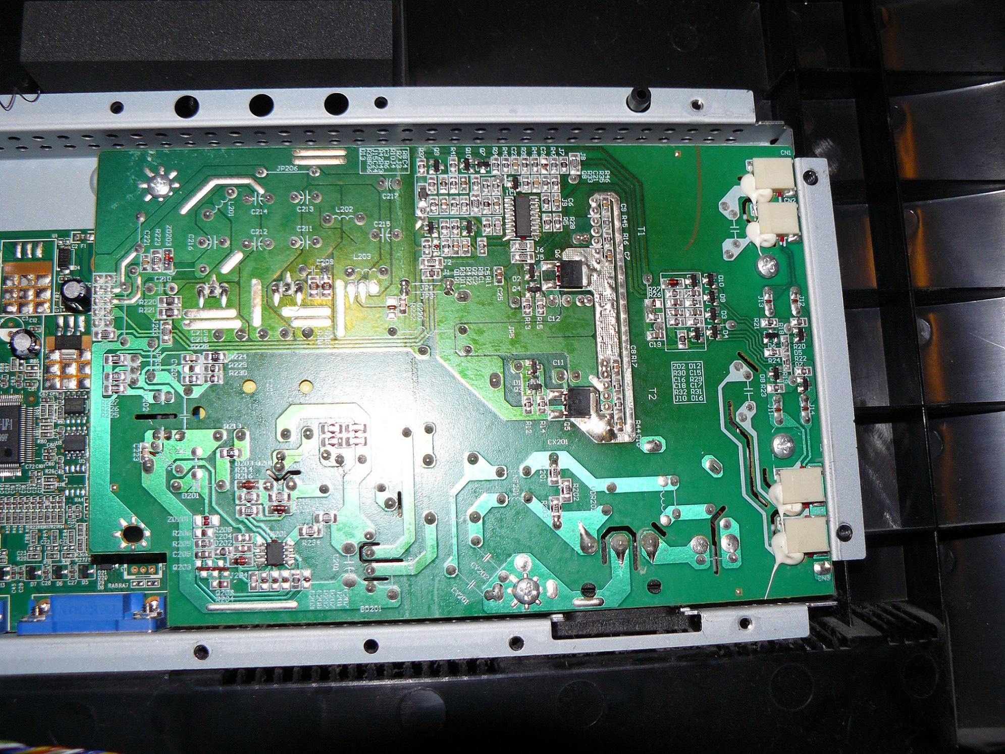

    I have one widescreen monitor and one widescreen tv/monitor. Both are 19" The tv has a cracked screen and the monitor has the pink glow.
    Heres the stinker.....
    The tv only has 2 bulbs whereas the monitor has 4. Could the monitor work with 2 bulbs though its designed for 4?
    I'm just curious and i don't want to tear into it and then it be a big waste of time. Wanting to do this the freebie route since both devices were throw aways.

    It depends. Some modification of the inverter circuitry may be necessary. The modification may not even be possible in some cases. And it depends on how clever you are. Pictures of the inverter will give some idea of your chances for success.

      Here is a picture of the inverter side. Let me know if you need a shot of the power supply side.

        This tells me enough to lead me to believe it's not going to work. The design uses a single secondary on each transformer. The CCFLs are in series with the current sense components tied to ground. I'm assuming the TV CCFLs are a larger diameter to give more area to glow. The monitor uses a higher output voltage so the current can be lower. The TV used a lower output voltage and higher current. I can't see any reasonable way to get them to work together.

          Thanks for the input.
          I just went ahead and ordered the 4 ccfl kit from ccfl warehouse. I've never soldered the bulbs but atleast i can say i attempted it.
