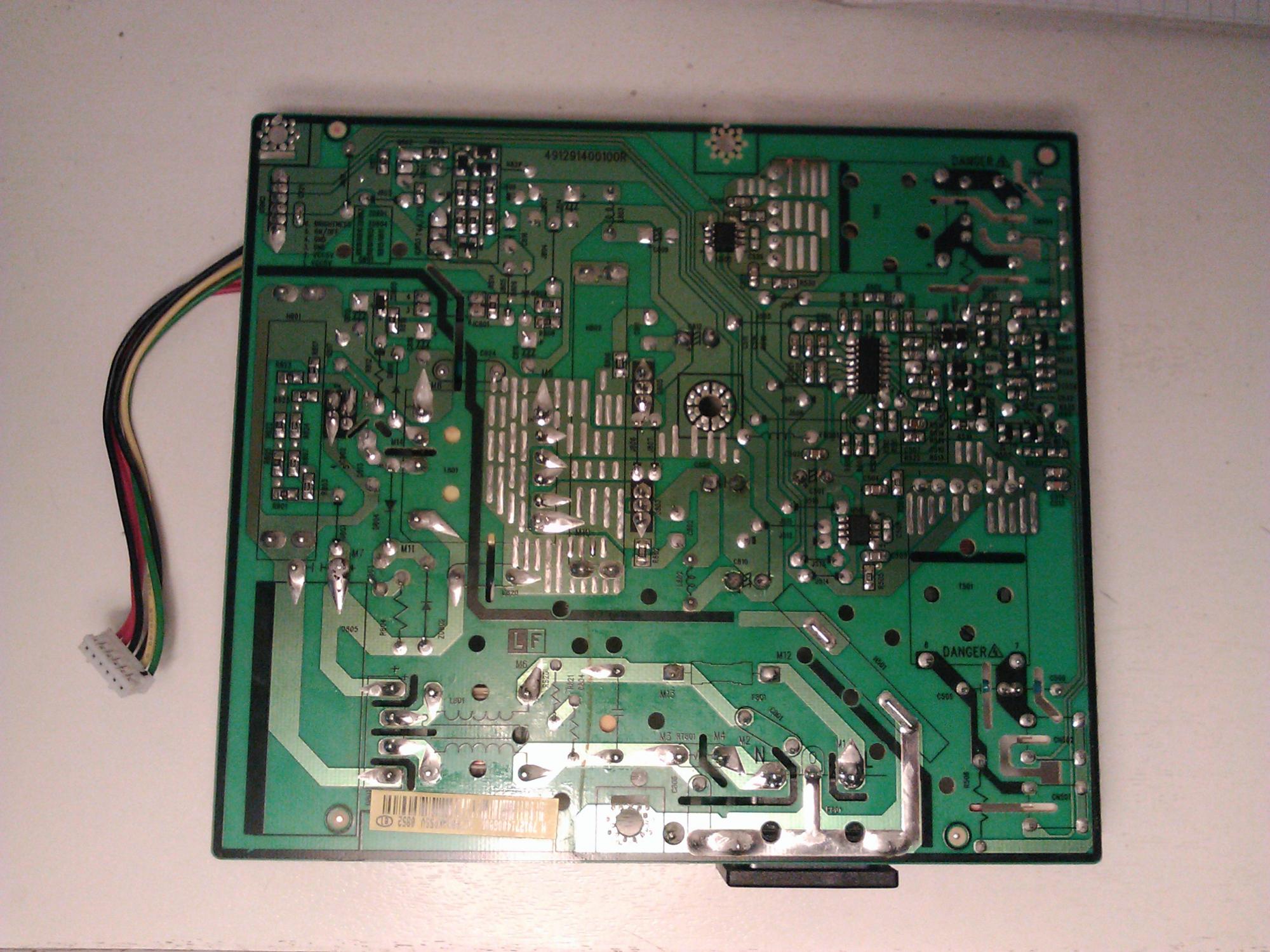

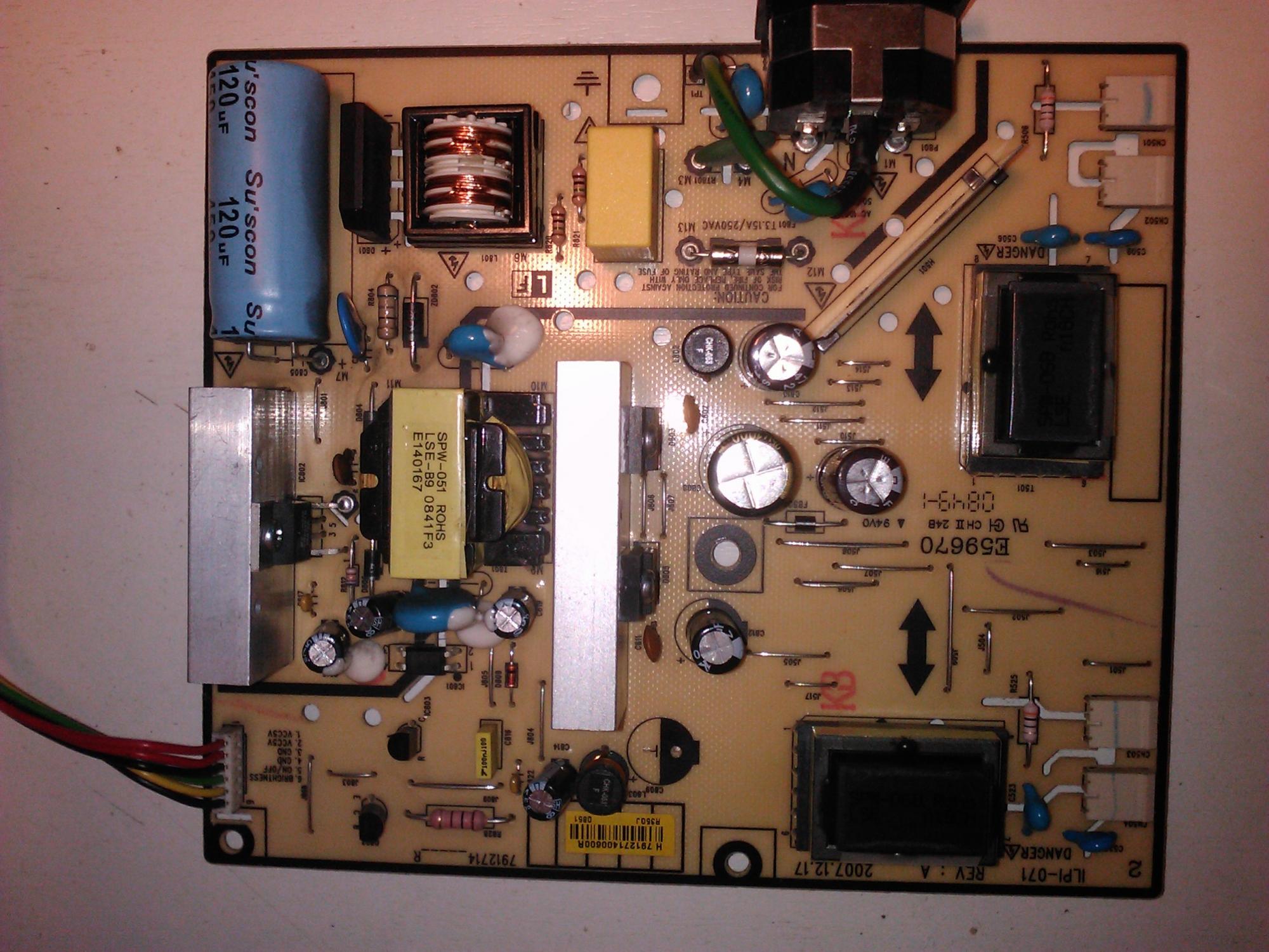

    Hi, i've a problem with my lg w1934s monitor. It's the "famous" 2sec to black... the monitor power light stay on but the backligh disappear... yesterday i opened the monitor and i change the capacitors but the problem persist. I try all the CCFL singly and all of them works... I've made other test for example leave a single CCFL, the monitor turns on and after 2 sec the backlight disappear... what can i do? I've an iron solder and a DMM but i don't know how to use it becouse i'm noob in EE... i can make soldering but i don't know how to use a dmm
    Here there are some pic of board...
    Sorry for my english...

    2 seconds to black can be
    a) bad caps
    b) bad inverter transformer (marked in red paint are likely your secondary inverter pins)
    c) bad ccfls
    d) bad ccfl wiring (especially the return wire)
    All are explained starting with post #19 and #20 at (including how to use a multimeter)
    https://www.badcaps.net/forum/showthread.php?t=10419

            Hi, finally i found the problem... it was a ccfl that has gone... at the moment i broke my replacement... I buy a new CCFL but i must wait 1 month or more... is there any way to "isolate" the CCFL inverter transformer to give power only to the working CCFL? I think that i can use the monitor with 3 CCFL for the moment... Thanks...
