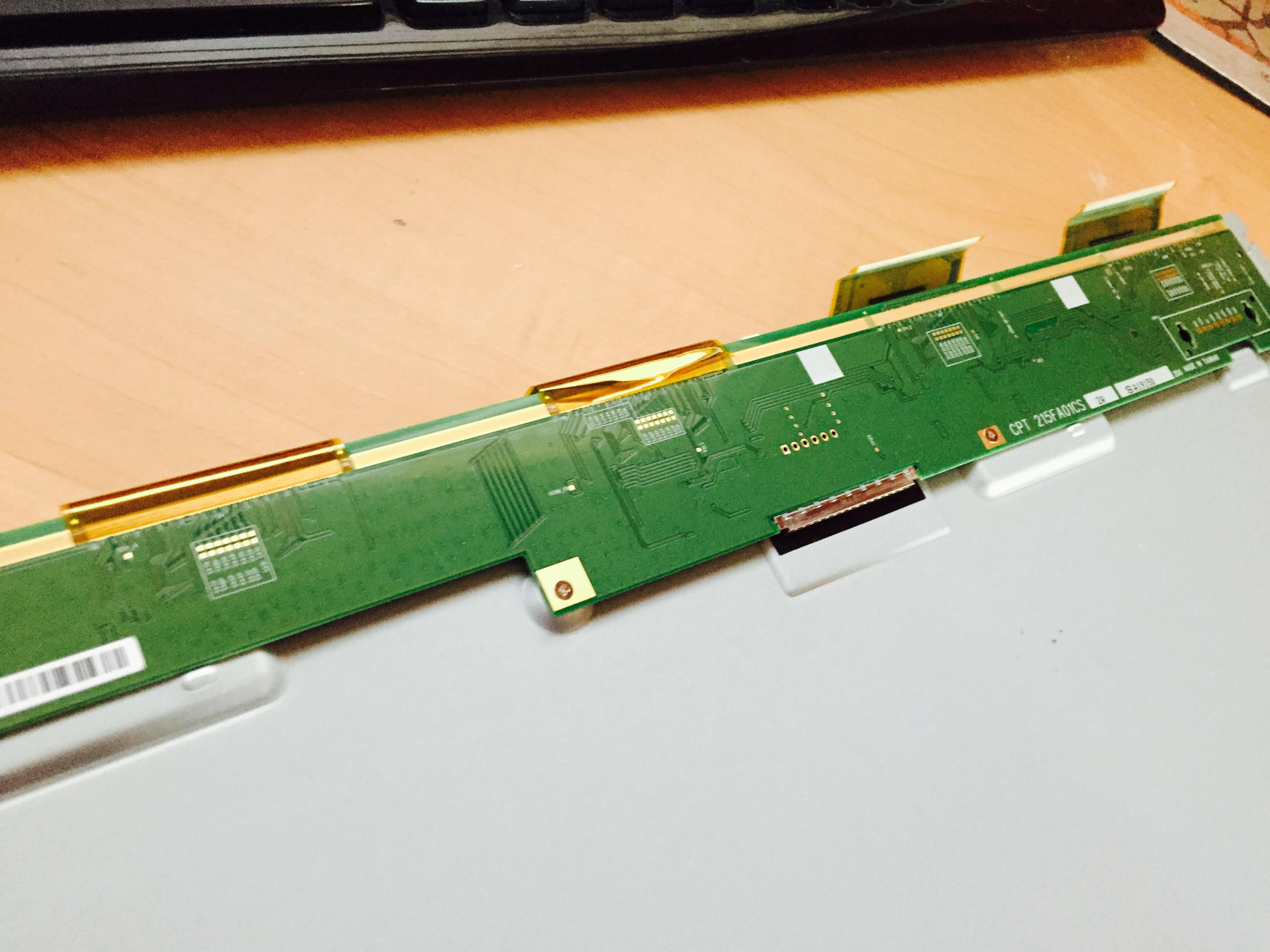

              one little problem now, the monitor was clicking and making a weird noise and then this happened. is the monitor trash now? I feel like it is but maybe their is a simple fix. The ribbon cables off the motherboard post ccfl installation, it was making a weird noise that was rapid clicking and the screen had changing lines of color so I took it apart again and these ribbons came disconnected the contacts are smaller than a hairs with... idk what I should do now.. picture is posted

                Any Ideas? sorry again for the bump but I didn't think I should open a new thread because I already started the other portion on this thread
