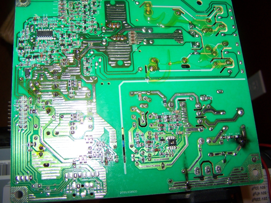

      With Q102 shorted, it could have taken out other components. Please post a good focused photo of the bottom of the power board. I'm also concerned that the startup cap, CE107, is not charging from the the pwm chip U104 (located bottom side on power board) pin 6, since you said you measured 0V across it, possibly indicating U104 is also bad.
      I am attaching the best photo I could get of the underside. I am slightly embarrassed because I do my best to be careful and I should know better but I accidentally grounded my test probe when I was initially testing for 110v coming in on the trace. The spot is pretty obvious in the photo. Not having a replacement fuse immediately on hand, I soldered in a jumper. I know this is not really a good practice or in most cases not the best idea at all. I will be ordering a replacement with any other components from DigiKey. Can someone help me select an appropriate replacement? I attached a photo of it as well.
      What should I look at next?

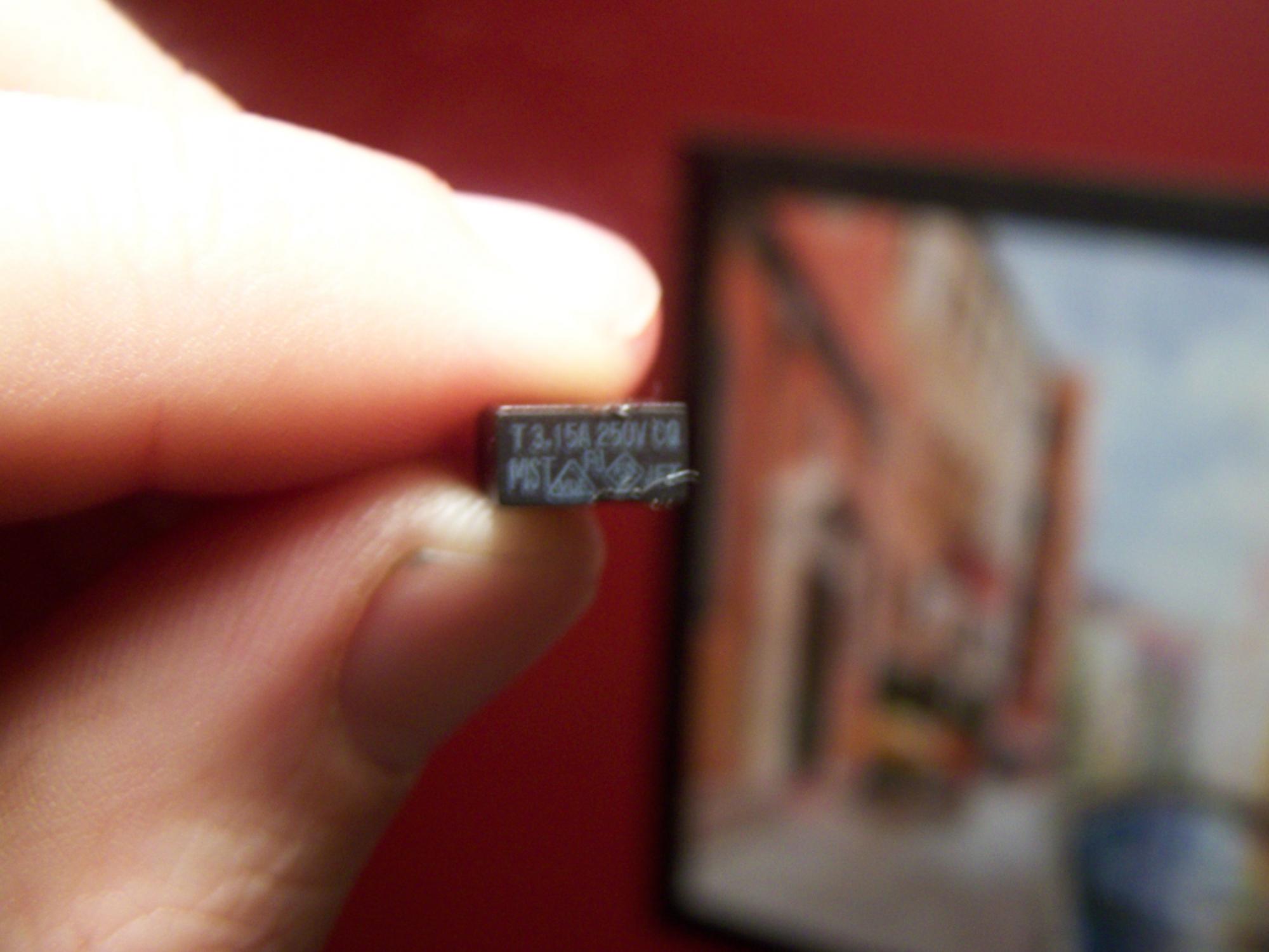

        1) I believe this is the correct one. Check the dimensions to make sure it fits.
        http://search.digikey.com/us/en/prod...1181-ND/809325
        2) Clean up the black marks of the backside with some isopropyl alcohol.
        3) There are 3 SMD resistors (R136, R137, and ???) just NW of the AC plug. Measure them in circuit to see if the resistance readings matches their markings.
        4) Clearly jetadm123 has worked on this board because he identified U104 without a picture of the backside. I have no such knowledge so what is the part number for U104?
        For U104, find its datasheet. Then find the pins that are VCC and GND. Measure the resistance between those two pins. Any reading less than 30 ohms suggests U104 might be bad.
        5) From the photo, it also looks like U104 has some black marks?? Is that IC physically damaged (cracked, split, bubbled, etc)?

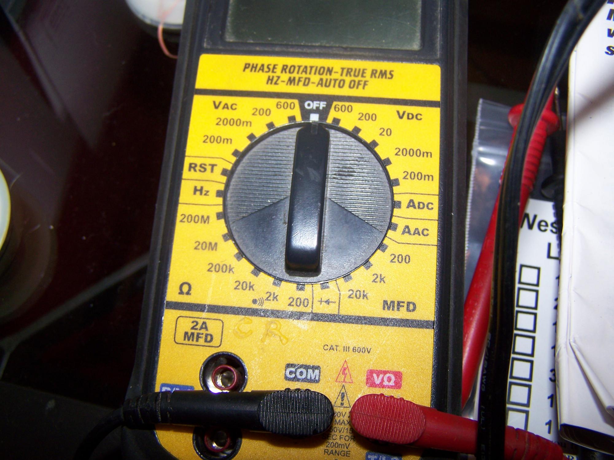

                    Post a picture of your multimeter.
                          Ok here ya go.
                          Retest with your multimeter set on the 200 (two hundred) ohm scale.
                          Getting nothing on any of the four resistors in question.

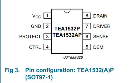

                          If you're getting only a reading on milliohm scale between vcc and ground on U104, then that indicates a short.
                          I still am not exactly sure which pins are which because it is oriented differently from the schematic.
                          What would be considered a "good" reading between Vcc and Ground?
                            5) A shorted (bad) reading is something 30 ohms or less.
                            6) See the attached diagram. See the notch? Pin 1 is below the notch. Then the pins are numbered counterclockwise.
