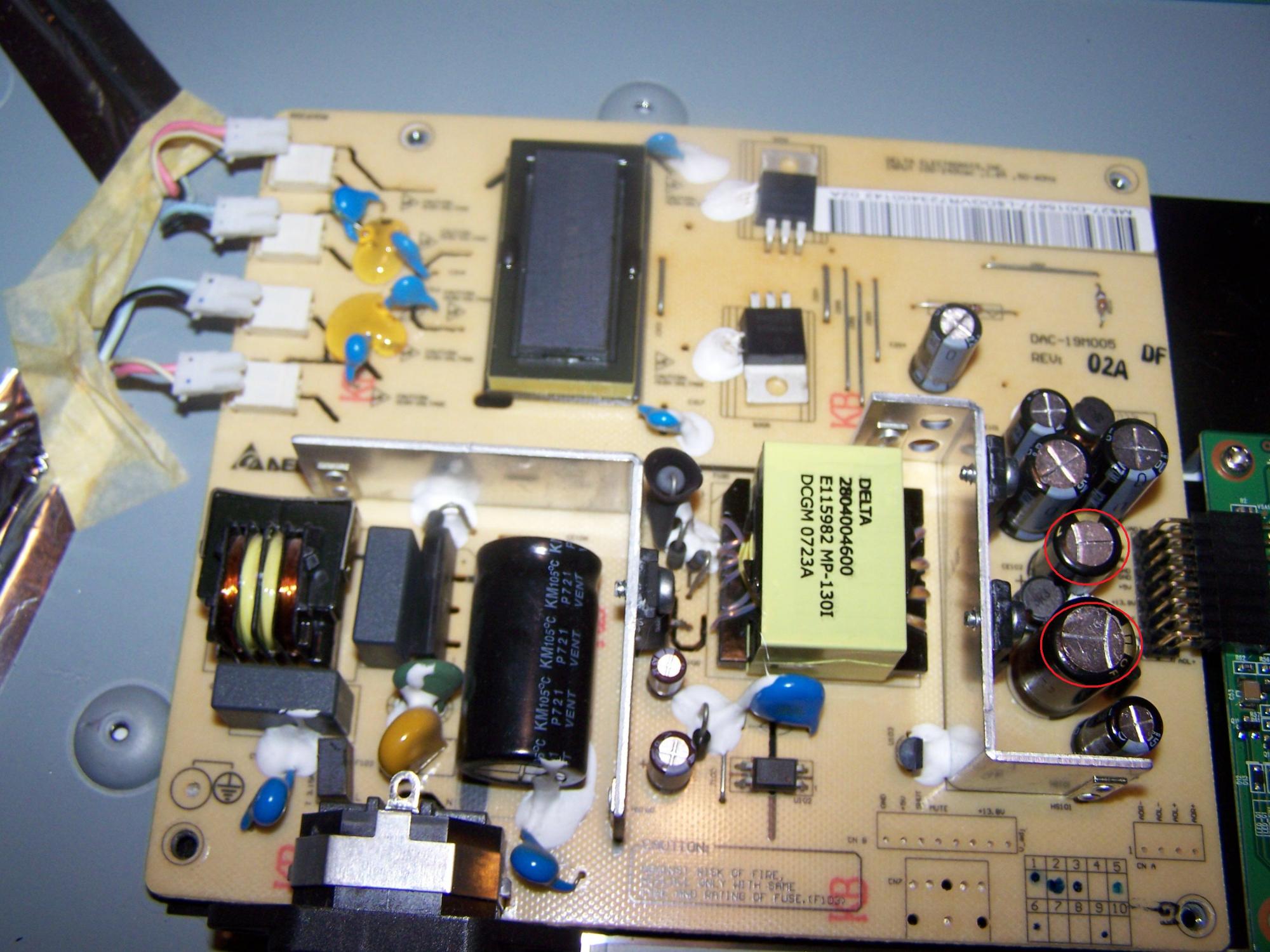

    Hello everyone, this is my first post. I have 2 Westinghouse L2046NV monitors that I purchased a couple of years ago. The first display went out on me about a year and a half ago. I got online and found some fantastic info on this forum from many other people who were having the same exact problem. I replaced all the suggested caps as well as the blown mini fuse (parts list included in the thread, talk about awesome lol) and I was back in business.
    So anyhow....i play in a band and we have a practice room setup with a bit of gear. My Bassist fires up his amplifier the other day and it trips the circuit breaker in the room (same circuit the monitor was plugged into). When I got the power back on, the monitor was completely out...no flashing light, no power indicator, it just doesn't turn on at all.
    So I open her up thinking that I probably have a blown fuse. I checked with my multi-meter for continuity on all the mini fuses that I could spot in the circuit. as well as the initial fuse where the 110v enters the circuit. As far as I can tell all my fuses are still good. What I did notice was that the 2200uF cap and the 1000uF cap were bulged and leaking. So I ordered a replacement kit that had all of the caps for this board. I replaced those two that looked bad and I am still getting nothing.
    I took the Same board (assuming that this is the the power supply?) out of my other working monitor and put it in the bad monitor and it fired right up so I know that it is something on this board that has gone bad. I unfortunately don't really know where to go from here. I plugged the board up and I can verify that it is getting power beyond the first fuse but from there I have no idea what I should be looking for. I am an electrician for my Day job and have dabbled with some electronics but I really don't have the background to be able to sit down and troubleshoot this.
    Is there really any sense in swapping out the other caps if they aren't visibly damaged? Is there somewhere else in this circuit I should be checking? I am assuming there is at least one transformer in the circuit but I am not even sure what voltage it should be operating at.

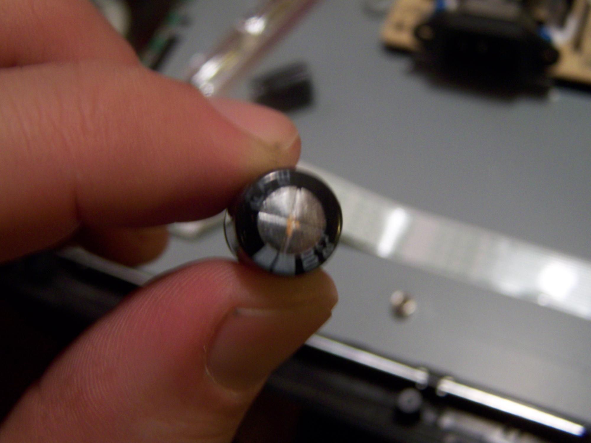

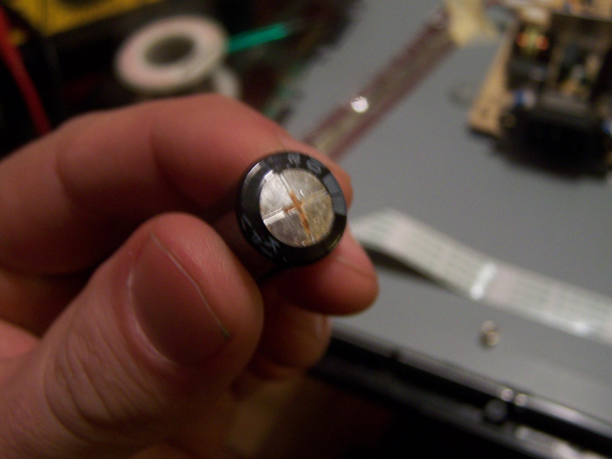

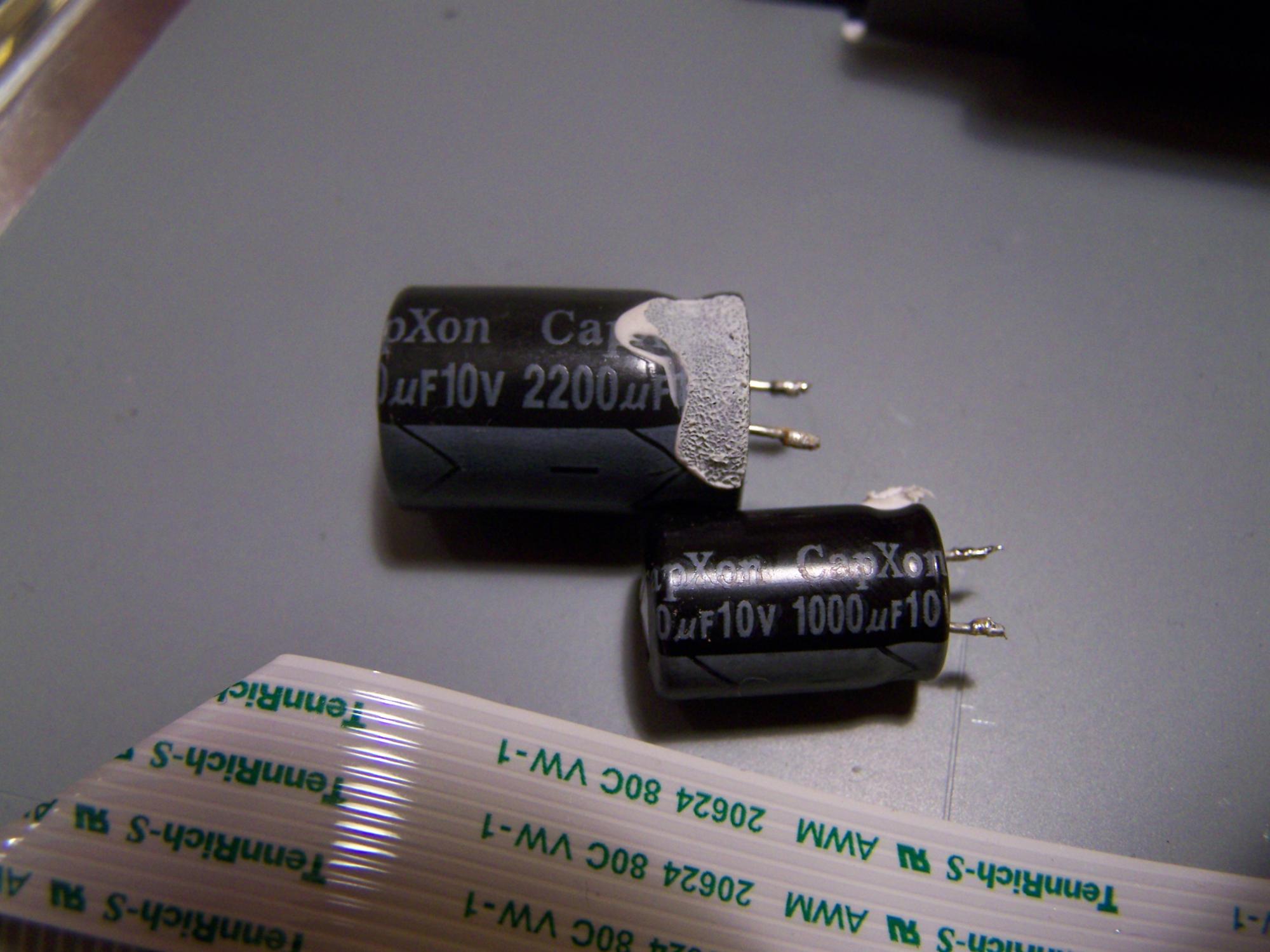

    2) Yes, Capxon makes terrible quality caps and don't last very long. So change out all the remaining Capxon caps. See standard answer below.
    3) However, I suspect your bridge rectifier is shorted. See the component circled in red.
    If you number the pins 1, 2, 3, and 4, measure the resistance between pins 1-2, 1-3, 1-4, 2-3, 2-4, and 3-4. You can do this initially in circuit.
    Any reading less than 30 ohms suggests a short and you should verify out of circuit (i.e. desolder and retest).

      5) If the bridge rectifier is not shorted, you should get roughly 165 V DC across the big filter capacitor.

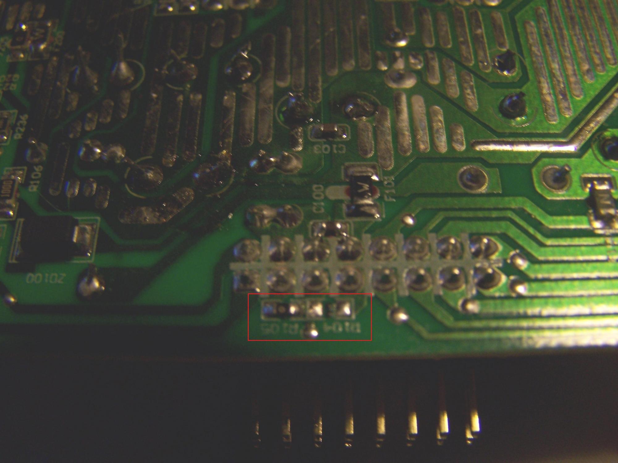

      6) On the connector between the power and main/logic board, there is a legend silkscreened on the board. If everything is working properly you should get those secondary DC voltages.

        -So after reading the standard answer....a bad capacitor can result in keeping the monitor from powering up at all and not be visibly messed up if it is out of tolerance? I apologize, I am still trying to wrap my head around the capacitors role in the circuit.

        -I am a little confused by the Pin out legend on the main power board. It has 7 labels on the left side of the connector ......Ground, Ground, +5v, +13.8v, Mute, ADP-, ADL- On but there are 8 pins total. The right side has EVA, GND, DET, 5v+, W-adj, Shut, ADR+, ADL+.....I am assuming that the left label is for the upper level of pins and the Right label is for the lower pins?
        Also, when inspecting where these pins are soldered to the PCB, I noticed 2 components......R104 and R105 (resistors?). R105 has what looks like a 0 printed in the center and R104 looks like it is no longer there......I am trying to get a clear picture but it is super tiny. Thanks again.
          Probably.
          Yes. R is resistor. 0 is a 0 ohm resistor. It is possible R104 was not ever present.

                                        I still recommend changing out ALL the Capxon caps on the power board.
