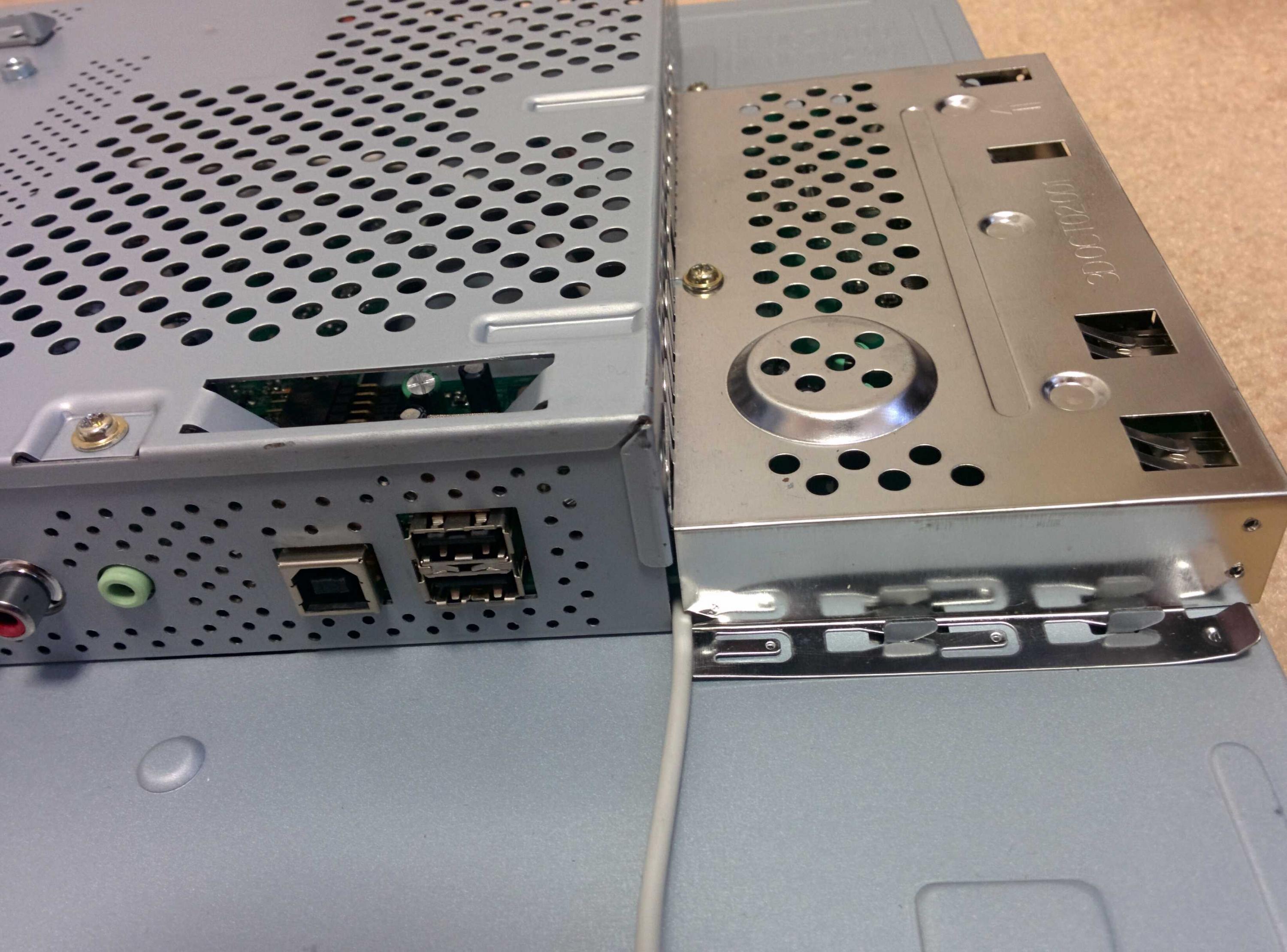

                                  So I wanted to post my workaround (NOT fix) for the Dell screen not [powering on. But to recap
                                  • The fix is to heat up the heatsink on the onboard BGA chip
                                  • Seem to imply that the BGA solder is bad, but someone had reflowed the BGA chip and that did not fix the problem
                                  • X-ray photography shows that the BGA solder balls to be intact
                                  • Speculation that one of the internal pins broken and only bridged with heat
                                  • I confirmed that a hot hair dryer on the heatsink for a few minutes will subsequently allow the monitor to light up
                                  Hack uses two resistors powered by a USB 5V source to heat up the heatsink of the BGA chip. The basics of the USB heater design are:
                                  • 2 X 3W, 6.8 ohm connected in series to USB source
                                  • Heat resistant sleeve where it contacts the heatsink
                                  • V = I X R, therefore that current in the circuit is about 0.37A, below the 0.5A specification of a USB port
                                  • Heating power = V X I = 1.8 watts between the two resistors, so I chose 3W rated resistors for adequate safety margin
                                  The implementation was as follows:
                                  • Old USB cable, but doubled up the line to reduce line resistance (Data+ and Data- cable used for power and neutral respectively)
                                  • Heat sleeves to resistors, between resistors and also from resistors
                                  • When circuit is soldered, do a trial with a 5V source to confirm that resistors heat up
                                  • Outer heatsink fins bent outwards to create space for resistors. Resistors in contact with heatsink and just held in place by friction.
                                  • Ensure no bare wire contact with heat sink
                                  • USB cable routed under boards
                                  • Cut made in right protective stainless steel cover and also screen back cover to allow access for USB cable
                                  • I would strongly recommend to connect power to the USB cable to confirm that the heatsink is being heated up before reassembling the monitor
                                  I attach some photos to show final implementation. To use it, either connect the "new" USB to a 5V source (a phone charger works) for a few minutes. I find that 2-3 minutes is all that is required on mine. Alternatively, power up the monitor - despite the screen not lighting up, there is power to the USB ports which can be used to heat up the heatsink.
                                  Then power down the monitor at the mains and reapply power to the monitor and it should fire up. The reapplication of power is a necessary step as just heating the heatsink with power turned on to the monitor will NOT light up the screen
