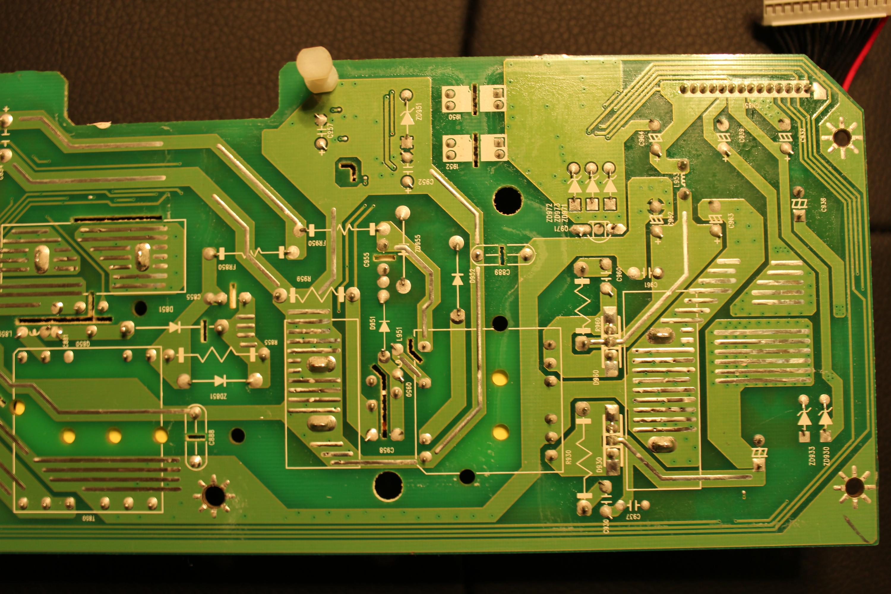

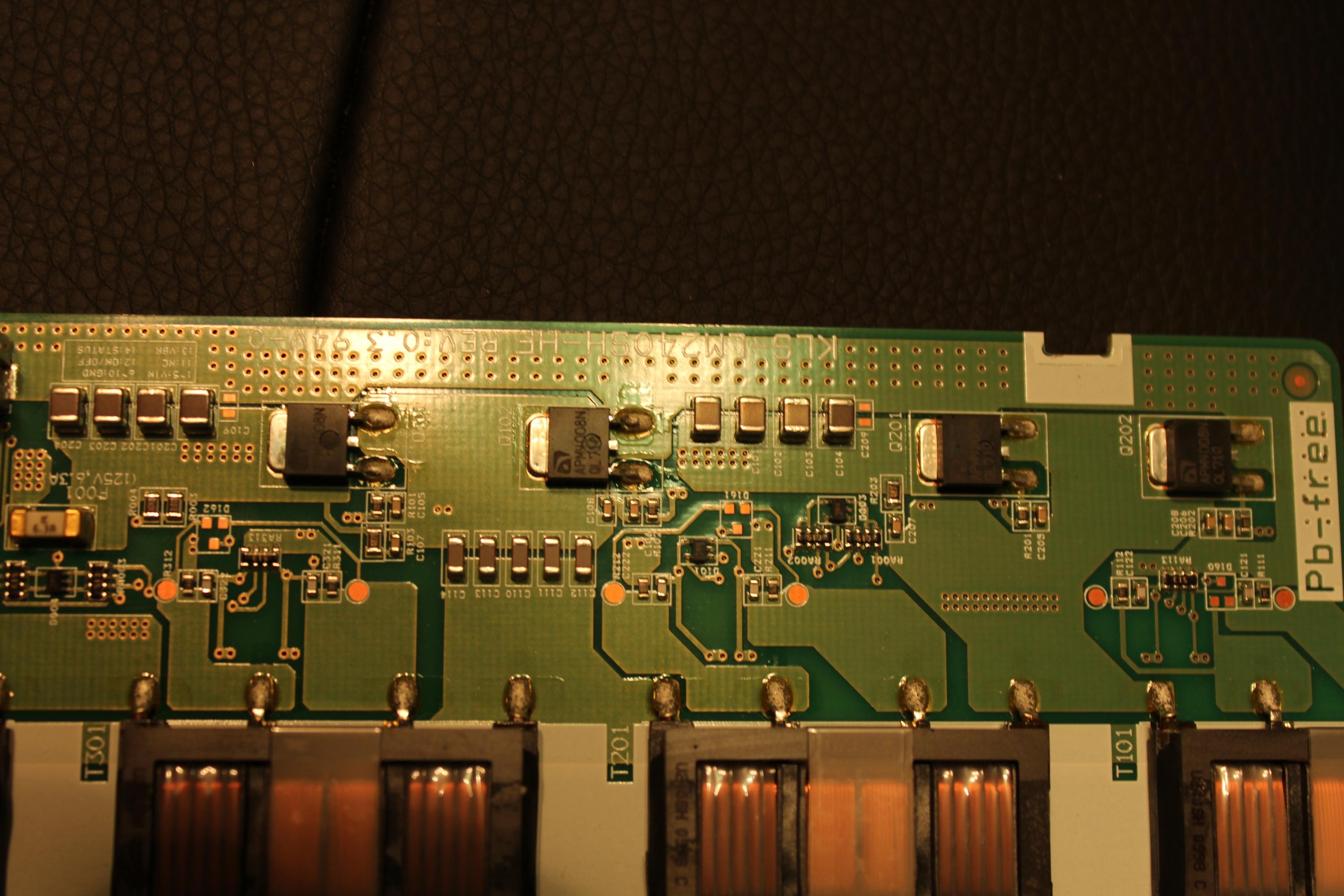

          hey budm, tell me what else you would like me to take measurements on and I'll be mroe then happy to. If you need more pictures just let me know for that too. I have a nice DSLR camera I can take them with
          I think I found the resistor, or pretty darn close to what I burn out - but am not sure where to pick them up at as it's a company based in China. If you have any suggestions for an alternative I'm all ears.

            Re: Dell U2410f

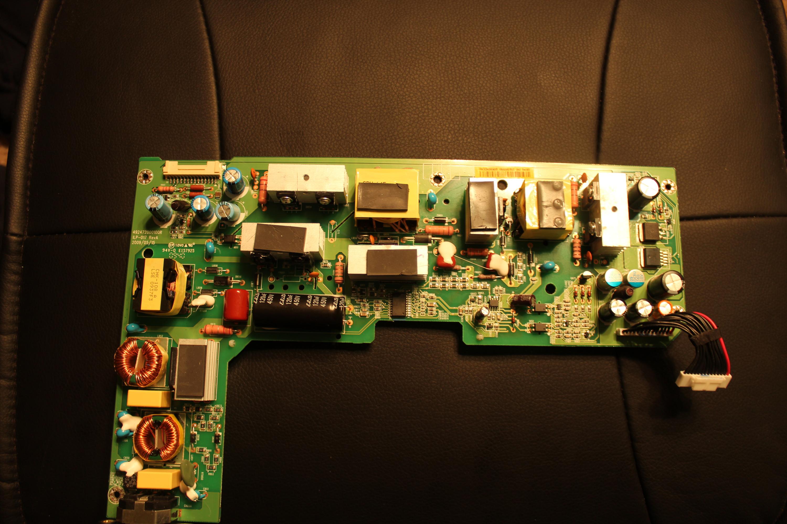

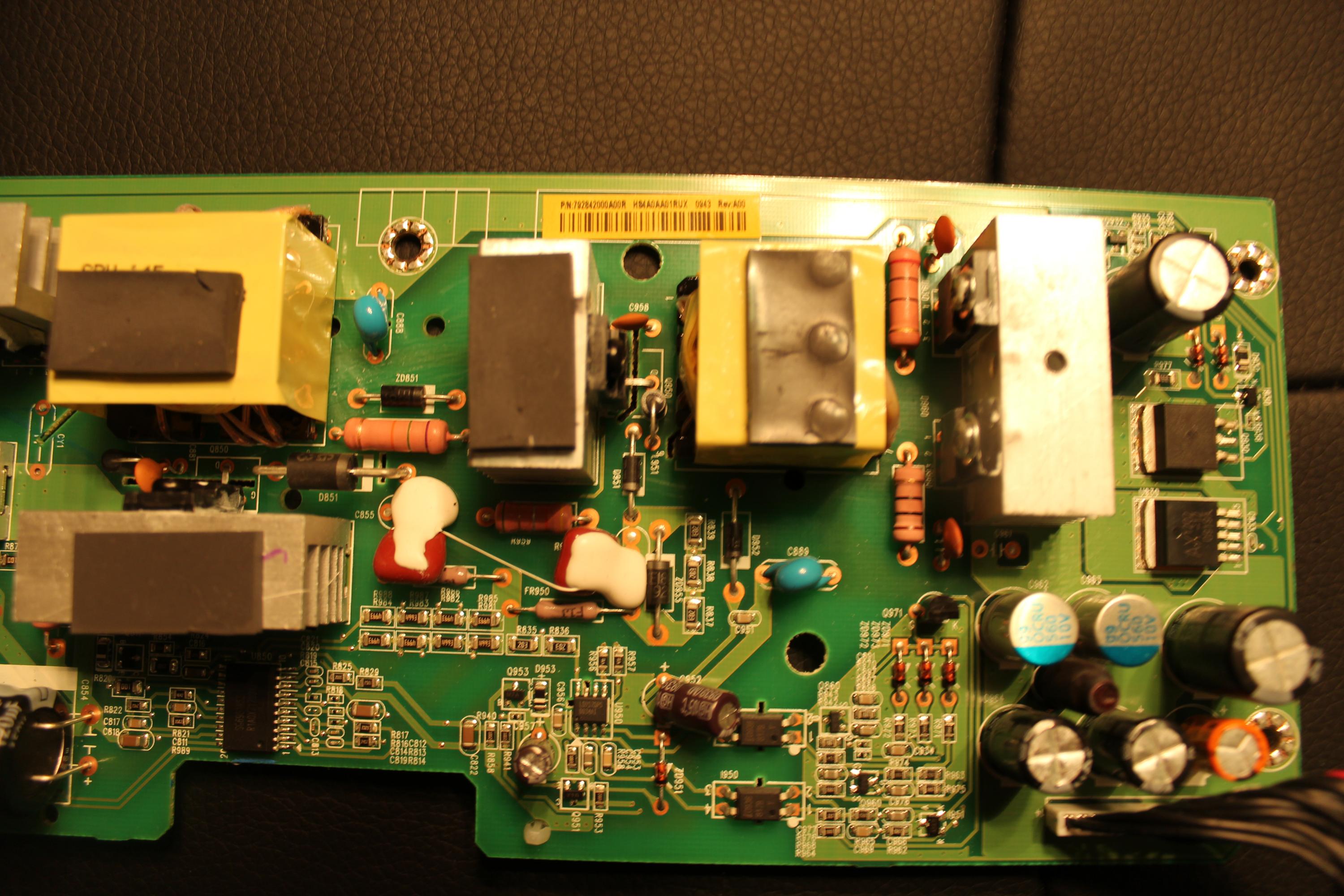

            I will have to download all the pictures and see how the monitor is setup and see where I can tell you the test points will be. I may ask for more pictures since my eyes are not that great.
            What resistors do you have laying around? I will have to tell you first to check and see if there are anything else that may have been damaged when the resistor burnt up, we do not want to power this thing until we find out if anything shorted out or not.

              Please just let me know whatever places you would like a closer view of and I'll be more then happy to snap a photo.

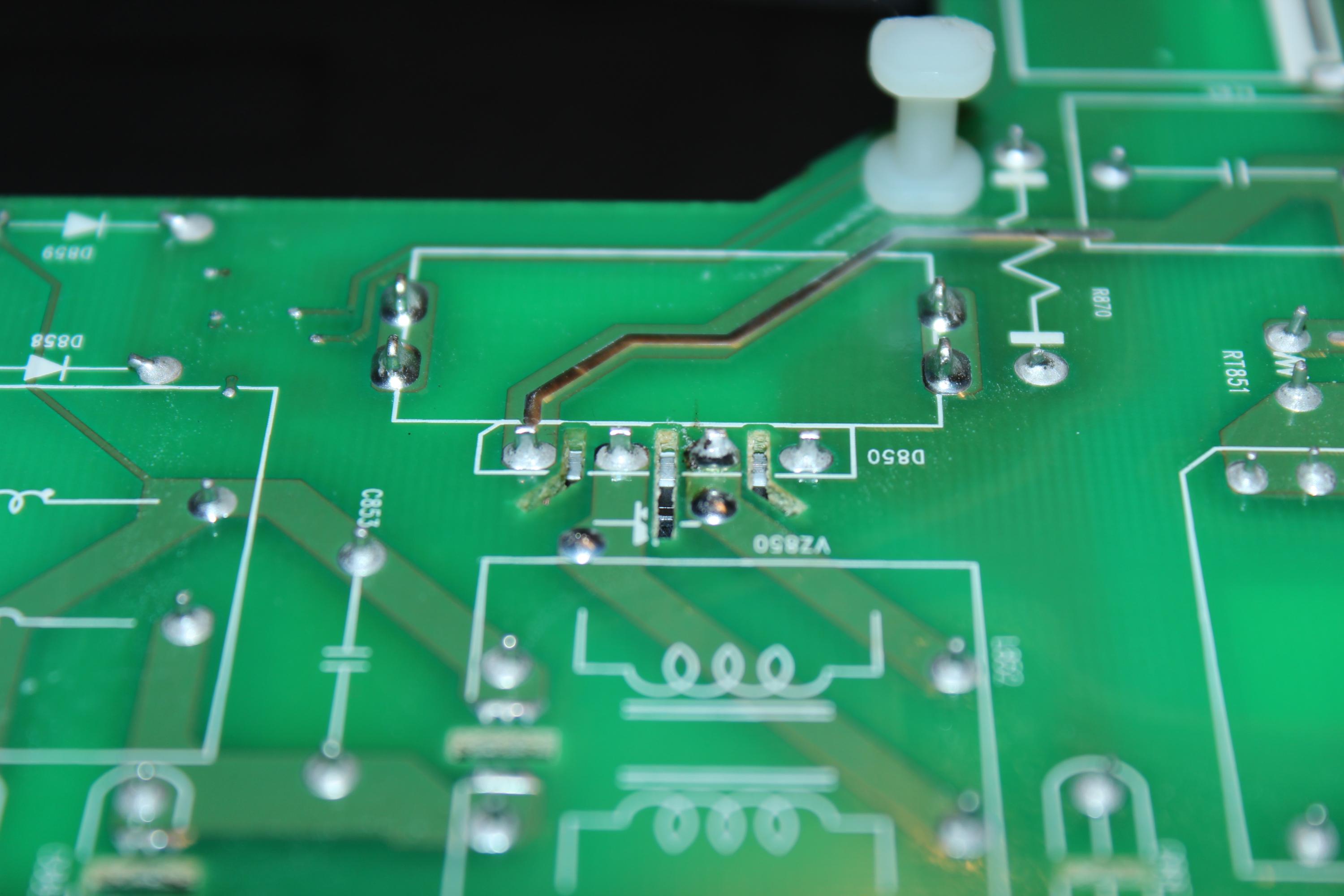

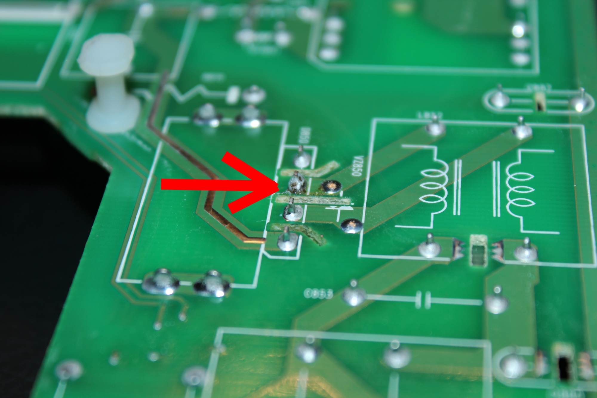

              One thing to note before we get too deep into this, when desoldering this fusible resistor, I did accidently pull up the copper rings they were fed through on the board. I figure with enough solder inplace this shouldn't be a deal breaker, but if it is let me know and I'll just scrap the project or try and get those metal pieces off the blown resistor legs..
              From a physical circuit standpoint, I don't think the cross talk / inductance shielding this is removing will have to large of an effect, but you if you feel otherwise let me know.

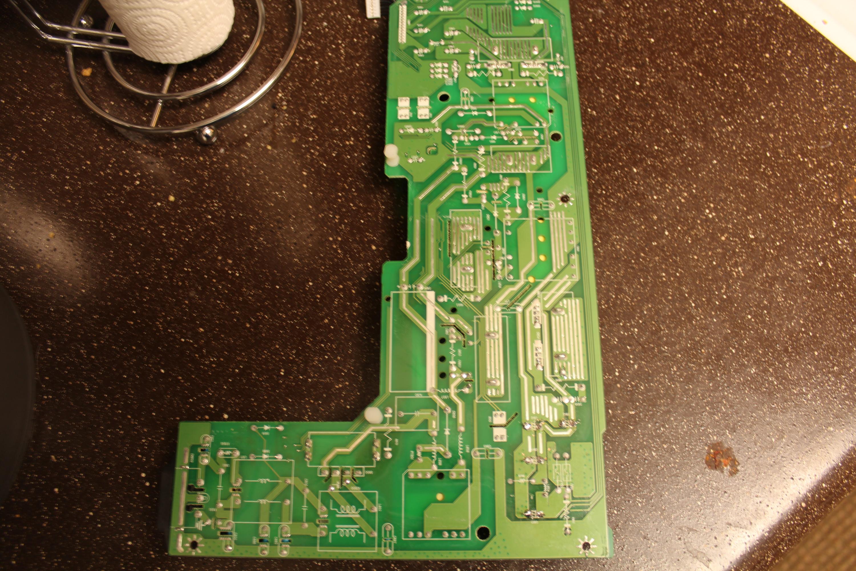

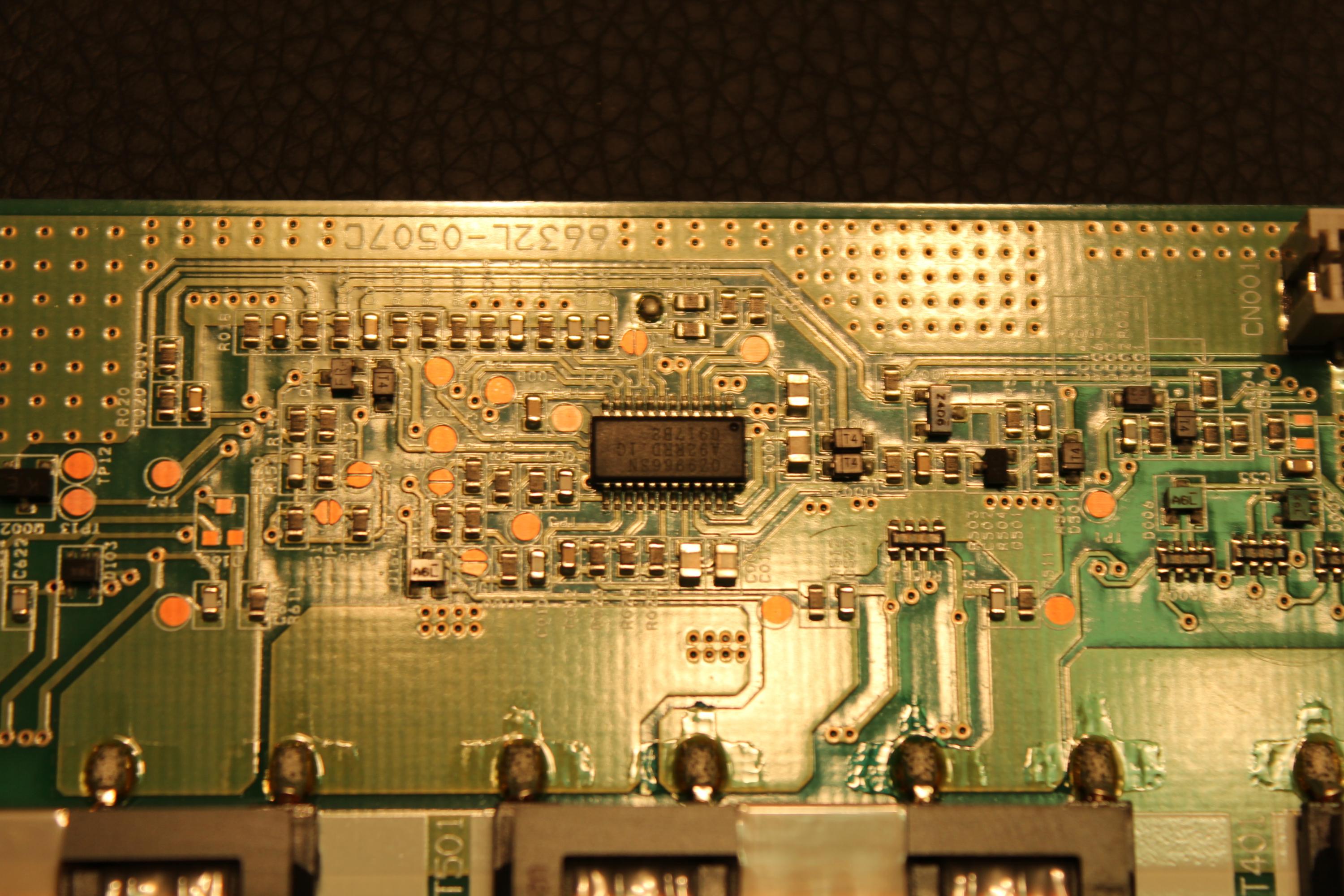

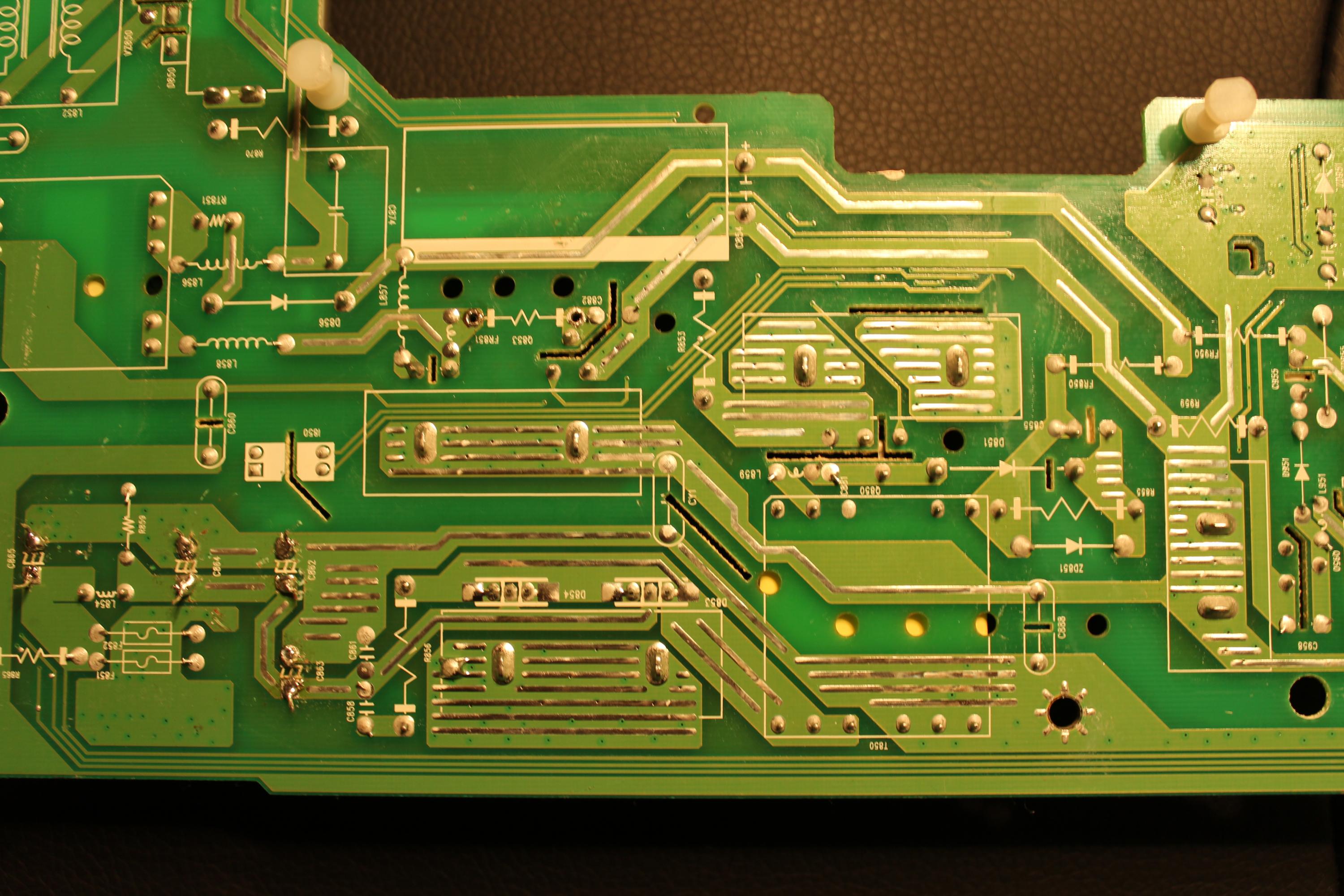

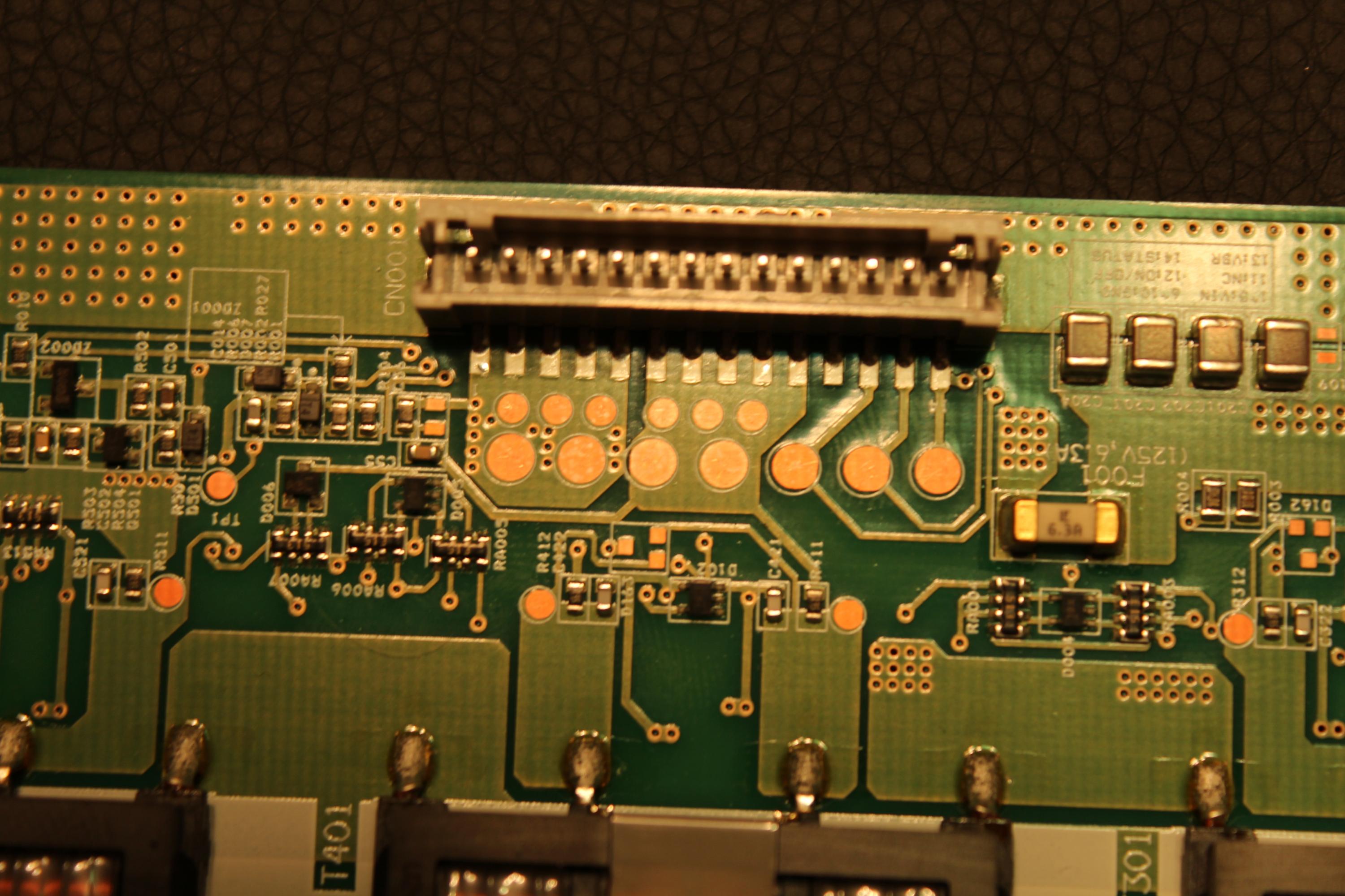

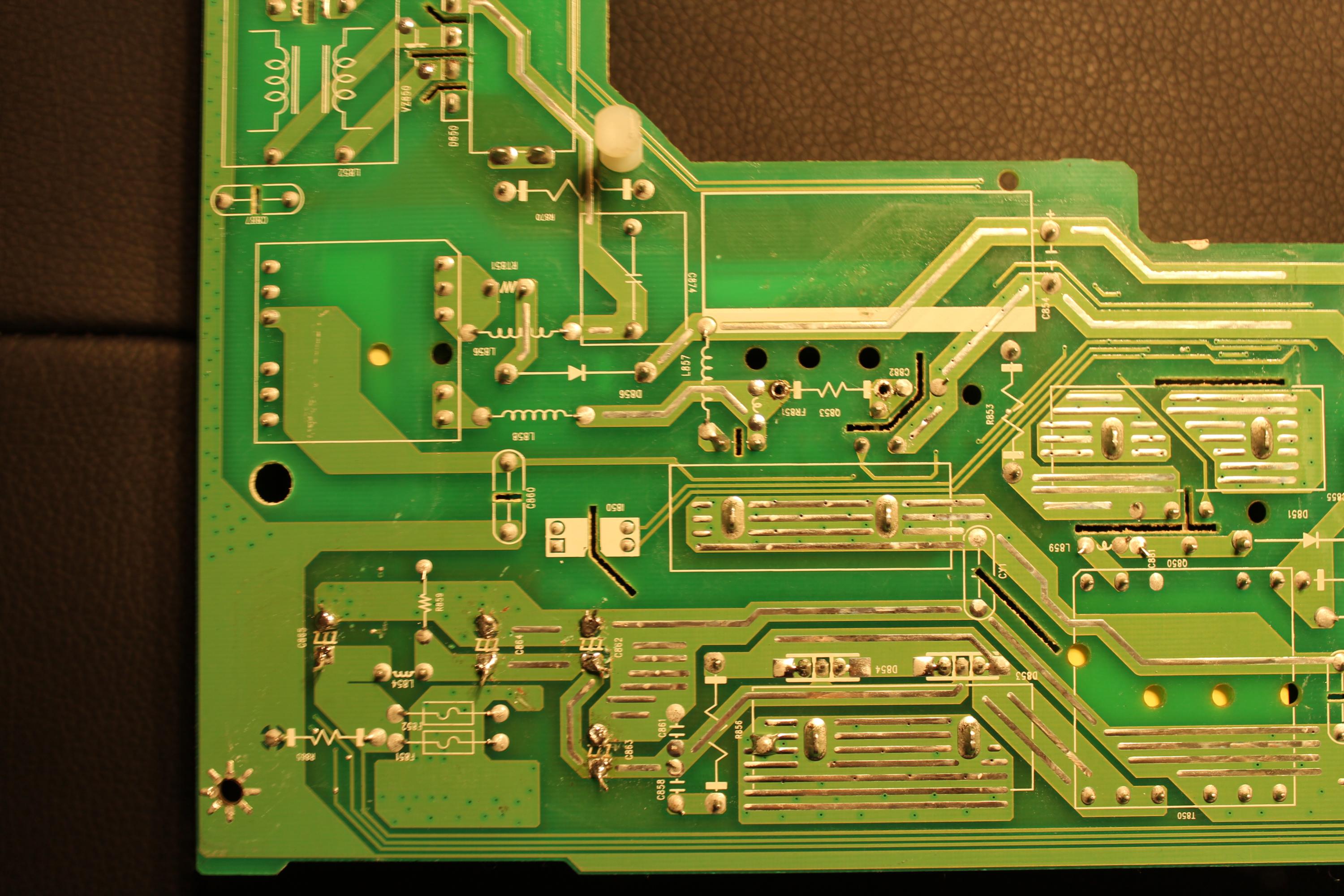

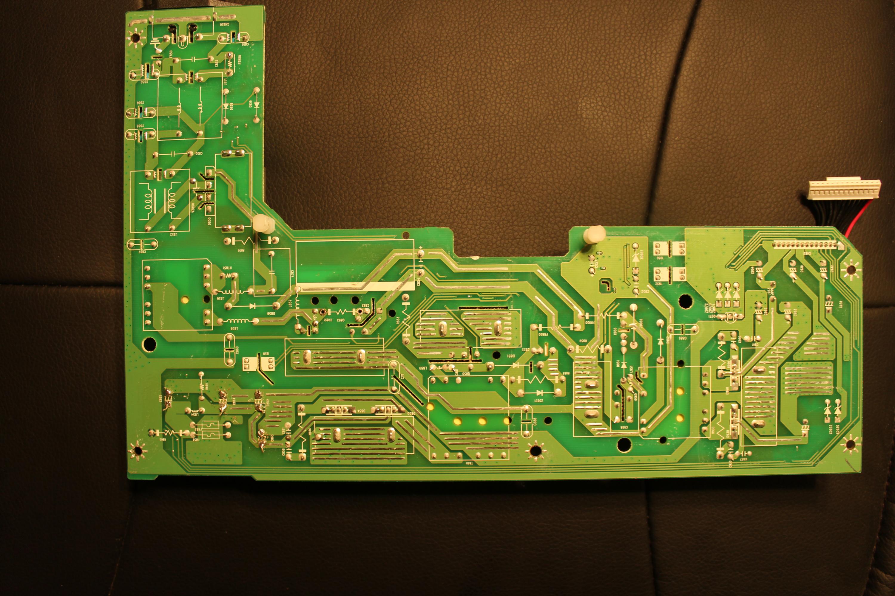

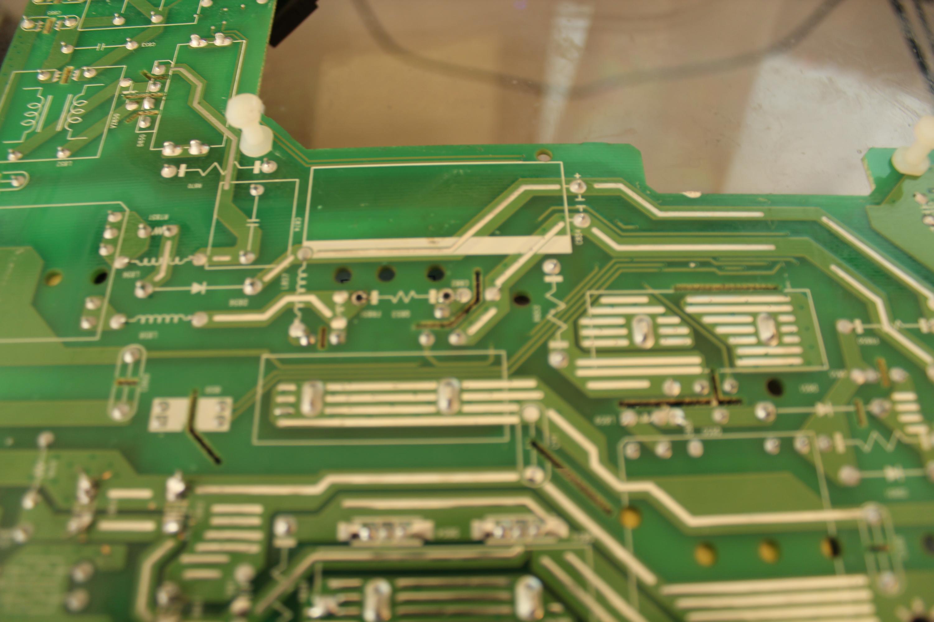

                  Can I get a clear straight shot of the pictures? I cannot see the traces well.
                    #29
                    Re: Dell U2410f

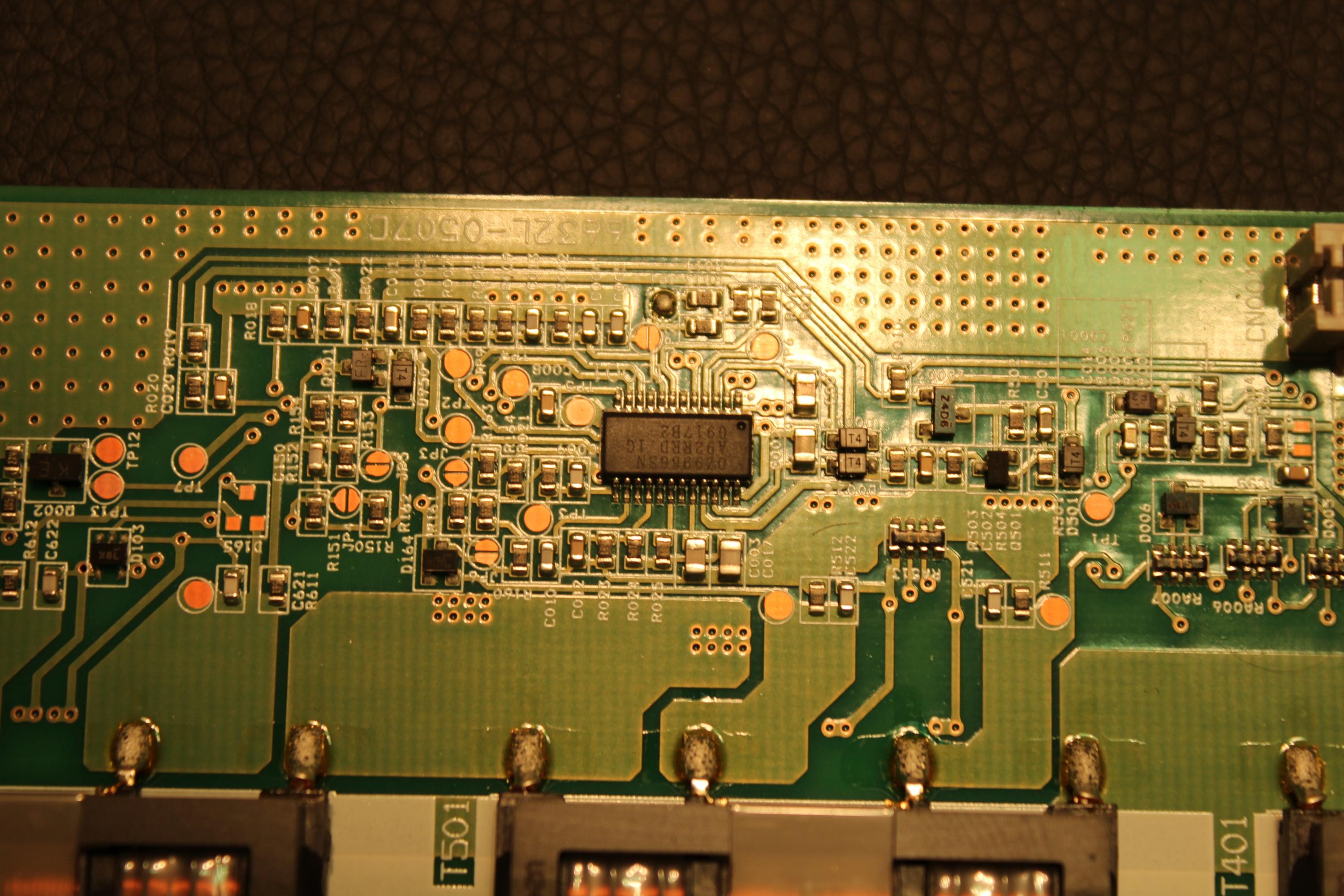

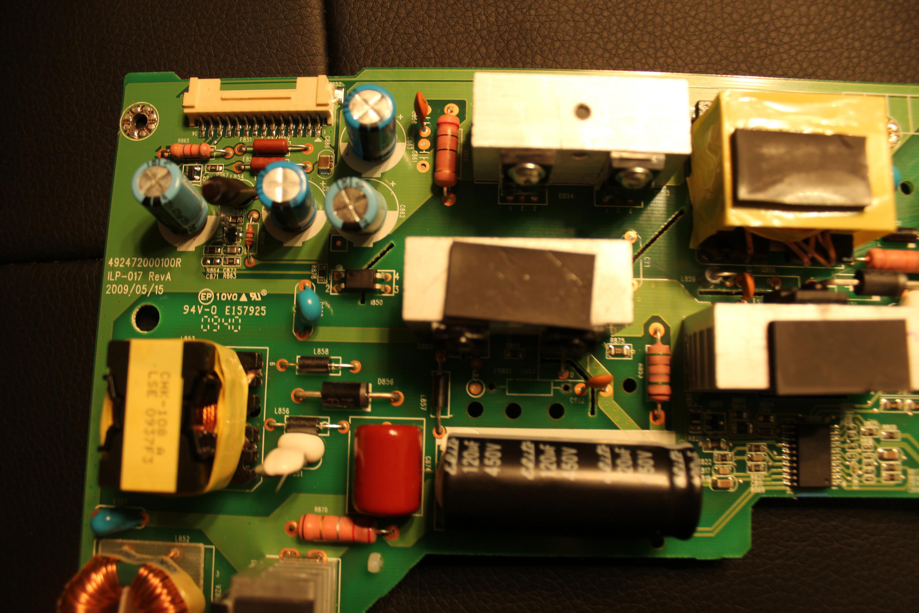

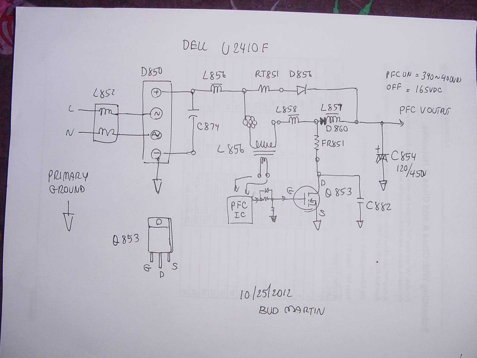

                    Since that fusible resistor FR851 blown up, it can be that the MOSFET Q853 is shorted out or you may have shorted the bottom end of FR851 to primary circuit ground.
                    You need to check the resistance of Q853 between S and D, S and G, D and G to make sure it is not shorted out. We need to get this PFC circuit working again.
                    I draw up the diagram as good as I can get from the pictures.
                      #30
                      Re: Dell U2410f

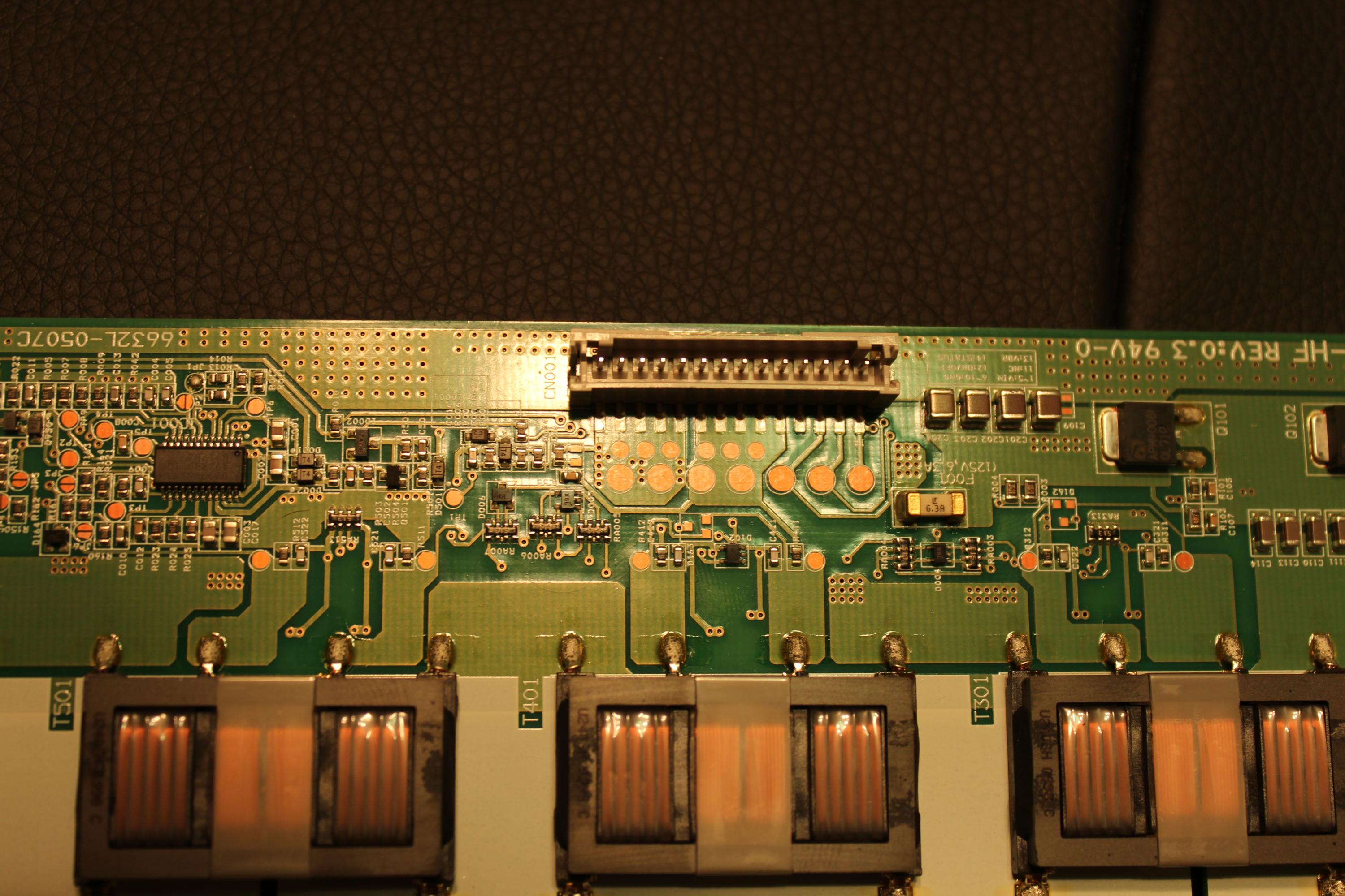

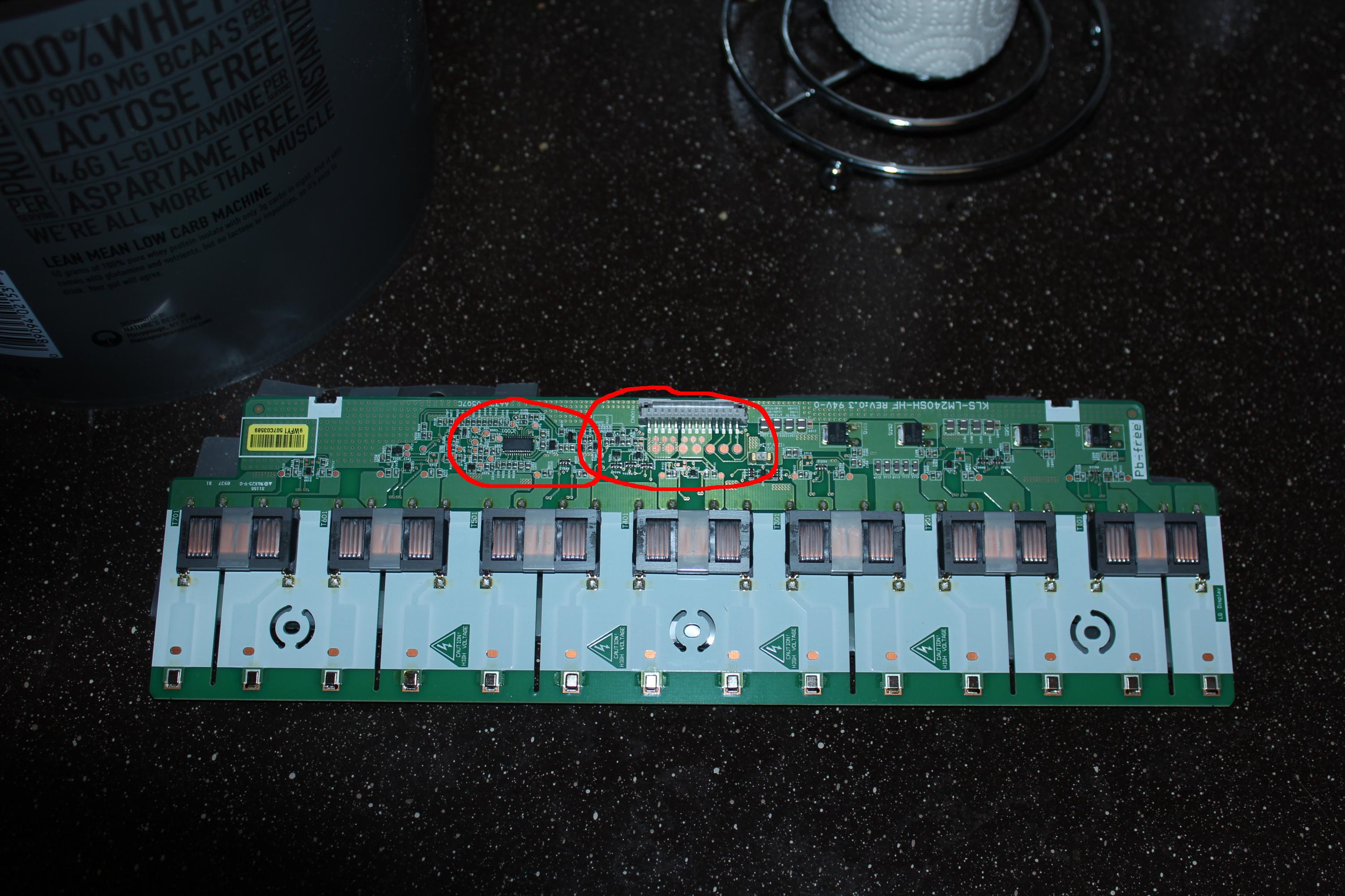

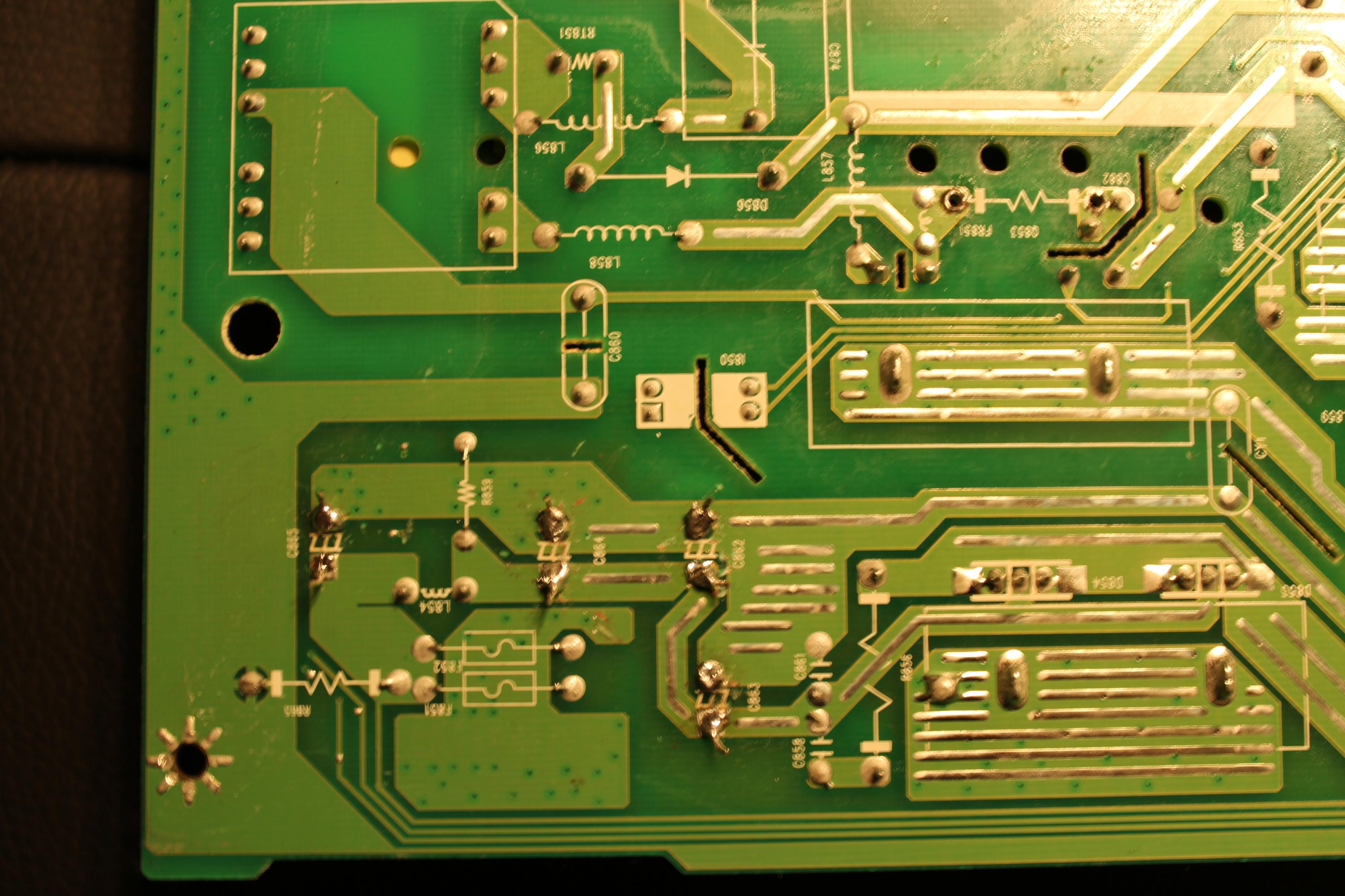

                      Can I also get the LCD panel P/N so I can look up the spec sheet? it will tell us the pinout of the inverter board.
                      Also closed up and focused pictures in red circles.

                        Just wanted to let you know that I won't be able to get to these pictures until late this evening.
                        ~Sam

                          I believe the P/N is KLS-LM240SH-HV Rev:0.3 94-0 the other number on the board is 6632L-0507C which is close to the right circle in the last post.

                            Re: Dell U2410f
                            I'm pretty sure what happened was I grounded out the resistor. Not smart on my part.. Regardless, the resistance readings I'm seeing across Q853 is SG: .6, SD: 2, and DG: 2.4 a bit rusty, but from what I was reading on another post if any of the readings are less the 30 ohms it's probably shorted out. This very well could be the case.. idk, I think the best thing will to get my blunder patched up and then begin solving the original issue

                              I took measurement resistance measurements on the Q950 and Q850 MOSFET and had measurements as follows on the 20k MM setting.
                              Q950: GS - 9.43, SD - 0.L, DG - 0.L
                              Q550: GS - 9.16, SD - 0.L, DG - 0.L
                              So it does indeed look like the Q853 MOSFET was shorted out as well.
                              I also did notice a small dark mark on the bottom side of the board that I've attached a picture of. I'm not sure if this would cause anything to be a problem or not, but wanted to note it.
