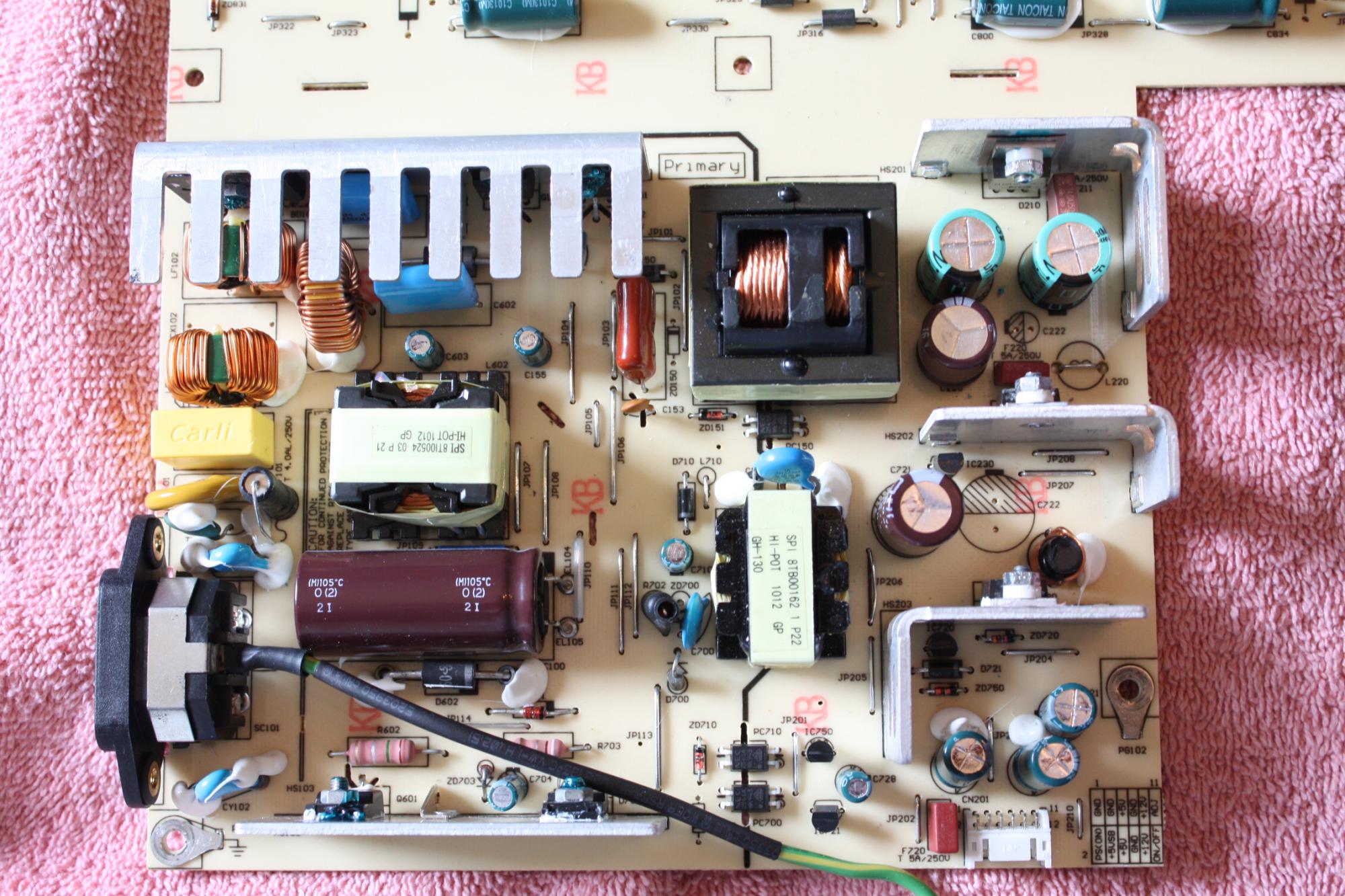

    I bought a this monitor and it does not power on. No lights no nothing. Please give any info on how to fix it

    open it up check capaitor and voltages from regulators
    if you do not find a problem upload pictures of board
    read the section on how to upload pictures

      I think that your monitor and the one in the link I am giving you are the same, yours is manufactured my Hanns G. Read the info in this link and when you open your monitor check the pictures of the power board provided on the link to see if it is the same as yours.

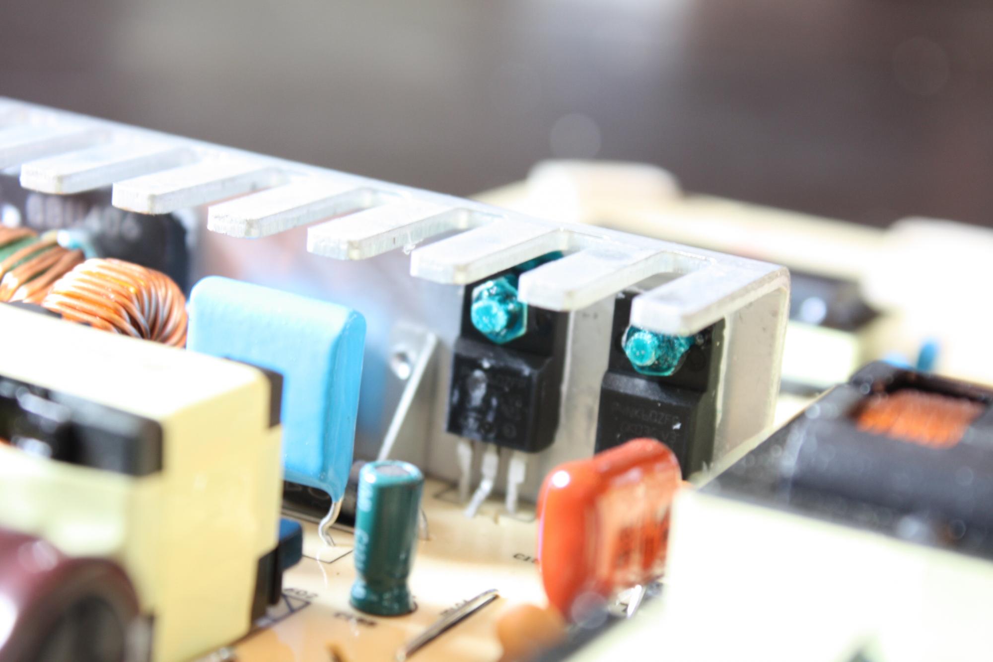

            The caps have no bloat.

                simple things first: check the fuses (those wine-red boxes in your pics)

                  The main filter cap was around 170v. The six connectors going to the logic board was also checked. On the 5v, I got .1 sometimes .2. The 12v was .1 and then 0 then 2. then 0. I believe this is a cap problem. Also the fuses were good.
                  If there is any thoughts on this, please let me know. Until I can get the new caps, it kinda of a stand still. I would like to check out the other boards. but without the power board, it will wait.

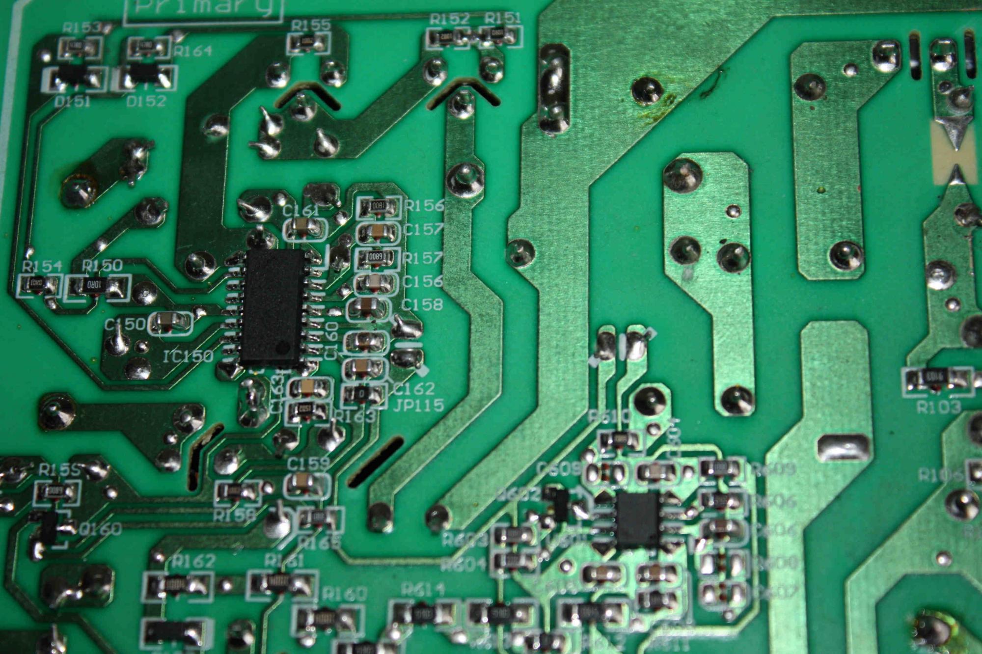

                    Suggest you measure the voltages again, with ONLY the Power board connected,and no others.If you still get no voltages then I would check to make sure the SMPS chip is working.You will need to take photos of the bottom of the Board,and please use the 'managed items' attachment,and not post in line.

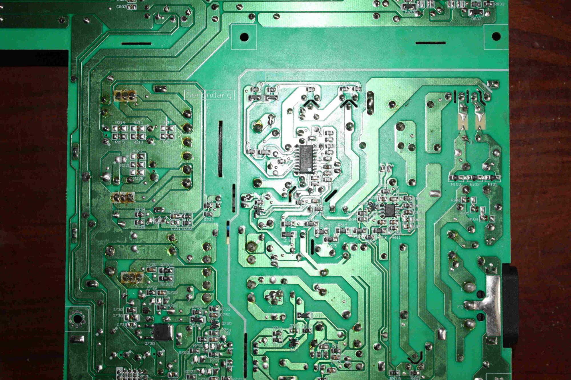

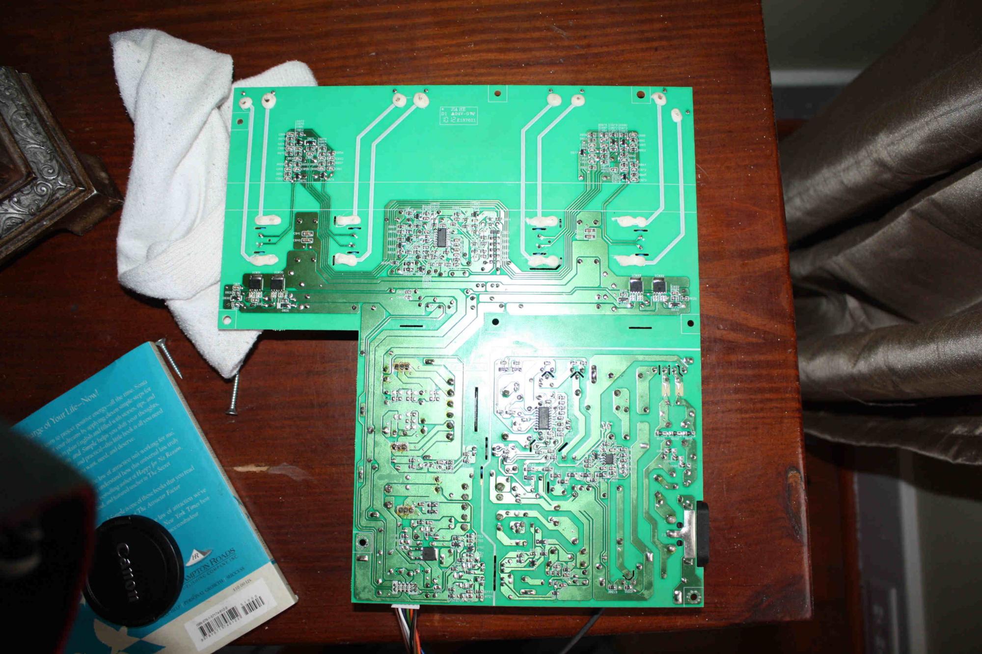

                        Here's the pics of the underside of the psb. The readings earlier was w/o the logic board attached. Still no readings at the connector, unless I'm doing something wrong. Here is the pics, again....

                          Google the datasheet for the SMPS chip, and take readings,unfortunately although the photos are fine, cannot read what it is.

                            The two chips in the last pic are as follows: Q150 and Q151 with P4nk602fp ST. There are two more chips along the heat sink wall across from the heat sink with the grated top. They are: U700(STR, w 6252, 0311E). And Q601 with( P10NK602, GE 146) I hope this helps.

                              On your photo 3 shows a 8 pin device...thats the one I mean.Also presume you have checked the devices you mentioned on the heatsinks, as without looking for all the details,there are Schottky diodes on there, and if one of them is short cct, will give you your symptoms .

                                Are you referring to IC150? I cannot see any written on it. But will look again with bigger eyes.

                                    No IC 601, the smaller one !!

                                      Ok. The Q601 is a Fairchild chip. FAN6961SYB The data sheet is on this link:
                                      www.fairchildsemi.com/pf/FA/FAN6961.html
                                      It took me awhile but it's there. I believe this is the one.
