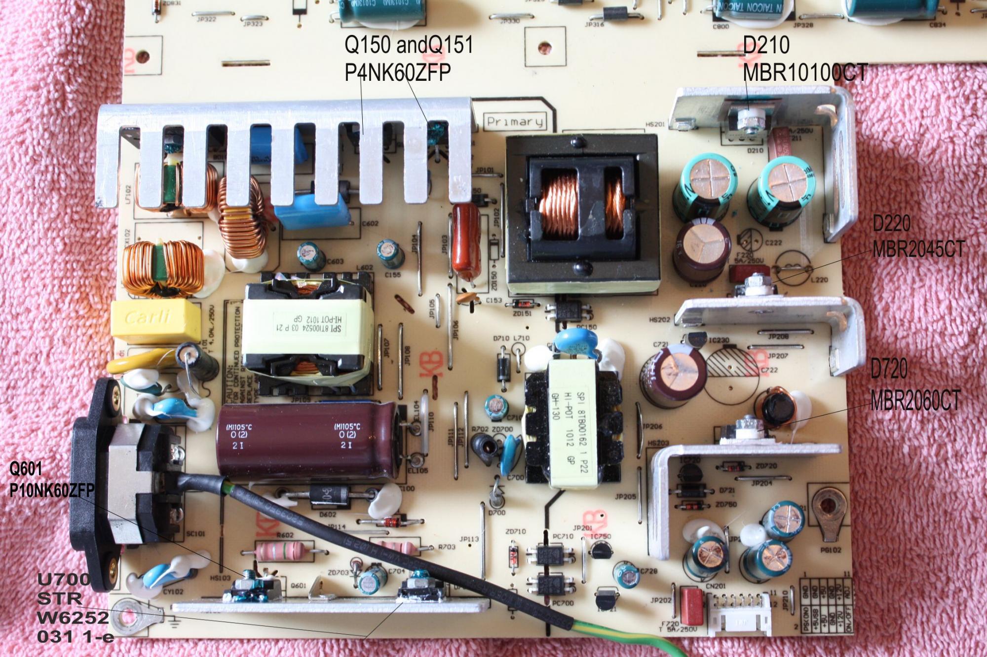

Yep. Pin 1....0
Pin 2...0
pin 3 through 12....o
Also, I read up on how to measure those schotkzy diodes. One was to put the black probe on the BIG cap negative side, and the red on the middle pin of the Schotkzy, Power on. And the other way is to measure with the diode test pwr on. All i'm interested in to see where the power stops at. The inverter board is dead. I guess i will try to get thenew caps soon, but really wanted to find out if that is the only problem. I'm rather new to these newer LCD's and my electronic knowledge is constrained. Please bear with me on the learning curve.
