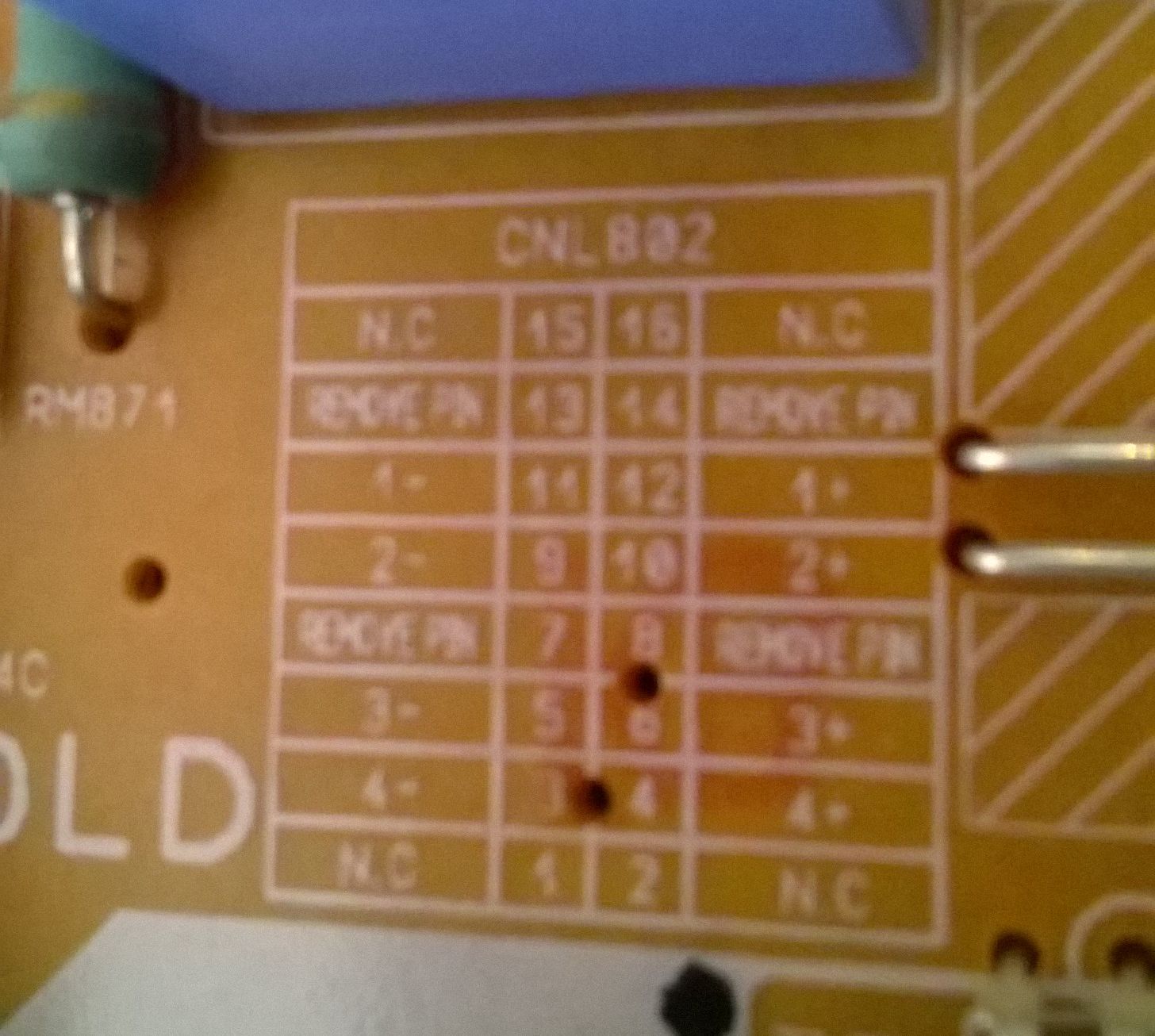

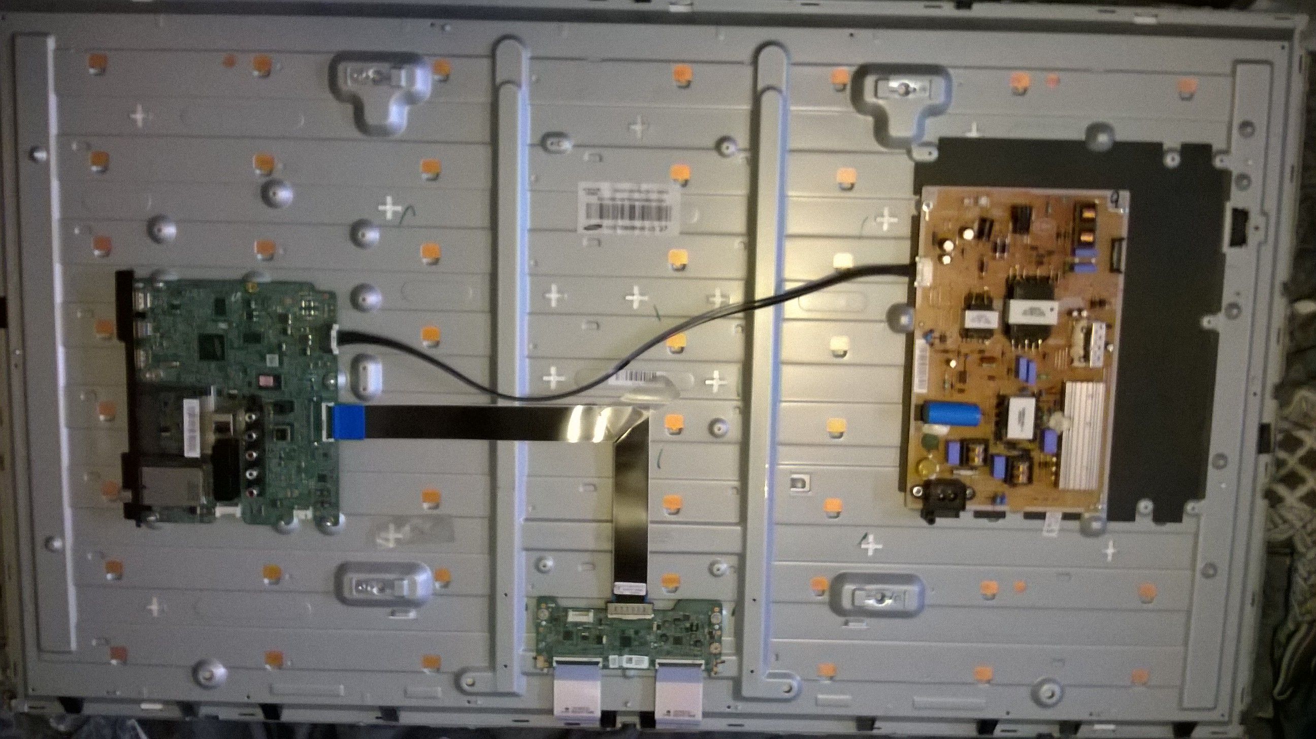

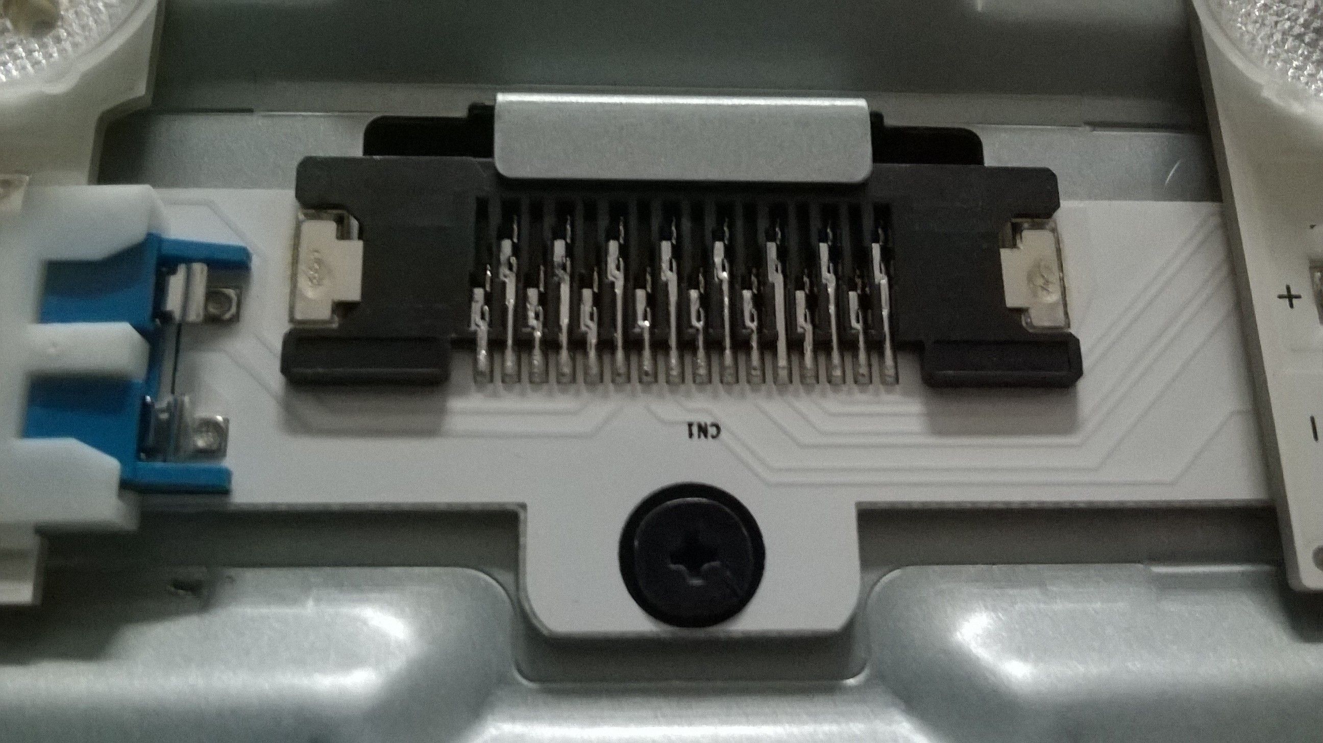

    When the Main board is disconnected, the back lights are off but tapping on the chassis makes them light up and all voltages are then good. Connecting the main board up makes the TV work normally until moved. LED INERFACE STRIP BN41-01971A has a short on the first 2 pins on the left of the picture, the cable tests good. All the other pins and all LED strips test good. Is there an easy way to fix the short or do I need a new interface. Any help would welcome.
    PSU number bn44-00610A L46SF_dpn

    Just noticed the pinouts are printed on the power board, pins 1 and 2 and 15 and 16 aren't used so I haven't got a short.

          This power supply will not start without a load of 5v and 13v (there is protection), and accordingly there will be no backlight when the motherboard is turned off...
