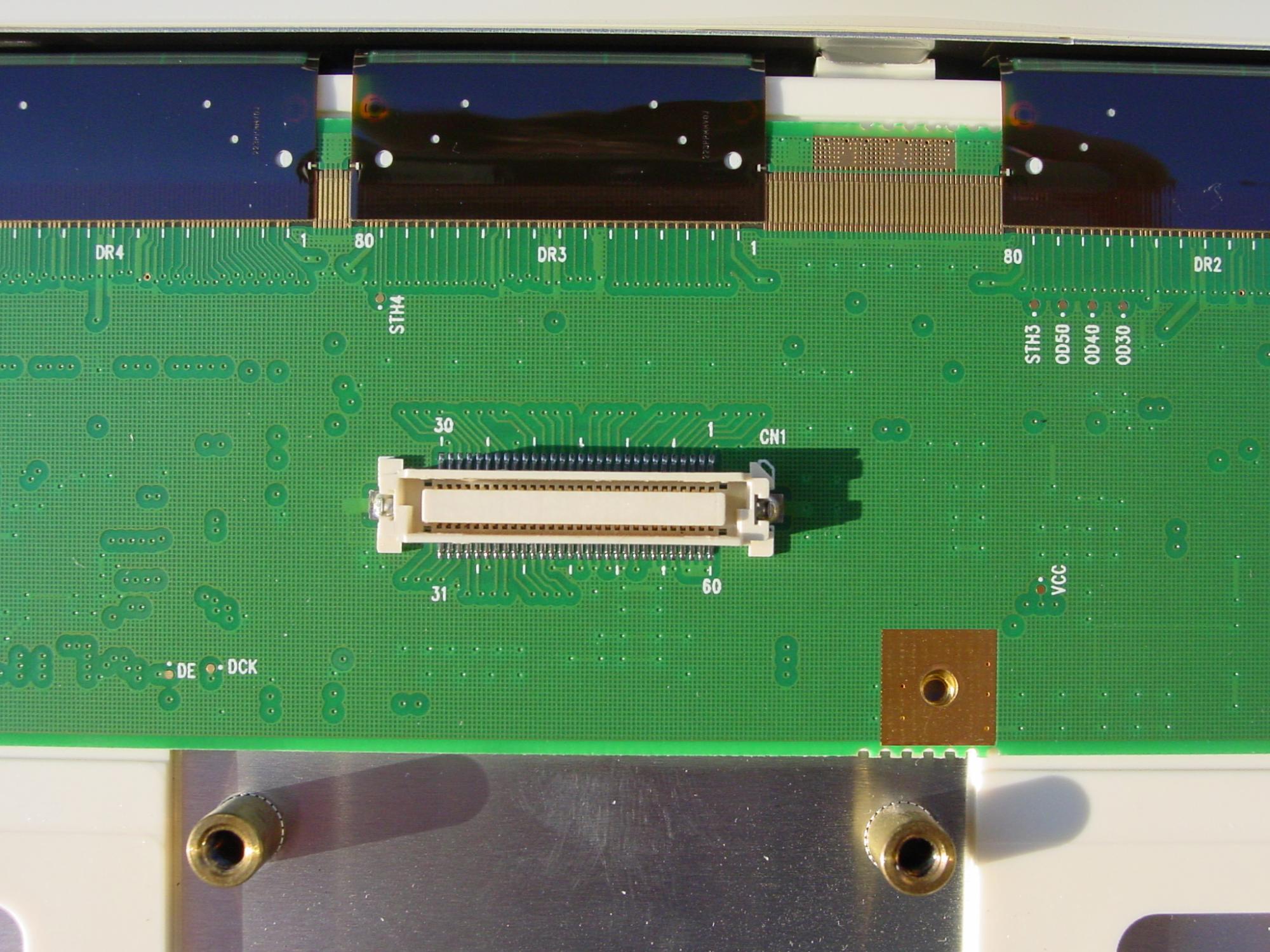

            There could be an overload on the t-con board (the board that attaches to the LCD panel).

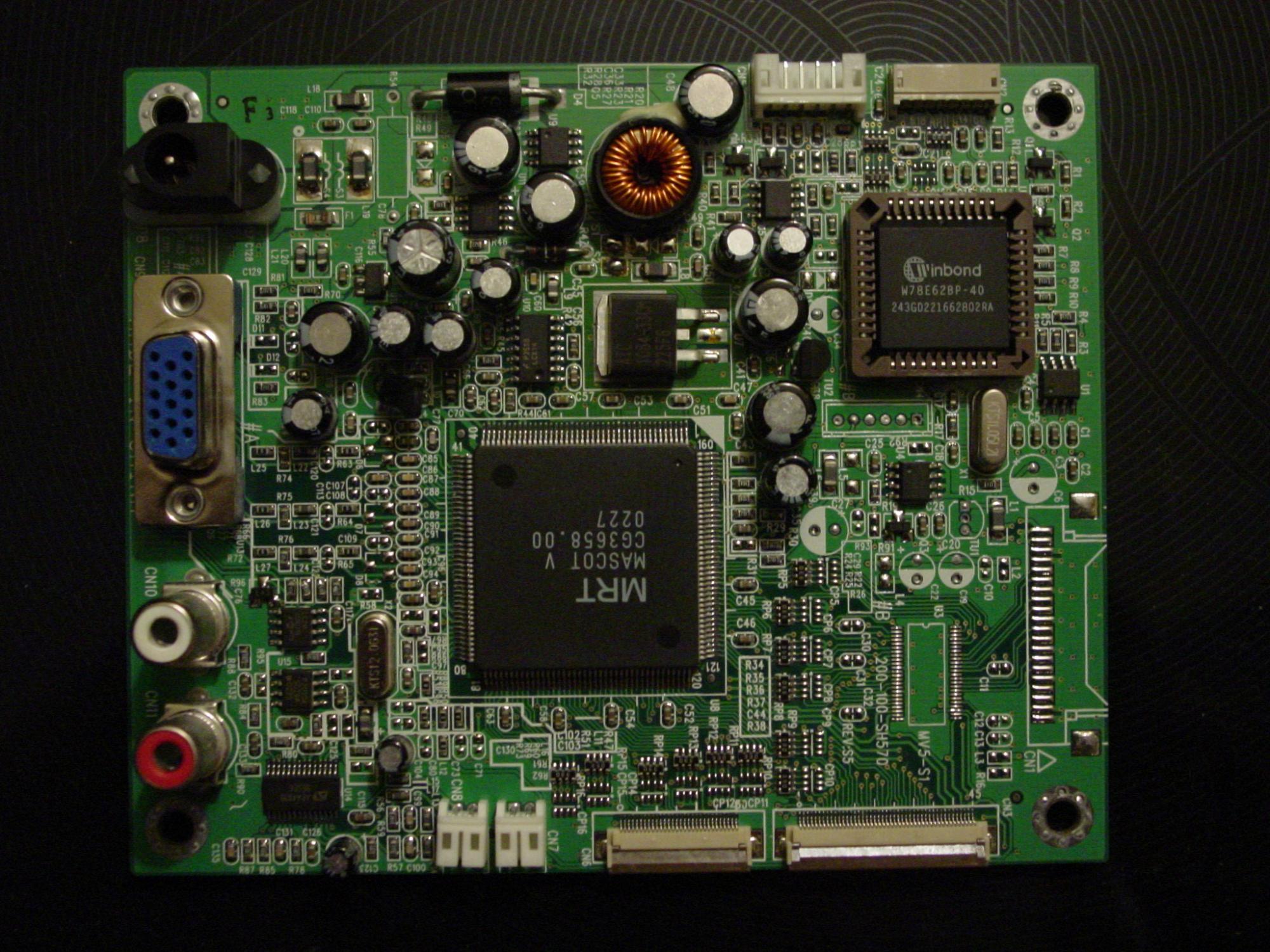

            Do you have a multimeter? If so, post some pictures of the t-con board if you can. The area around a surface-mount inductor is of most interest. It's usually near the connector that goes to the video/logic board.

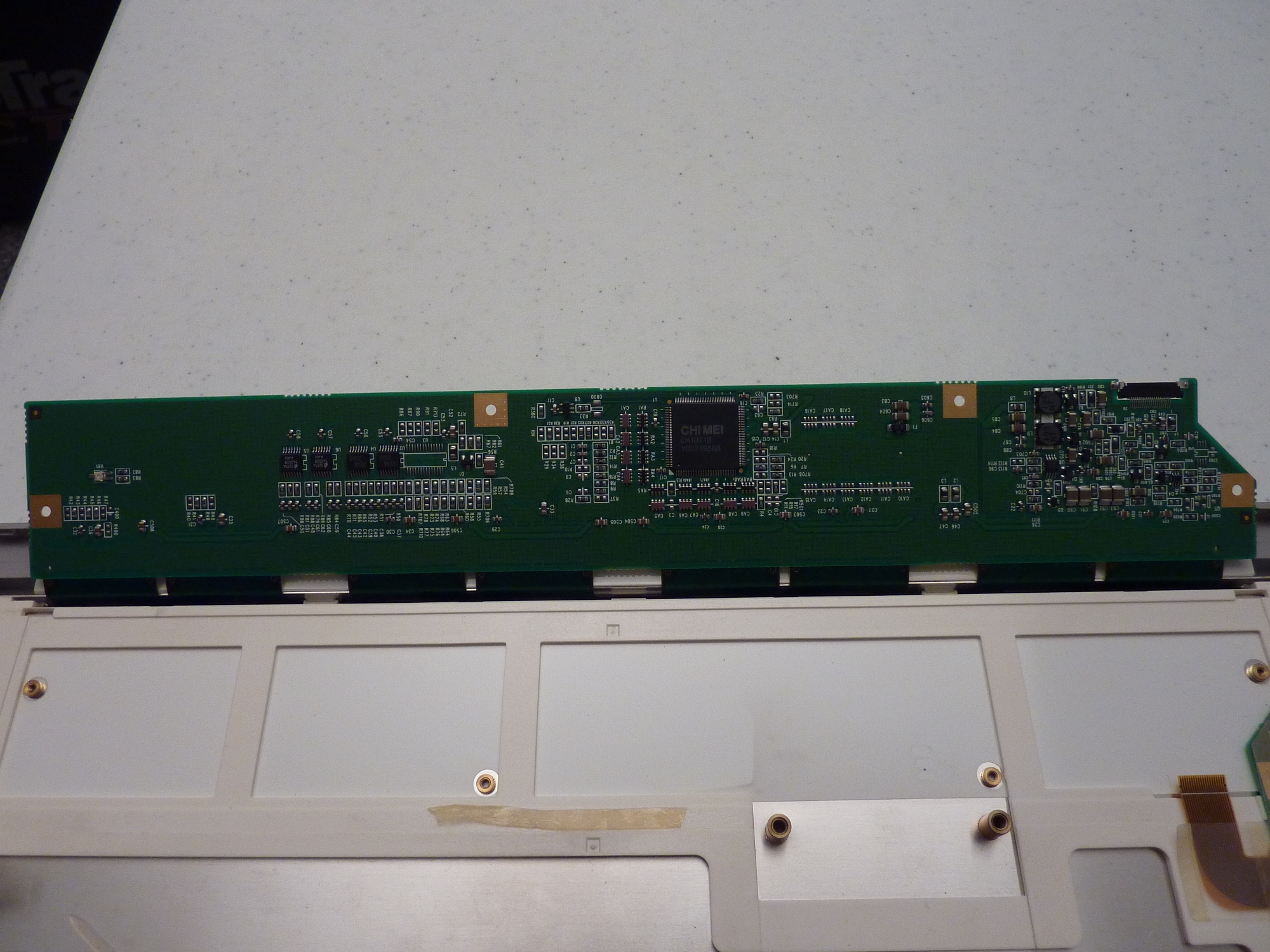

              Yes, I have a DMM. Attached are the pictures as requested. There are several inductors in the same quadrant as the connectors (L1 and L6 exist, L2, L3, L4, and L5 are labeled, but are not present on the board) Both L1 and L6 read 1.7 ohms.

                Re: emachines eView 15L - Blinking power light

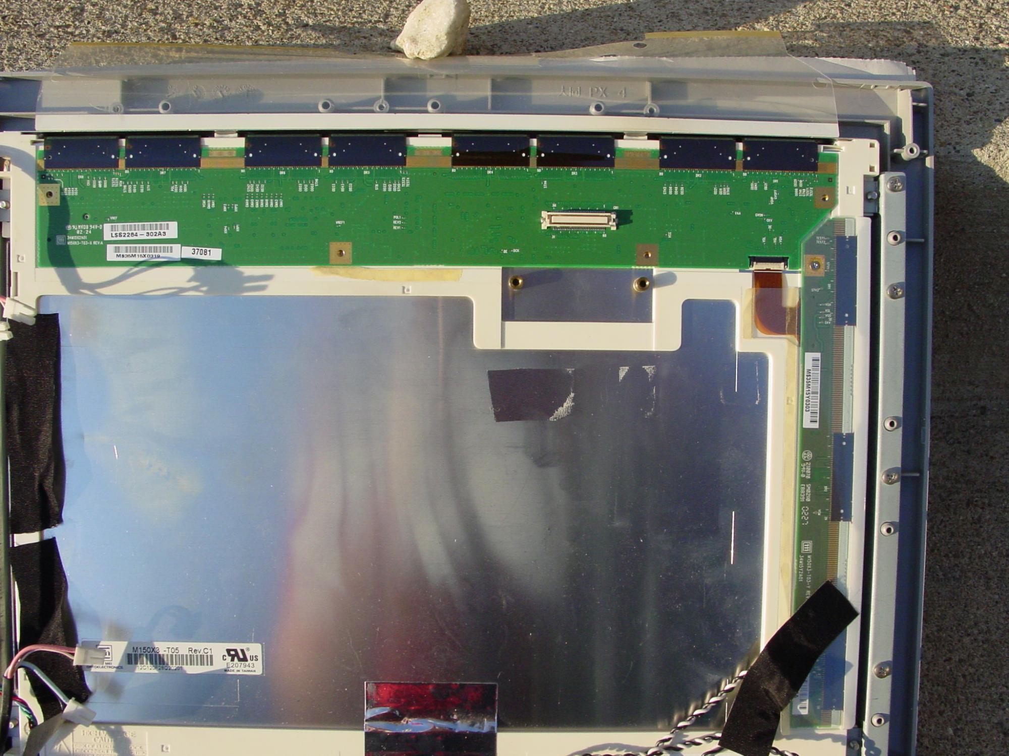

                What you have above is the video/logic board. The t-con is the one is usually hidden under a metal cover on top of the screen and is permanently attached to the LCD panel with thin ribbon cables.
                • jayoung
                  • May 2011
                  • 172
                  Sorry about that, I seen "connector that goes to the video/logic" and went for pictures of the logic board. Here are the ones you were looking for. There are actually two boards that connect to the lcd panel that are connected themselves with a ribbon cable. I tried it without the second t-con board connected, but with the same results.
                    Sorry for the late reply.

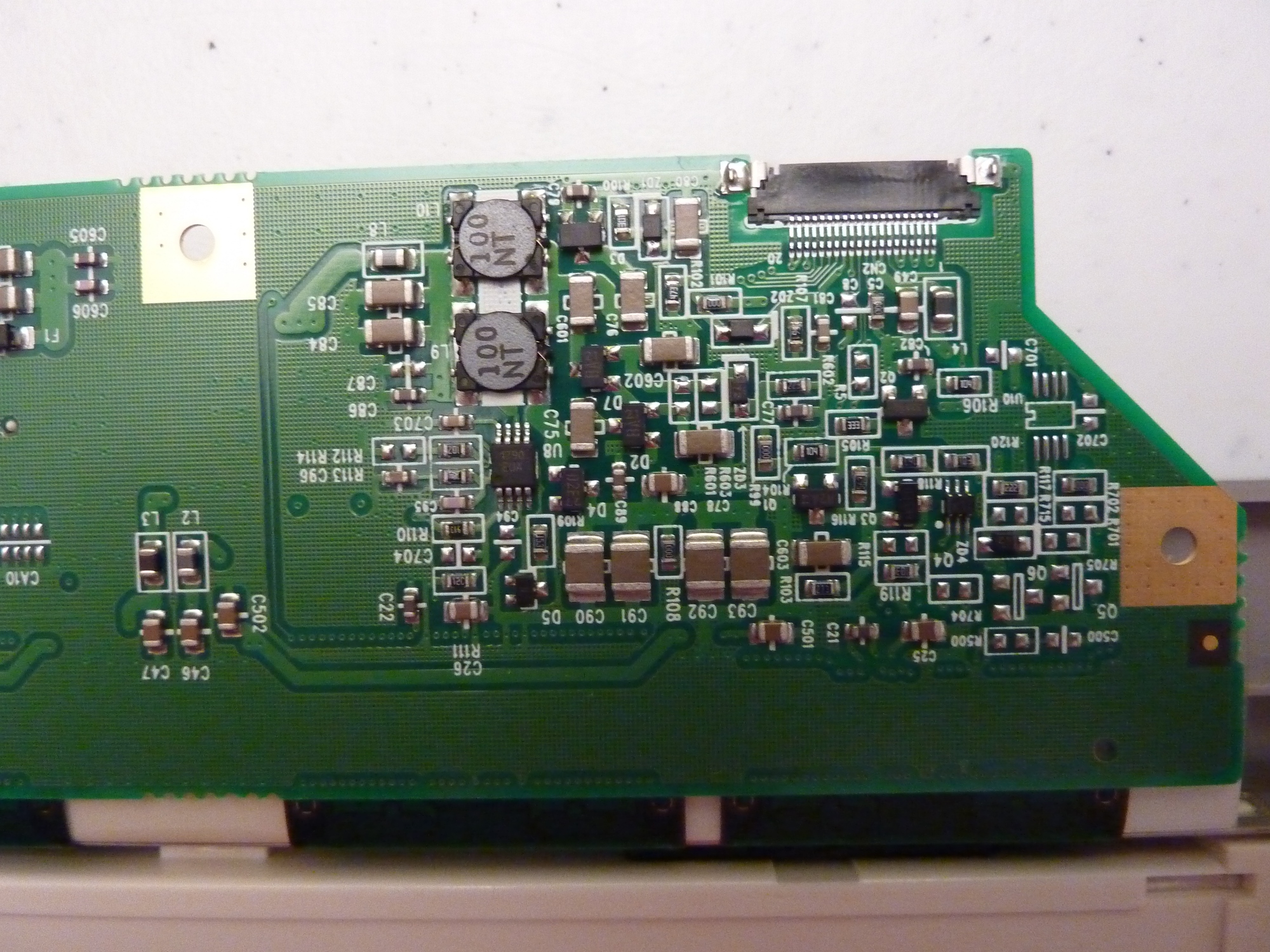

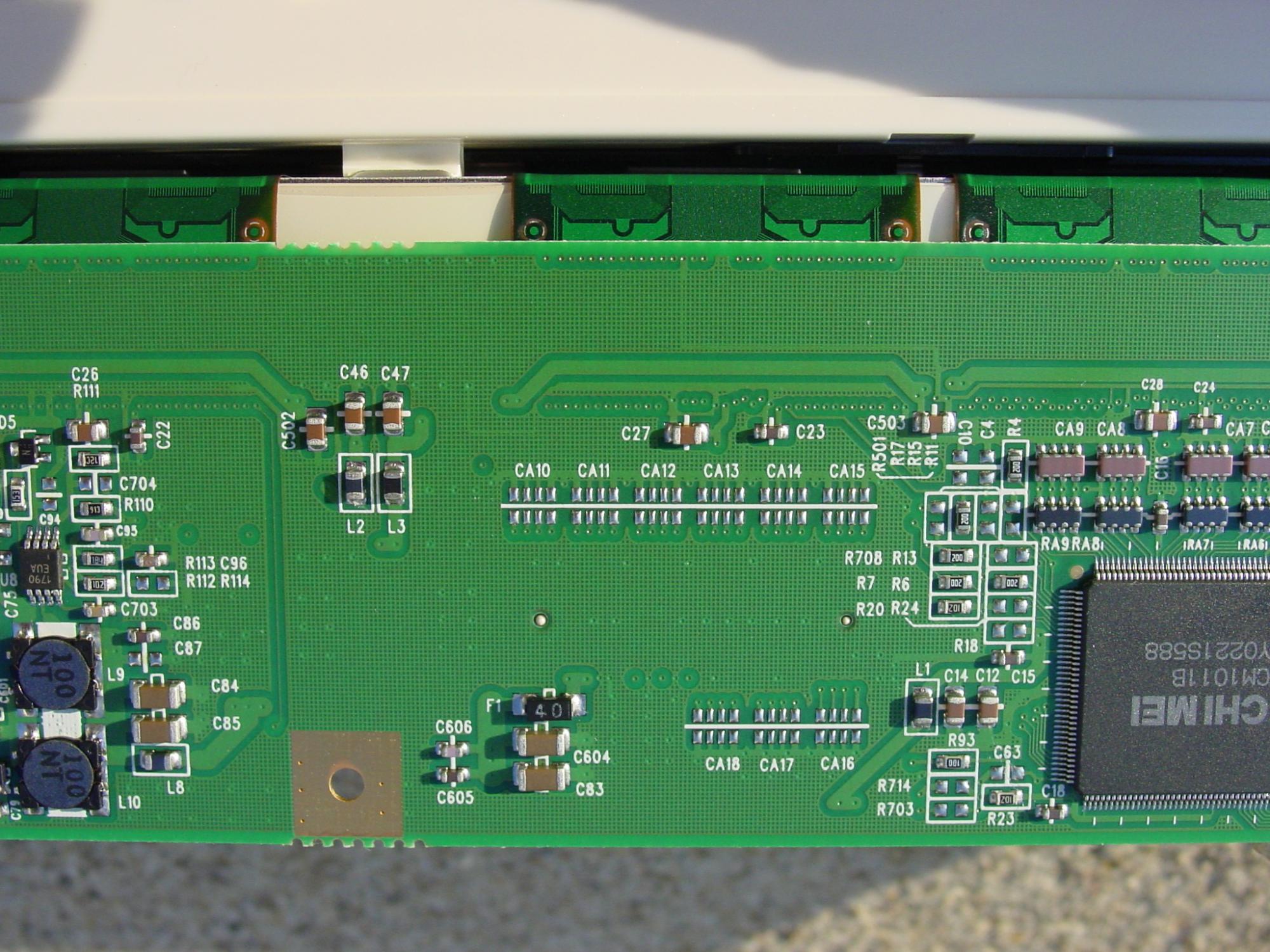

                    Looks like you have a reversed t-con board (the components are on the back rather than on the front of the board). The 3rd picture almost shows what I need. If you can take 2 more pics (of the big t-con board) - one overall with the side that has all of the components and another picture of the area around the two round inductors L9 and L10. That should cover everything of importance.
                    In the 3rd picture you posted, there's a fuse (F1) with "40" marks on top. Check it with your multimeter. Use lowest resistance scale and measure the resistance across the fuse - it should show 2 Ohms or less (depending on how good your multimeter is at low readings) or basically a short-circuit. If you get a "0L" or a "1" on the left side of your DMM, then the fuse is open (bad).
                    If the fuse is good (shows 2 Ohms or less), check resistance on the input 5v rail to ground. Use 200 Ohms scale. The input 5v rail is connected to F1. That means, put the black DMM probe on any ground point on the t-con (such as the exposed copper areas around the screw holes) and red DMM probe on one side of F1 (it doesn't matter which one if the fuse is good).
                    Do you get more than 100 Ohms resistance?
                    - If yes, then there likely isn't a problem on the 5v rail.
                    - If no, then what resistance do you get?
                    By the way, just a word of caution: be careful when flipping the t-con board. Those thin flex cables that hold the t-con to the LCD panel are not always glued/soldered very well to the t-con. Try to avoid bending them too much or too many times.

                      Pictures are attached
                      Fuse is good (0.4 ohms same as touching the two probes together)
                      On the 200 ohm setting, I get OL. On the 2000 ohm scale, I get a reading of 814 ohms.

                        There's only a few more other things to check, now that you provided the pictures.

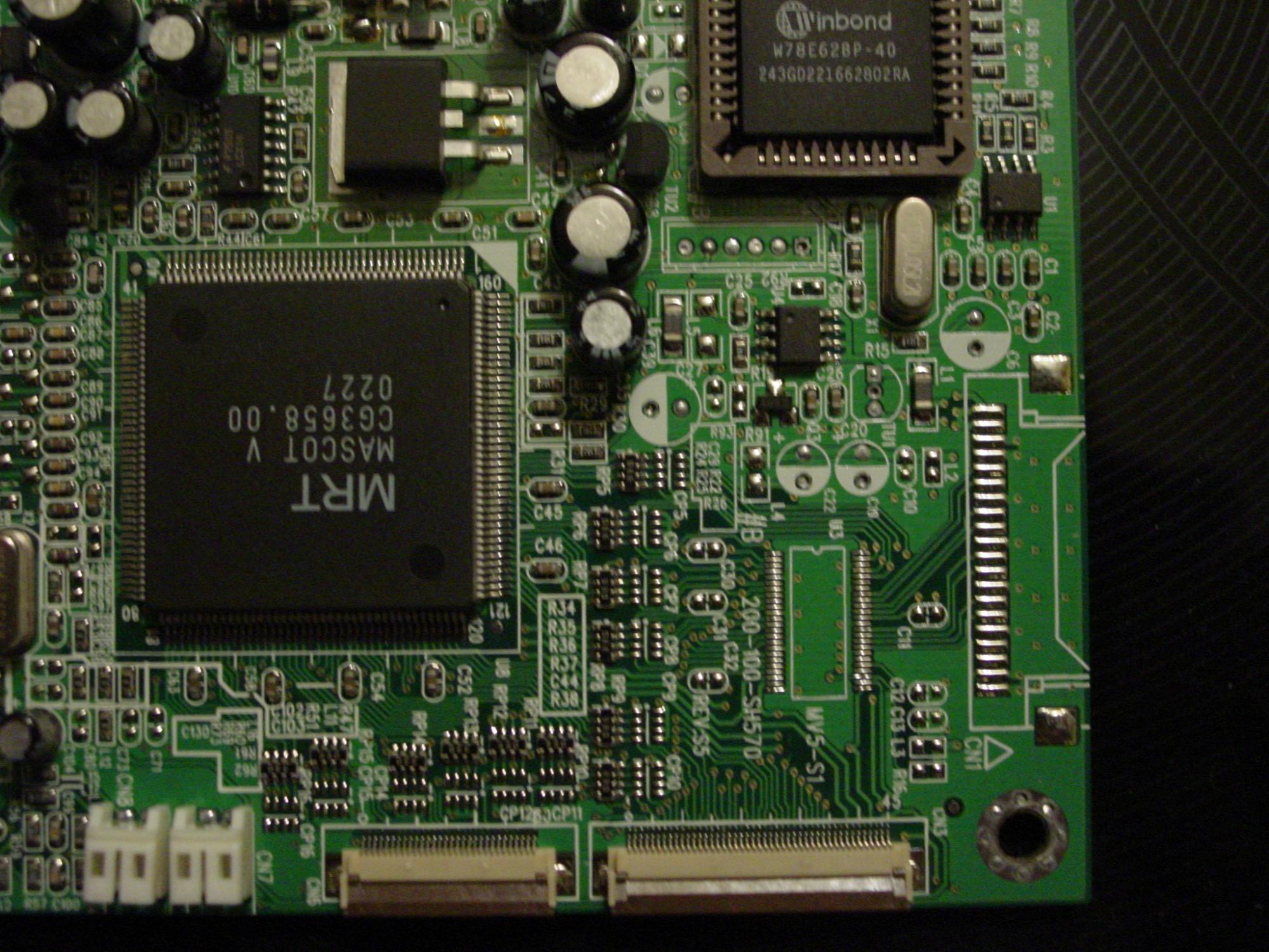

                        Using the second picture you posted above as a reference, measure the resistance across the following (use 200 Ohm scale only):
                        - ceramic capacitors (rectangular, beige components) C90 or C91 (doesn't matter which one you pick, since they are connected in parallel)
                        - ceramic capacitors C92 or C93 (again, it doesn't matter which one you pick).
                        - ceramic capacitors C603, C75, C78, C602, C76, C601, C80, C79, C81, C82, and C46.
                        ---- if you get OL or over 100 Ohms for any of these, they are likely fine.
                        ---- for the ones you get less than 100 Ohms, let me know what readings you get.
                        Using the first picture you posted above as a reference, measure the resistance across the following (use 200 Ohm scale only):
                        ceramic capacitor C41. Like for the other capacitors you measured above, see if you get anything lower than 100 Ohms - if not, then C41 should be good.
                        I hope this doesn't sound like a lot of work. Should only really take about 10-15 minutes at the most to check these.

                          C90 - 890 ohms
                          C91 - 890 ohms
                          C92 - 890 ohms
                          C93 - 890 ohms
                          C603 - OL
                          C75 - OL
                          C78 - OL
                          C602 - OL
                          C76 - 1048 ohms
                          C601 - OL
                          C80 - 715 ohms
                          C79 - 1058 ohms
                          C81 - 552 ohms
                          C82 - OL
                          C46 - 891 ohms
                          C41 - 913 ohms
                            master hoarder

                            Pretty healthy readings, or at least everything in the power supply section of the t-con seems to be in order.
                            Not sure what else to suggest. Perhaps the t-con is working right but maybe there's a problem in the video/logic card?
                            If you feel like playing with it a bit more, just check the rest of the ceramic capacitors on the t-con board (as they are usually the component that fails the most) for short-circuit. I doubt you'd find anything wrong, though.

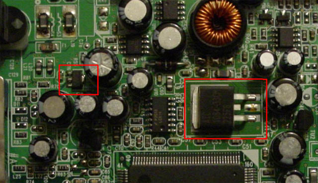

                            Other than that, I also see 2 voltage regulators on the video/logic board. I'm almost positive they should be working (otherwise the buttons on the monitor likely won't function at all, even with the t-con detached), but check them anyways. For these, measure the voltage on each pin with respect to ground.
                            The one on the right in the picture I included should be a 3.3v regulator, so you should see 3.3v on one of the pins. The other smaller one, I'm not sure since I can't see the part numbers on it.
                            Let me know what you get.
