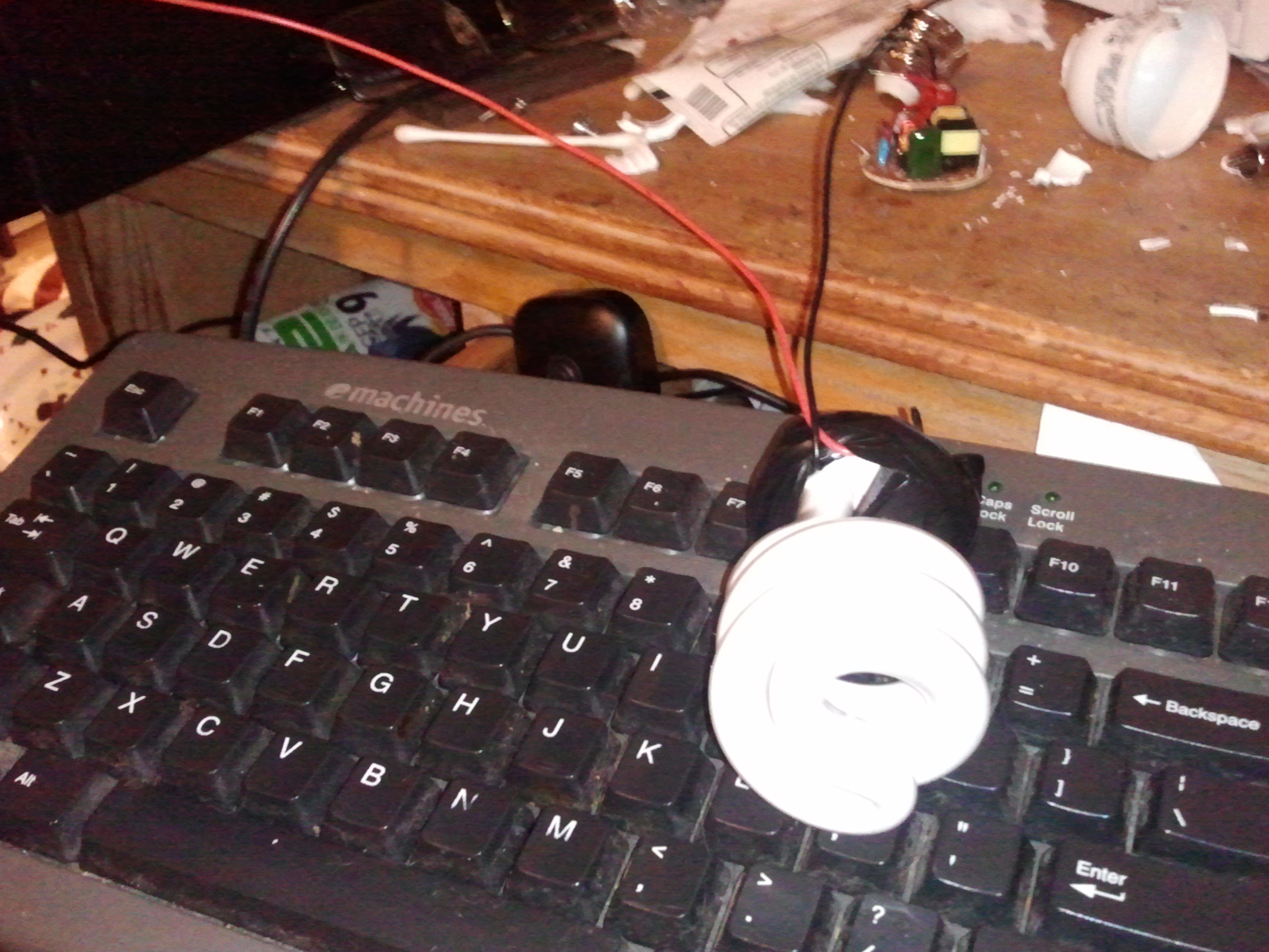

        Just make two test lamps and solder the wire directly to the lamps sockets on the board solder side.

          budm......correct me if I am wrong but if I read you information so long as it is 14 watt or smaller it should be fine as long as it is a cfl bulb correct. if that is the case then this should not be too difficult to organize. and just to confirm if I understand what you are saying I should solder the connections to the reverse the actual connection points were the plug for each cfl is on the board...sounds easy enough...now to grab my hammer and get to whacking so to speak....thank you for the help....will reply back when I have had a chance to see what I can make of it all.
            Re: Gateway Model LP1925 2 seconds to black image is visible with a flashlight

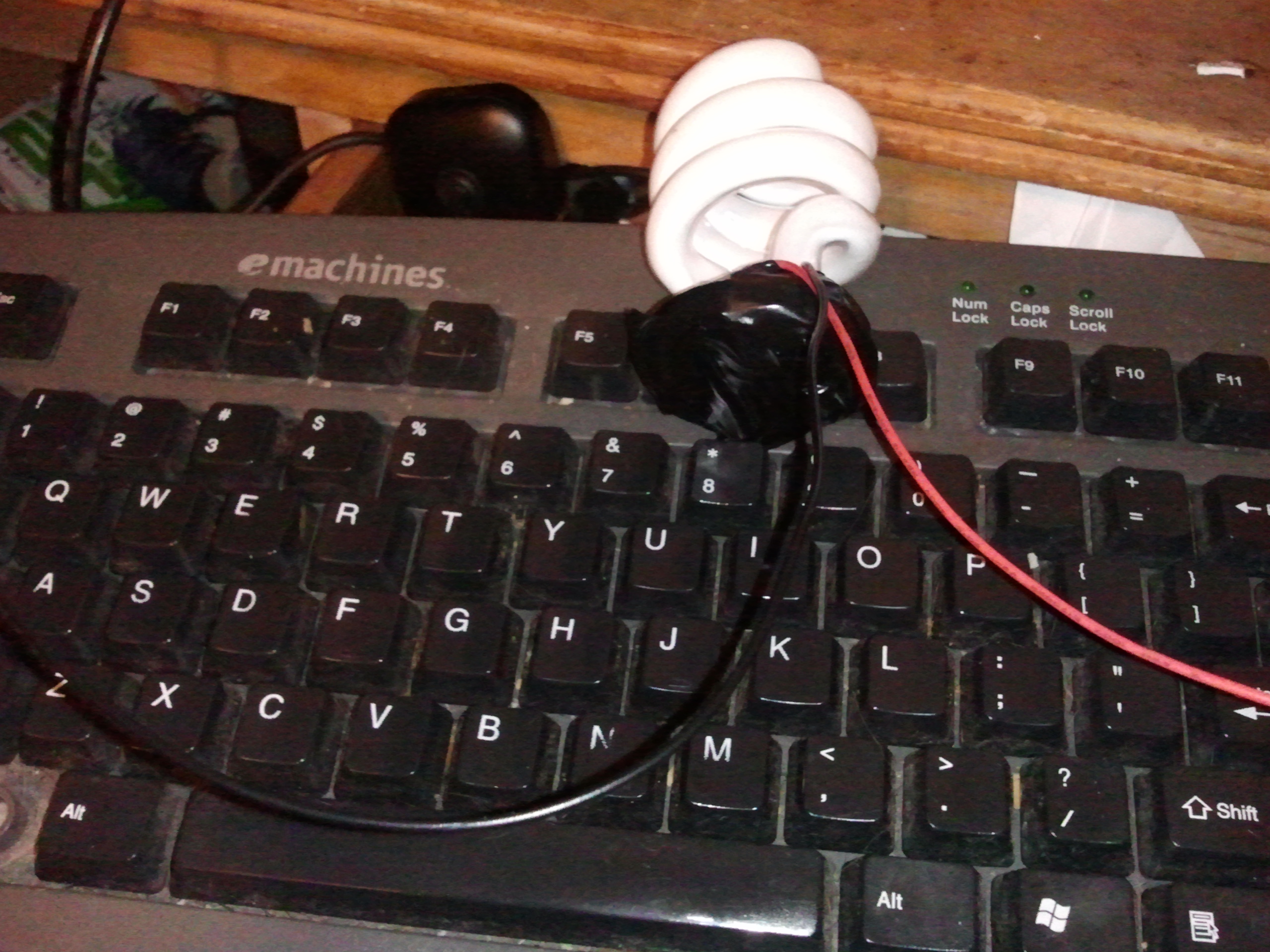

            That is correct, the larger tube may not stay on. Yes, solder to the pins on the bottom side of the board, I do that when I do not have the matching connector to plug into the lamp sockets on the board.
              Ok, today's project went well....I did what you described and made the test bulb. I got 13 watt bulb, but i was concerned with how brittle the filament wire in the bulb was so after I soldered the connections i wrapped the bottom of the bulb with super 33 3m electrical tape. to help keep the wires safe and hopefully reduce movement as I might opt to use the bulb again in the future i hope. i used 22gauge solid wire for my leads. And I can also tell you that a razor blade cut through the bulbs outer shell but I do not recommend it unless you are calm and secure and have a anti cut glove. Does this look good to you budm?

                OK, attach both lamps to the set of sockets on the board and see if you will see any arcing since the start up voltage can be as high as 1500V.

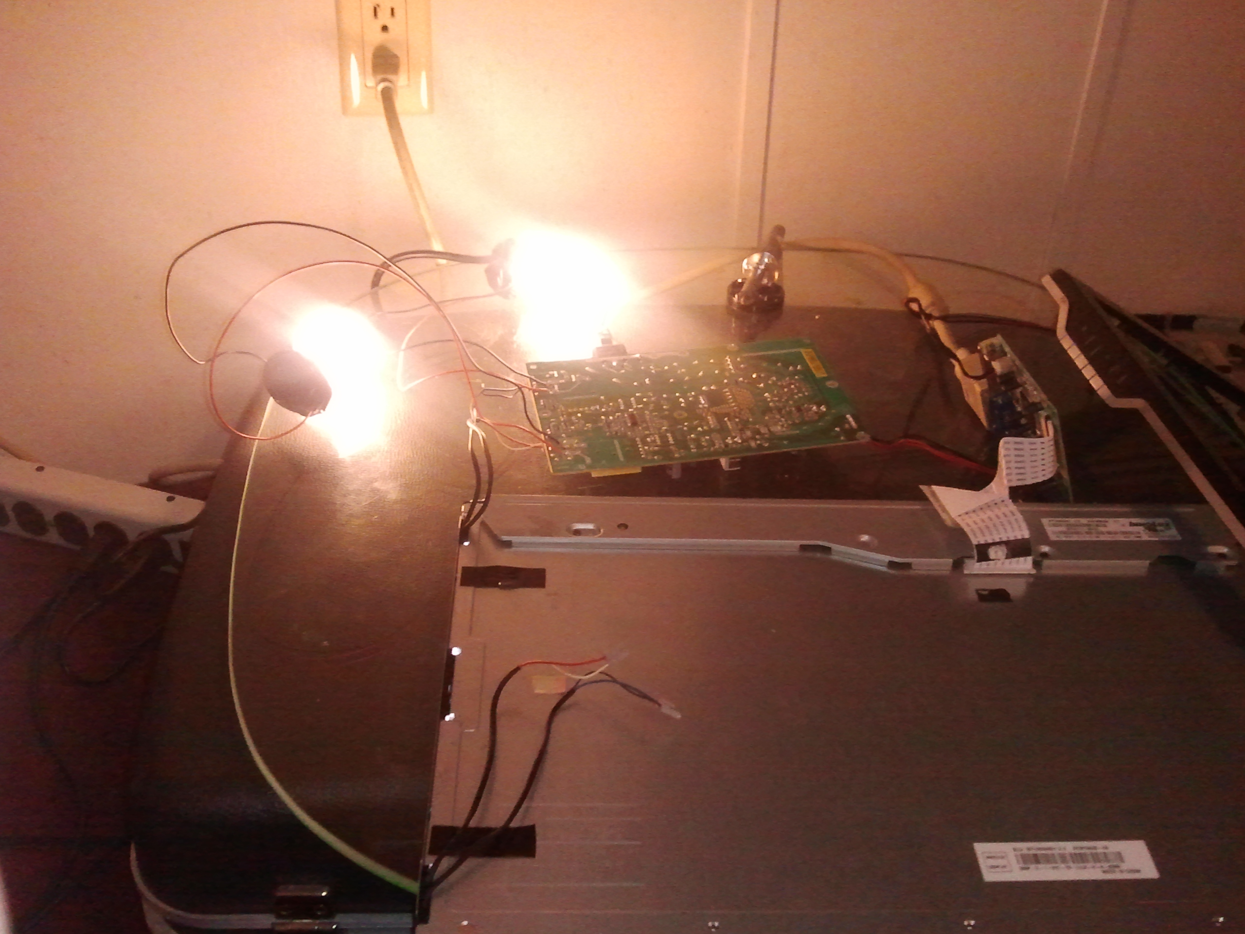

                              Ok I have the system set up. Have been testing this is what I have found so far.
                              I marked one light so I could distinguish the two sets. For simpler purposes here is a basic idea of what i had
                              #1= Red+white wire set = lamp one
                              #2= Blue+Black wire set = lamp one
                              #3= Red+white wire set = lamp two
                              #4= Blue Black Wire set= lamp two
                              Test sequence ran
                              1=4-appeared stable-did not shut down
                              2=4-appeared stable-did not shut down
                              2=3-appeared stable-did not shut down
                              1=3-appeared stable-did not shut down
                              1=2---flashed on....shut down
                              2=3---flashed on shut down
                              also noticed bulb -2 when powered on if wire was touched or wiggled the far end of bulb would flash or flicker.....tested further did not see this on any other bulbs wondering if it could be bad connection on bulb.
                                #35
                                I do not quite understand your setup.
                                Form your pictures, there are two set of lamps on the LCD panel assembly; 1 set for the top edge, 1 set for the bottom edge.
                                So if you plug 1 set of the top edge into the two sockets sitting close to each other, then solder in the the two test lamps to the other 2 sockets sitting close to each other and the all 4 lamps come on and stay on, then it indicates that the inverter is OK.
                                The bottom line is that if all the lamps stay on, the inverter circuit is good.

                                  The picture is a little misleading sorry. that was the only picture i remembered to take. Two of the bulbs were hooked up from the monitor but i did not like how i was having to pull the wires like that. So i took the monitor all the way down and removed the bulbs .
                                  I hooked one test bulb to the top set of bulb connectors ...and one test bulb to the bottom bulb connector. since i did not think it would matter 100% which connectors they were plugged into. Then used the two remaining plugs to test the bulbs

                                      If you can get all 4 lamps (two test lamps, two LCD panel lamps) stay on, then you will need to look at the lamp assemblies next.
