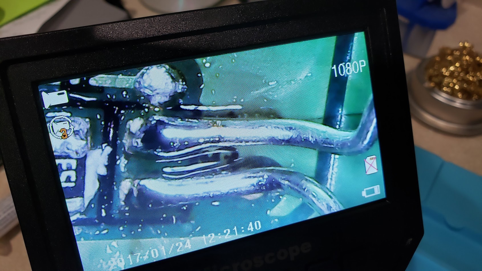

      I didn't have an SMD resistor so i kludged a normal 1/4 watt trough hole instead then fixed it with hot snort.

            My dell works again!! Removed that broken smd resistor. Didn’t have 2,7k resistor so now there is 1.2k and 1.5k trough hole resistors in series.
            Used some hot glue to secure those resistors in place.

                  This was EXACTLY my problem. My 2.7k resistor was actually showing wandering resistance when measured - it kept changing!
                  I unsoldered it and tore the pad. I then traced the pcb traces and connected the resistor (only 2.2k) to the transistor and IC directly for better mechanical strength.
                  I tore off some of the excess heat sink tape between the power supply and chassis to add back in some thermal mass for those resistors to replace the removed glue.
                  So far, so good. I would have NEVER found that failed resistor. Thank you, everyone!
