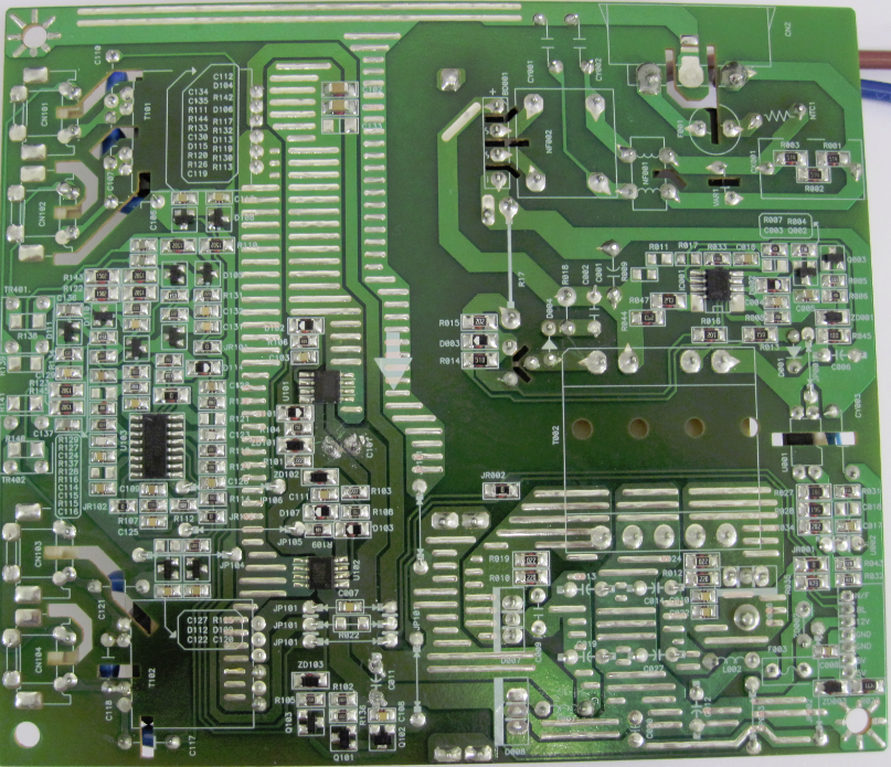

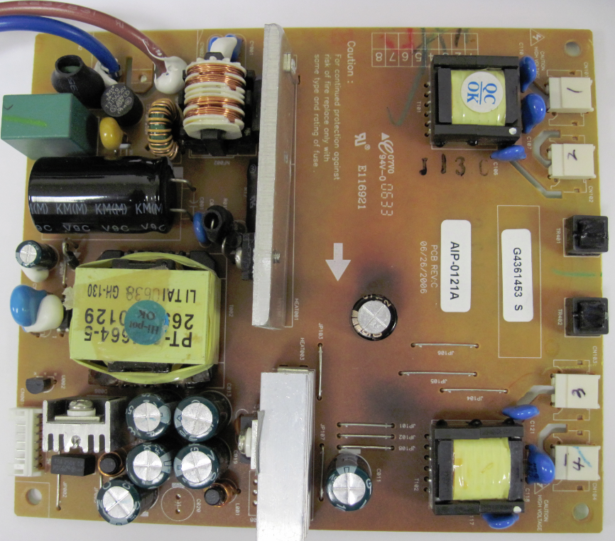

    Hello All,
    The LCD Monitor Sceptre x20wg-naga will go black after 1-2 sec. If I turn on
    the monitor the screen just stay for few seconds, and then goes away(black)
    but power is on. If I turn off and then turn on,the screen come back and goes black again for 1 to 2 sec.
    I checked board with power supply and inverter, and found the Capacitor C101(25v 150uf) is bad, I replaced that caps and tested that, but problem is not solved on this way.
    I have searched this forum and got so many good guidance how to fix this problem. But I am new to electronics repair and don't have experience for the repair. I hope I can get detailed help from this forum for this monitor.
    Thanks in advance.
    Because the uploading is failed, I try post links for pics of power board. Sorry
    for the inconvenience.

    Typical description of 'two seconds to black'. If you found one bad cap there is no reason to believe the other caps are good. They can (and do) fail with no visible signs.
    Did you use a good quality low ESR cap as a replacement? General purpose caps will not work properly; even after a complete recap using new general purpose caps a monitor can exhibit this problem.
    The two most common causes of 'two seconds to black' are bad caps (40%), bad (aged) CCFLs or a problem with the CCFL wiring (40%), bad transformer (15%), bad component in the protection circuitry (5%).
    If you have a good CCFL (or a non-working monitor with good CCFLs) you can substitute a test CCFL for each CCFL in turn and isolate the problem.

      Thanks PlainBill for the quick reply.
      I posted pics links on the post.
      I see some burned area on the board, this could be a problem?
      The transform looks bad? How to check that?

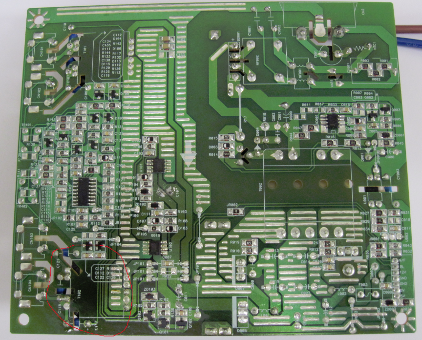

          Detailed burn area.
          On pic IMG_03121.jpg, the right one is burned compare to link one.

              I see nothing wrong with the burned area. And the weirdest thing is that on the other side there is allmost nothing.
              Transformers can be checked while not powered with an ohm-meter, they should all give allmost same readings on primary and secondary windings.
              Do you have an ESR meter and a DMM?

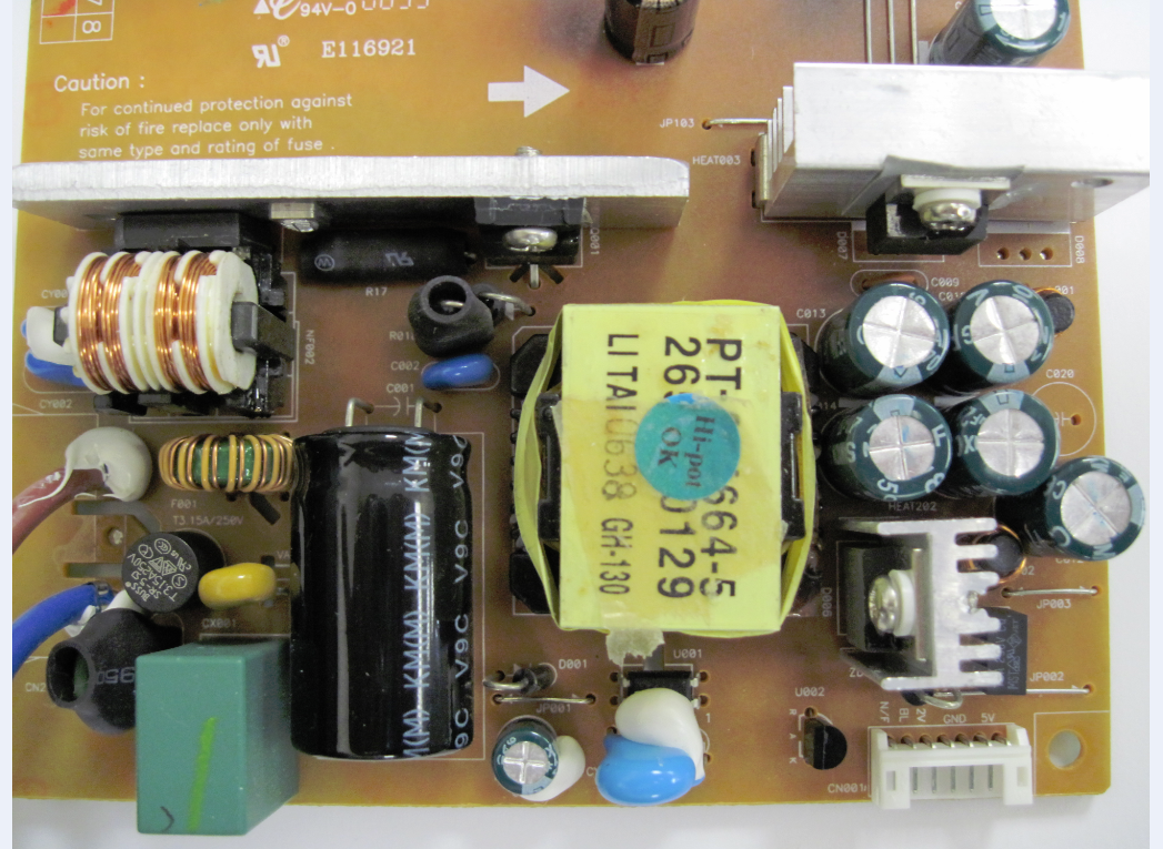

                      More Pics. Burned area.

                        I will get a DMM right now. How to check and find the problem? Could you mark that
                        on the pics? Thanks.

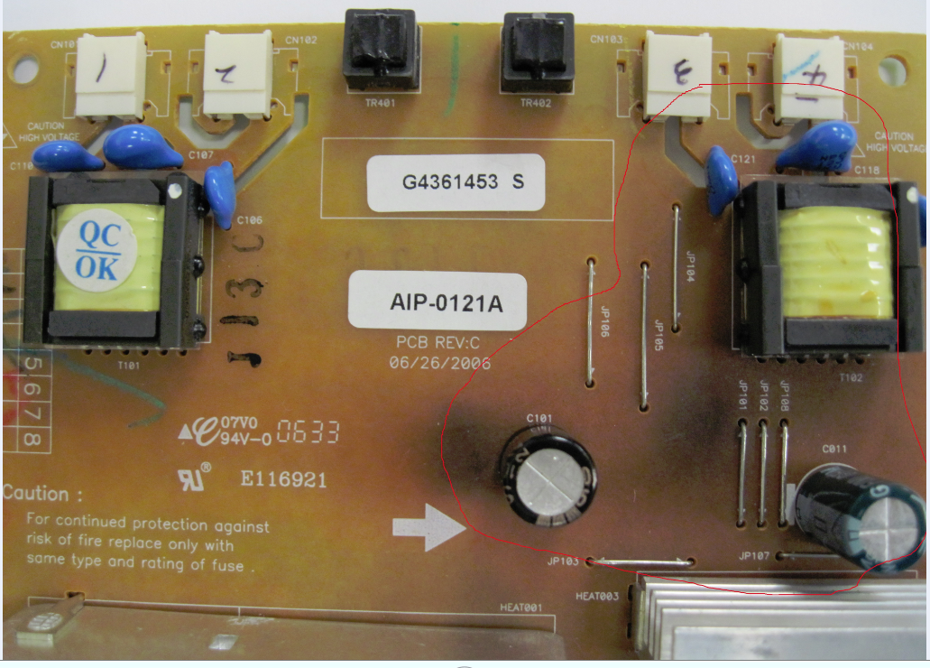

                          Hello ipman,PlainBill or anyone, could you help me to check transformer(like PlanBill ponted:bad transformer (15%)),I post one more pic here.
                          I am really appreciated your help. better draw/mark that on the pic.

                              Not that transformer......measure resistance(ohms), on the secondaries of the two inverter transformers ....

                                The ones near the CCFL connectors, one of them has "QC OK" on it. Secondary means the winding leading to connectors.

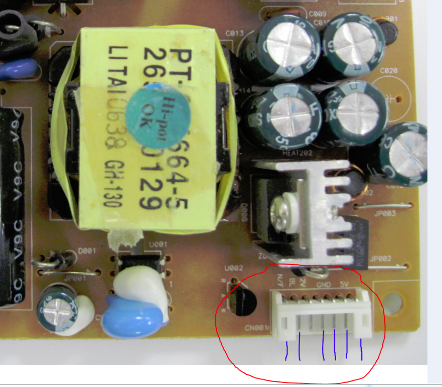

                                  Have you checked the voltages at the white connector CN001?
                                  If the voltages are bad there, it may prevent the inverter portion from firing up.
                                  I would check for the 5V and 12V in the first instance.

                                    I checked resistance for the two inverter transformers,that shows 621 and 626.
                                    I guess this is Ok(under 3%),right?

                                    Look CN001 on pic:
                                    N/F BL 12V GND 5V
                                    Is that right?

                                      For the CN001, I checked 5v, got 4.96, no 12v connection(see pic,just 6 connections,blue line).
