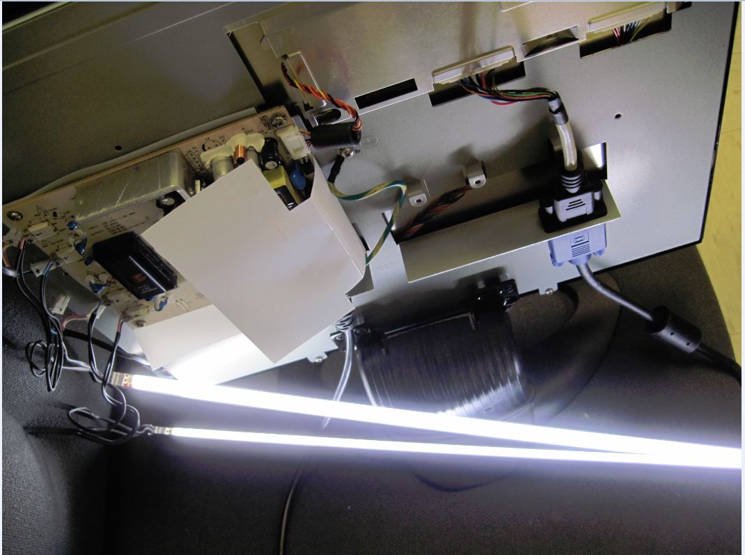

LCD Monitor Sceptre x20wg-naga will go black after 1 sec.
  • ukagwx
    • Jul 2011
    • 15
    Re: LCD Monitor Sceptre x20wg-naga will go black after 1 sec.
    I don't understand your question. Buy CN001? This is just a connector.
    • ukagwx
      • Jul 2011
      • 15
      Final update: I found the problem 2 CCFLs are bad. I replaced CCFLs and the monitor is working.
      Thanks to anyone here helped me.
      • ukagwx
        • Jul 2011
        • 15
        Testing CCFLs using another LCD monitor.
