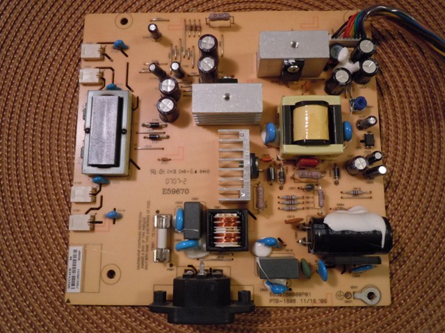

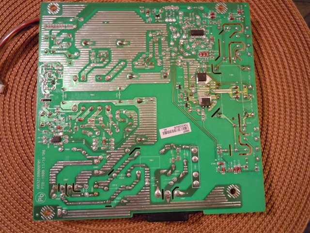

    I am new to the forums and a beginner to electronics repair. I have a Compaq WF1907 19" LCD Monitor I picked up already broken. I opened it up and saw no visibly bad caps. I have replaced a few caps already but to no avail. I have the rest on order and should be here in the next few days. I am starting to think though from what I have been reading that it isn't so much the caps but maybe a transistor, transformer or maybe a CCFL. I am here to get some opinions on the matter from you guys. The power supply is marked as follows:
    E59670
    PTB-1808
    6832180800P01
    I have add a 2 pics of the board for visual reference.

    Sorry forgot to mention in the main body of the post that when it turns on there is an image for abotu 2-3 seconds then black while the green indicator light remains on. I also noticed that the top CCFL seems to be a bit dim.

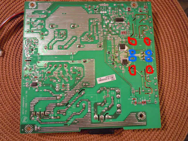

      Re: Compaq WF1907 Turns On Then Off After Few Seconds
      The problem is called 'Two seconds to black'. The dim CCFL is an important clue. Inverters have protection circuitry which will shut down the inverter if the current through any CFL is too high, or if the voltage across any CCFL is too high (current too low).
      One common failure is a bad solder joint at the CCFL, another is an aged CCFL.
      Do you have any spare CCFLs available, or a 'test' monitor you can use for testing?
      Another possible cause is shorted turns in the inverter transformer. Compare the resistance between the two terminals at each end. They should match to within 3%.
      PlainBill
          Where you have marked the trans in red ,
          measure resistance between the top 2 pins then do the same on the bottom
          2 pins and compare readings .
          I would expect readings of 650 ohms and above and they should be within 3% of each other .
          • Craigt4113
            • Jul 2011
            • 10
            thank you sabre, I got 582 on the lower 2 in the pic and 581 on the top 2, so that doesn't see to be the problem

                Good news on the transformer.
                The best approach at this point would be to hook the 'test' LCD panel to this power supply and see if the CCFLs stay on. If they do, that eliminates the inverter. After that, one at a time replace the test CCFLs with a CCFL from this panel. If you get 'two seconds to black' only when one of the top CCFLs from this panel is connected, you have identified the problem - it's either the wiring to the CCFL or the CCFL itself.
                There are two leads going to each CCFL - Drive (the wire with thicker insulation) and return. Common problems include arcing through a hole in the insulation of the drive lead, arcing through the end support at the drive end of the CCFL, a failed solder joint at either end of the CCFL, and a frayed wire at either end.

                    Ok so here is what I have found out so far, In the lower CCFL unit there is 1 dead unit and the top CCFL package both units are a pinkish color. I was unable to test the CCFL's in another rig cause I forgot I had shipped that one out already. So if one bulb is completely dead would that effect the rest? Any ideas where to go from here?
                    • PlainBill
                      • Feb 2009
                      • 7034
                      A total relamp may be required.
                      The protection circuits are detecting the open (dead) CCFL and shutting down the inverter. The pinkish color indicates the CCFLs are near their end of life.
                        Thanks bill, I forgot I had a another LCD in the spare bedroom and I cracked that one open. I hooked up the CCFL's and same thing pink on 2 dead 1 and ok 1. So you are right I would have to do a total re-lamp and since I can not find these lamps I am going to part out the power supply and video board and e-bay it =). Thank you all who helped me on this I appreciate it very much and have learned alot.

                            The spots in red are for testing the transformer secondaries.
                            The ccfl's are in the lcd panel, you have to take it apart to actually inspect / remove them.
