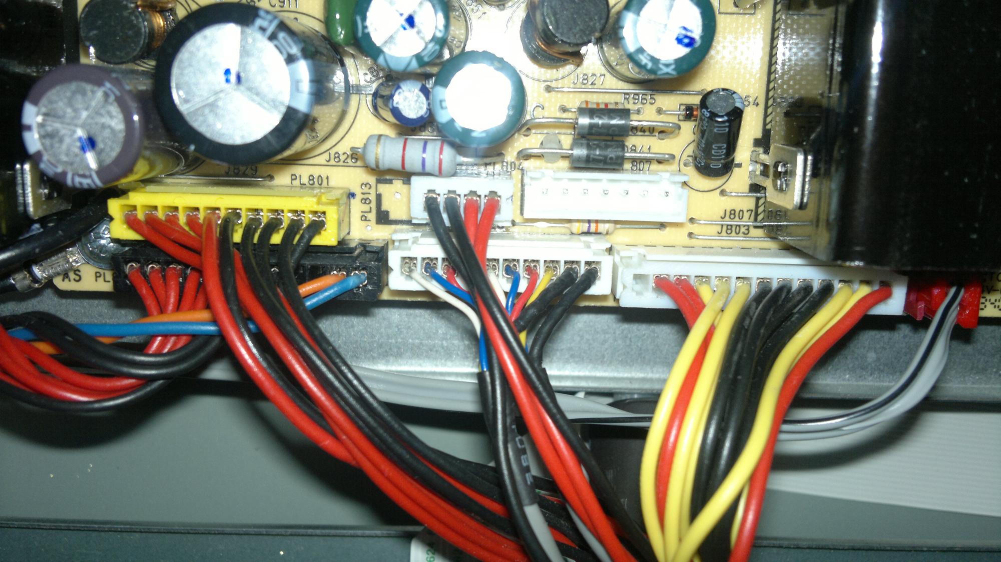

    We have the same boards but somewhat different connections. Can you post a close up pic of your PSU socket area (with plugs connected) and I'll be more able to make a comparison - I can get a better idea when I can compare positions of wires of a particular colour. Cheers
    System: HP xw6600 Workstation, 650W PSU | 2x Intel Xeon Quad E5440 @2.83GHz | 8x 1GB FB-DDR2 @ 667MHz | Kingston/Intel X25-M 160GB SSD | 2x 1TB Spinpoint F3, RAID0 | 1x 1TB Spinpoint F3, backup | ATI FireGL V7700 512MB | Sony Optiarc DVD +/-RW | Win 7 Ultimate x64 | 2x Dell UltraSharp U2410f | Dell E248WFP
    • dumpystig
      • Jul 2011
      • 485
      #82
      Re: 32" Goodmans TV
      Here's mine
        #83
        Re: 32" Goodmans TV
        See attached

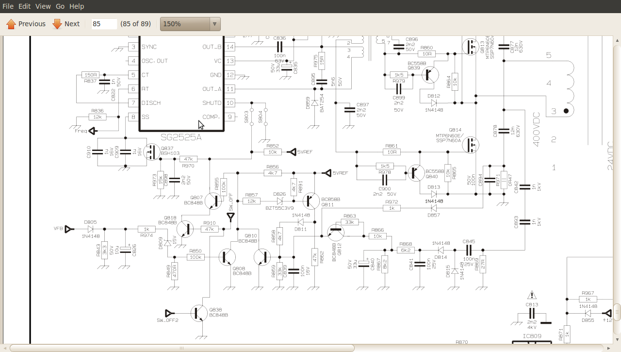

                              Okay, I reversed my fix to the TV with pin #8. Now the LED doesn't blink, but we're back to the original issue: it just won't turn on. I had a little difficulty with the circuit, I broke a resistor off the board (R970), but I looked the schematic and it looks redundant to me, so I bridged it. I might replace it later and see if it matters, but I don't think it will.
                              One pin to look at is SHUTD, as it appears to turn the power supply off. I suspect it must be low to do so. The resistor R970 then might be necessary as it stops the PSU from being held in shutdown while the cap C898 charges. But if we stop the PSU shutting down by removing the transistor which is pulling it down, we might never be able to turn the TV off properly... Ugh! A new PSU is a simple answer, if the main board is good.
                              Now, we have to debug the slow start circuit and find out why it stops the TV starting properly. Perhaps some protection is activating; if so, why?
                              I'm most interested in the transistor Q818 as that seems to handle switching the TV on and off, although the switching on and off is also handled by other parts, so it's like everything has to activate in sequence, maybe this was the problem?
                              There's a lot of protection in this circuit. VFB and Q808 seems to be overvoltage for the 12V rail, tripping on 15V or so. Not bad at all, a good idea in fact. If the caps are aged, the rail might be peaking. So I could look at inhibiting this. Also interesting is the stuff around 5VREF; maybe an undervoltage cut-out?
                              Problem is, this stuff is all primary side. So I can't probe it with a scope as I risk damaging it. Unless I broke the ground pin off the plug but that is very much frowned upon (and rightly so) as it leaves the chassis of the scope LIVE, and dangerous. I'm limited to a 3 Hz multimeter.
                              I've attached a screenshot of the part of the circuit we are interested in.

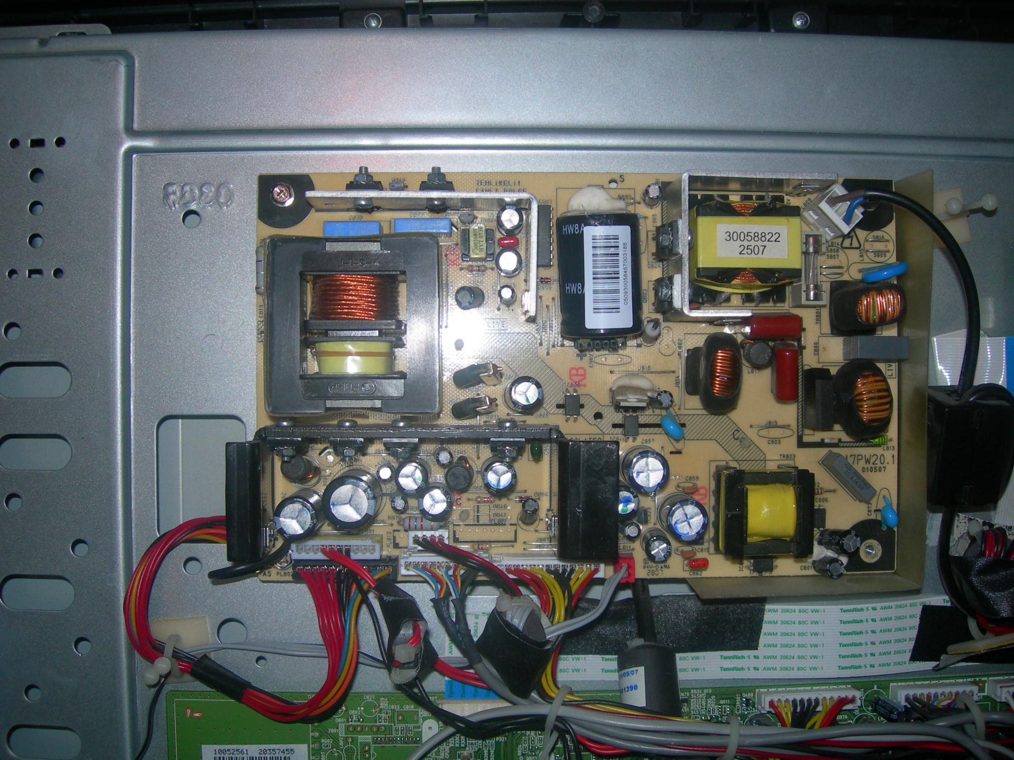

                                I was a doofus, I bought a power supply for this TV, didn't read the description - sold as faulty!
                                Thought it was too good to be true for £10.
                                Although I will still try to get it working - maybe the fault is similar or easier to fix than this one.

                                    Ah, got my broken PSU today.
                                    Interesting. The transformer for the PFC has been broken right off the board and is quite loose.
                                    The fuse is also blown.
                                    Apart from this though, it seems okay.
                                    Was thinking of removing the PFC fet, and the PFC transformer. Replace the main winding of the transformer with a piece of wire. It wouldn't have PFC any more, but it should work just like mine did, on 328V.
                                    I'll give it a go, haven't got much to lose.
