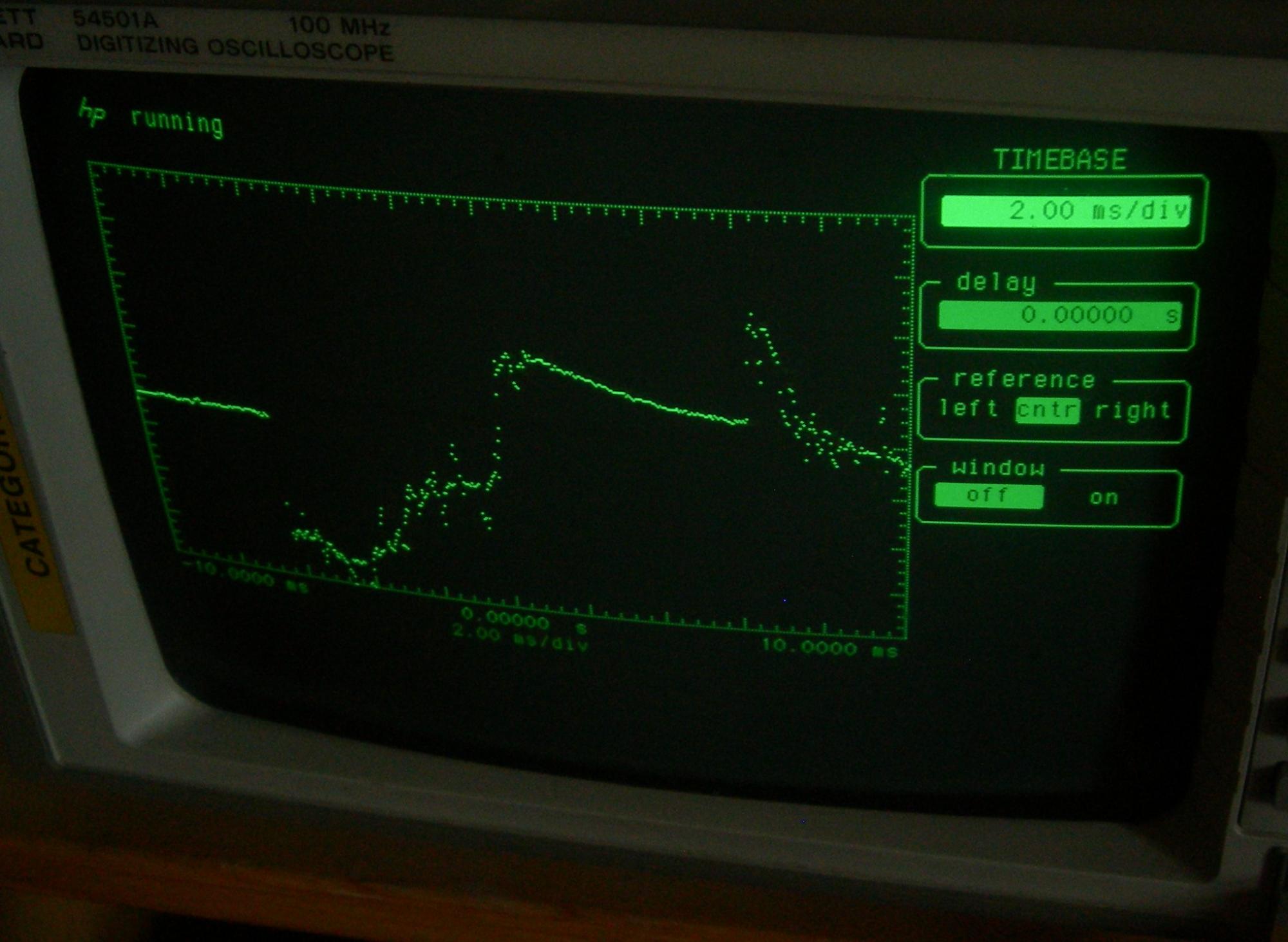

            Re: 32" Goodmans TV
            This is bizarre.
            I was scoping the 8V line and I notice it runs at 8.18V idle but every so often spikes to 8.25V. Perhaps that is caused by it cycling power: it's trying to start up, but failing.
            The 1.8V supply measures at 1.887V and the 3.3V supply at 3.324V... both seem perfectly in spec.
            I've ordered some replacement standby caps. I'll only replace the caps powering the inverter board if I have to.

                                  This is odd, because I would expect pin #5 to be the signal from the mainboard to turn on the TV, but there is no significant signal on it.
                                  But, when scoping it... I think it has a clue. While it is trying to turn on it goes crazy! It changes between several waveforms - at one point 2.5Vp-p - but eventually goes almost completely dead. Sometimes these waveforms show up when the set is switching on and sometimes not. And sometimes pressing the power button on the remote makes this pin go high for maybe half a second, then go low. Something is stopping it fully starting.
                                  I've ordered some caps, but it seems less and less likely to be a cap issue now.
