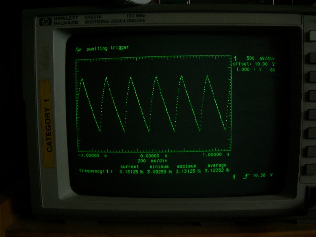

    Hmmm...
    It's tempting to buy a new main board.
    I can get one for £20.
    I will first try to find the actual fault with this board.
    I don't think the inverter is faulty; see previous post. Disconnecting it shows similar problems.
    Although, the 24V line to the inverter, while LED is flashing, is at 9.5V - 10.5V, changing slowly between values... very odd...

        Re: 32" Goodmans TV
        Originally posted by dumpystig
        There's plenty about these bloody boards thats odd...
        Gona do some more testing, back soon
        Thanks for your help.
        The 24V line looks rather odd indeed... see scope trace
        Bouncing from 8.5V to 11V at... guess what frequency.
        [If you guessed 3 Hz, you'd be right.]
        Everything in this PSU is sync'd to this 3 Hz signal! Where is it coming from? The only thing I can think of is the STBY_ON_OFF line... and the only place that comes from is the VCTP.
        To test the display I plugged it into my Xbox 360 (got it off someone for cheap because of a broken disc tray, was easy to repair.) It was working perfectly, albeit making that rather annoying buzzing sound. Then I turned it off. I turned it on again, and briefly (half a second) there was an image (from Xbox) but then it switched off, and the LED started blinking... and it's been doing that even since.
        I'm thinking software issues because I did turn it off by the plug. If it was writing to that eeprom at the time then who knows? It could be corrupted. I was using component video inputs, but I don't think that would matter.

                                          #80
                                          Re: 32" Goodmans TV
                                          Yeah, it's not meant to power on until either RC or side buttons are used... odd. How about we both post a list of all V's we have @ PSU PL connectors - both STBY and RUN if possible?
                                          Can't get it to go into run mode, but here's STBY voltages measured relative to case
