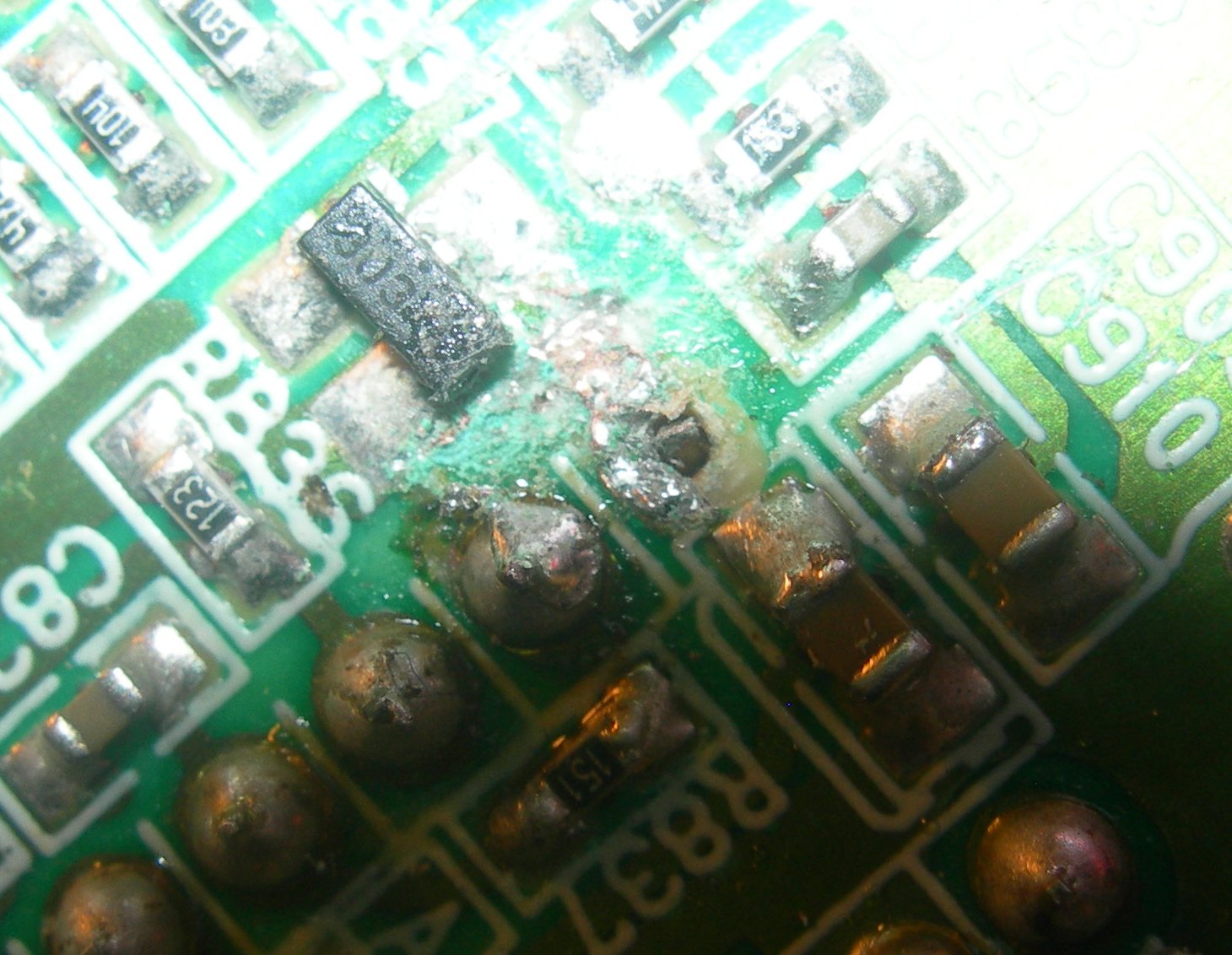

                                Well, I've found that the TV is signalling a fault condition by pulling down the PROTECTION_DETECT pin. But this could be because the PSU is shutting down...
                                  #36
                                  Re: 32" Goodmans TV
                                  So:
                                  Pin #6 is on/off for PSU. Off is 1.8V, on is <0.4V. It's at 0.02V when switched on and 1.8V when off, so that seems good.
                                  Pin #5 is an error flag from the signal board. It's supposed to be high when there is no error. But it's often low. Only when the set is working is it high (2.5V.) The pin is low if the rails are out of spec (too low.) However, the rails will always be out of spec if the supply is too low because it's not starting...
                                  The voltage across the PFC cap is always ~330V while in standby or while trying to start (not yet had an opportunity to measure it during operation.) So something with the PFC circuit is not working. However, 330V should still be enough for it to work. I don't care that much about the PFC to fix it unless it's crucial.
                                  So why isn't it starting... could be the fet Q837?

                                    Re: 32" Goodmans TV
                                    Hmmm
                                    Pin 8 (of SG2525A) is looking like it might be the problem
                                    So it's making my meter go crazy on the DC range, reading random values from -9V to +10V. On the (True RMS) AC range it reads 46V AC.
                                    This pin definitely shouldn't have these kinds of voltages on it, but how are they getting there?
                                    EDIT:
                                    Okay, so this time I did it with the meter grounded to a heatsink (the FET heatsink.)
                                    Now during start-up it measures 0V, it should be above 0.4V, preferably 0.7V. It is charged with an internal 50µA current source.

                                      Re: 32" Goodmans TV
                                      FIXED!
                                      Pin #8 was the problem... I broke the trace between Q837 and pin #8 of the SG2525A and it now starts up, turns off and does that all many times including between pulling the plug out, which it never did before. I'll leave it overnight to see if I can turn it on in the morning, but it's looking good .
                                      I still left the slow start caps connected to the pin because they provide the slow starting (the set takes 5 seconds to come on, approximately) whjch might be helping to reduce the load on the supply.
                                      I ordered some of the secondary side caps for it, but I don't think they will be necessary any more.
                                      Oddly, the PFC bus voltage is still only 328V - which means PFC isn't working. But I guess if it ain't broke don't fix it, it seems to still be happy with the ~330V.

                                        Re: 32" Goodmans TV
                                        Oh no, it just died after I wrote that post... I was a bit too quick.
                                        Hmm... possibly my track break wasn't good enough. Will look into it. It was definitely working better than before...
                                        EDIT: Yep, the pin is touching something. I will have to remove all the solder, as I twiddled with the pin and it started working. So it looks to definitely be this pin causing all the troubles.
