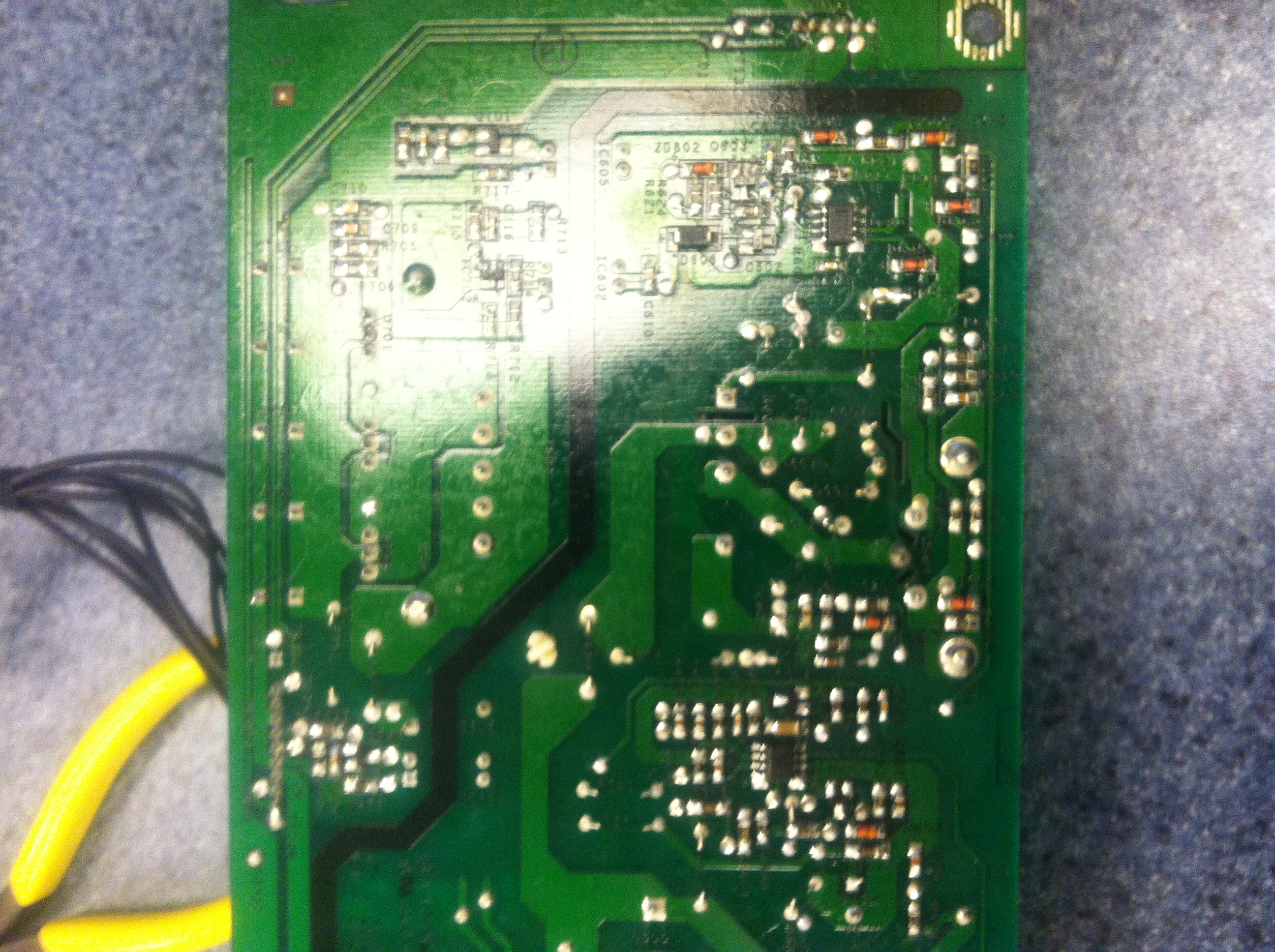

      So I'm trying to fix up a power board from a monitor at work.
      http://i.imgur.com/QIQWh.jpg
      http://i.imgur.com/J4RdP.jpg
      Replaced the large cap, seems the R670 is bad as well. Anyone else notice anything? I can probably grab the R670 at radioshack on my lunch. Gonna find my multimeter as well to check anything else if people have recommendations.

          Re: Dell 2407WFPb Monitor - Bad Cap
          Hopefully these are a lot better.
          And my skills are amateur really. I have a radioshack iron and a few things here and there (multimeter and such). Will eventually will invest on a better set of tools. Hoping this is one of the easier boards to repair but doesn't seem like good odds.

            • jetadm123
              • 2169
              #266
              Actually, from what I've seen the success rate for repairing this board has been poor. One of the successful repairs was back on post #258. You can check your parts against what elvena replaced.
              Also, it wouldn't hurt if you gave a description of the symptoms your monitor is having.

                #267
                Pictures are not a lot better - too grainy - more natural light is the key.
                Anyway - you still need to tell us the problem. What happens when you plug it in. What happens when you switch it on. What does the panel (Screen) do
                what does the power led do. Any noises ( Hiss squeeks etc)
                As you will have read we only know of one of these being fixed by conventional methods - others have modded with an external power supply.

                  #268
                  Natural light is unfortunately impossible today.
                  And no noises, I just connect AC and it does nothing. No lights, logo, pops, nothing. The power button makes a nice normal click.
                    #269
                    When the Source resistor is damaged, it means that the MOSFET has shorted out and it will take out the IC that drives the MOSFET also, you should replace them at the same time.

                      #270
                      Ok plugged in but not switched on what voltage across the Big Cap?
                      Meter on 600VDC red prob on positive leg of cap and black probe on negative leg.
                      Then do it again after you press the power switch. CARE High voltages do not touch any heatsinks or other parts.
                      If its been switched on switch off & leave 5 mins then
                      I cant see that you have checked the main fuse? or the Black round component next to it.
                      For both meter on ohms 200 and check resistance - post results

                        #271
                        00.6 on the fuse, 07.1 on round component.
                        My multimeter only goes up to 500VDC and it reads 158.
                        I am also reading through for the components required for the IC, MOSFET, and resistor. I see the resistor is a .22ohm as mentioned above.

                            #273
                            So what do you get when you check the MOSFET, is it shorted? Does the 0.22 Ohms resistor check open?

                              #274
                              I haven't checked the MOSFET but the .22ohm resistor has two cracks down the sides on the top so I'm pretty sure it's blown.
                              https://www.badcaps.net/forum/attach...3&d=1344971275
                              You can see the crack in this picture.
                                #275
                                OK, it would be safe to replace the IC's, MOSFET's, resistors, main filter cap components in the post 258. The surface mounted may not be damaged but look at them real close with magnifying glass.
