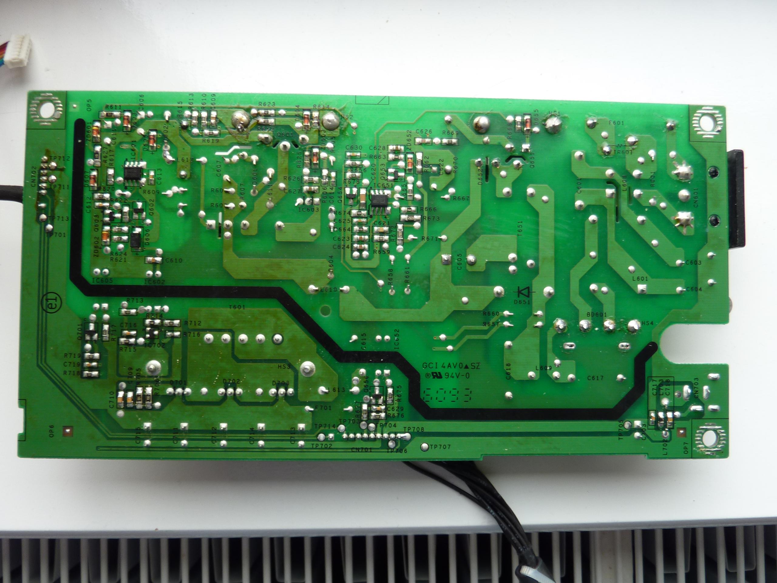

                            Here are some pictures of the power board, hope they help. The large green cap is fine, the marks are where it was glued the other way up on the power board I removed it from.

                                Re: Dell 2407WFPb Monitor - Bad Cap
                                The big cap is the correct way round, I have checked F701 and that's fine. I have had a good look at the board and I can not see any more fuses.
                                I have just uploaded some full size pictures to my website, if you want to have a look at them that would be great. www.linfotech.co.uk/psu1.jpg www.linfotech.co.uk/psu2.jpg
                                Terry

                                  #376
                                  Yes the small black fuse maybe is on the Main Board
                                  It was that I was wanting a picture of
                                  On the back of the psu the solder around one of the heatsink joilnts looks a bit odd touching the other trace? (maybe just the picture)- perhaps just try cleaning it up a bit.

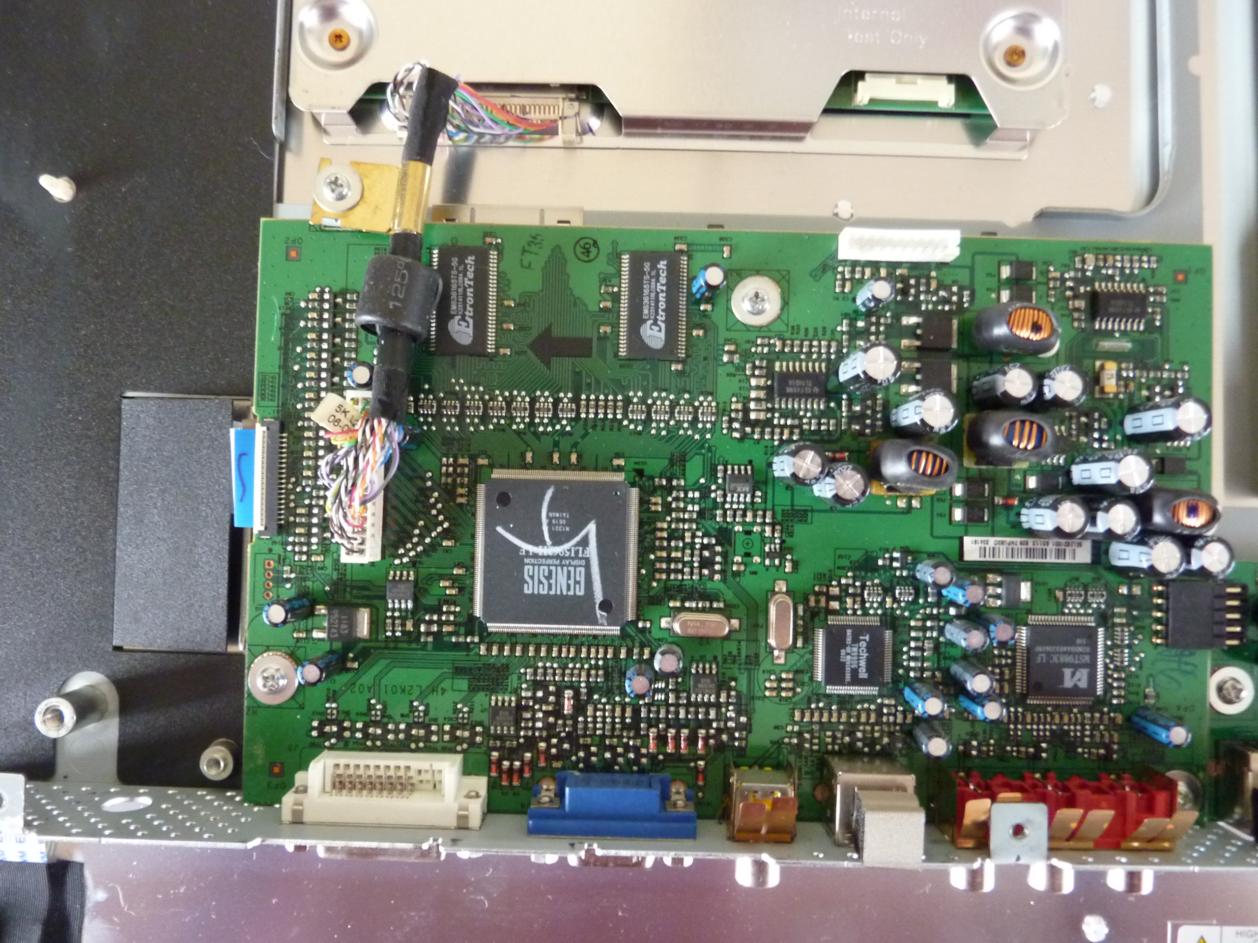

                                    Here is a picture of the video board the only fuse on it is the white 3A one. this is ok, I know to power board is the problem, if I use a bench test PSU then the monitor works great.

                                      • 7870
                                      #378
                                      Hmm- right - it must be on the board under the metal plate but if you say you can power it up externally then it must be ok SO- back to the psu.
