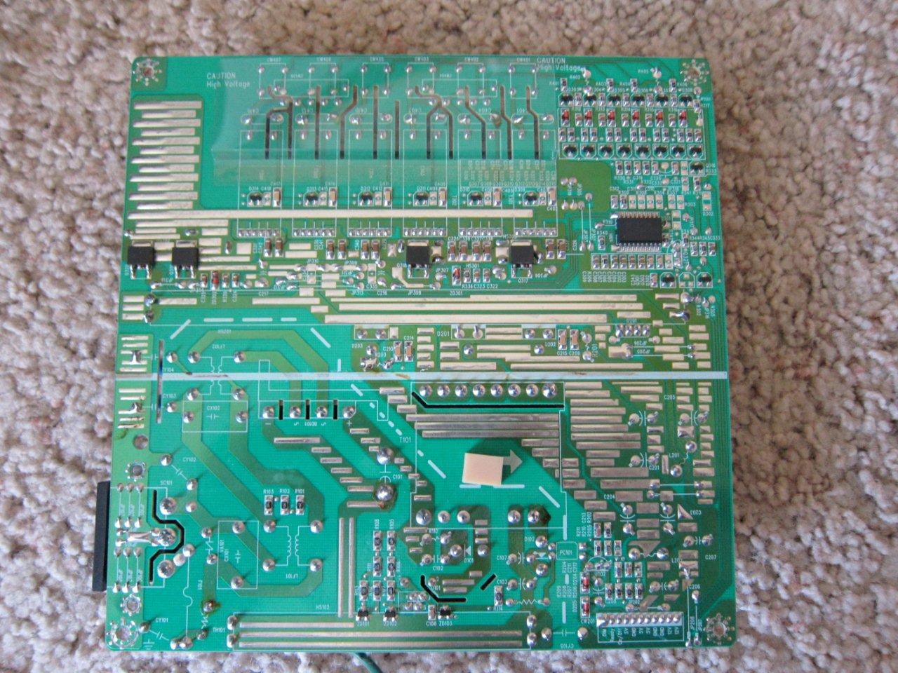

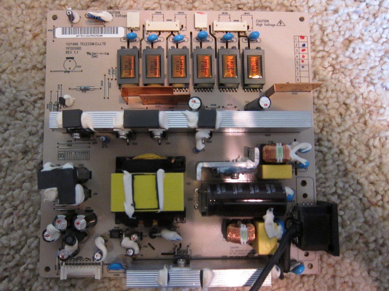

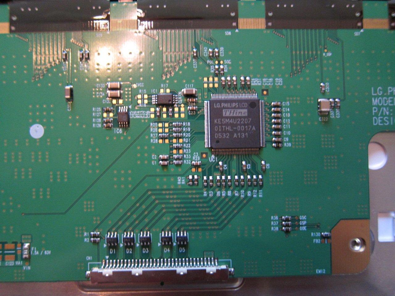

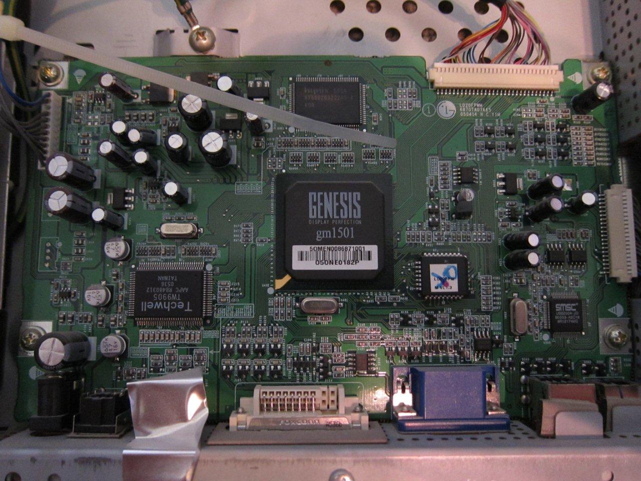

    My Dell 2005fpw recently started acting up with the following symptoms.
    -Occasionally goes black, buttons on the front stay green. Image will come back if you power down via the button and power back up again. This cycle will repeat about every 5 min.
    -Hissing type of noise
    -Kind of an ozone smell after dis-assembly.
    -None of the components look visibly damaged/distorted, but I
    This is my first venture into computer/monitor repair, I can follow directions very well and I have already ordered new Panasonic Capacitors for the Inverter Board from digikey. Should I recap the board first or are there other diagnostic tests I should run first?
    Pictures are attached

    Re: Dell 2005fpw
    Ozone. See
    https://www.badcaps.net/forum/showth...ighlight=ozone
    https://www.badcaps.net/forum/showpo...&postcount=169

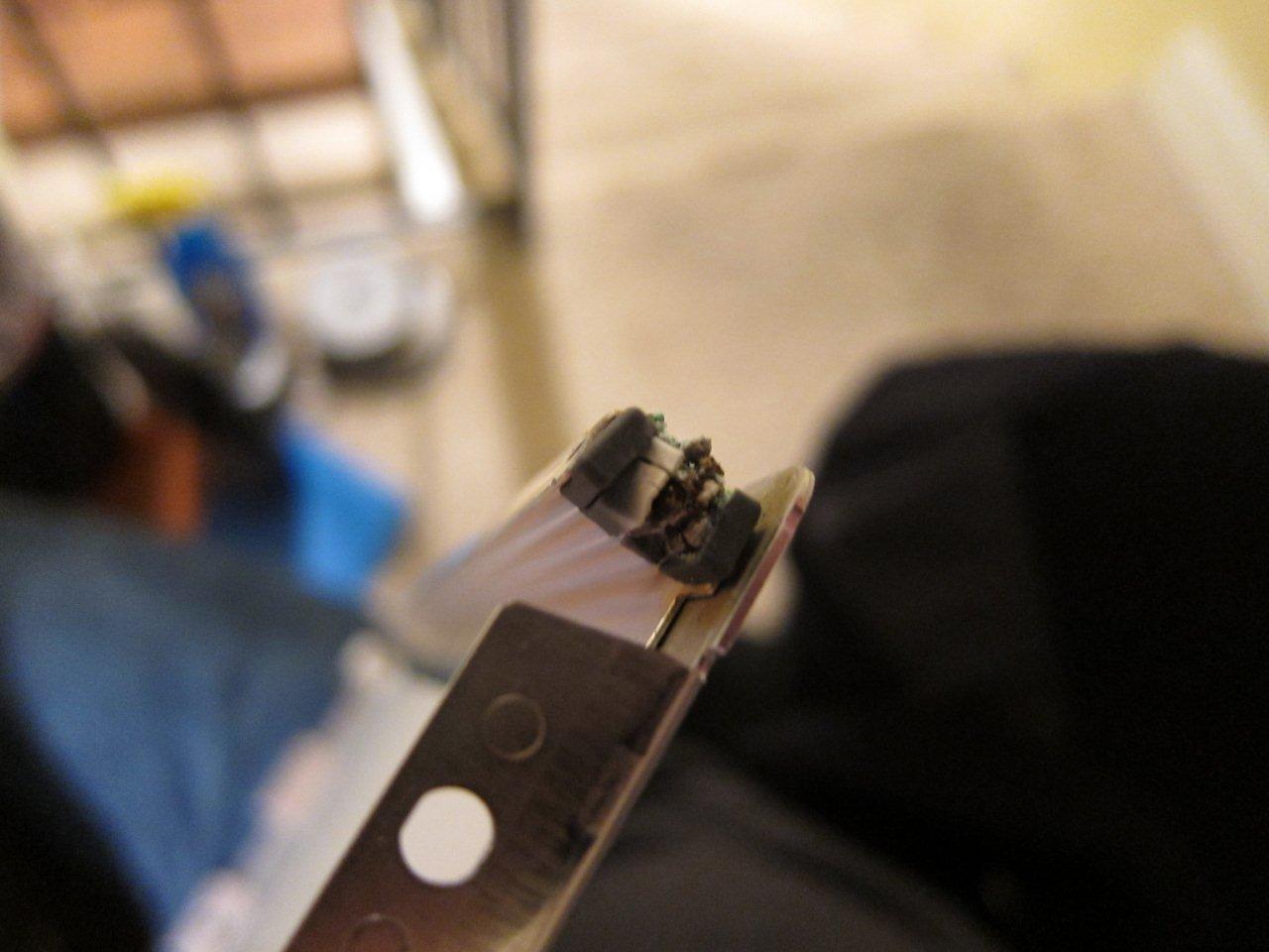

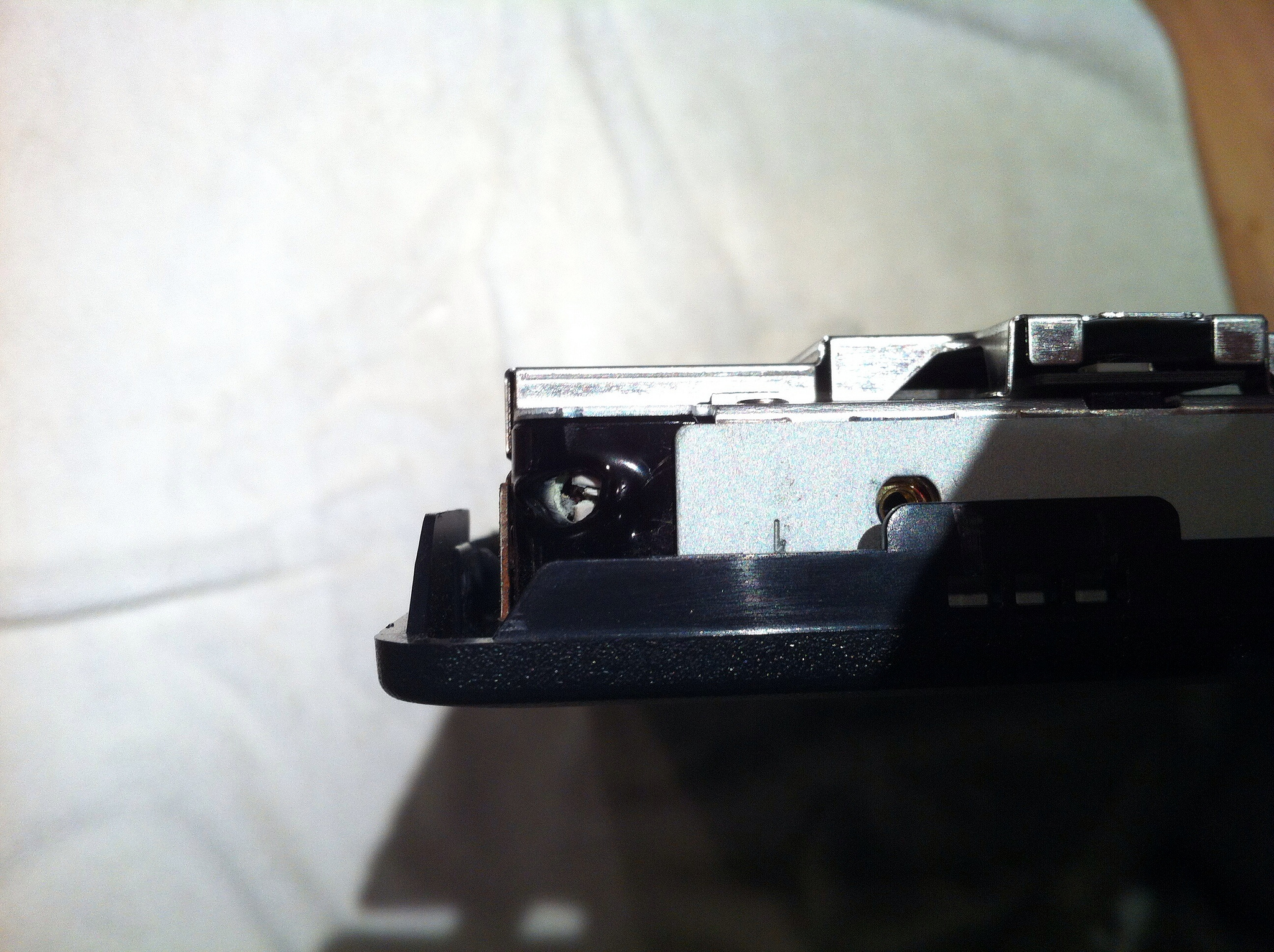

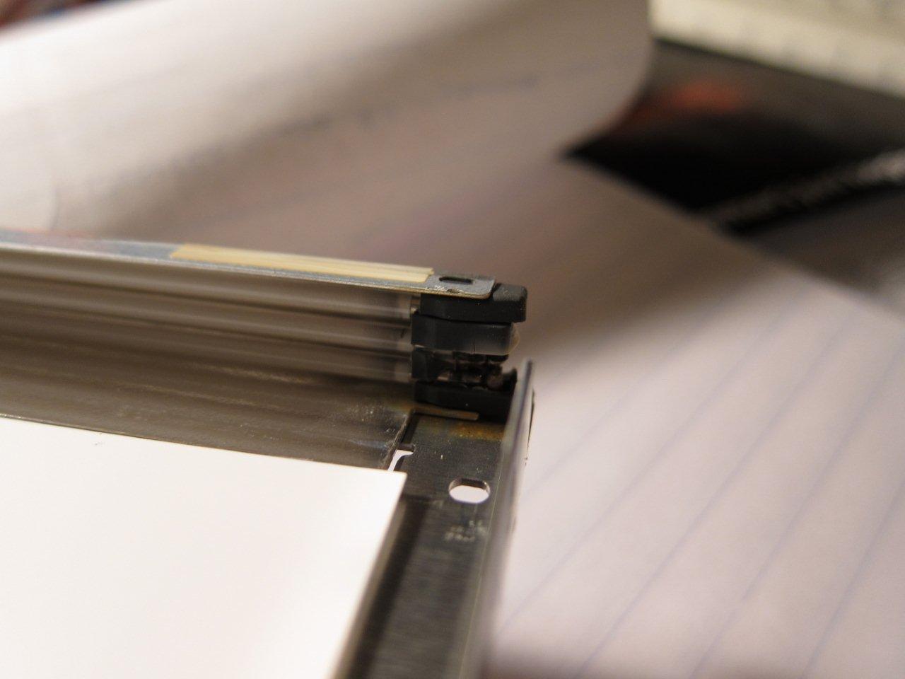

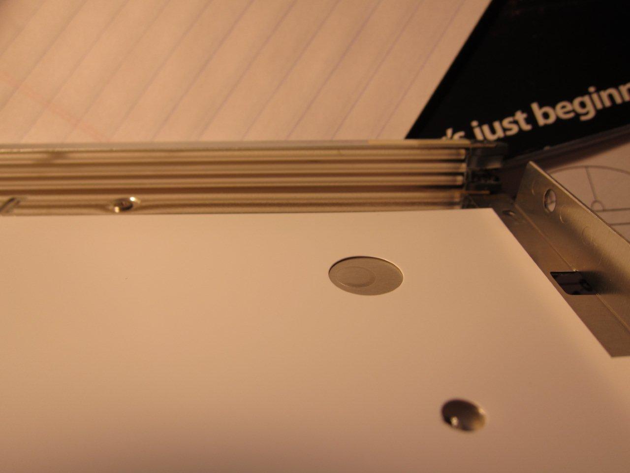

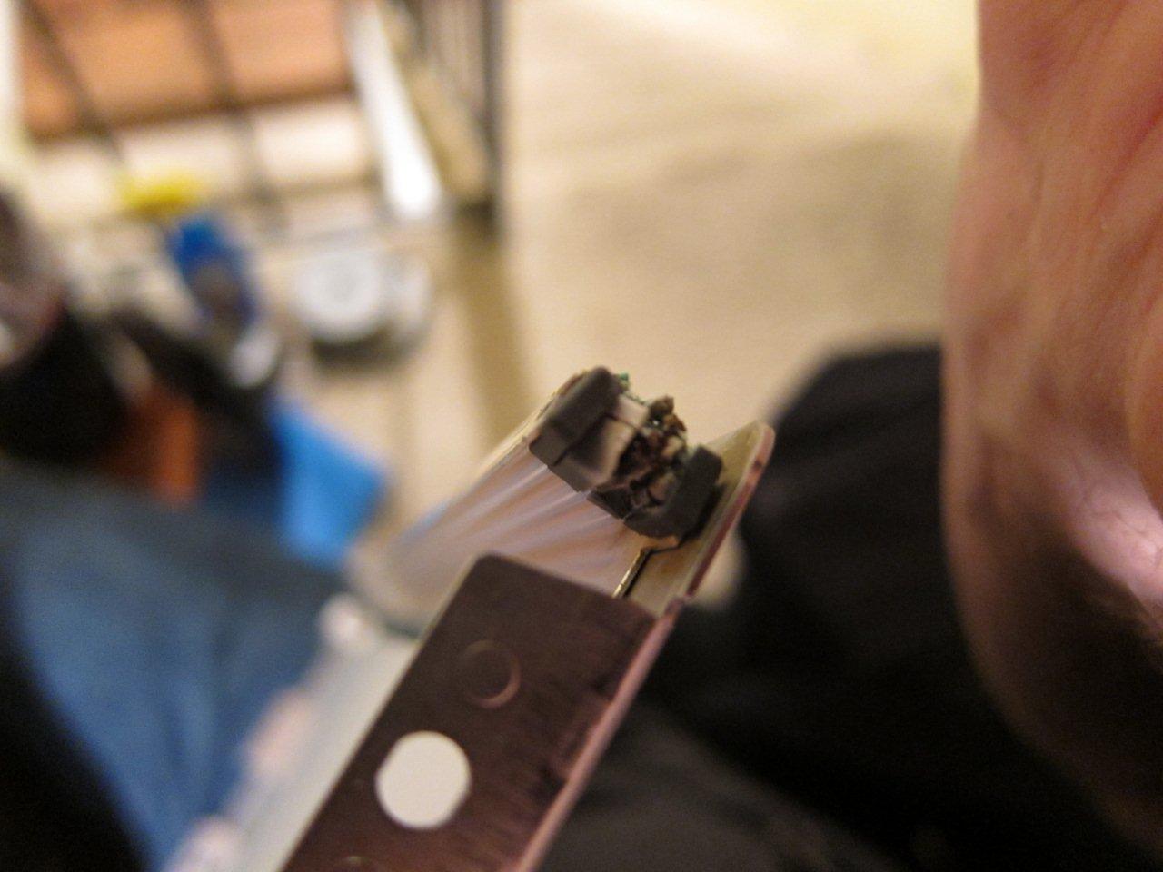

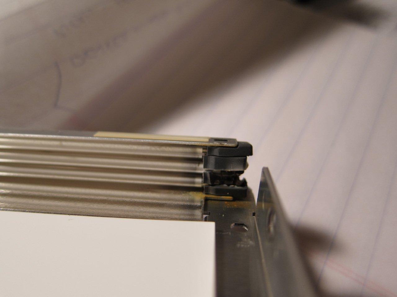

      Took the monitor apart a little further and finally found something wrong. Now I just need to source a new CCFL Assembly. Any vendors that you guys would suggest?
      Overall length of the tube + plastic end caps = 15.875" (15-7/8")
      Height/Depth Across the 3 tubes = 0.402"

        Re: Dell 2005fpw
        ccflwarehouse in the States, gets a lot of good feedback from members.Also while you are waiting,suggest you keep the Screen etc very well protected,from dust etc.

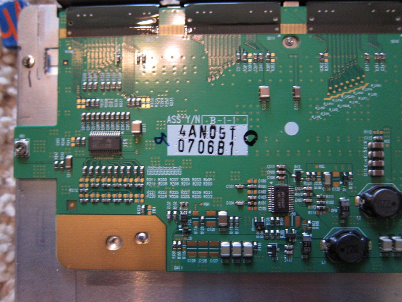

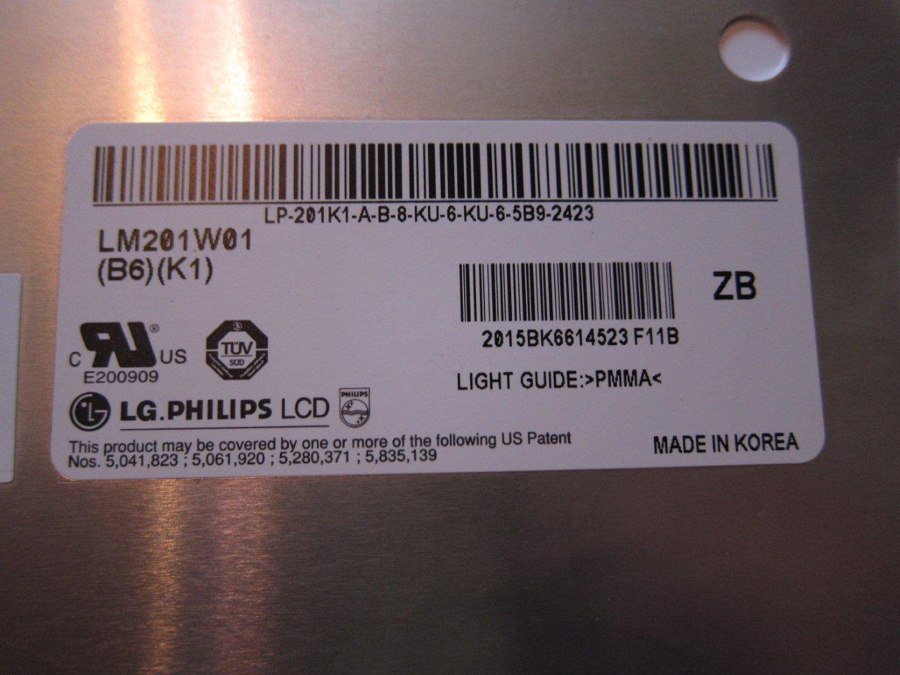

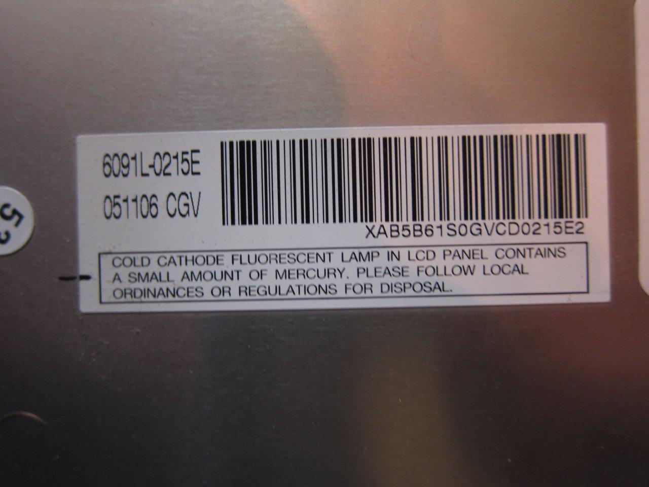

          Found product specs for the LCD screen.
          But this is quickly looking like it is no longer gonna be a cost effective repair. I would assume that since this lamp assembly went out, the other one is not far behind?
          6 tubes x $9.95 = $59.70 or about the same for two new lamp assemblies. Or get a new monitor for $100 more and it wont be 6 years old.

                    Re: Dell 2005fpw
                    That can be sign of bad wires on the lamps, or at the lamp's connectors. Do not run it like that since more damage can occur.

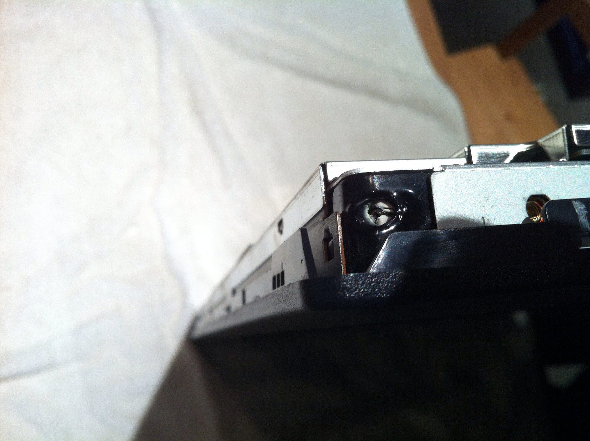

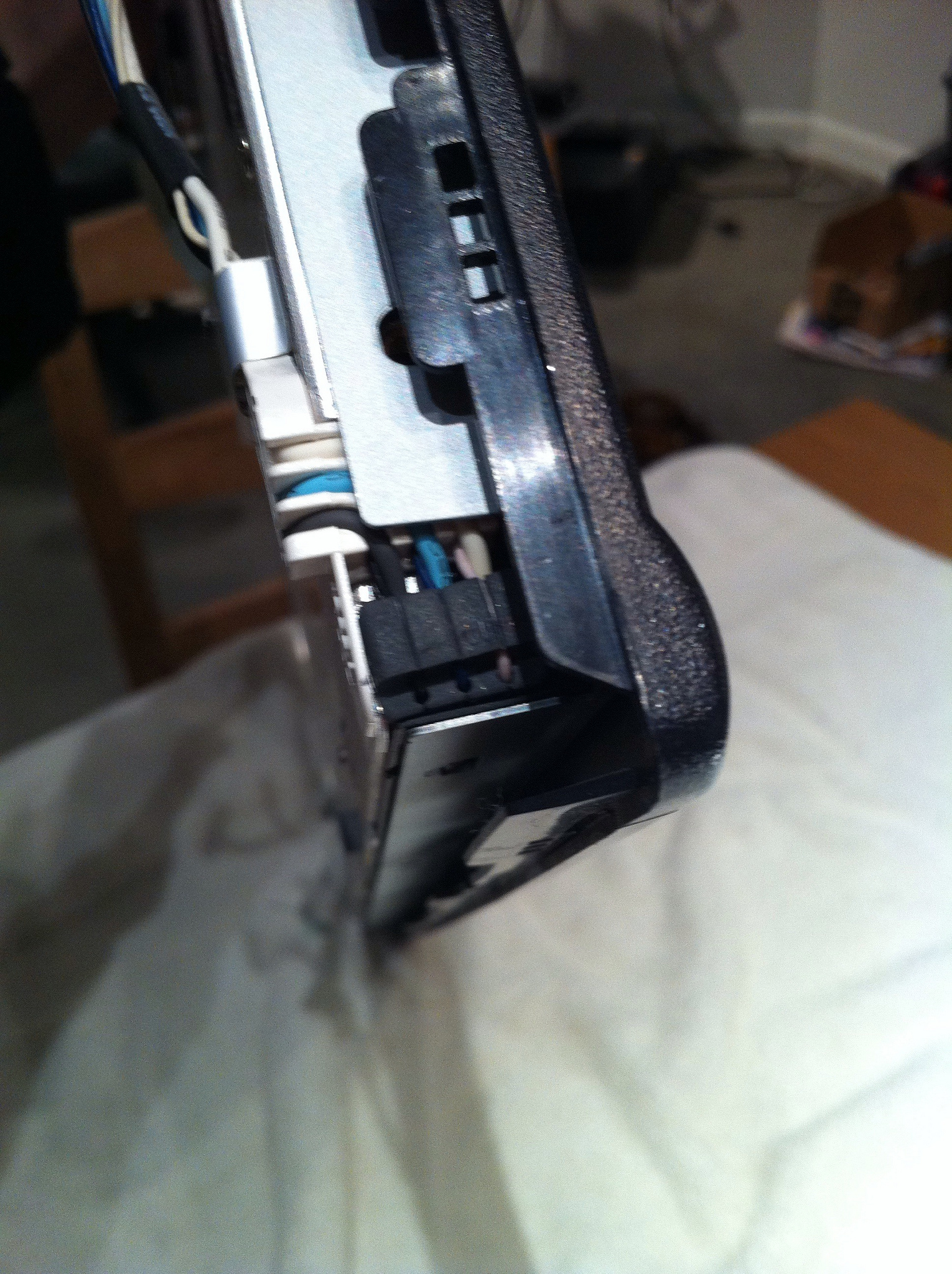

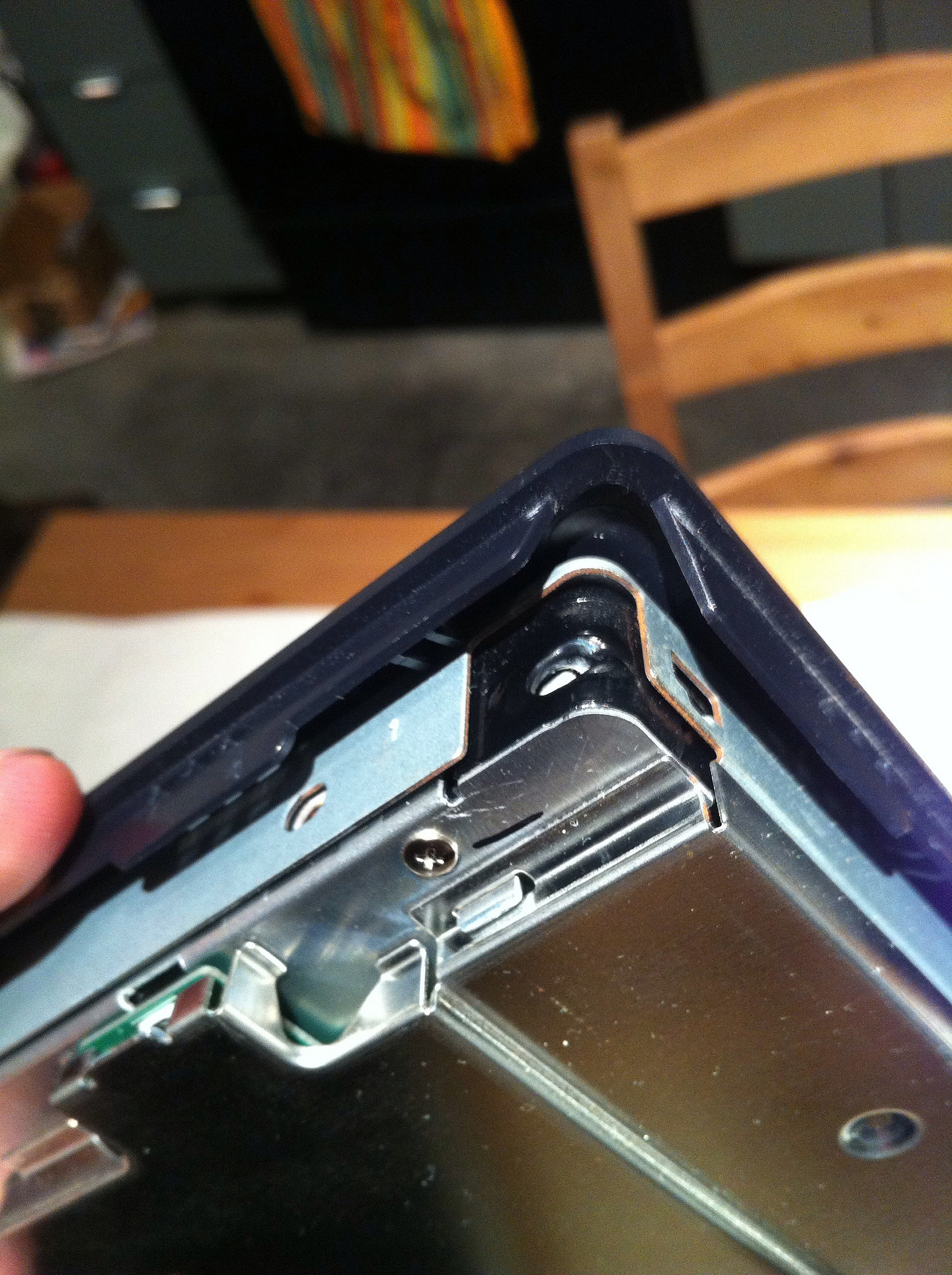

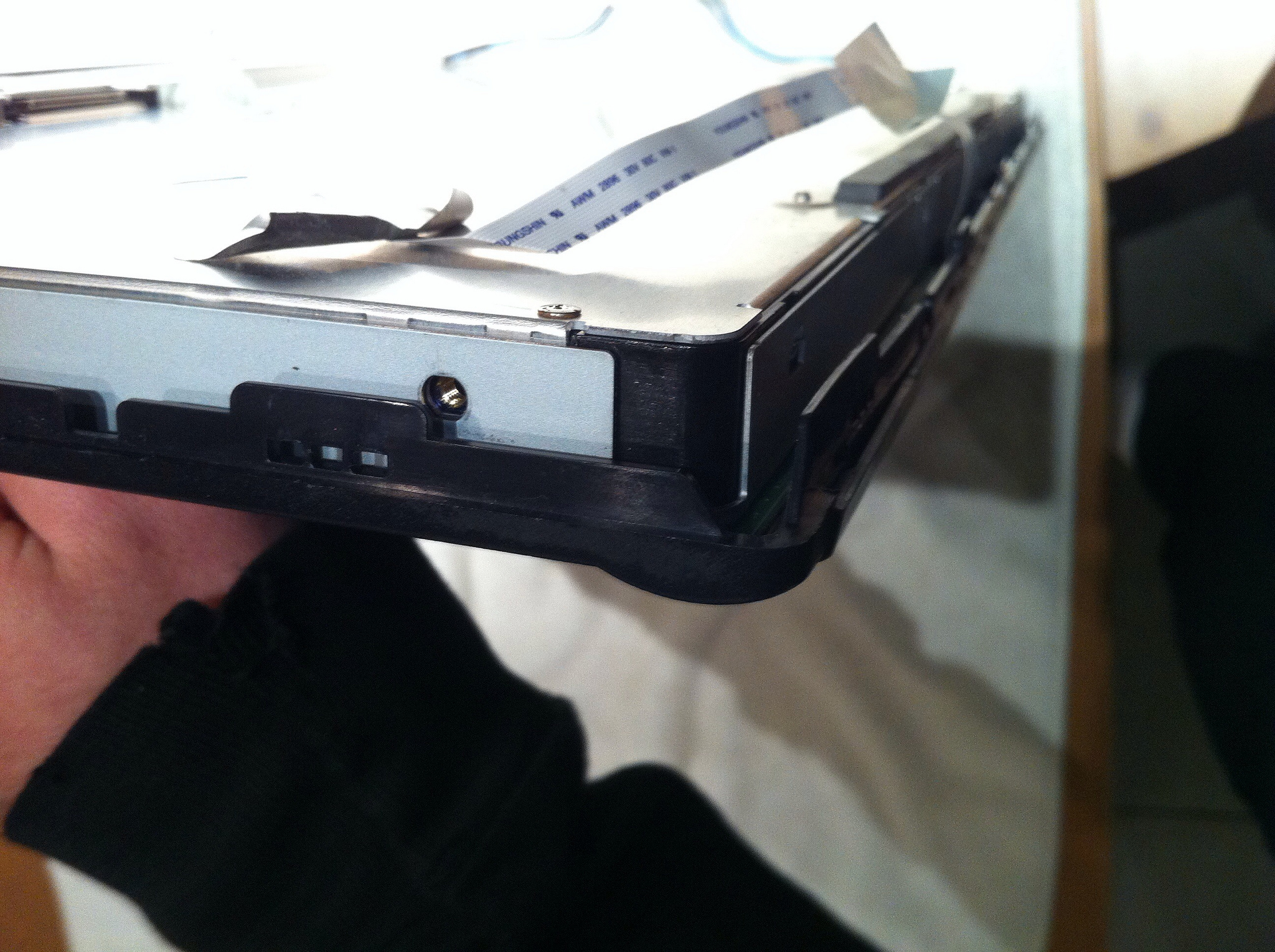

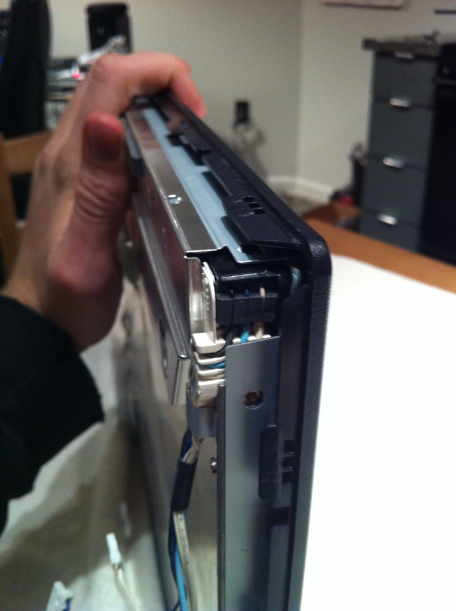

                        So I think I found out what was going on:
                        http://www.flickr.com/photos/bretc/s...th/8096103982/
                        I see rust around the burned out spot, indicating some kind of liquid damage? I dont remember spilling anything on it. Oh well.
                        It has been through the mail a few time, and lived around room mates. Who knows. The hissing sound was coming out of the opposite side of where the clear damage was.
                        Some of the images are for reference. I cant get any deeper into the innards untill I pick up some smaller screw drivers. I just moved and dont have a eyeglass driver set.
                        I might just recycle it though. Or craigslist it. Someone in portland will want it right?
