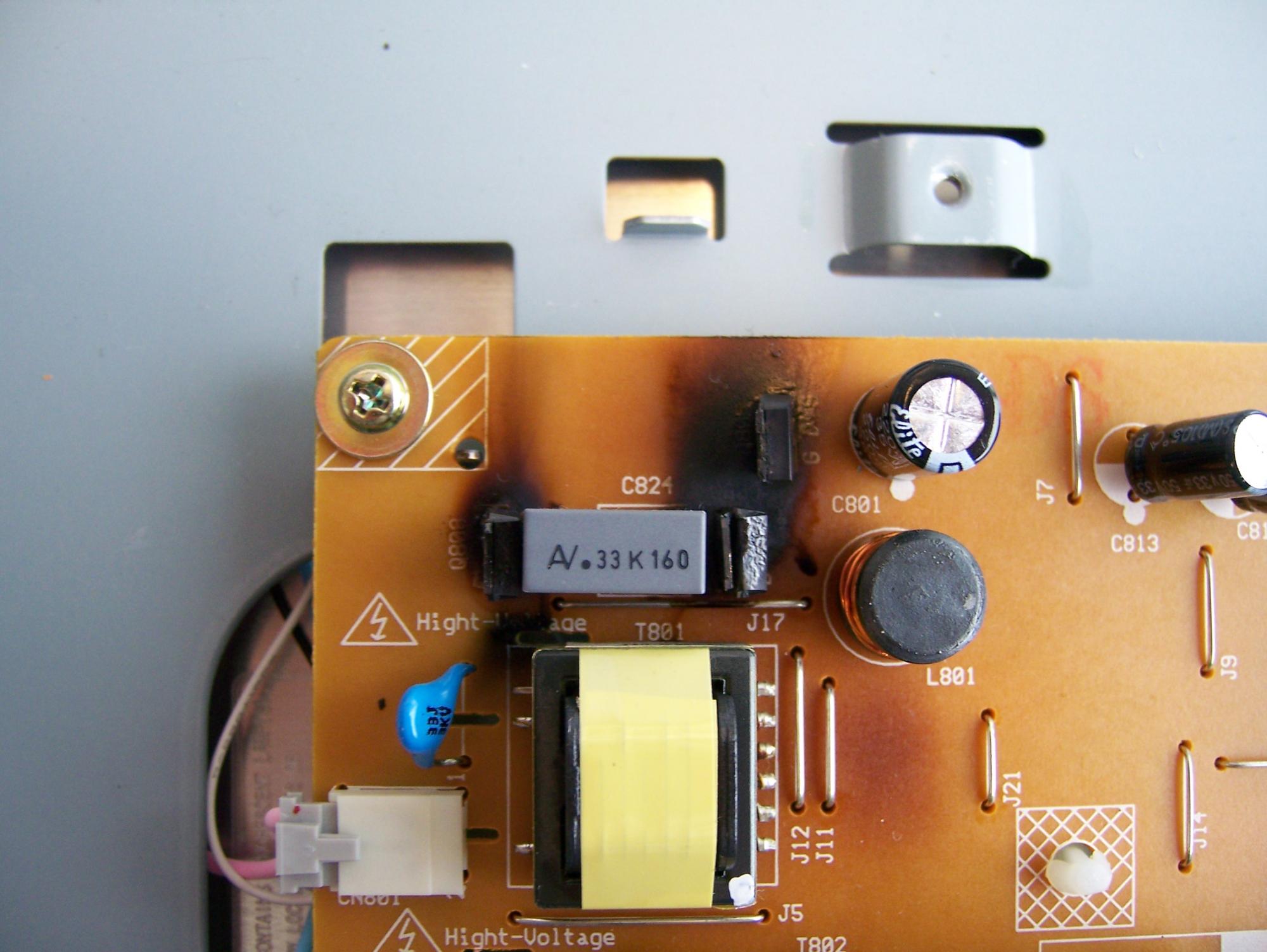

            Hey guys. I found what appear to be scorched transistors on the BenQ power supply board. (see attachments). Does anybody know how much these cost, and a good supplier? (preferably in Canada).

              Re: HP1940 backlight
              Good luck finding parts in Canada. I ordered mine off ebay.ca. Just search for c5707 kit. It should be around $4 to $6 and you will likely get
              4 - c5707s
              2 - fu9024s
              1 - 3A 125V picofuse
              edit: The damage looks pretty bad. It might be beyond repair, but the cost is relatively low and it is worth trying to save a 19 inch monitor?

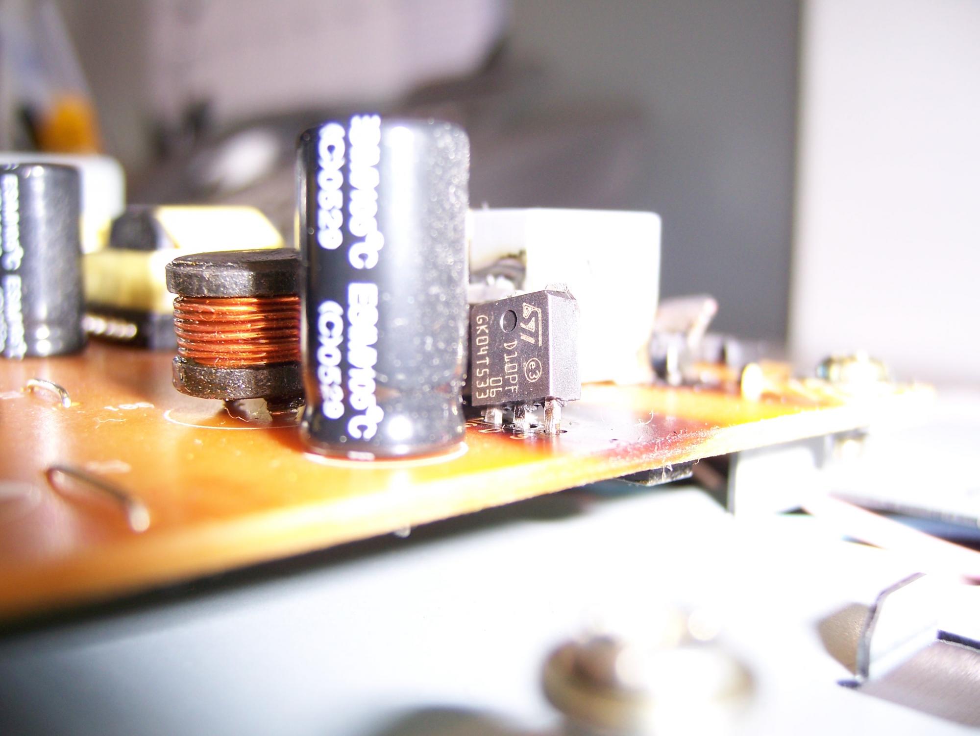

                  On closer inspection with a bright light the damaged components are:
                  C5707 (x2)
                  D10PF (attached)
                  I found this repair kit on eBay for $5:
                  http://cgi.ebay.com/ws/eBayISAPI.dll...m=220778537253
                  (USA is much better than waiting a month for it to come from China!)
                  The board in the ad doesn't look like mine. Also, they provide a FU9024N and a 3A fuse. Mine is 5A (see attached). Is it the right kit?
                  Can any of these components be damaged by a soldering iron? What are the test values for the transistors?

                    The FU9024N will work in place of the D10PF, I've done it, and lived to tell about it.
                    If you don't know how to test, or don't have the equipment, it might be just as easy to replace them all, they're cheap enough.
                    USA might be just as slow as China, lately shipments via Canada Post have been very slow, but it does vary, so you might get lucky.
                    The 5A fuse might explain the crispyness of the transistors. Hard to say what the original should have been, 5 seems high, but might be original. On the BenQ models I've done that have a similar circuit, it's always been a 3A.
                    You generally won't damage them with soldering heat during install, if you're any good at soldering. De-soldering them if you're not good, could damage, but they're already toasty anyway.

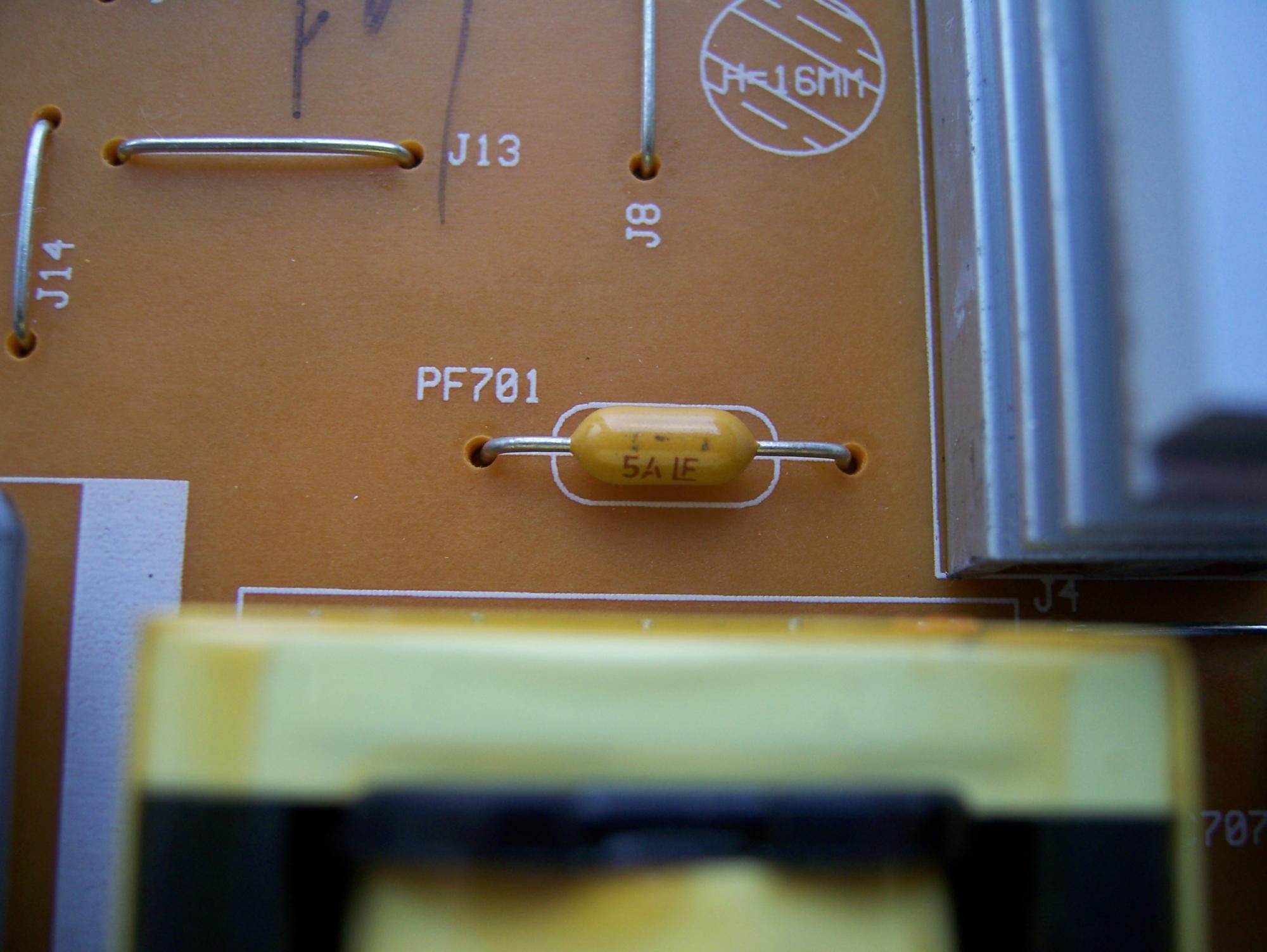

                      You can easily test to see if the existing fuse is good or not. A good fuse should measure less than 1.0 ohms.
                        This fuse definitely came with the monitor, so I hope it still works. I think model 1940 (part no. PF803) is uncommon. You usually see the L1940 (PF803AA) or L1940T (EM869AA).

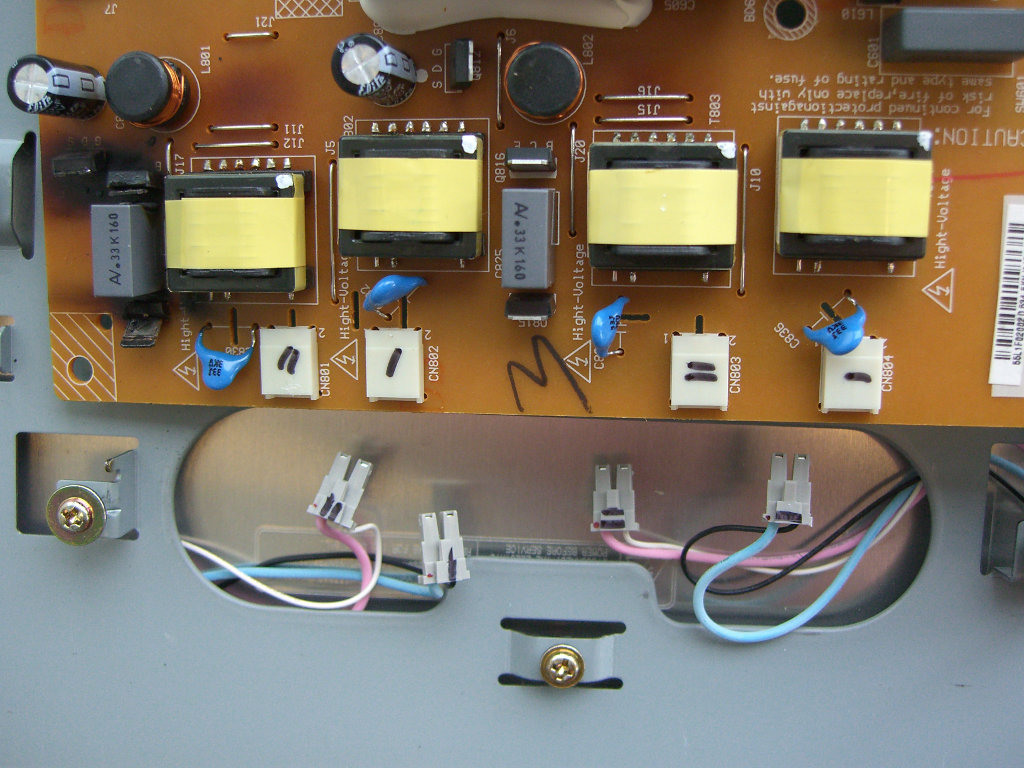

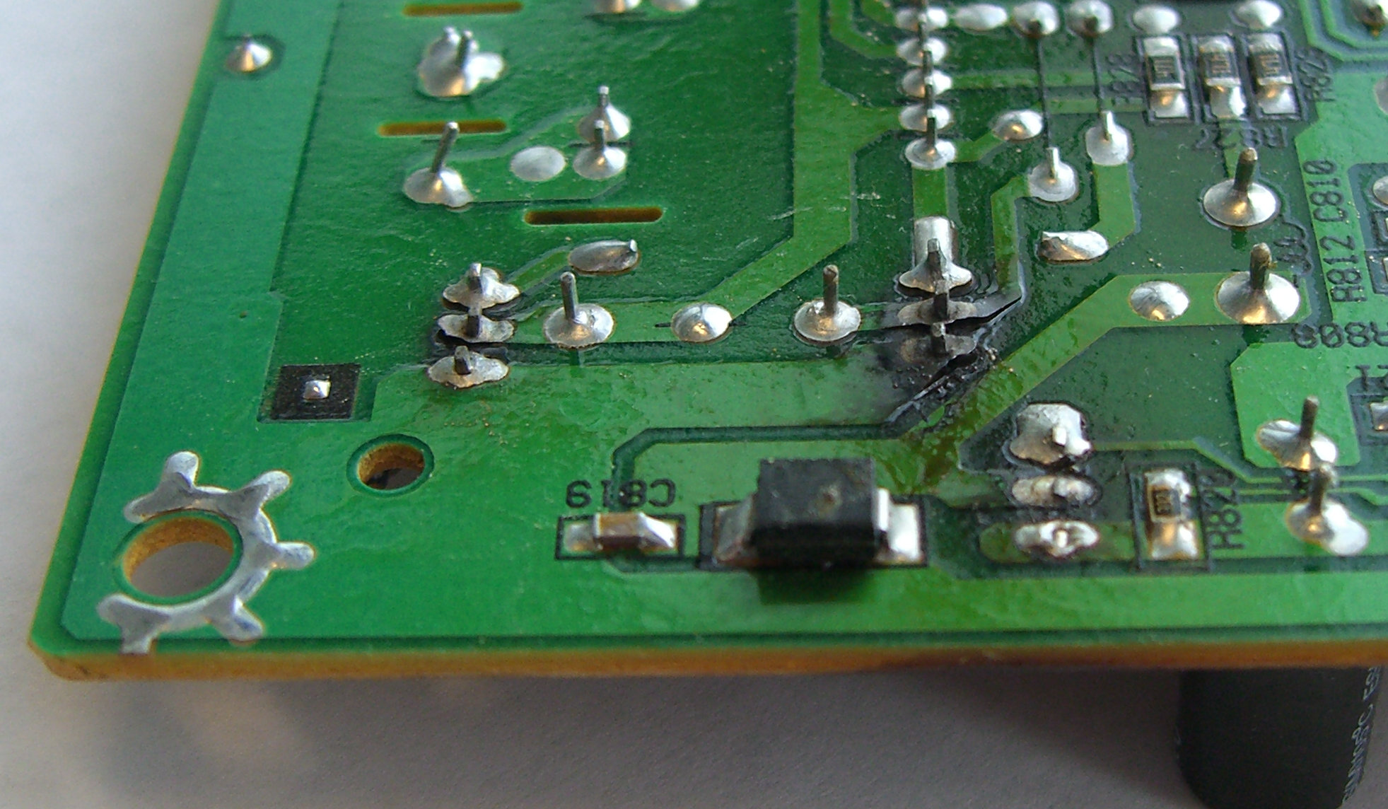

                                    I have a couple of questions for you guys. Some of the traces have lifted away from the PCB. My plan is to just reflow the solder, leave as is, test the monitor, and if needed, add some wire segments and clean away excess rosin with isopropyl alcohol since they could be high-voltage circuits. What would you do?
                                    The transformers look OK, but I should resolder them right? All four?
                                      You *MUST* resolder all the 4 inverter transformers. These Benq style boards have poor soldering on the inverter transformers which causes the picofuse to blow and other problems.
