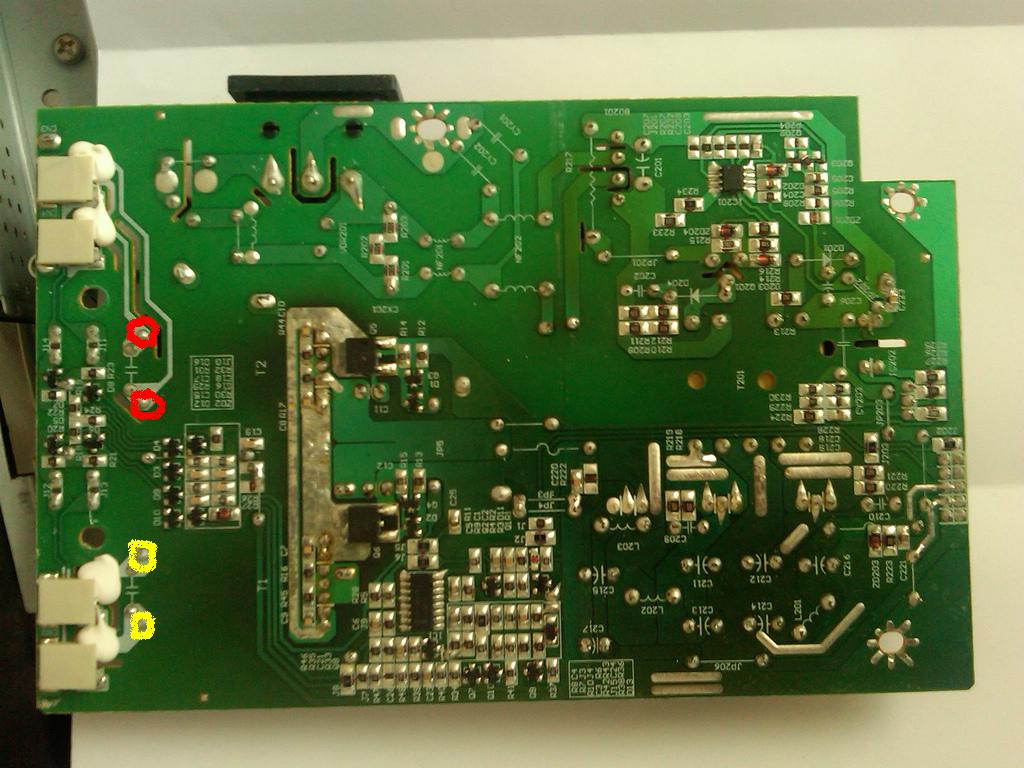

    no he just looked at it and show it to another person and they both said i dont need the caps they are fine. the other guy from the tv store said the same thing about the caps. I think I should just get a mulitmeter and test everything myself that way i know what is good and what is not. I just dont wanna remove the caps if they are infact good still. they look almost new
    ps: he tested the fuse and they where both fine.
      Re: mag 2200w lcd wont power on
      Well i am not knocking them but you cannot tell if a cap is any good or not just by looking they could be out of range in capacitence or out of range on ESR .
      You need an ESR meter to test them for ESR but they are expensive unless you do it for a living .
      With the heat you have had around the board they may well have dried out
      which again will cause them to fail.
      If you read through a few threads there are a lot of guys on here who have been doing it longer and have much more experience than i do who will tell you the same thing maybe one of them will look in and comment as i may have missed something .
      In my opinion for the sake of very little money that it will cost for new caps i would replace them anyway as they have been on the board from day one and are probably no good anymore .
      When caps fail they cause the voltages to go astray and hence cause problems like burning out other parts ie the mosfets .

              If you have a multimeter you can test the transformers i have taken the following from Retiredcaps 2 seconds to black guide (might be worth reading the whole thing if you have not already done so
              Here is the "short cut" version. Measure the resistance between the 2 red dots. Report findings. Do the same for the yellow dots.

                                ok guys I got the mosfet in and while i was de-soldering them the first one came off without really any problem. the second one both leads broke off while i was attempting to use twizer and de-solder them. after placing them in and hooking everything up its still does that but now the picture come on for a second then off. I guess the next thing is to change the caps. I will need to see if i can find any cause the stores i went to had some but they are way to big. anyways i will keep posted!

                                  Before replacing caps, I suggest you perform retiredcaps test on post #26 before you go any further.
                                    #37
                                    ok so i measure those two the red and the yellow and they both are at 768 on the resistances. the metere was seT to 2000 was I doing it right? and is that reading ok or is there something wrong?
