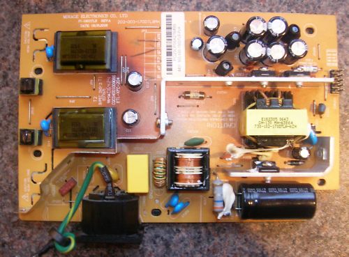

          Here is an idea of the sort of picture needed

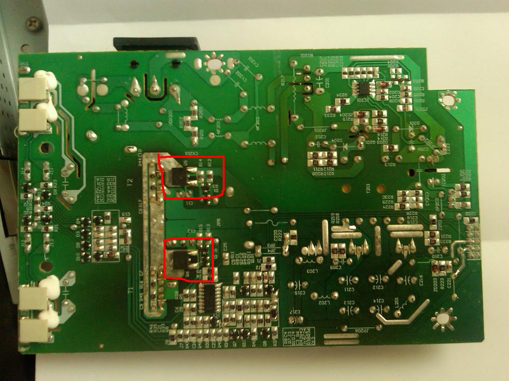

              here the pic from what i can tell it looks likes something might have toasted on the board. anyways tell me what you guys think
              thanks

                Hi on the pic i have attached the 2 transistors i have marked up should be
                3055 6G
                I have had the same problem on this type of board (used in the Phillips php-X19)
                Change all the caps except the large one and replace the 2 transistors with
                MTD3055VLT4 N-Channel Power MOSFET 60V/12A
                Caps should be
                4 x 680uf 25v
                2 x 470uf 25v
                3 x 220uf 25v
                1 x 10uf 50v
                1 x 22uf 50v
                But do double check yours

                  So all I have to do is replace all those parts for it to fix the problem? Or is it just the two you circle that need to be changed. The cap on the other side look fine though?
                    Re: mag 2200w lcd wont power on
                    As you have it apart you may as well do the caps
                    Once you have replaced these parts this may well fix the problem ,
                    if not it will have eliminated those parts and further tests can be done .
                    But i am pretty confident that the 2 parts i have highlighted are toasted
                    and that is the cause of your problem .
                    Also whereabouts in the world are so others can suggest suppliers for parts if you have any problems sourcing them

                                    HI well all i can say is the boards i have repaired looked exactly the same as the one you have posted a pic of and doing the parts i said sorted it .
