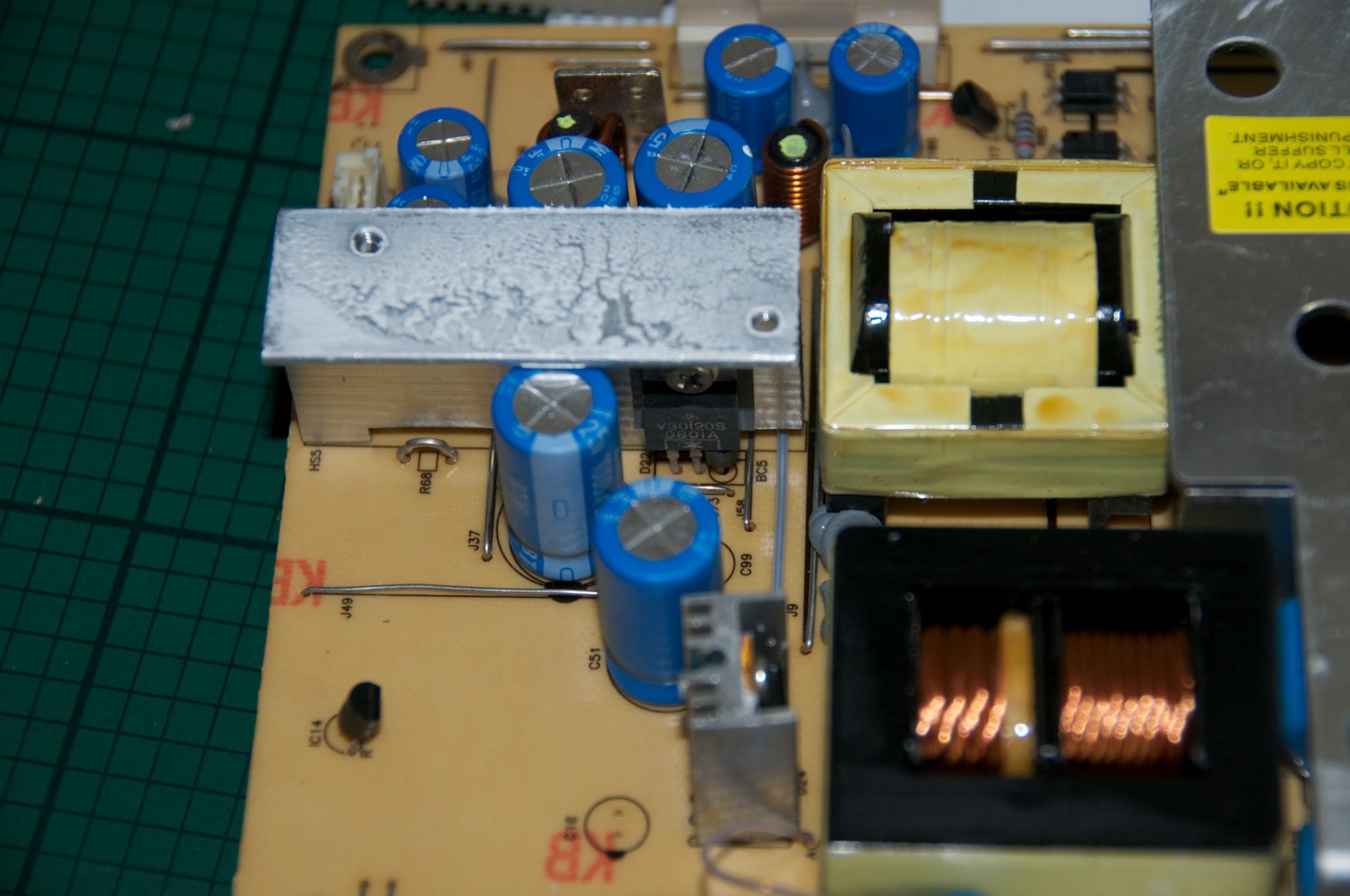

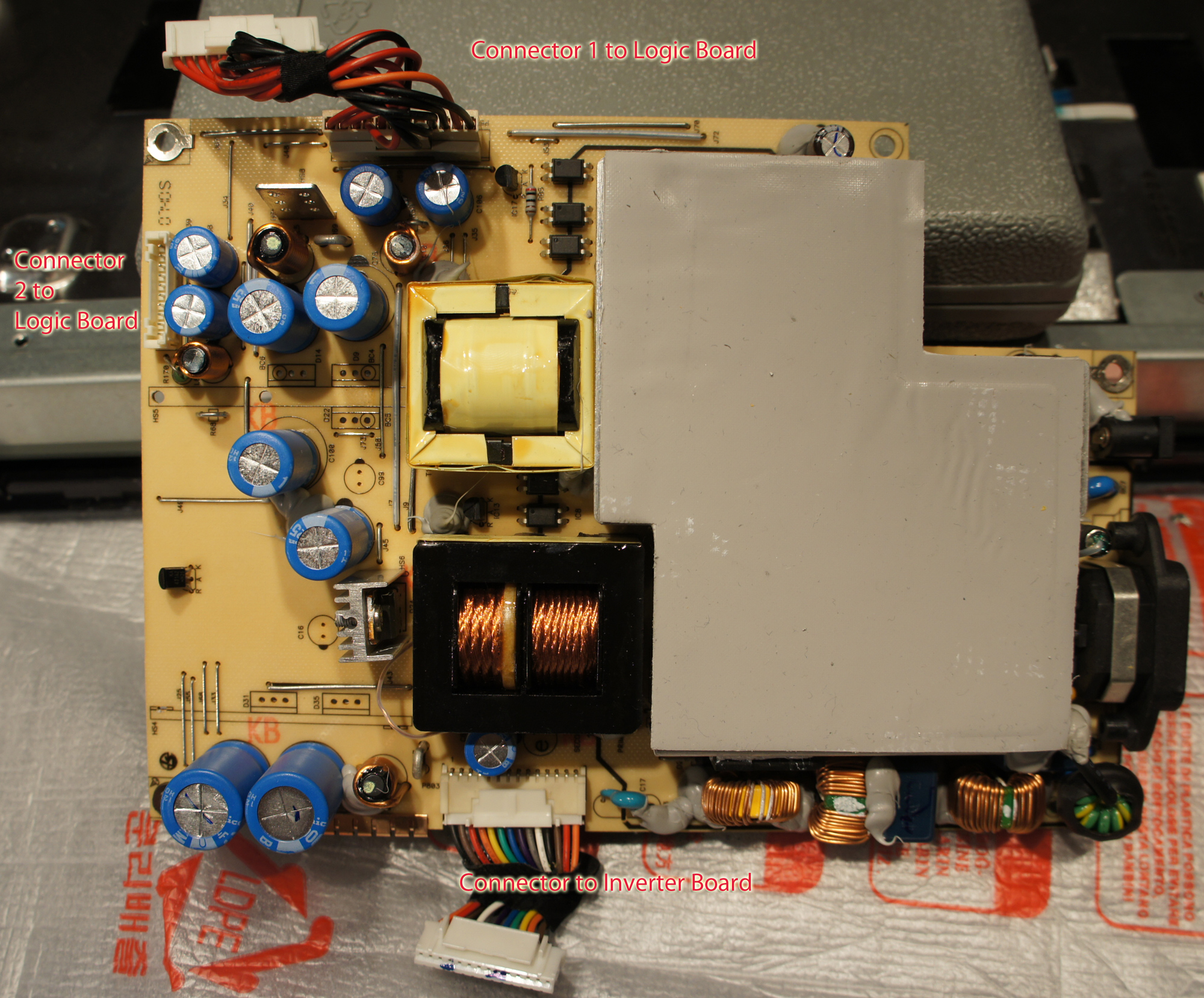

                  Here is a picture of the board. I removed all the skews. The heat sinks are tightly glued to the chassis.
                  My idea right now is to unsolder all parts from the heatsinks.

                      Finally, I managed to loosen the power board, with the right tool. Unfortunately I don't know the english name for it. See at the photo.
                      I took a series of photos of the disassembled dell 3008wfp. From the visuals I cannot see any flaw at all. On the metal covering the inverters, I found something that looks like rust.
                      My screen went dark one day and never turned back. Computers still recognized the display and it seems to operate except that it does not display any image.
                      Where should I continue to look or measure?

                        Have you tried checking D22 for a short yet? It seems to be a weak point for this power supply.

                                If the diode has not failed open circuited (high current) then you probably won't see if the diode is failing short circuited with a multimeter. I am assuming previous failure of D22 on other monitors in this thread was a sort circuit at operation voltage without causing the diode to fail permanently in an open circuit state (both directions). Maybe the other members who have removed their faulty Schottky Diode can report on the state of the diode with a multimeter?
                                I'd would start by replacing D22. Did the power light at the front turn off or go from blue to orange?

                                    OK - thanks for the pictures They are a little better but if you look at them and try and see what I am asking you to test you will see the problem.
                                    Wait and see if you get any more info about the D22.
                                    Easy things to test - On pic 1 in the middle of the board there is a fuse F1 - check with meter on ohms200 should be the same as touching the probes together.Report result.
                                    Also on that board the top connector is twisted - is it attached ok?
                                    Again on that board, with meter on 2000 ohms can you check each transformers secondary winding- that is the two pads on the white band the connectors are on. Please records results as
                                    T1 xxxohms
                                    T2 xxxohms and so on
                                    The Yellow caps on that board ar Samyoung which do not have a great reputation.
                                    On Pic No 3 top right corner there are 3 other white fuses F301 and F302 & F303 next to each other
                                    on Pic 6 there are 3 fuses bottom right F1 F2 F3 not all populated? Also on this board there are components labelled FL1 to FL8 these are fusible links and blow just like fuses so they can be checked the same There may be more of these and more fuses I just cant see.
                                    Finally I attach a pic with joints marked in red - Maybe just the photo but they look burnt - can you check them - may need resoldering.
