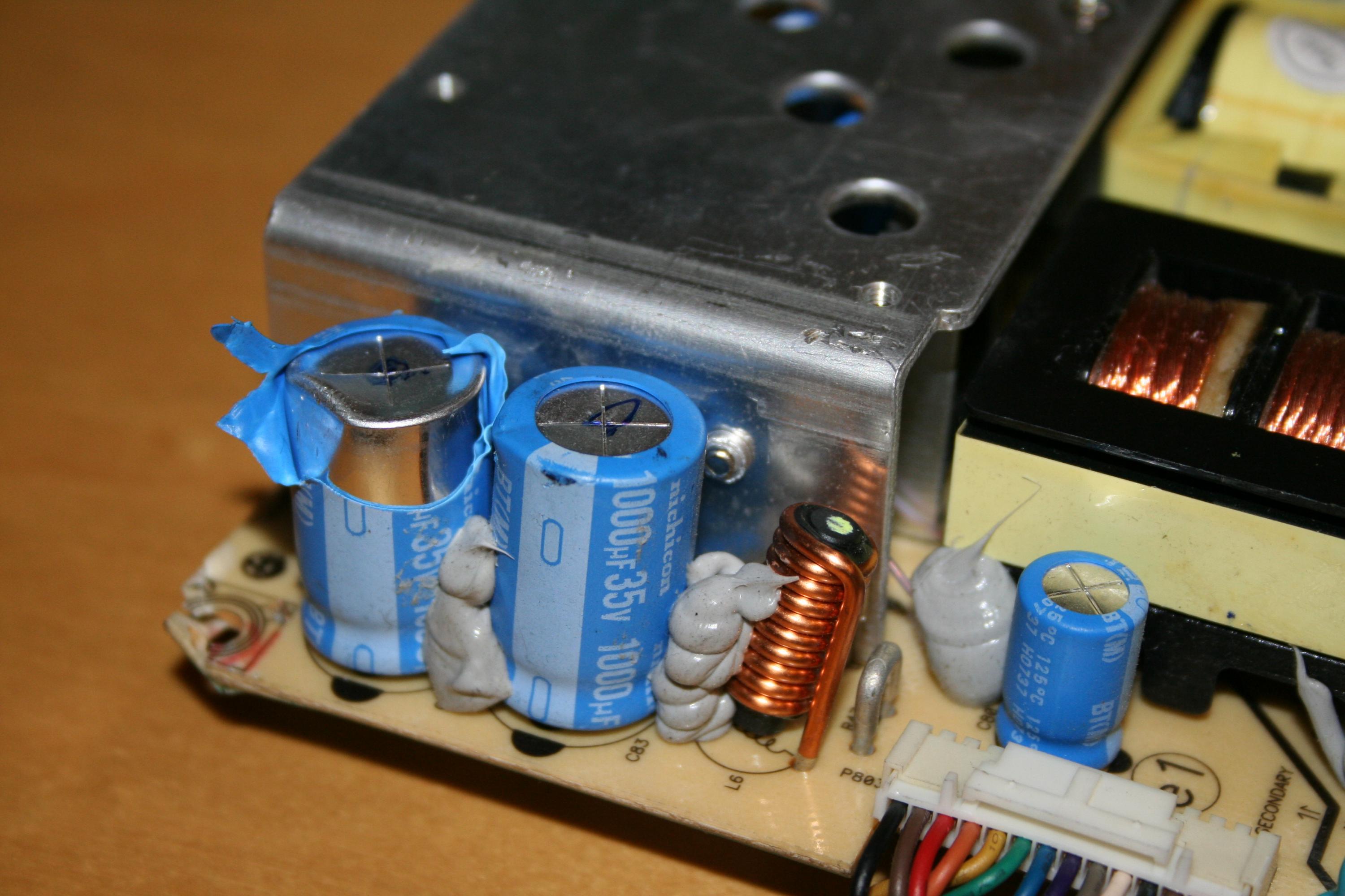

                #287
                Re: Dell 3008wfp faulty power supply
                Replacement arrived today. One of the capacitors has been damaged in transit, trust my luck... Also looks like the diode has been replaced on this board with an identical replacement. *sigh*

                    #289
                    the cap has a dent in it, will it still function correctly? It has not split open!
                    Shall I look to replace the diode or shall I see how long this one lasts?
                      Its a catch 22 considering your soldering might be better to leave the cap but if it is damaged then if it goes really bad it could take out more components.
                      Again, I would try leaving the diode but I cant remember - if that goes does it damage other components? has anyone said what causes them to go bad ( Knock on from ripple from bad caps?) or are they just under spec.
                      What make are the caps on it?

                        #291
                        I have a feeling they're under spec.
                        All caps on the board are nichicon
                          When the D22 schottky diode goes out; it doesn't take any other components with it. You just have no power. No Led. I believe it goes out during a voltage spike because the original is rated at 120v (reverse voltage) and we are replacing them with 170v.
                          The caps on that power board are excellent. 125c Nichicons. If it just has a small dent I wouldn't worry. Like you said, if its not split open or leaking. But that's your choice.
                          Or, you can contact the seller and tell them you want a replacement. Good luck man!

                                #295
                                I switched it on earlier for about 30 seconds and not much happened to be honest. The cap is a 1000uF 35V one. Pics to follow
                                        the damage is miles away from damaging any traces
                                        Pinching a cap off the old board sounds good, however I doubt my soldering skills...

                                          #300
                                          Great pictures fuus. It looks like it's been dropped. You should send those pics to TaoBao. If they don't back up their products, they are not getting my business, or hopefully anybody elses that read these threads.
                                          I see the corner of the pcb is also chipped. Normally that would be a ground internally. But who knows what other damage may have incurred. That chinese company better compensate you, or they are not getting any of my business. Up to you mate. It shouldn't be making a whining noise either. The ones we replaced were totally silent. Contact them, and tell them all the problems. And that it has been dropped and damaged. That's totally unacceptable mate. Good luck.
