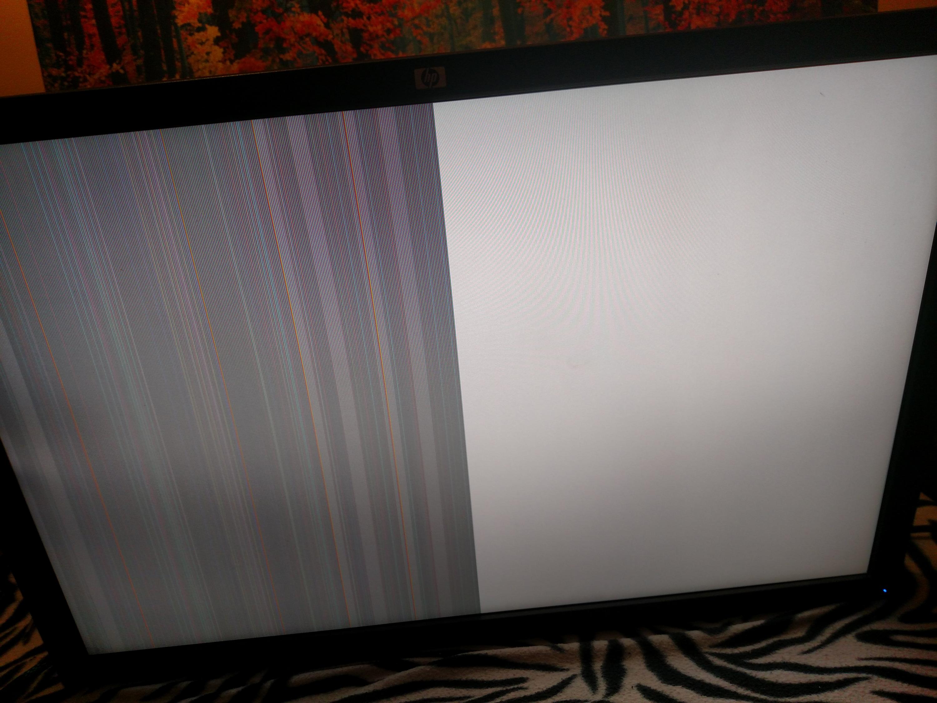

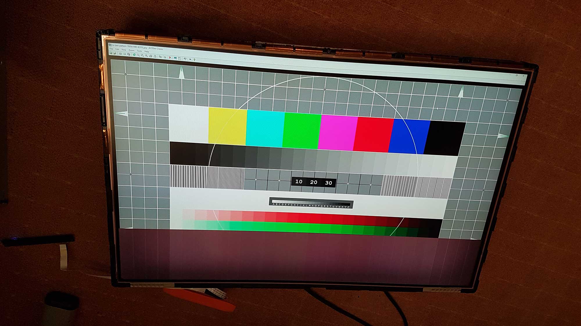

        I repaired PSU 2or3 years ago(no power at all), as I can remember I just replaced diode D22.
        Monitor worked again perfectly until today.
        Now problem is different, lower 1/4 of LCD does not work (black or low light stripe lines on that area, see pic).
        Any idea what could be wrong?
        Thanx.

          Re: Dell 3008wfp faulty power supply
          You can try to touch the connectors on the side of the LCD panel, to check if there is a bad contact.
          You can also watch norcal715's videos on YouTube, like this one: https://www.youtube.com/watch?v=WuwG5wqxTpE

            #545
            Tried to press side connectors but no luck.
            Will try to clean cable connectors.
            Thanx

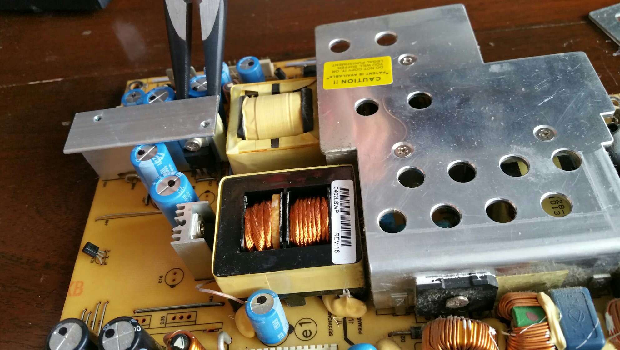

                • deepaksesh
                  • Feb 2018
                  • India
                  #548
                  Recently repaired my 3008 by replacing Diode d22. Thanks to this wonderful forum, saved nearly 20k Indian Rupees.
                  If anyone else needs info, i will be glad to help.

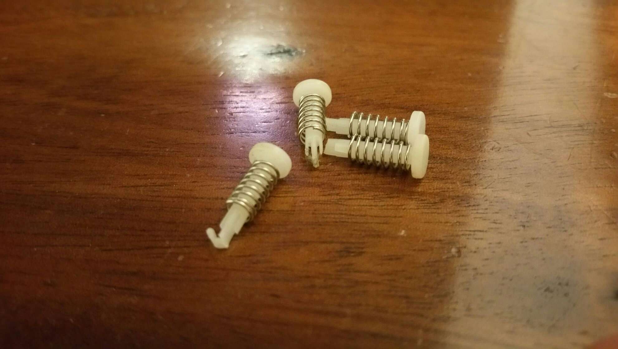

                        Also if anyone is out there, any idea where these 4 sprung plastic rivet things in the pic go.

                          Couldn't work out where those sprung plastic rivets came from, but I'm just thinking of the weight saving if I have to pull it off the wall again.

                              The plastic prongs with springs are studs which hold the heatsinks down. I believe there are 2 each for the 2 chips (4 studs in total).

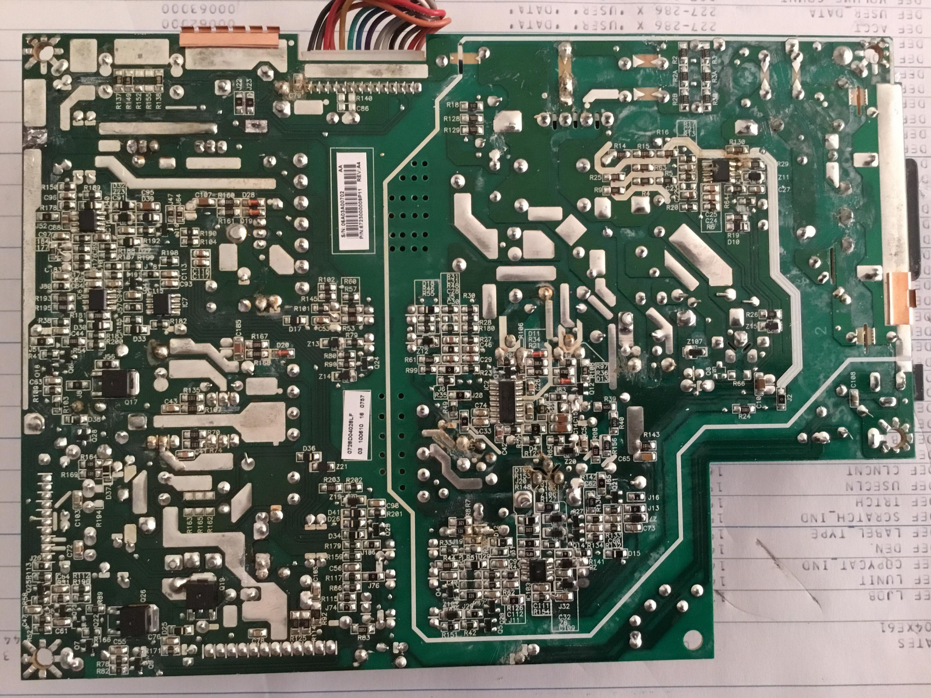

                                  Tell me what voltages need to be applied or what needs to be closed in order to start the power supply autonomously.
                                  • chsn
                                    • Aug 2022
                                    • 4
                                    • uk
                                    #557
                                    Do I need to load the line at 24V? How?

                                        #559
                                        Cold part scheme, there are errors, we correct. JPG and Diptrace format.
